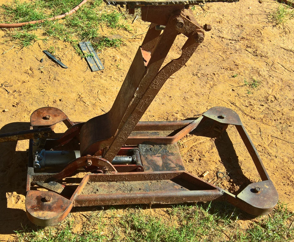

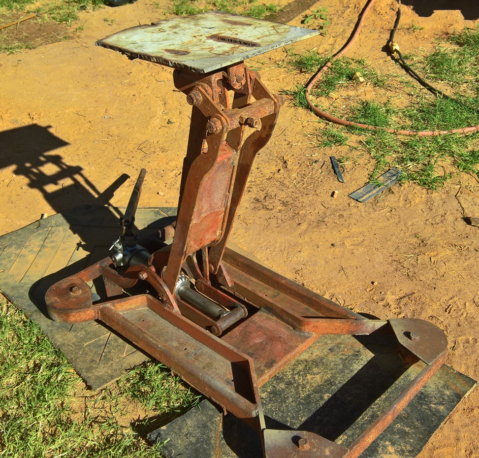

    Sometime in the late 70s I found this one in a pawn shop not far from where I had lived, the top plate had been modified by welding a piece of scrap plat on it. Now I'm not even going to speculate that it was the same jack my dad had that didn't matter to me when I bought it I bought it because I needed one and this one was cheap Along in the early 90s I rented out a section of my shop to a mechanic he needed a transmission jack so I gave it to him he died about 6 or 7 years ago and I got the jack back it wasn't working. I pulled a transmission out of a Dodge a couple weeks back using my big jack but there is too little room under the truck for it so I decided to see if I could repair or rebuild this one.

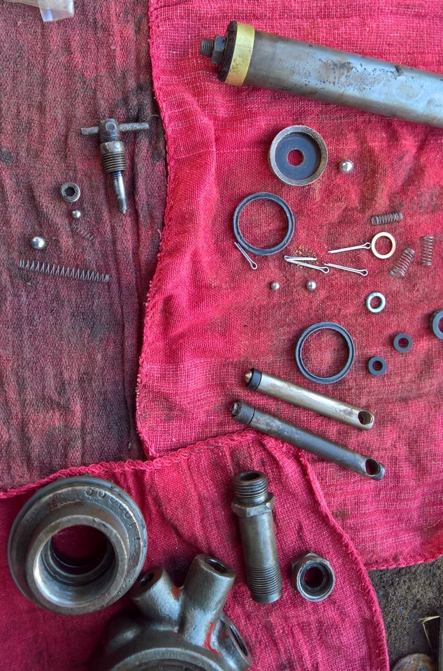

    A week later the kit arrives. The pump stem is short by .625, other than the springs the rest is just fine

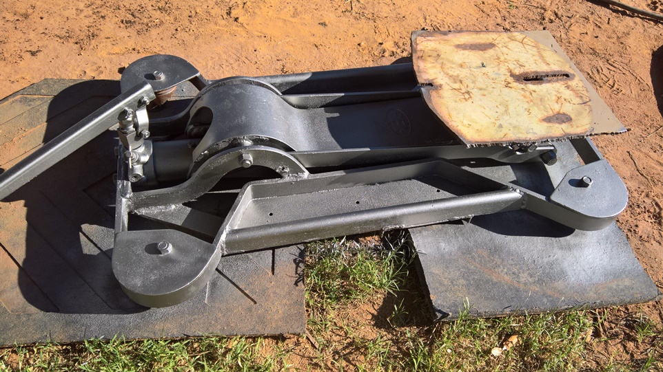

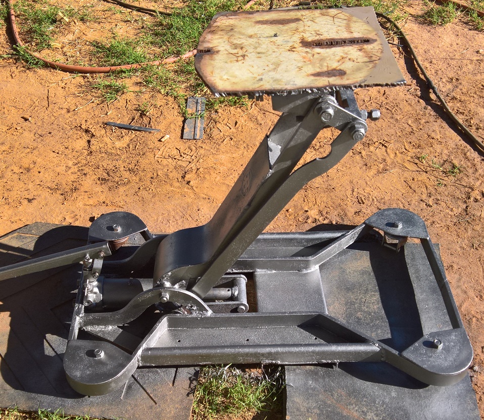

    The color of the week is KBS stainless steel top coat because I had it on hand
