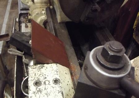

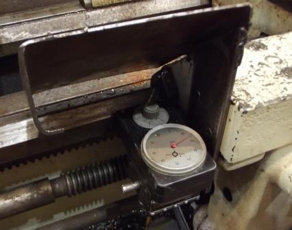

    One thing that I've always had on my lathes is a trav-a-dial. But until now I hadn't had one on either of my La-Blond lathes. SO today I decided to make a mount for one on my 19 x 60"but this time I wanted it on side of the carriage nearest the chuck since I do a lot more close in work than long turning now days. the problem with having the instrument located in this area is the swarf or chips and doubly so since I do a lot of blue chipping hog off work as well.
    So a deflection cover was required do do this I used a short piece of 6" 'C' purlin coped to match the angle of the carriage arms so as not to interfere with the max swing of the lathe

    And you probably gained carriage travel outboard for instances when long parts are called for. I'd guess the inboard clears, by width of chuck, offset of tool post and cutter.

    TM51 the chip guard just barely clears the High low or as it would be called in older lathes the back gear lever.
    the trav-a-dial does not interfere with close in work in the least on this particular make of lathe.
    But yes it would have limited the outboard travel somewhat had I mounted it in the usual position out board of the lead screw thread count indicator. Actually the trav-a-dial did come with a mount for that location and with very minor modification to that mount I could if need be put it there.
    My whole reason for wanting to locate it where I did was I sometimes make 2 3 an 4 grove pulleys with the web being on the center line of the groves doing all machining after the bore and key way is done without removing it from the lathe so to do this I use a keyed arbor this allows me to cut both sides of the web.
    Sometimes when having to work that close to the chuck it is nice to be able to see what your are doing and still be able to see the trav-a-dial at the same time since I have to actually stand behind the chuck.
    What it really boils down to I guess is it works for me and when I don't need it I simply rotate it on the mount away from the bed to reduce wear and tear Someday I might even join the DRO world and do away with it but @ 63 I've never needed DRO yet

    We've a little 12" LeBlond at work. There is little room on carriage left; I can see where QC gear box or control of head stock are likely to interfere. Trav-a-dial on left makes perfect sense - only with shield as you did. All of 'their' dials are mounted right side, and probably every lathe I've ever seen. Trav-a-dial set the precedent in their mounting hardware and buyers just herd along.
    Surprising situation. We're supposed to be so innovative, with facilities to create anything, yet follow along like sheep.
    re: DRO'S, when you are really working, flashing digits are not faster than creeping up with a needle. With QC holders and tight OD / ID's to hold they can't be beat. You don't have to figure which turn of the crossfeed you are on, just look at tip of tool, and then get the thousandths right. It's real fast with masking tape split on joint of slide and carriage, and a mark for operation steps - kind of like a vernier.

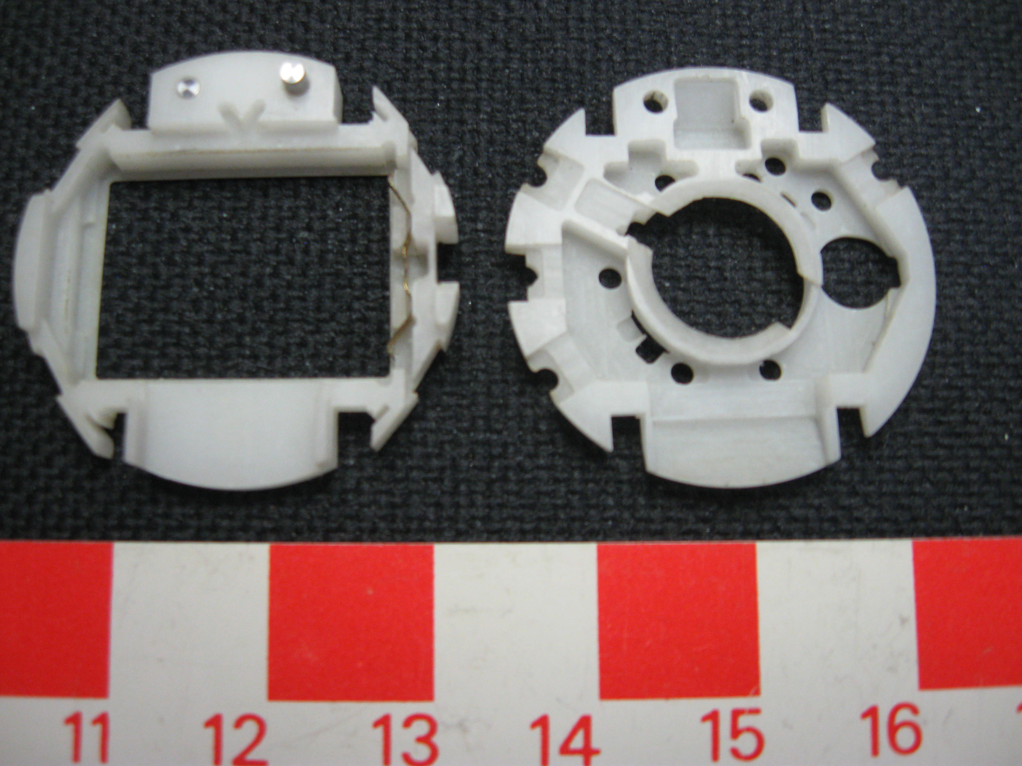

    For milling I like Trav-a-dial much more than digital readouts. With a dial you can see your approach to the mark, not just waiting for a digit to flip. I made these delrin watch parts on a Bridgeport with Trav-a-dials. Trav-a-dial mount & chip guard-img_3010.jpgThe diameter of the parts is 1.1". That is a cm scale. Once everything was set up I could mill to the numbers and finish a set of these in 6 hours. Carl.
