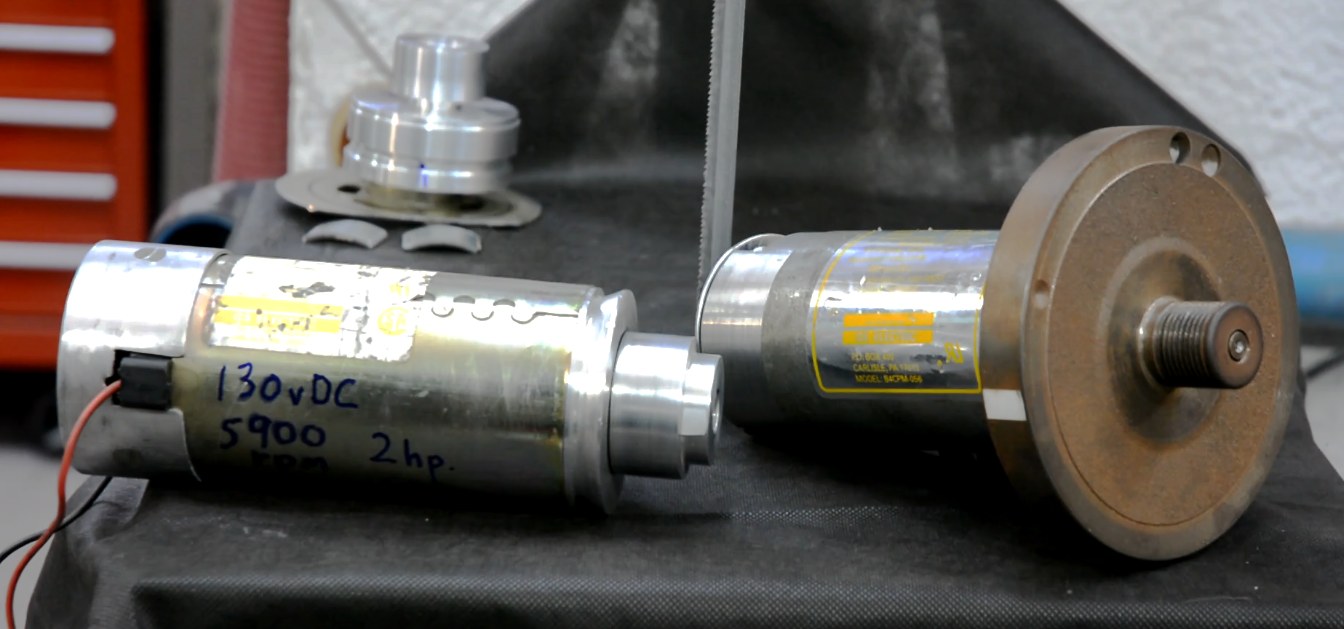

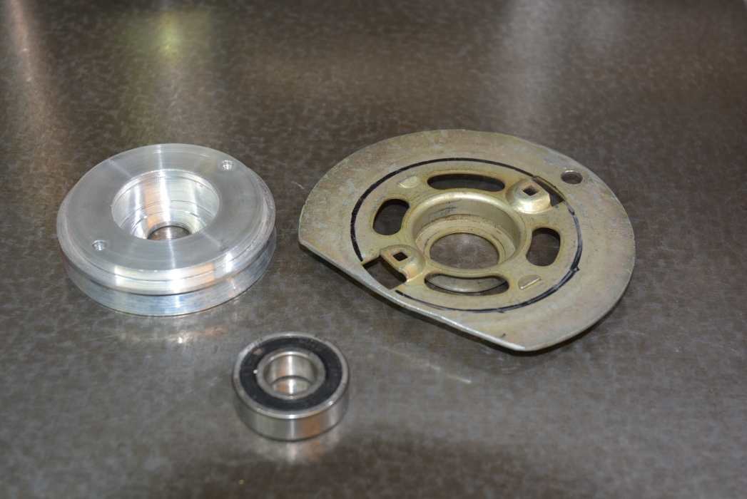

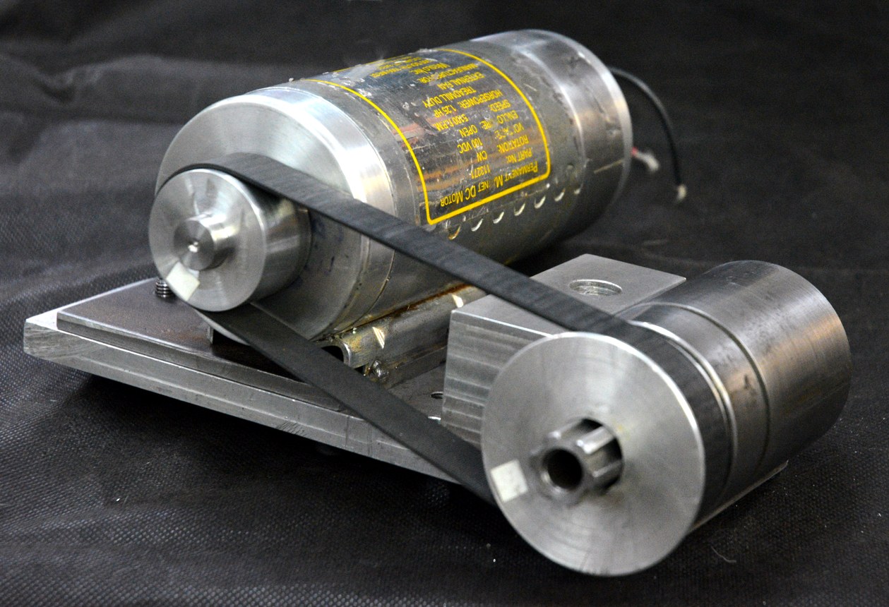

Attachment 38011 The objects in question. (click images for full size.)

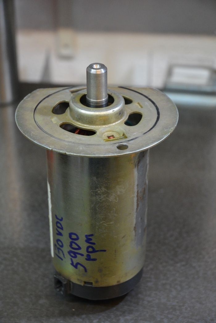

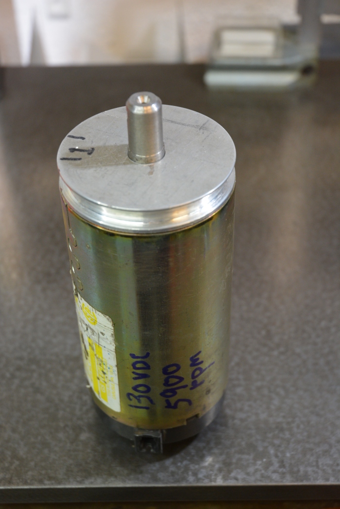

Attachment 38005 Attachment 38006
Attachment 38007 Attachment 38008

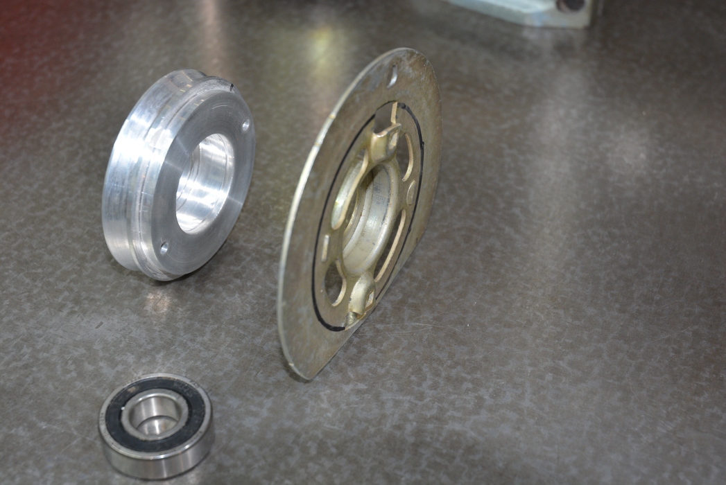

Before and after main bearing carrier (above).

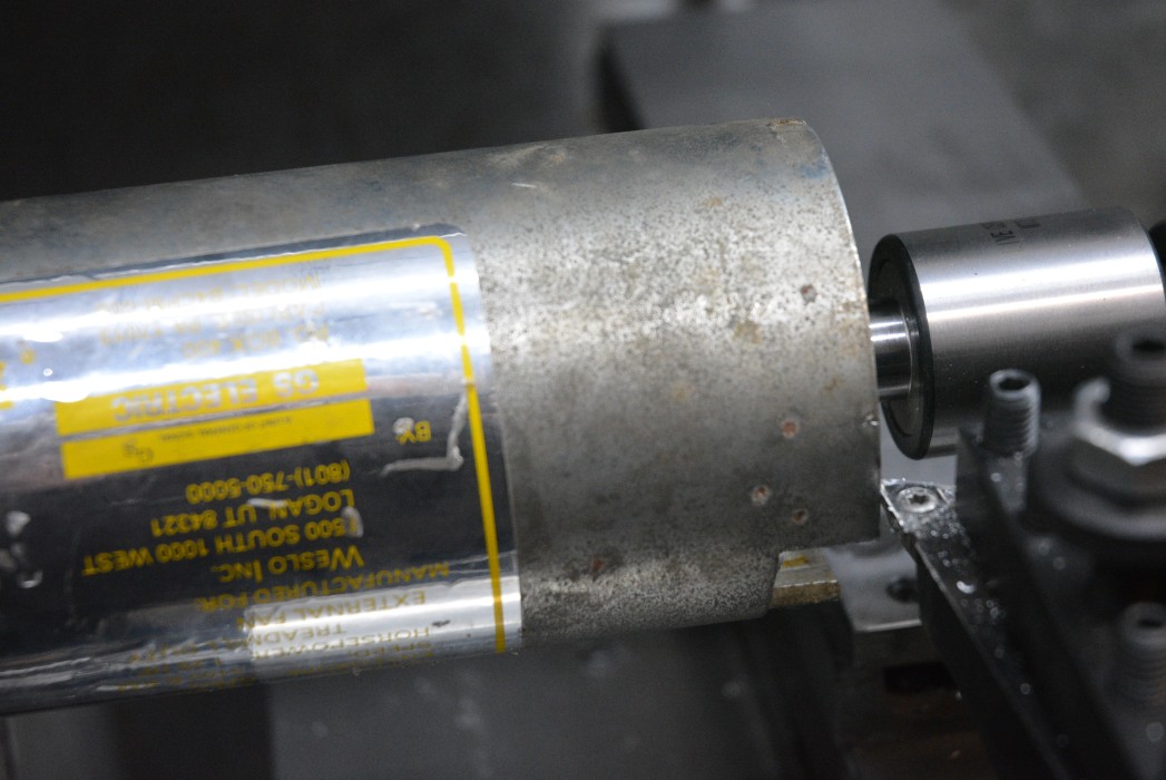

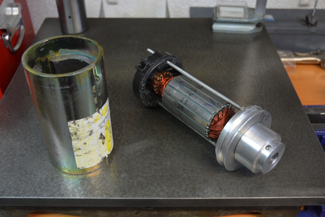

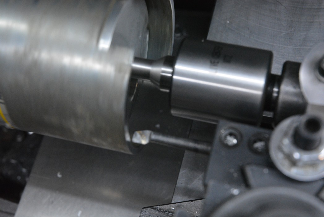

Attachment 38009 Attachment 38010
Truing the casing.

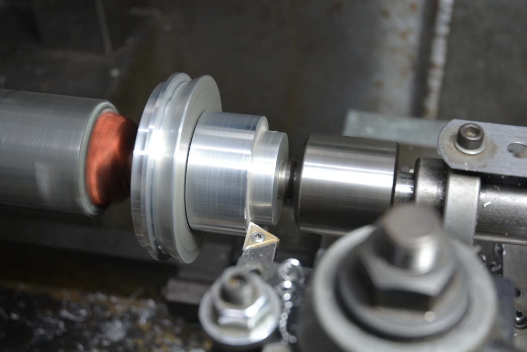

Attachment 38012 Truing the flat belt pulley on the armature.

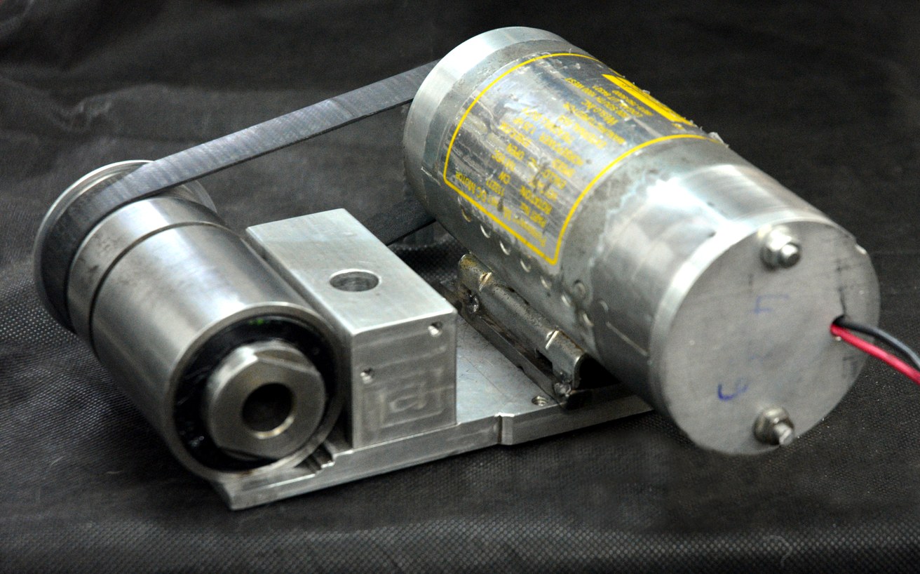

Attachment 38013 All the bits.
