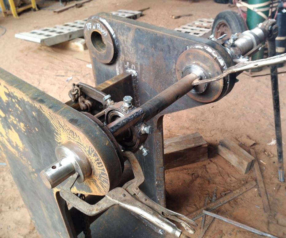

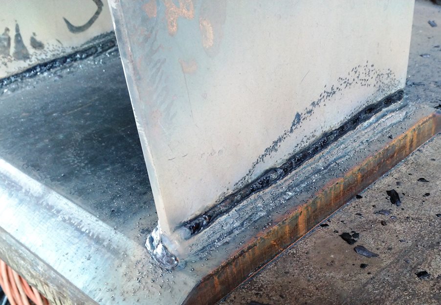

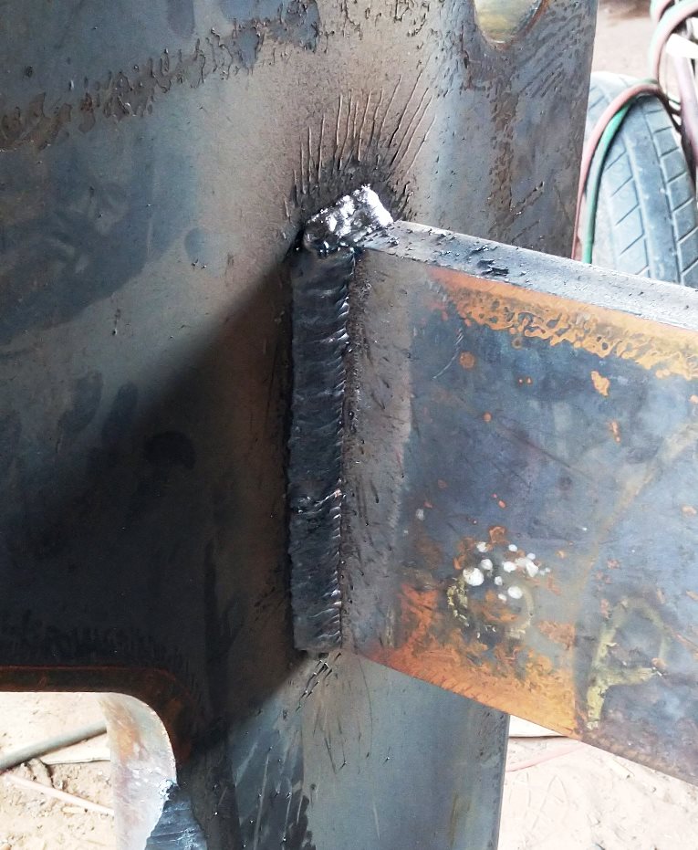

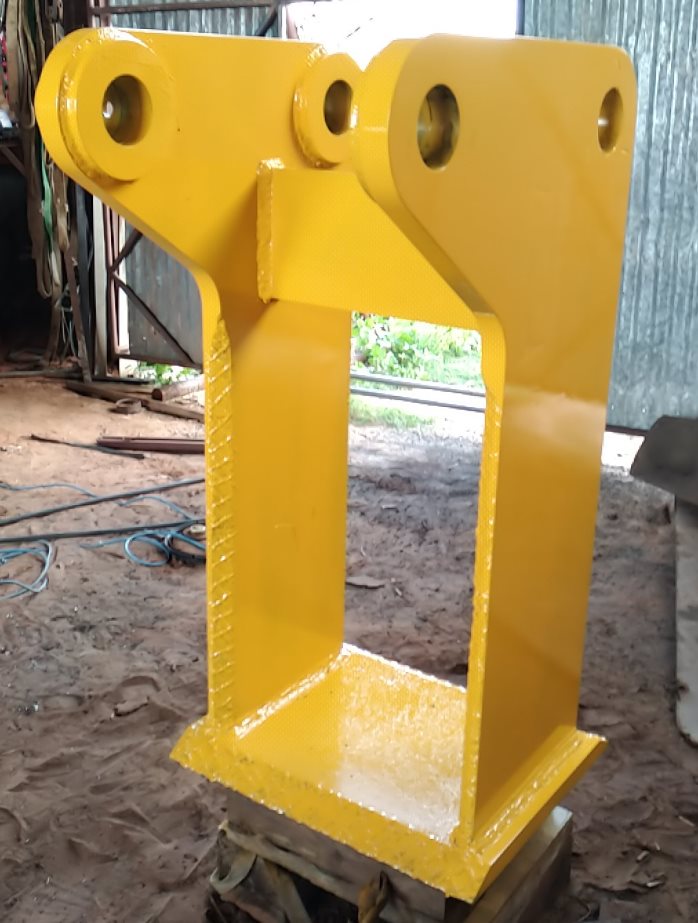

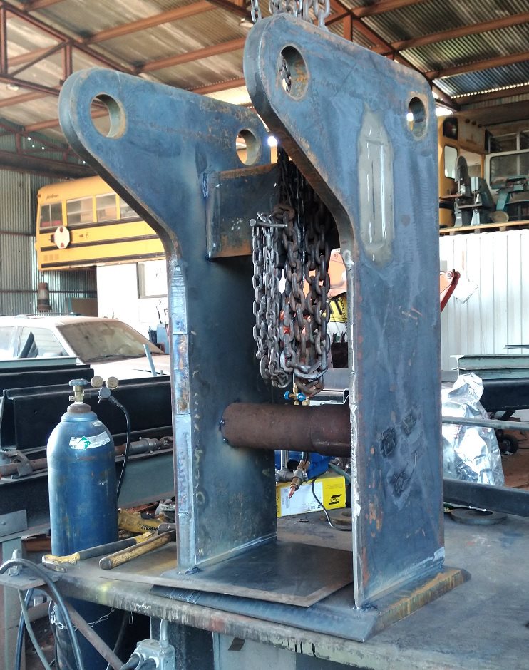

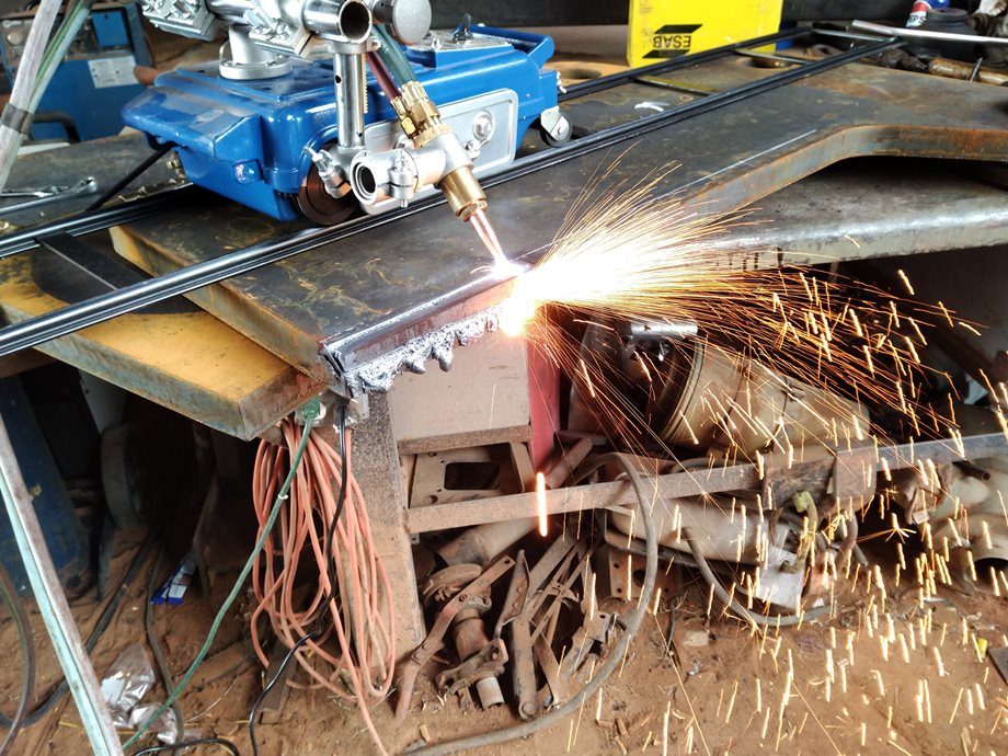

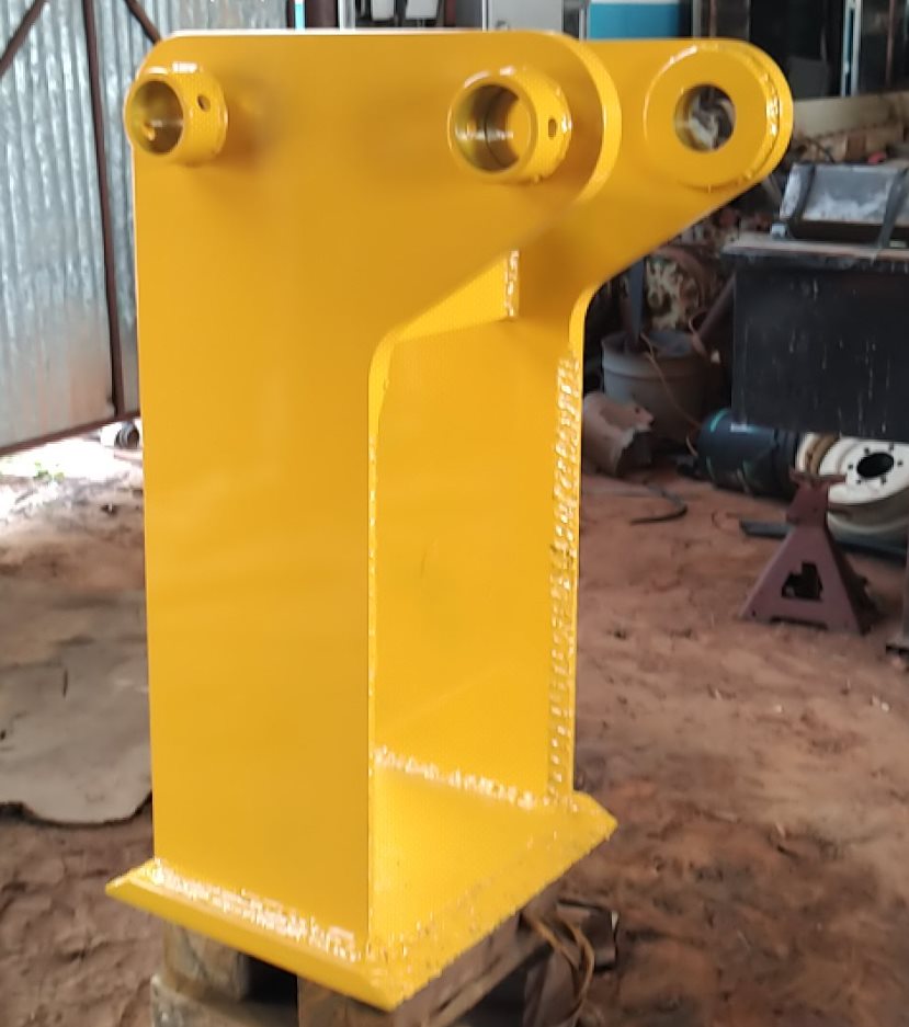

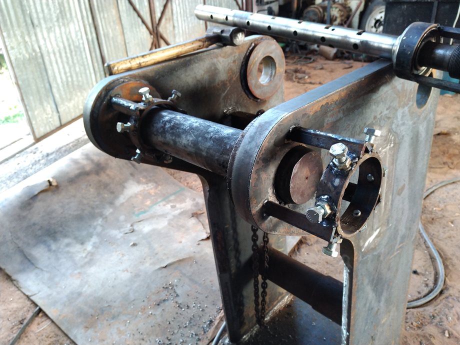

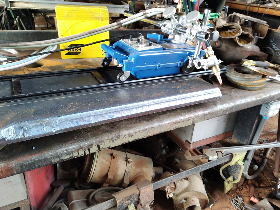

    I just finished and delivered this grubber. It is 4 ft tall has an open digging depth of 36inches 22-inch-wide cut 18 inches inside between the sides Fits excavators with 16-inch width stick and dog bone that use 90 mm pins approximately 900 lbs. made entirely out of 1 1/2inch gr 572 plate steel 30°beveled and hard-faced cutting edges
    Pin locations were line bored after welding

    GEEZ, that is a monster. Would love to see it in action. When i get time to work on it, I am clearing and grubbing weed trees and roots on a 4 acre plot with my OLD Ford 455 backhoe. But very few of the weed trees have more than 6" trunks.
    You burned up a couple of pounds of rod on that!!!
