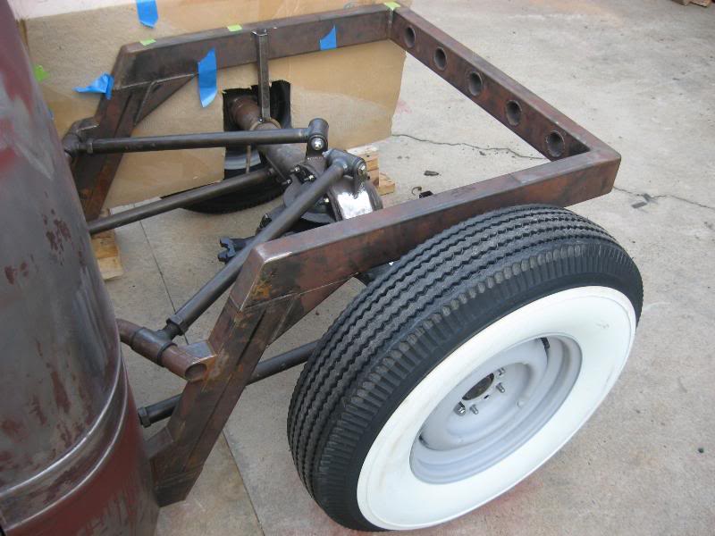

Details:

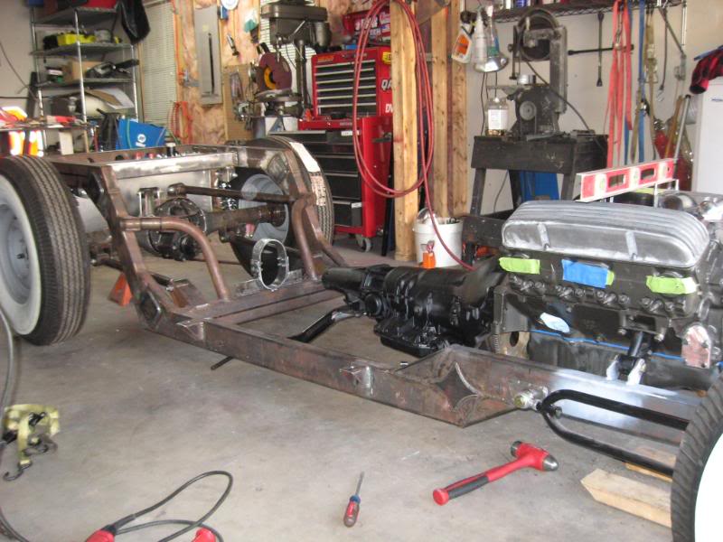

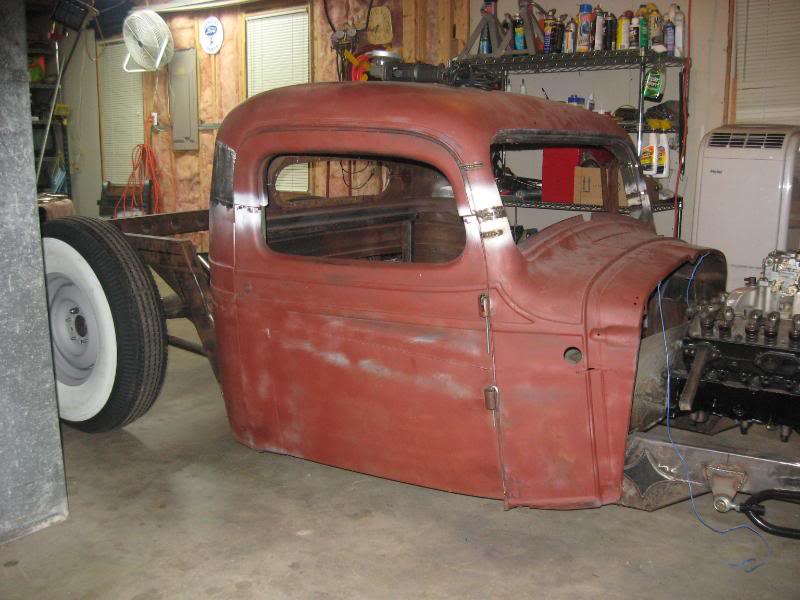

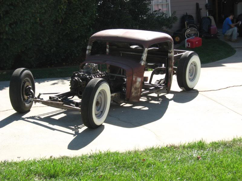

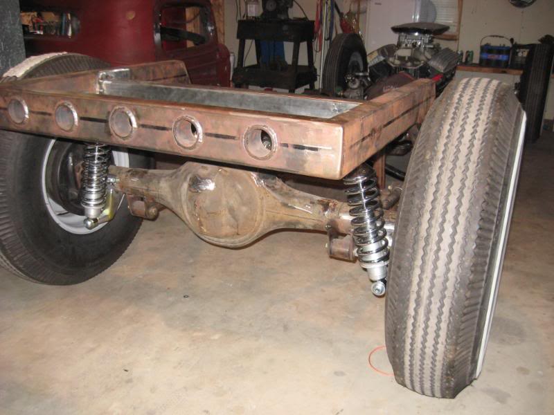

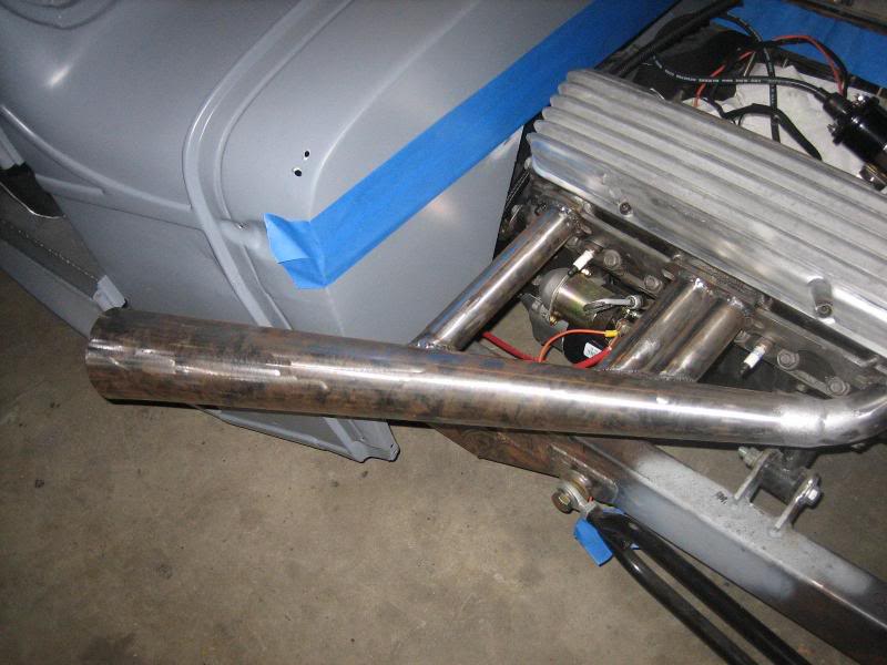

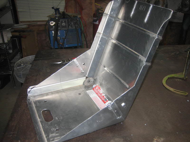

-body sectioned 8 inches and channeled 4' over the rails
-8" Z up front and 18" in the back
-350 engine
-4" speedway dropped axle
-Ford spindles with Chevy discs
-shortened 9" rear with 4 link
-swapped 700R4 for freshly rebuilt TH400
-cut up race seats because bombers were too expensive
-3 rochester carbs
-bumper made from 2 wishbones
