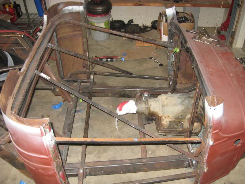

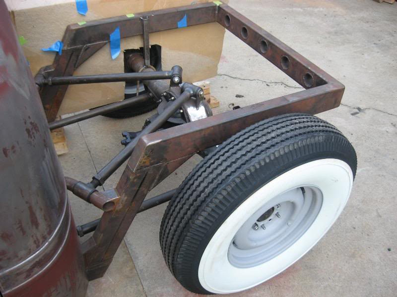

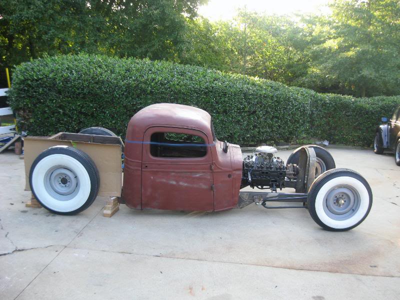

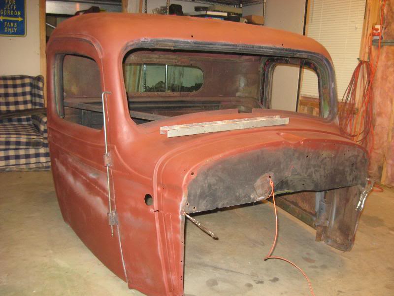

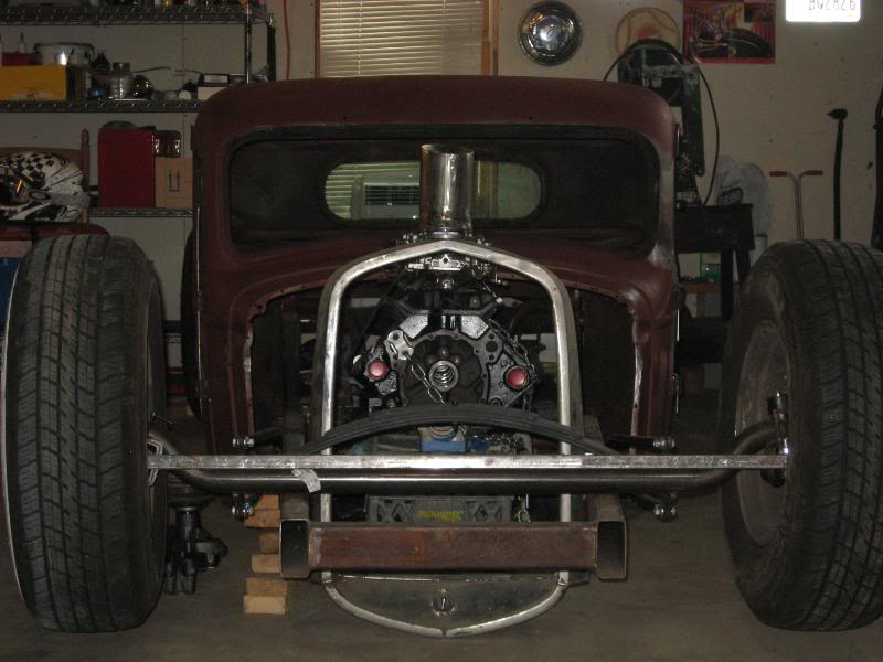

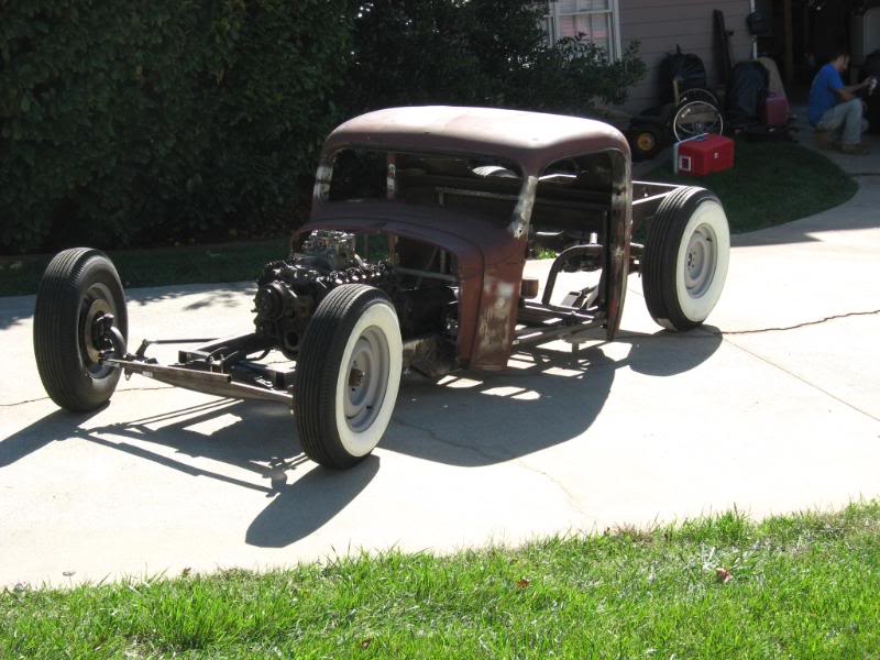

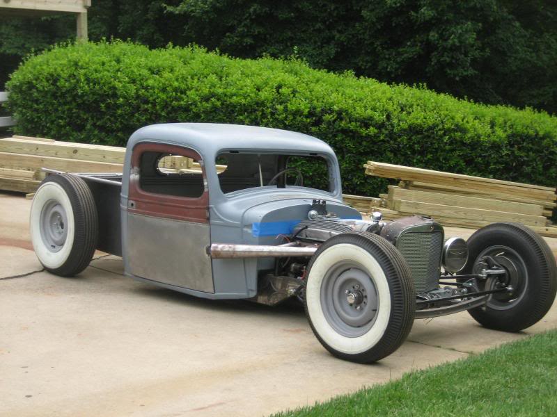

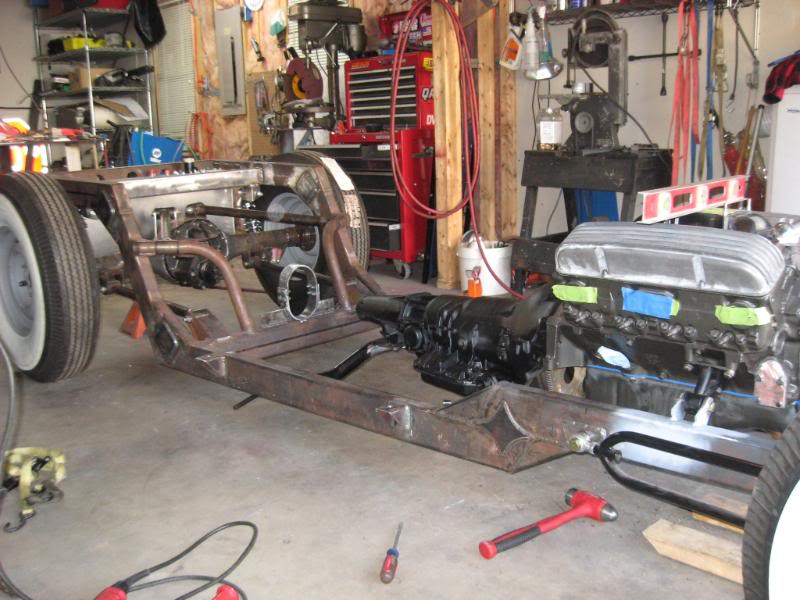

This '36 Chevy Low Cab Pickup was built by willmceliece on RatRodsRule.com.
Details:

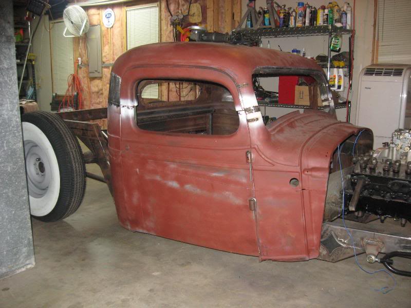

-body sectioned 8 inches and channeled 4' over the rails

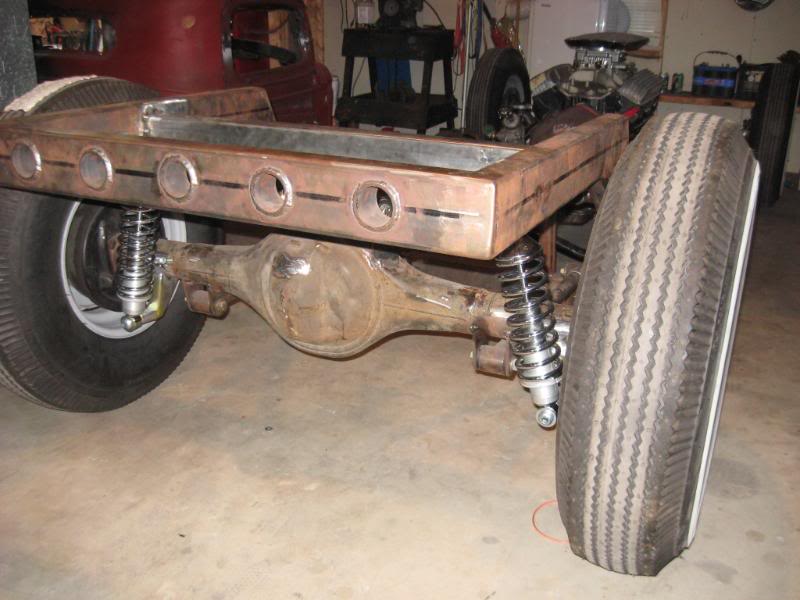

-8" Z up front and 18" in the back
-350 engine
-4" speedway dropped axle
-Ford spindles with Chevy discs
-shortened 9" rear with 4 link

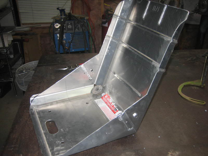

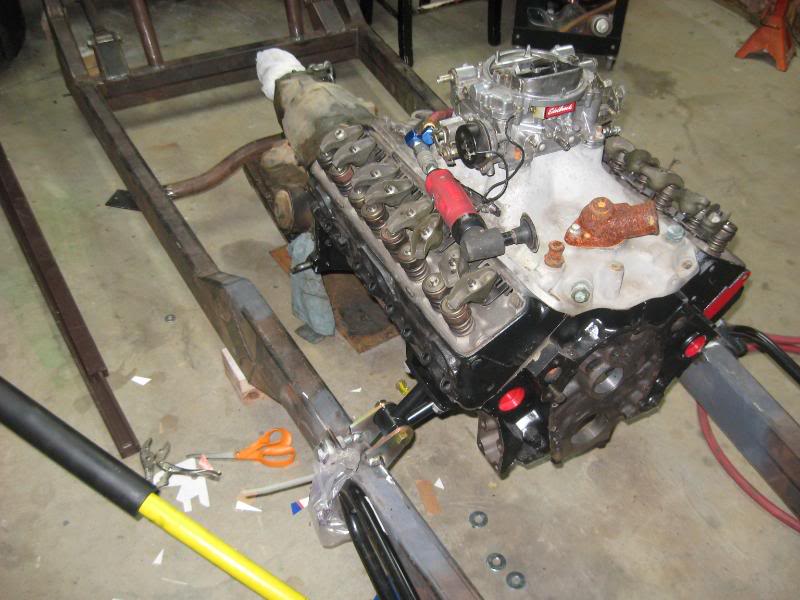

-swapped 700R4 for freshly rebuilt TH400
-cut up race seats because bombers were too expensive
-3 rochester carbs

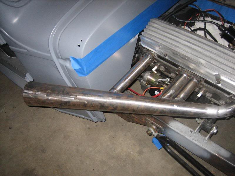

-bumper made from 2 wishbones
"Rat rod" usually hints at a younger builder, but I would not have guessed that this first-timer is only 20! Says another poster in the build thread:
"You are blessed with skills many people will never acquire over a whole lifetime of building, stand tall and be proud of yourself, you've earned it!!"
