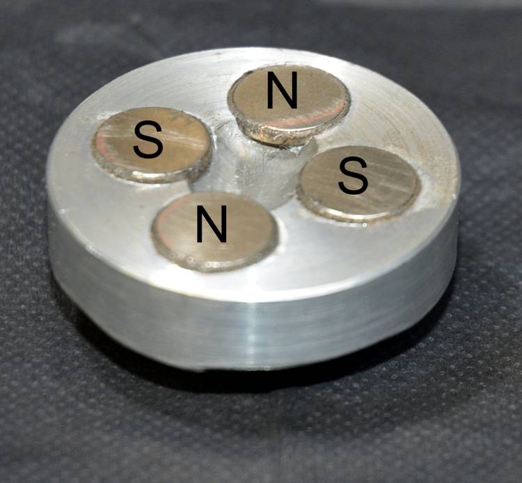

Just to be clear, I am talking about a plate type device like the attached photo, not a drum type.
Attachment 50312
Perfect — thanks for the photo. Yes, that’s exactly the kind of plate-type, 4-pole rotary demagnetiser I was describing 👍
What you have there is typically:
• Four permanent magnets arranged N-S-N-S
• Mounted in a rotating aluminum (or non-magnetic) carrier
• Producing a rotating, alternating magnetic field at the surface
Why withdrawal speed still doesn’t matter with this plate type
Even though it looks simple, this style of demagnetiser creates:
• A rotating vector field, not just a simple in-out AC field
• Continuous reversal and rotation of magnetisation direction
• Strong domain scrambling in multiple axes
So the tool sees:
A rapidly changing field direction and polarity before it ever leaves the active zone.
That means:
✔ The domains are already being randomized efficiently
✔ The residual magnetism is already being driven toward zero
✔ Your hand motion no longer sets the “decay profile” like it does with a single AC coil
So just like you observed:
🔹 Fast withdrawal ≈ Slow withdrawal
🔹 Practically no difference in result

A plate demagnetiser like this is engineered so that:
• The field geometry does most of the work
• Not the operator technique
No ritual hand-waving required 😄
