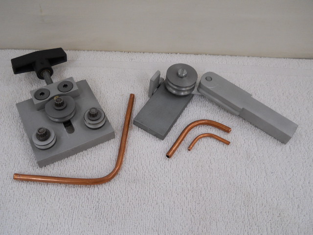

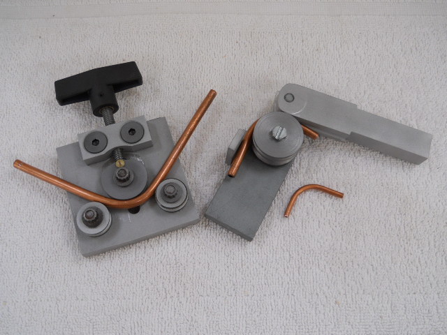

Two tube benders, one has a reversible wheel for a smaller diameter tube.
Attachment 36181Attachment 36182

Neat, have you considered using a bearing mounted wheel on the bender arm instead of the high friction 'shoe'? I work with stainless steel tubing a lot and it makes a huge difference, especially working 1/2" tube. Even my copper benders for household plumbing uses a wheel acting on the shoe to reduce friction.
Looks like it works well. Could the bearings be smaller and movable to create a tighter bend if using say 1/8" or 3/16" tubing? I have some craft applications that need smaller tubing like that bent without getting crushed.

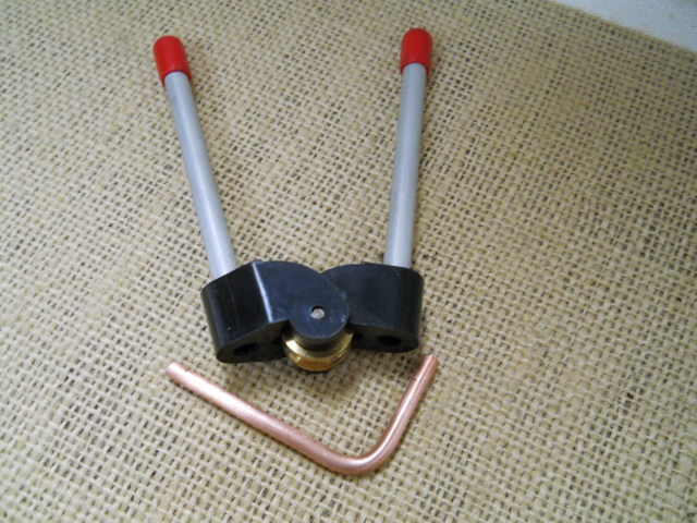

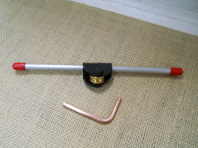

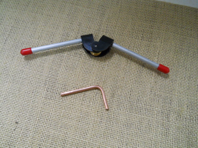

Attachment 36453 Attachment 36454 Attachment 36455
This bender is made by Dubro ,I used it to bend 5/32"A/C tube to replace plastic vacuum lines on
a Ford F150.It's a simple design, makes a 3/8 inside bend on copper or annealed brass.It looks
flimsy [plastic] sleeves, but bends tubing easily. "Hobby Zone" carries it.
