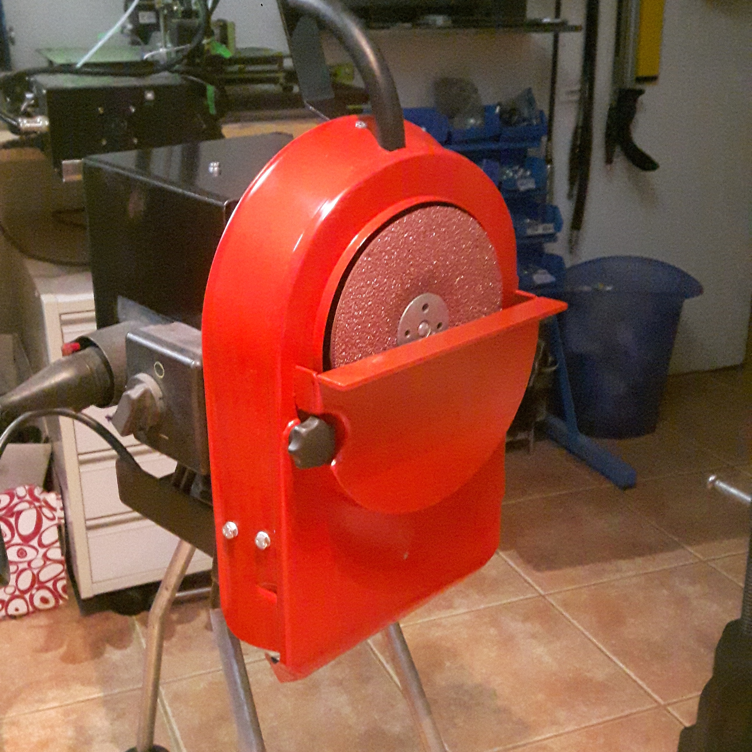

Turning crappy wood shredder to powerfull grinder / sander
Bought used wood shredder couple years ago.
Paid 30€ from it... after little use, i noticed
That this kind of cutting shredder ain't very usefull, specially with fresh wood, that i wanted to shred.
It was too slow in use, and got stucked too easily.
Stored it, and now i found better use for it.
It has 2000w motor and it runs 4000rpm.
That makes it pretty good grinder.
Attachment 25990
https://youtu.be/ZdHxi0XZSvM
Axle was originally with M22 thread.
Shaped it to M14. So that i could use it with angle grinder wheels.
