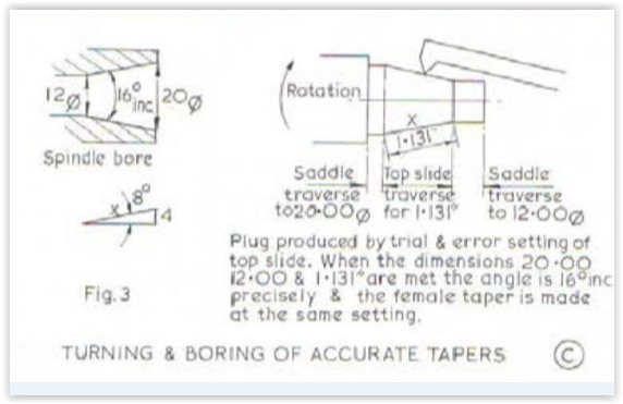

One of the many useful operations possible with a lathe is to cut tapers. These can be external or internal. Sometimes an external taper is cut and I want a matching internal taper. This article presents a procedure that requires no math or measuring to set up to cut the internal taper.
