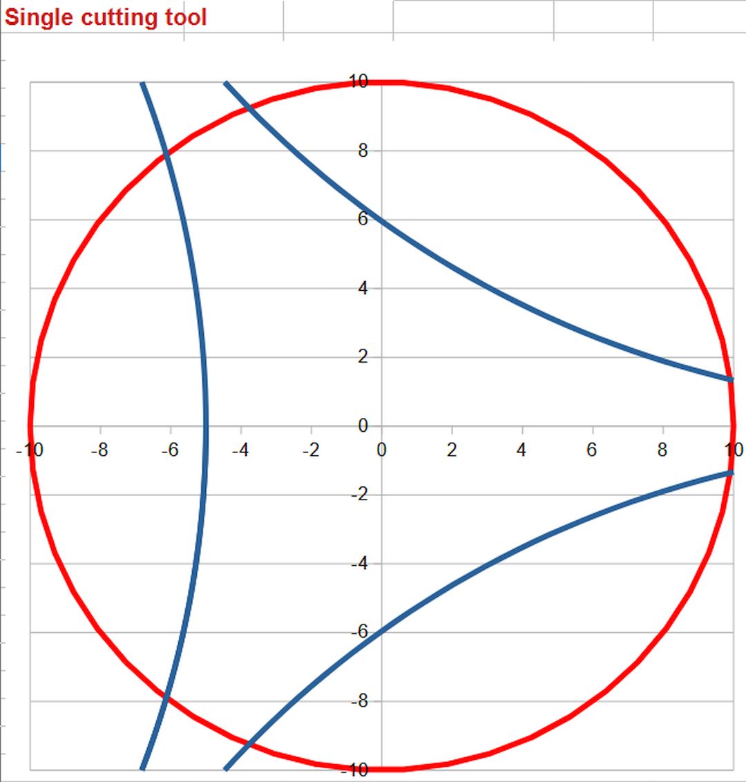

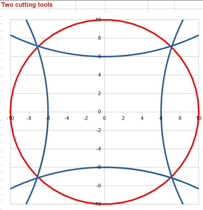

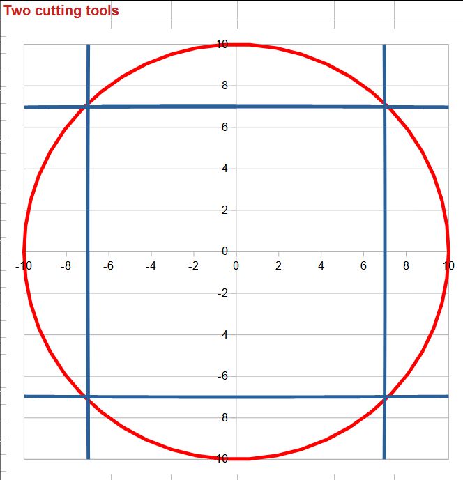

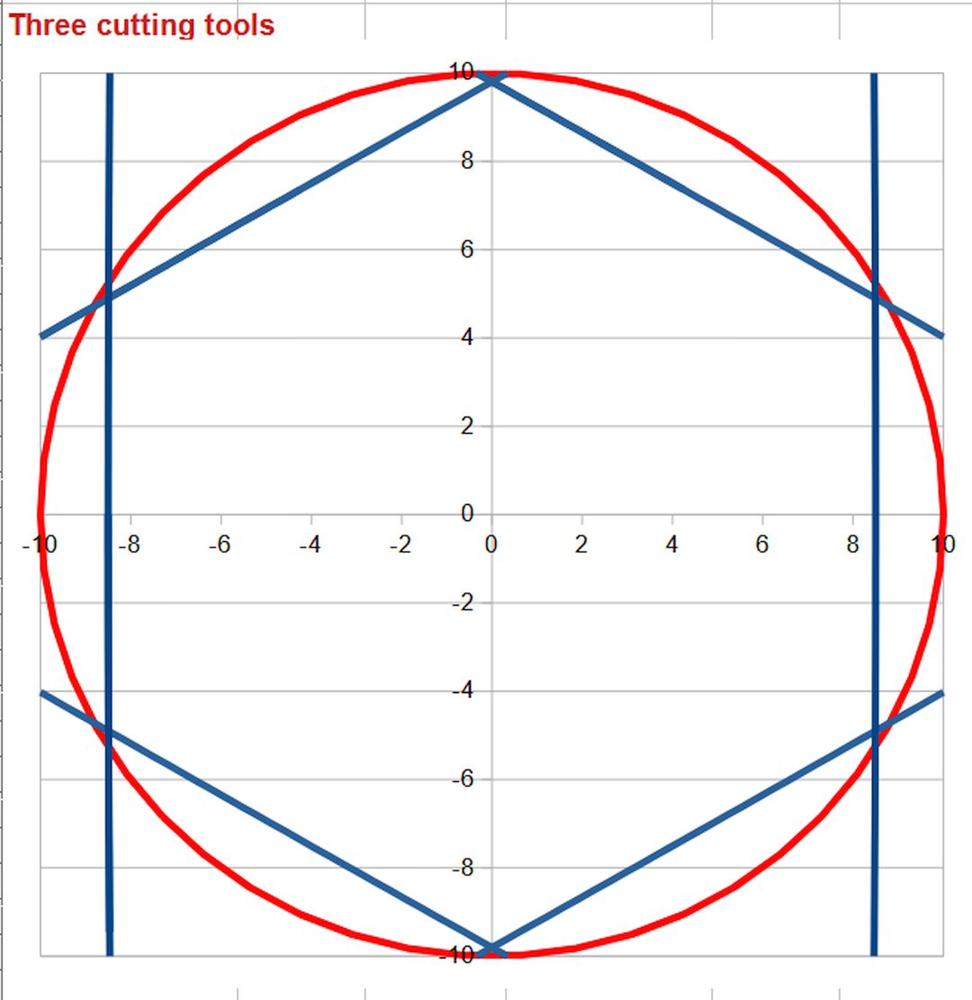

To satisfy my curiosity I needed to understand the mathematics behind this bit of magic. Internet searches came up with absolutely nothing. So I had to derive the expressions myself. I was expecting some complex geometry to solve but the reality is that the mathematics are very simple. I then prepared a design and understanding tool in the form of a spreadsheet to draw the shapes that could be made and that can be downloaded from https://diqn32j8nouaz.cloudfront.net...on_turning.xls.

Here are some sample images from the spreadsheet:

On the left is a hexagon formed with a gear ratio of 2 and 3 cutters on the cutting shaft. Workpiece and cutters rotating in the same direction.
On the right we see a gear ratio of 3, 1 cutter and opposite sense rotation.

Both of these 4 sided shapes are cut with a 2:1 gear ratio with 2 cutters, the only difference is the sense of the rotation, same sense on the left and opposite sense on the right.
