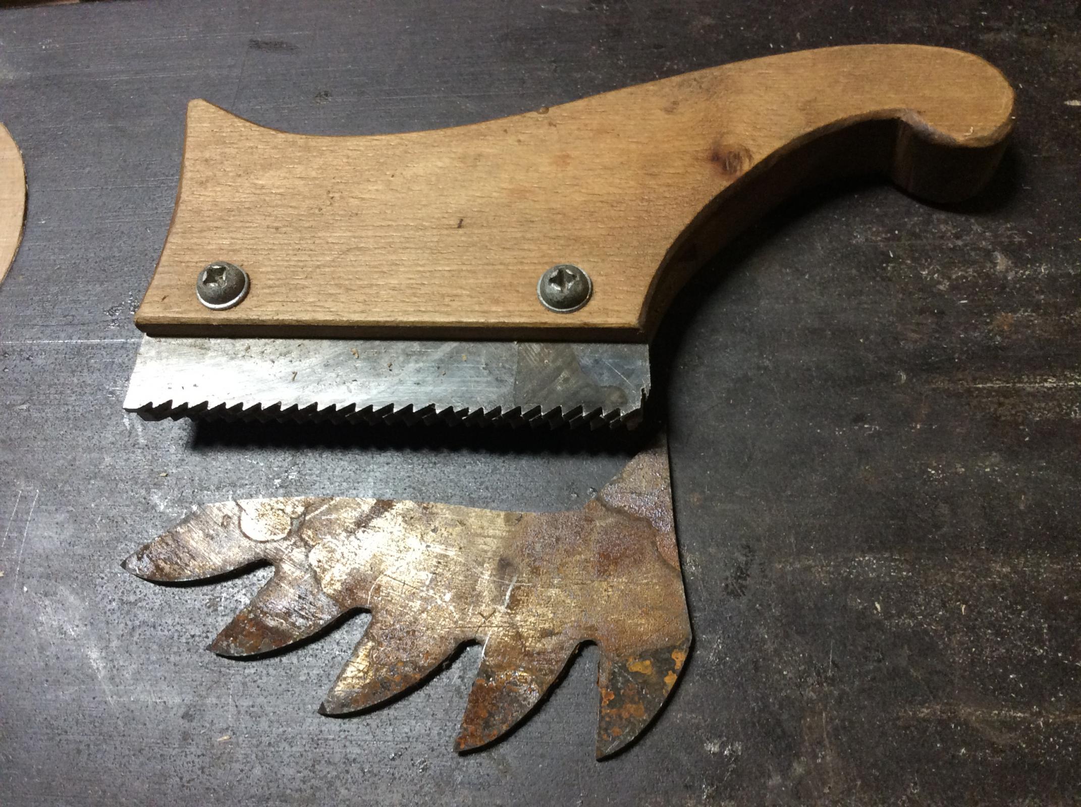

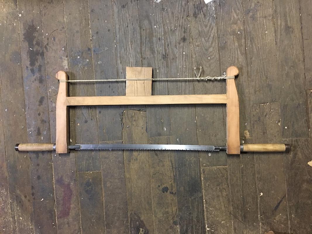

This is a saw frame I made in order to take advantage of broken bandsaw blades.

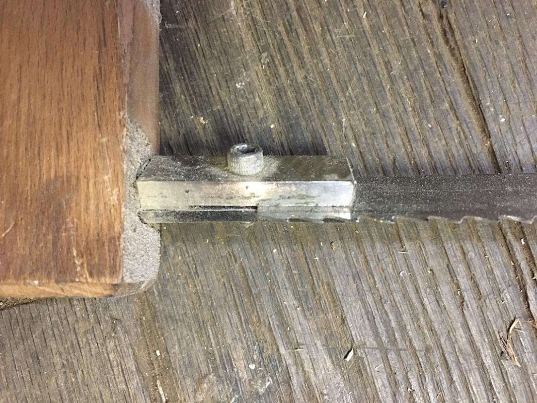

The blade clamps copy from small jewelers saws, with flat seats milled about halfway through the ends of long 1/2” carriage bolts that go through the handles. The 8-32 allen screws that tighten the clamps seem small but they hold great.
Attachment 27148 Attachment 27149

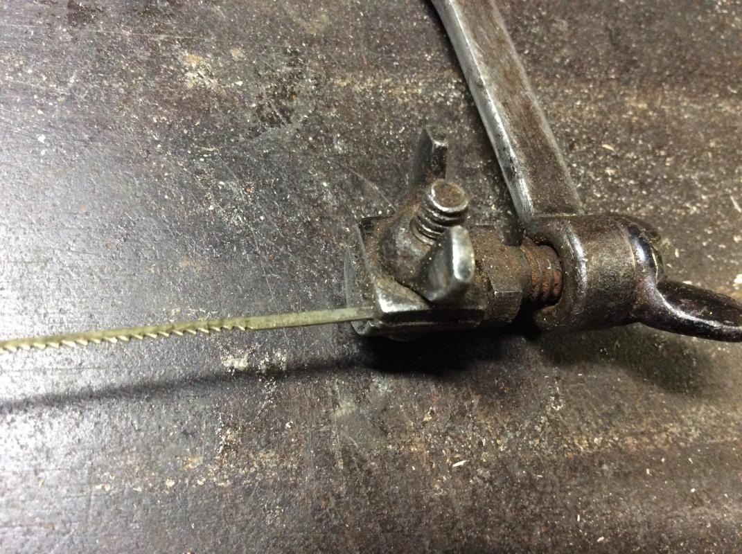

Jewelers saw clamp:
Attachment 27150
