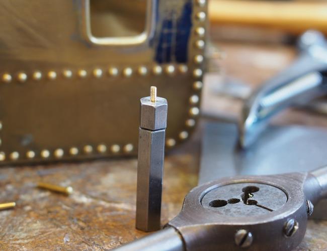

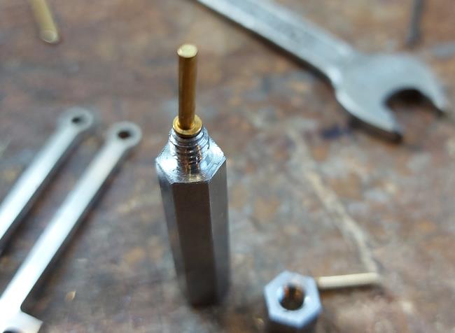

    This is actually all about making a small chuck to grip the head of the rivet so that I could apply a torque and cut a thread with a die.
    The concave dish is important as this grips the domed head of the rivet
    The rivet balancing on the anvil side of the chuck

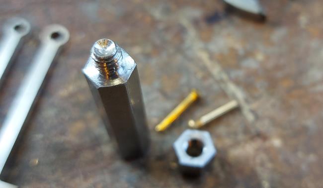

    The number goes over the shaft of the rivet and clamps the head against the concave form in the anvil side of the chuck.

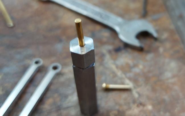

    I can then apply enough torque to cut the thread using a die.
    The interesting bit is that these rivets are just 1/16 inch and the thread is 10BA.

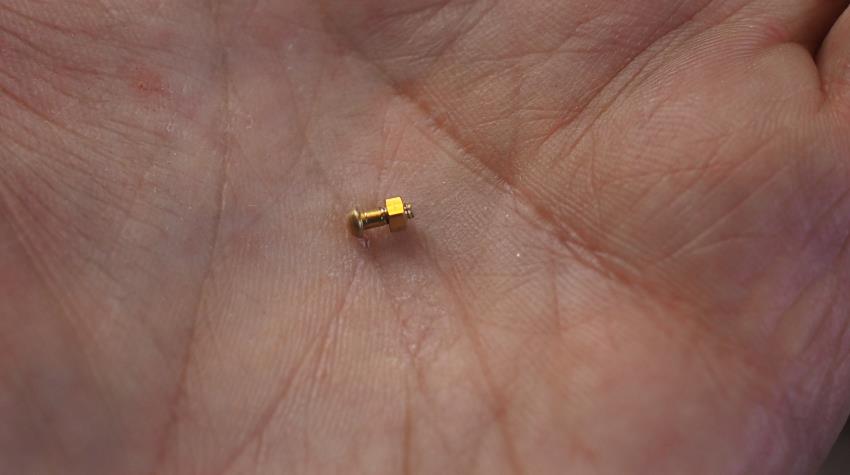

    This is all for the miniature Burrell traction engine and allows me to temporarily bolt where rivets should go. They are rather fiddly nuts and bolts though

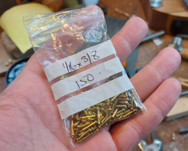

    What size are the rivets you start with, any chance of a photo of the box the rivets come in please ? :-)
    Supporting Member editor@glue-it.com's Avatar
    Apr 2017
    UK
    291
    40
    Thanked 524 Times in 146 Posts
    editor@glue-it.com's Tools
    Quote Originally Posted by greenie View Post
    Hi, an image of a packet of rivets:

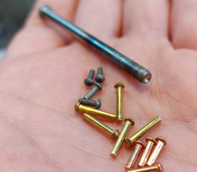

    The calculation for the rivet length is important, I use 1.43x diameter, calculation is here
    These rivets are available in brass, copper and iron from EKP Supplies. Some 1/16th inch rivets shown here with my homemade punch using hardened silver steel
