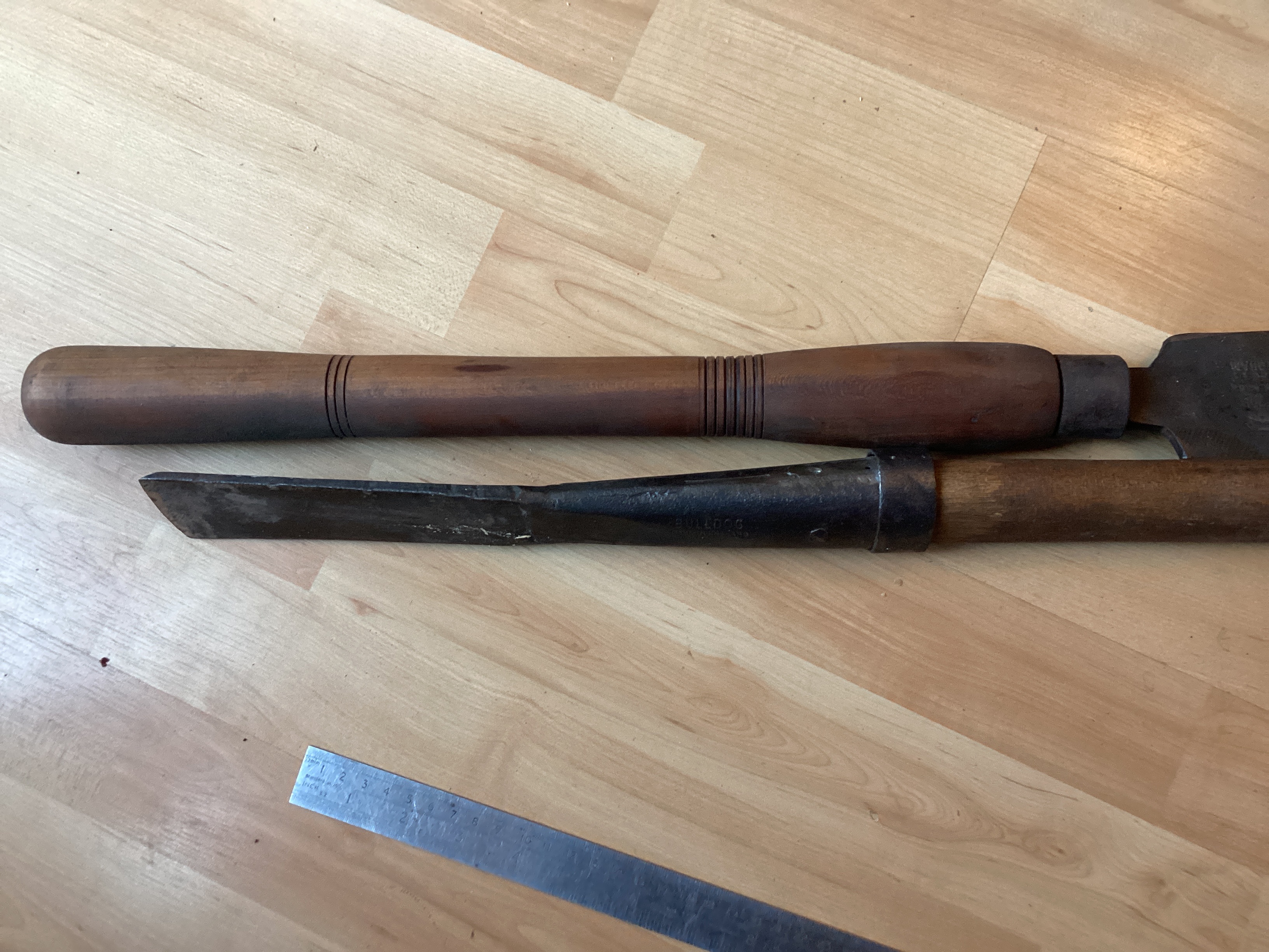

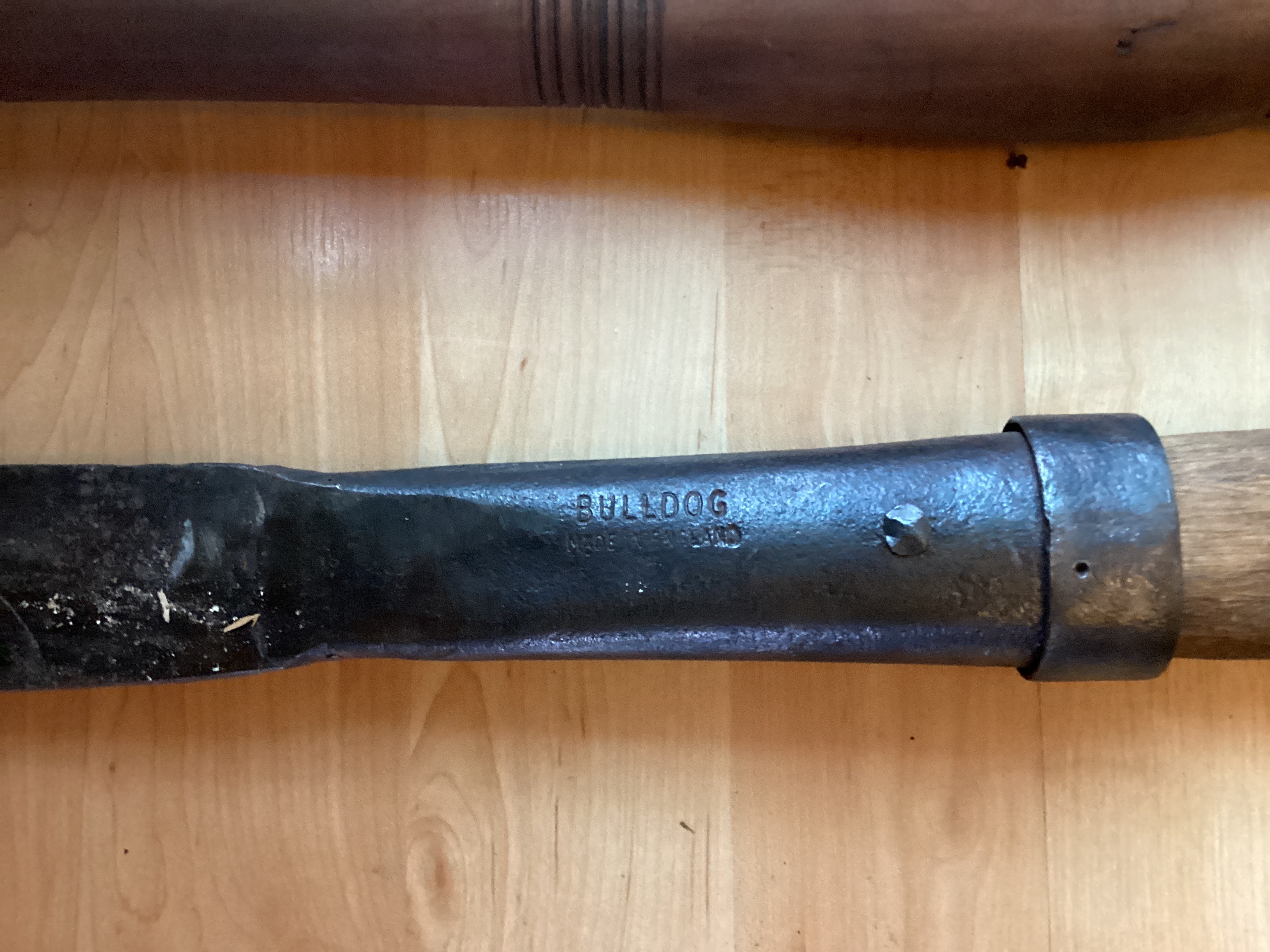

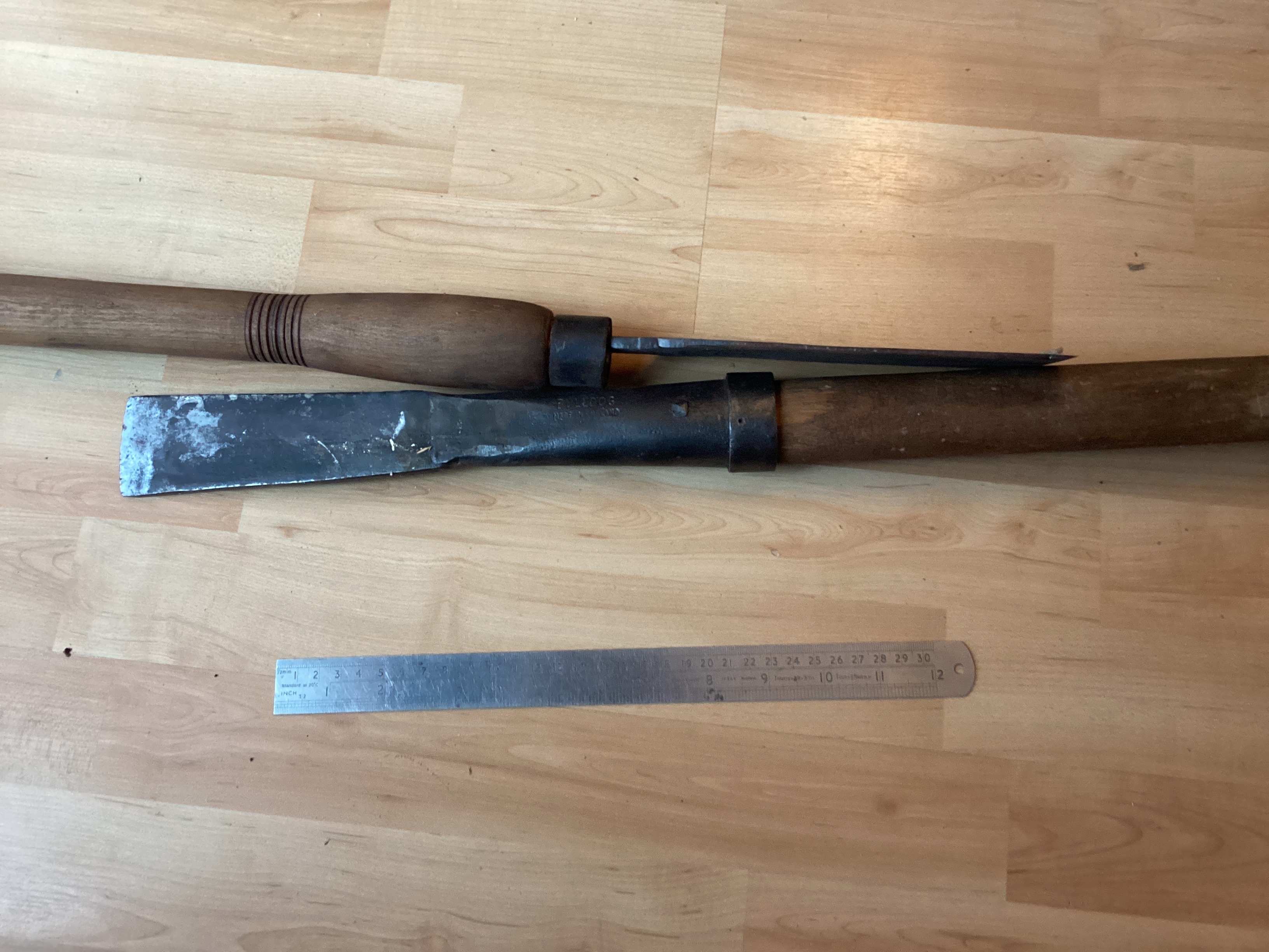

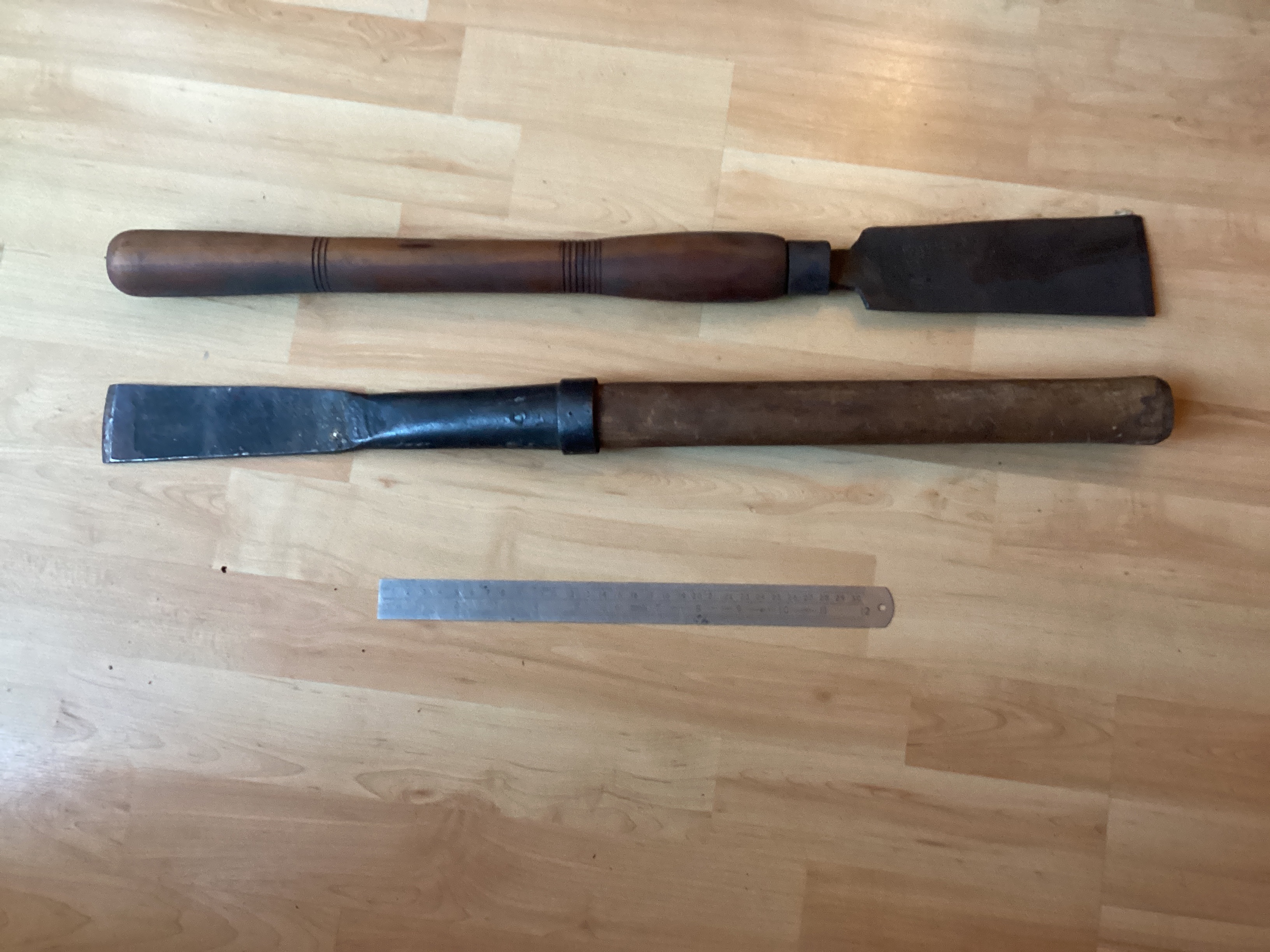

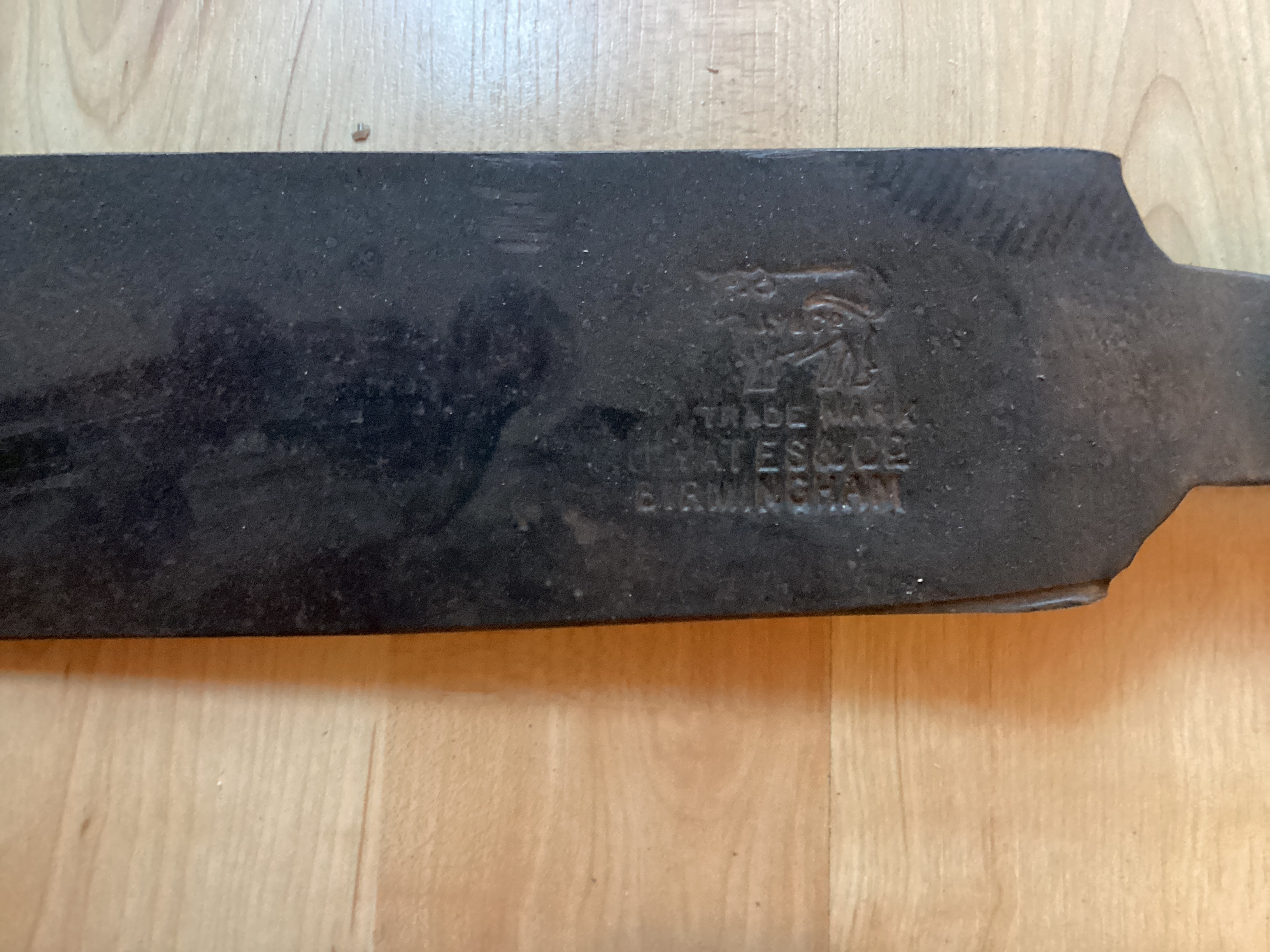

Two slicks
Attachment 48717
Attachment 48718
Attachment 48719
A slick is a broad chisel, used by shipwrights and timber framers, I understand.
These were made from discarded billhooks.
Attachment 48720Attachment 48721. Good steel! I bent the socket one at a red heat so it lies flat. The handle is hickory from a broken sledge hammer handle. The chisels were cut to shape with an angle grinder.
They are a sort of thrust axe.
