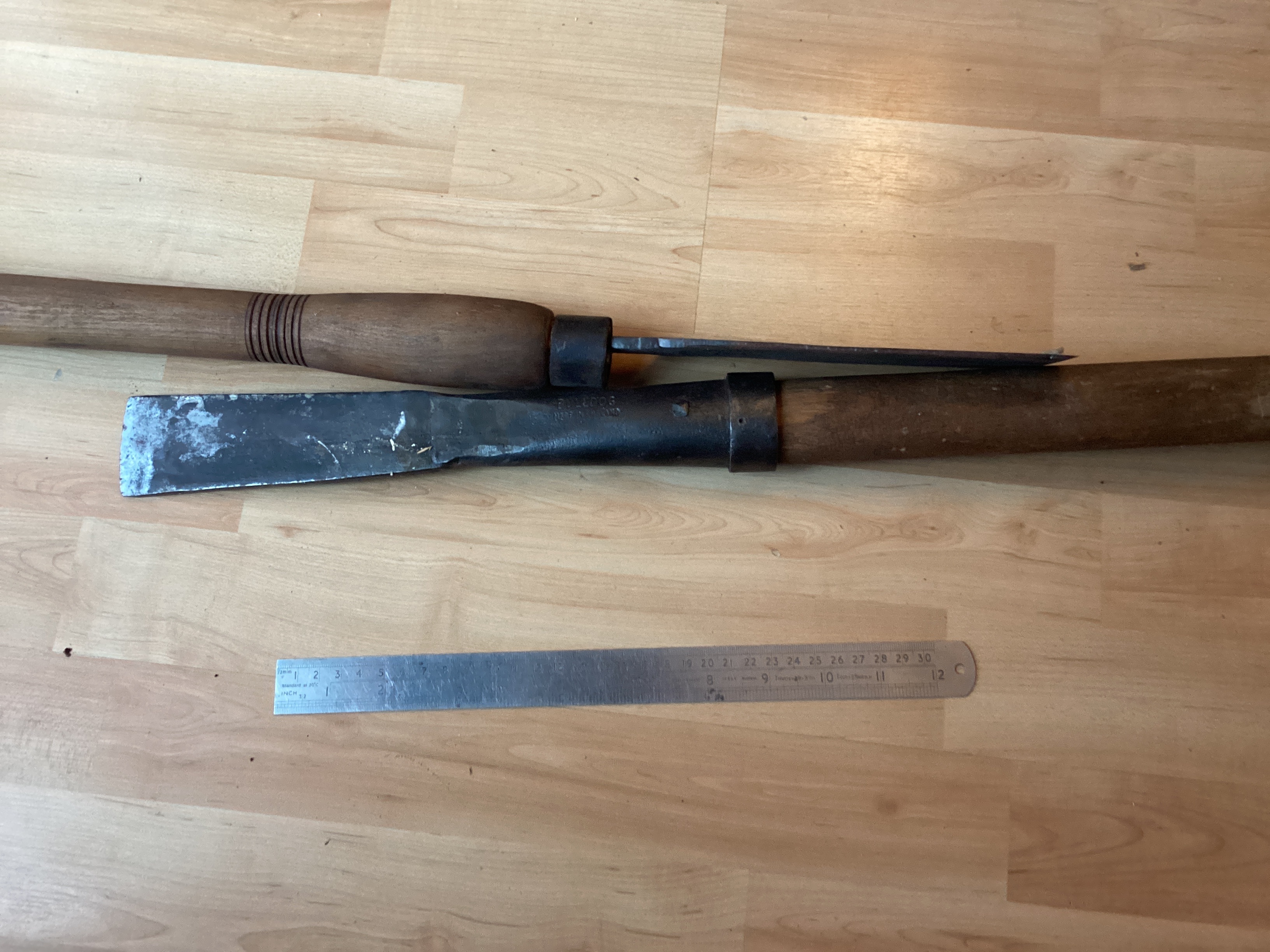

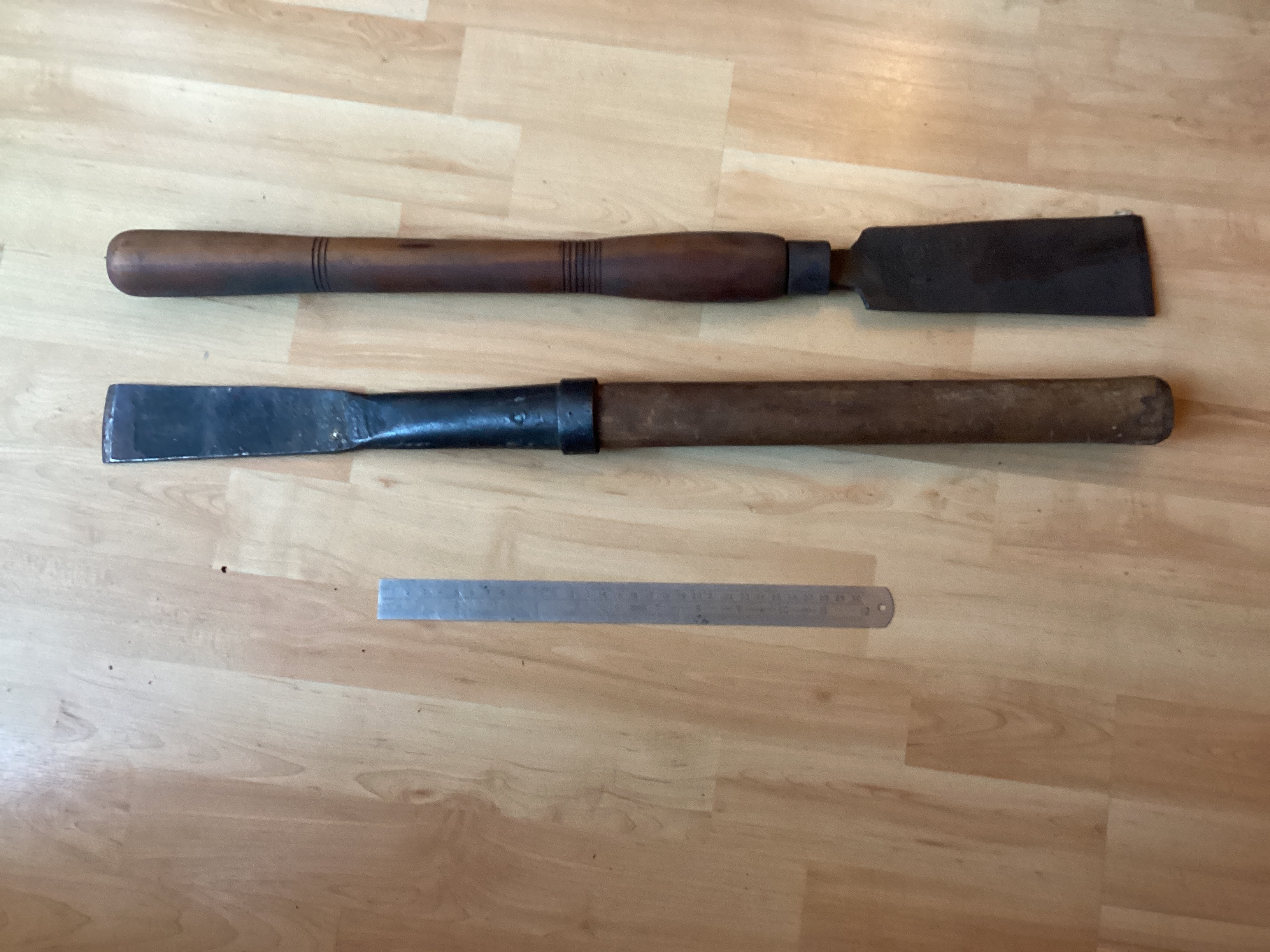

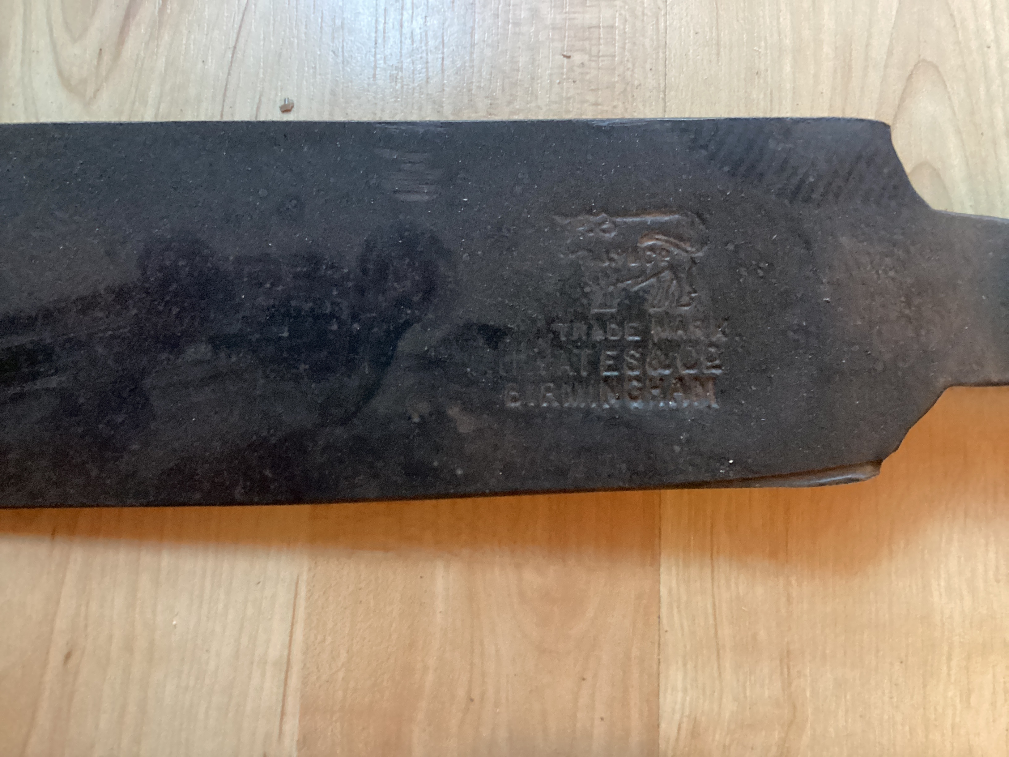

A slick is a broad chisel, used by shipwrights and timber framers, I understand.
These were made from discarded billhooks.
ID:	48720Click image for larger version.

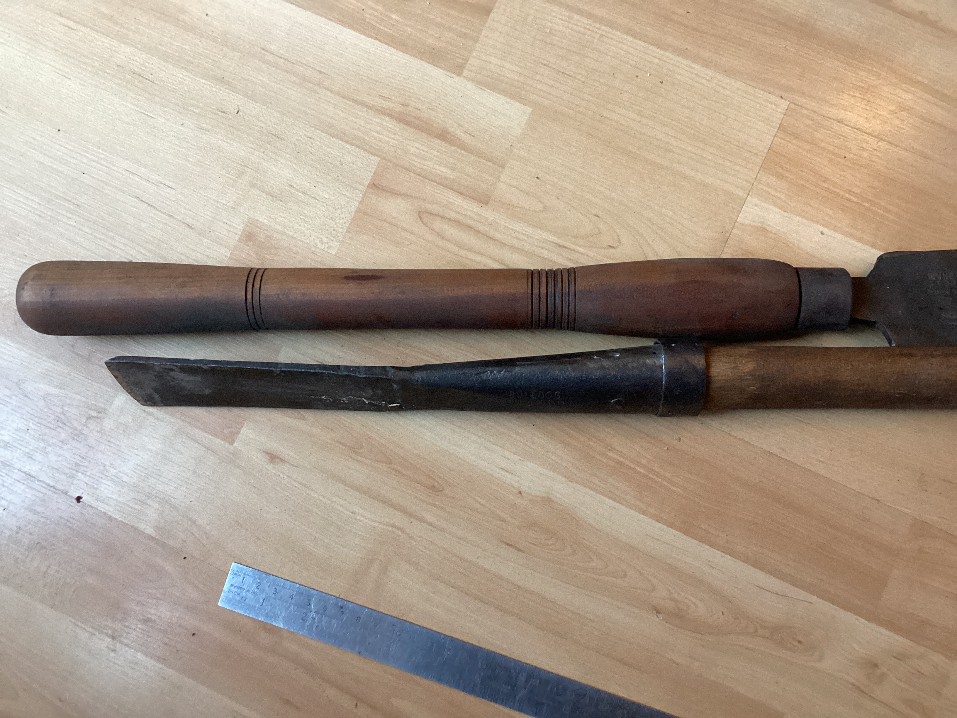

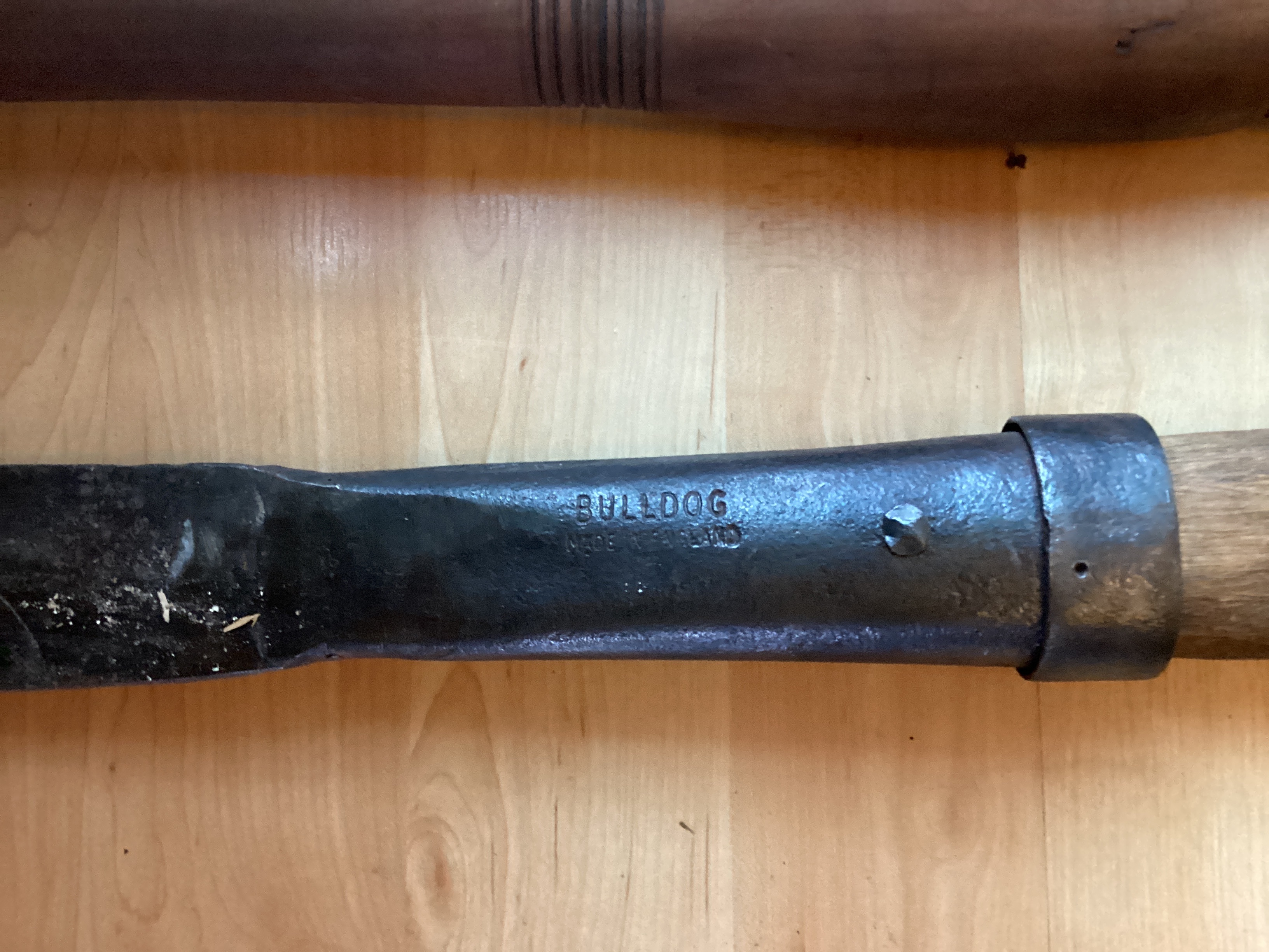

ID:	48721. Good steel! I bent the socket one at a red heat so it lies flat. The handle is hickory from a broken sledge hammer handle. The chisels were cut to shape with an angle grinder.
They are a sort of thrust axe.
