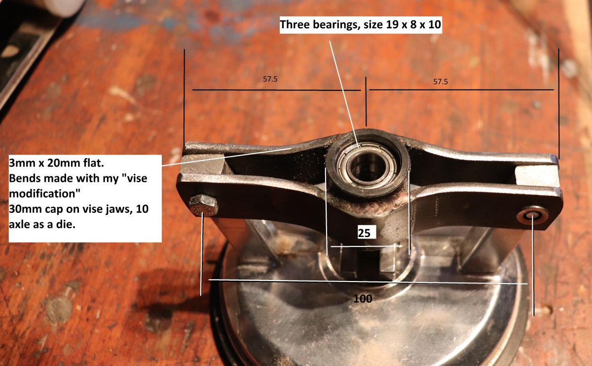

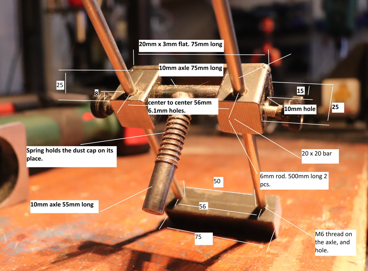

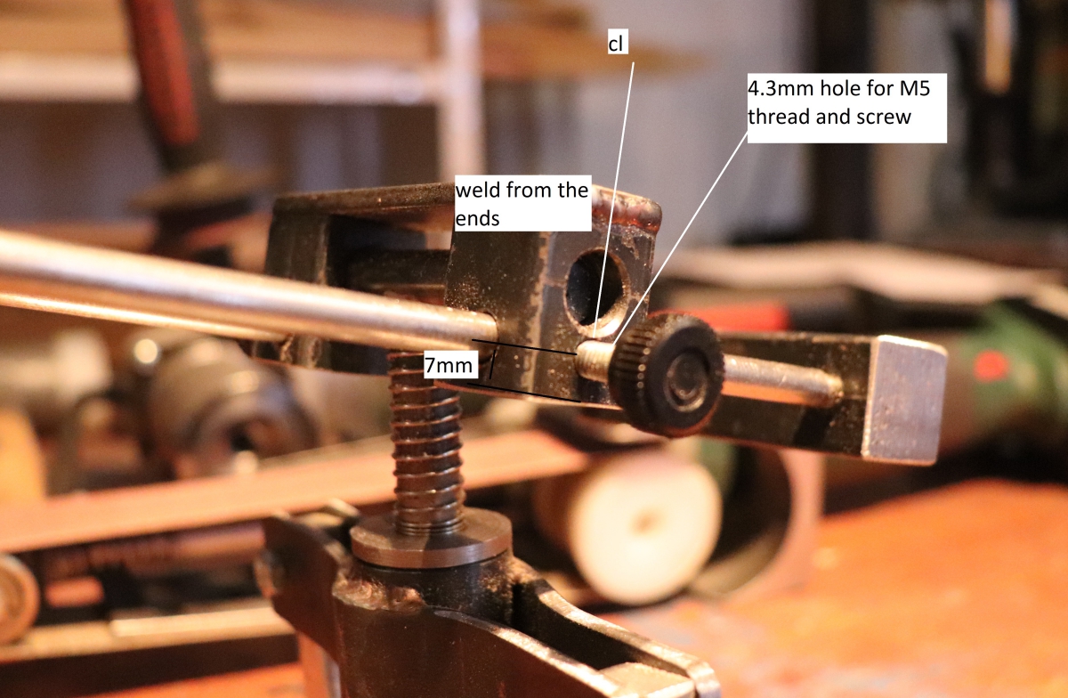

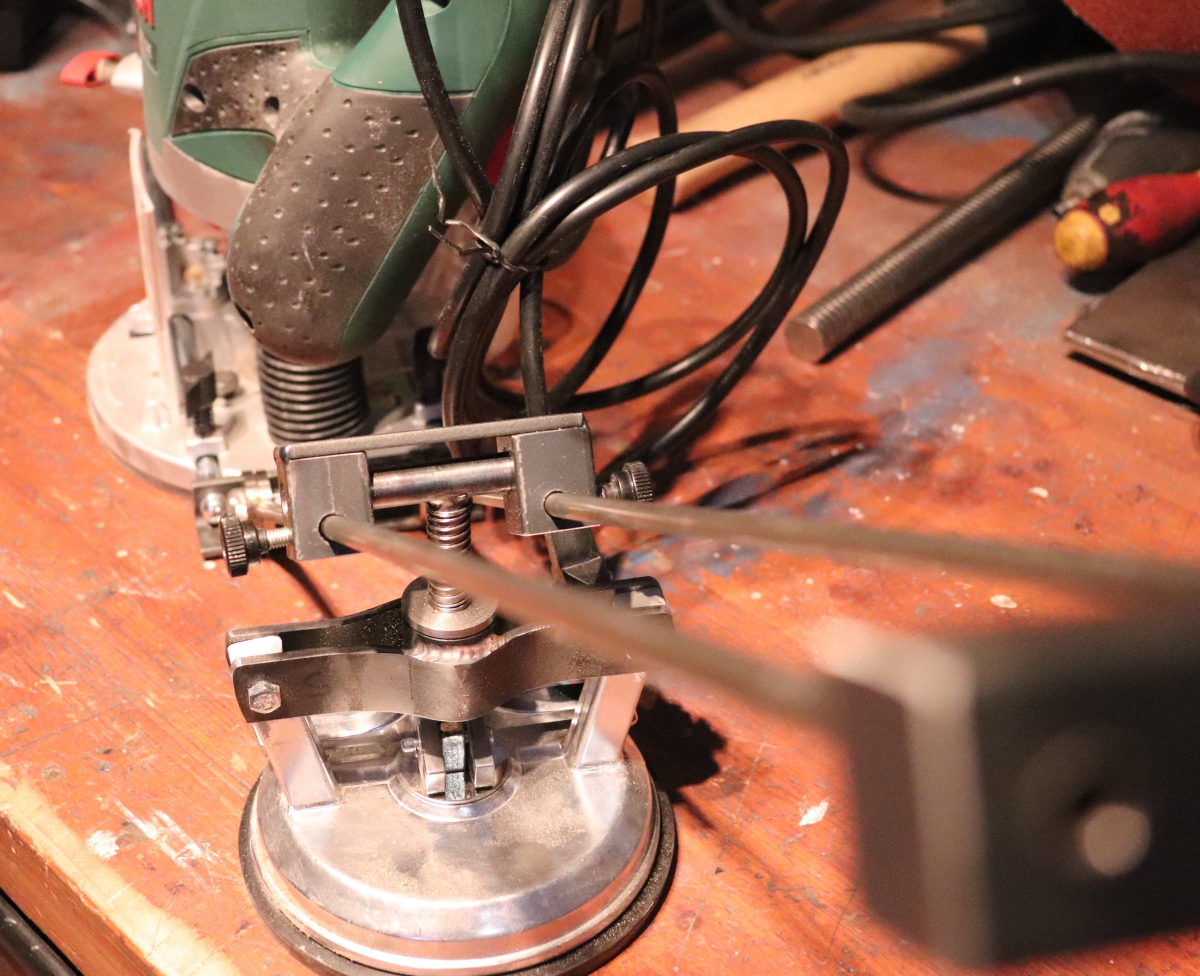

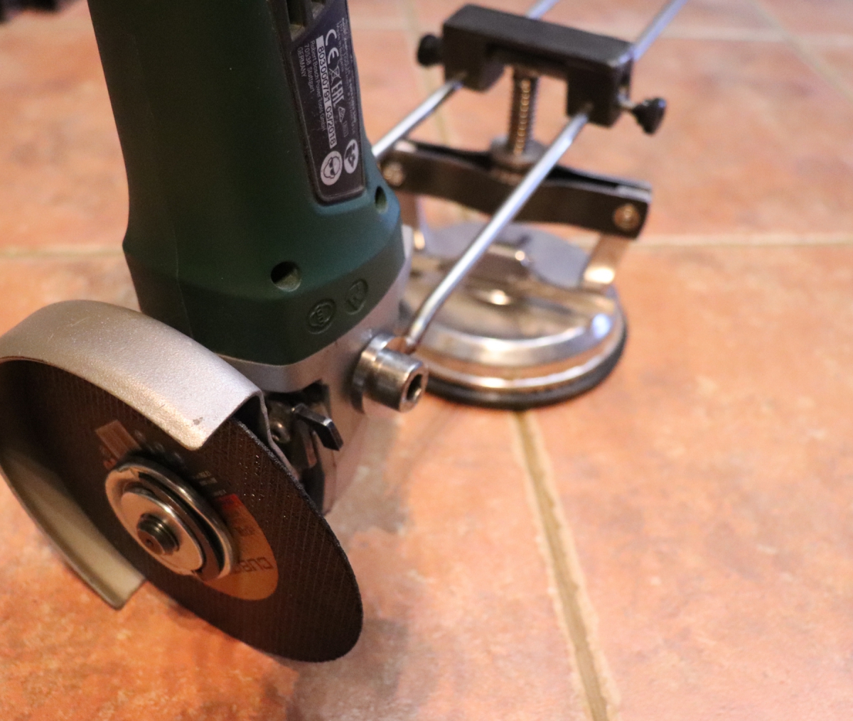

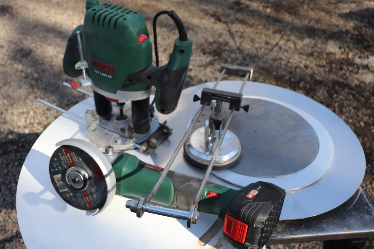

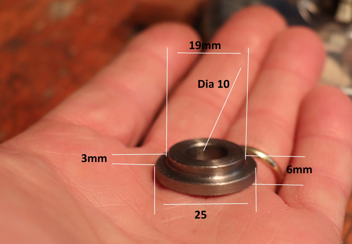

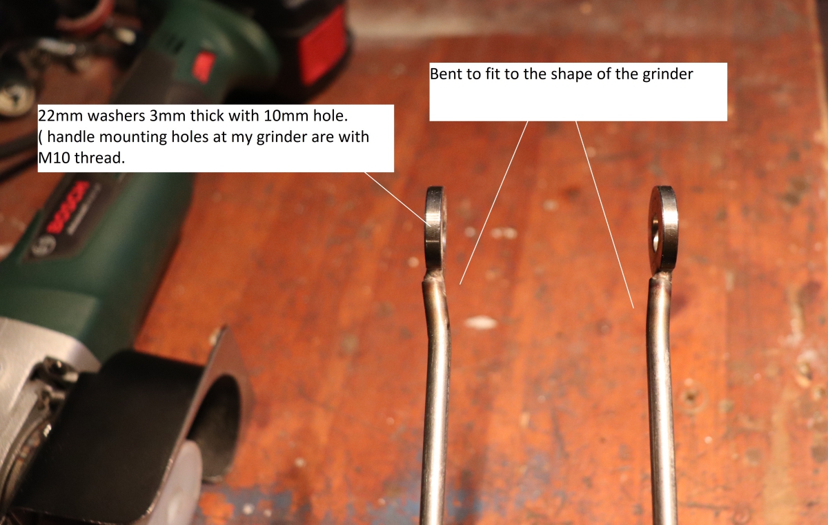

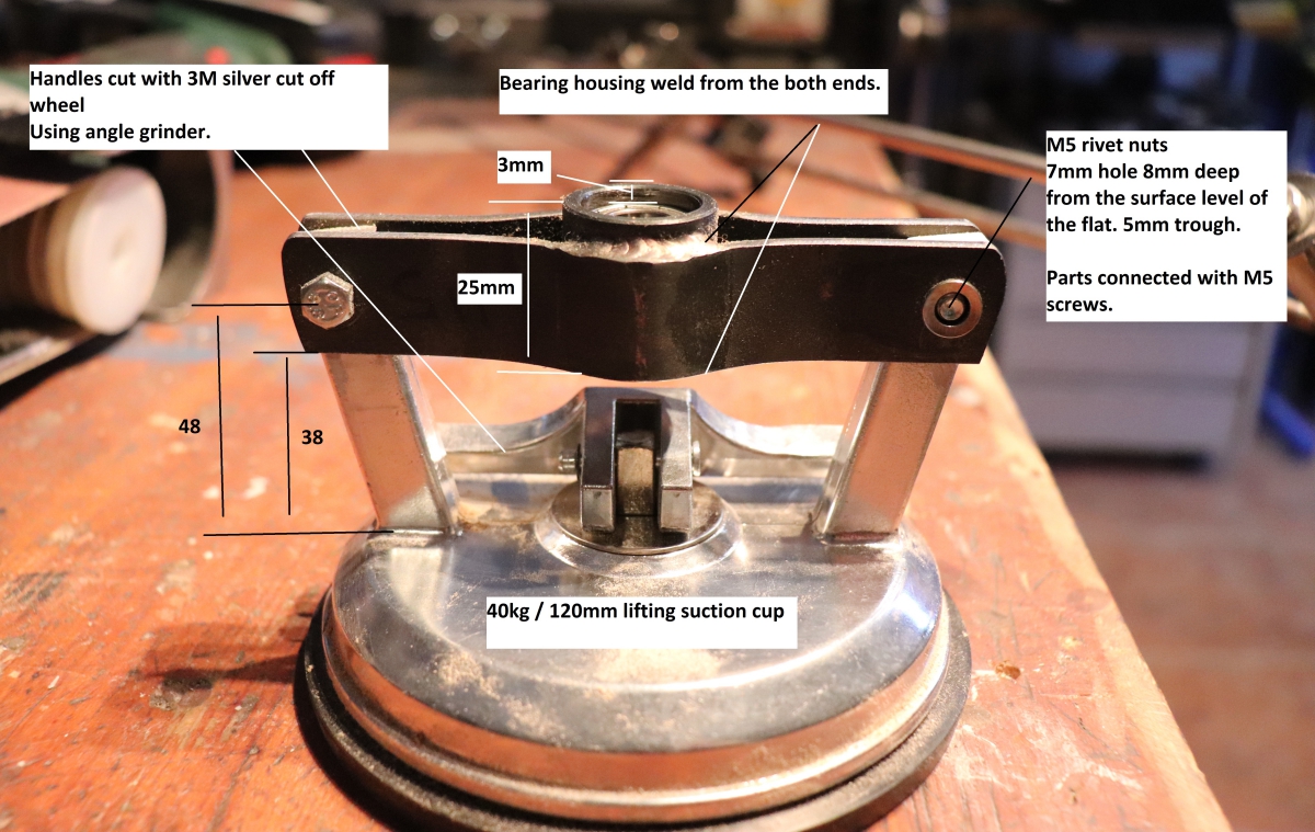

Made a new tool.
Its a circle cutting guide that can be used with non-ferrous metals too, also with wood.
https://www.youtube.com/watch?v=lThi...ature=youtu.be
Material cost about 17$
Made it as a prototype for a commercial manufacturing, but i tought i could share the idea with diy people too.
Actual commercial product will be little different, but the idea is similar.
10$ suction cup ( made for lifting windows etc )
https://www.motonet.fi/fi/tuote/765143/Imukuppi-nostoon
Three bearings and surplus steel.
Attachment 29123
