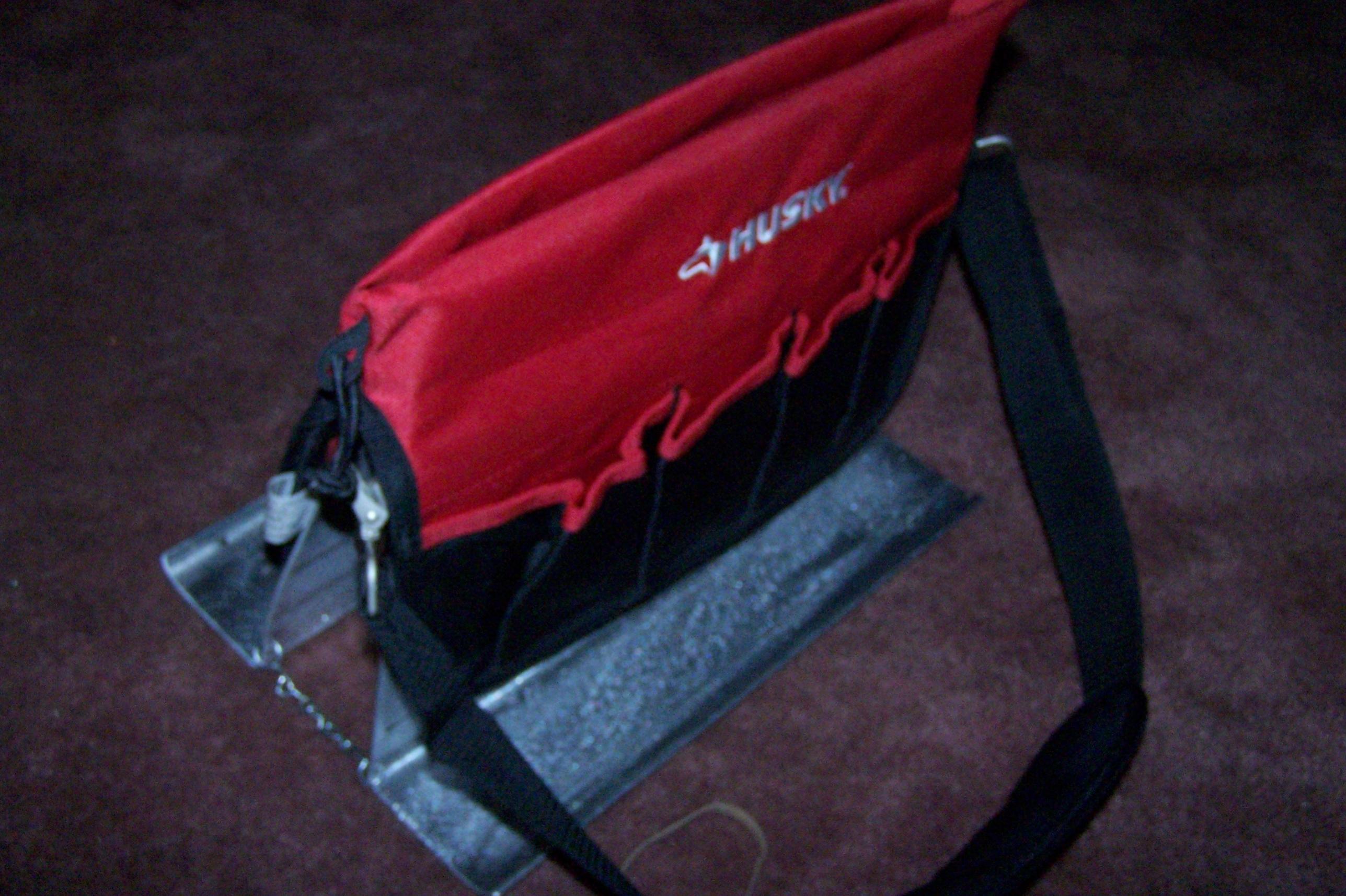

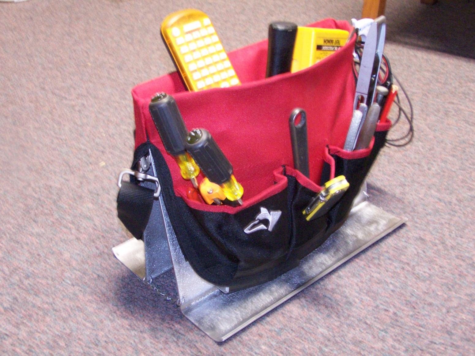

This commercial tool bag is sized for 3 gallon buckets. In my mind, 5 gallon size too deep for this. Heck, I'm only 5'7''.
I like the bags; lesser thrilled with buckets. Getting ready to go aloft (scaffolds for hardware and 14' double ladder for me) to pre-wire incandescent lighting; needs specific group of hand tools at the ready. So, here's my solution. Handy as C-Bag's shirt pocket.
1st thing is to be able to shoulder it - the climb is vertical! The ledges keep tools from poking your side. Used spare strap from laptop case; not euro shoulder bag! 99% of the time I'm there alone- Safety First! Not paranoid OSHA version, just common sense and experience, which of course is their downfall.
2nd, all the pockets remain accessible. It opens when set down, closes partially when raised. Two short lengths of jack chain restrain spread of the feet, otherwise could eject bag up and off. Fail! No rubber donuts or nylon skids. Nylon would be choice for counter-tops though.
3rd, needs stability, no interest dumping $180+ 15 feet even once. Again, I'd rather acquire additional tools, not replacements.
Drill motor, extension cords, walkie-talkie, digi-cam, drinking water, hardware/ fittings ride the Otis freight elevator. Well, clevis, pulley, clothesline and bucket, that is. Even wrote Otis on the bucket too, not one seen it gets the joke.

Nice one TM51! Wand Lit! LOL, your write up reminds me of Heinlein's saying about: "A human being should be able to change a diaper, plan an invasion, butcher a hog...." We all got to be able to take care of all kinds of things! I use totes quite a bit and think they are like my wife's purse...always too full and heavy enough to make you walk in circles. But that said a good design is worth the Weight! Nice! Like the computer bag shoulder strap idea...I save all those things and rarely use them except on trips. I'll have to post my Oxy/Map gas tote one of these days made from scrap acrylic...but doubt if it would survive a 15' drop. :lol:
Thanks for Sharing and the grins! ~PJ
LOL T51. I don't know about the rest of the folks here but actual tool and die makers are as mythical as the Easter Bunny and Santa Claus in my direct experience. So mythical as to lost in the mists of time and I have no idea what one actually looks like, much less wears. :) I think we all feel like toolmakers and it would be interesting to see how many actually do it for a living besides you. Just out of curiosity, when you registered did you take Toolmaker51 because 1 through 50 were already taken.? Inquiring minds and all that...
I've never been a big fan of those bucket pouches. They have always been a near miss. And mostly because of the bucket when I think of it. And the thought of wrestling one of those up a ladder.....double fail. I will do anything not to work on a ladder as they are so limited in their reach and I'm even more vertically challenged that you are. As scary as scaffolds are with their inherent wobbliness I'll go with that over a ladder just because there's someplace to put tools and covers more area.
I like your setup much better but several years ago I saw I think in Lowes they were selling tool bags of varied sizes that remind me of the old Doctor bags with pockets and a reinforced opening. I use them for everything now even for a small kit for overnight travel.
That's a nice stand you came up with, much better than a bucket! Two thumbs up.
