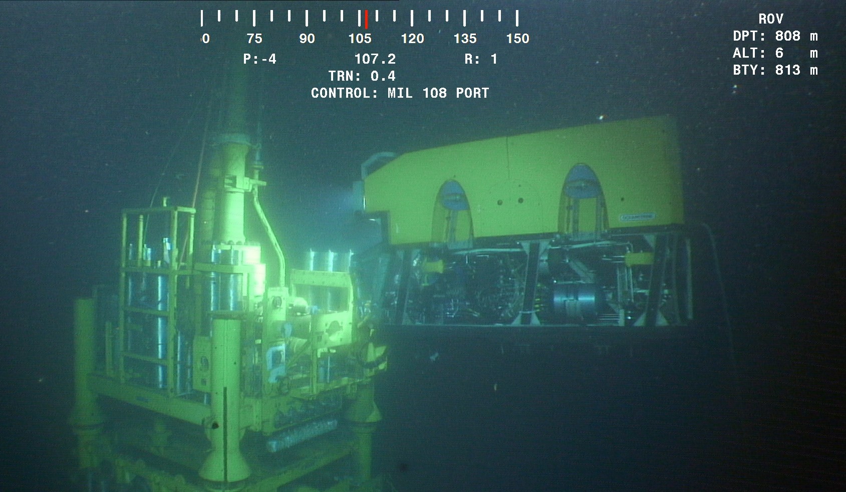

    And what it really looks like - in clear water obviously
    Smit are the boys, there expertise and sheer size of recovery is unbeleivable, they are taking heavy lift cranes to sea which would dwarf most land based cranes. The sea is not exactly a stable work platform and tends to be a bit spongy when you push weight down on it.

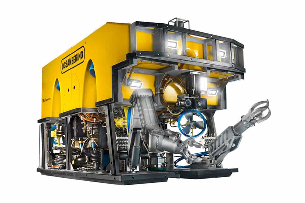

    What have I never mentioned ROVs,
    You know I built one, ok I can hear you all yawning.
    Yep these vehicles are the subsea vehicle of choice, just like divers they are hard maintenance and still complain but at least with divers on board the fridge is full of ice creams/cans of goffas and the fruit bowls are full of bananas. Energy food you undrstand. Not for ROV operators, yeah right.

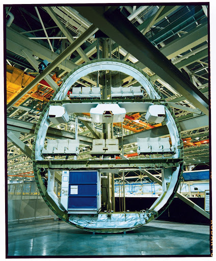

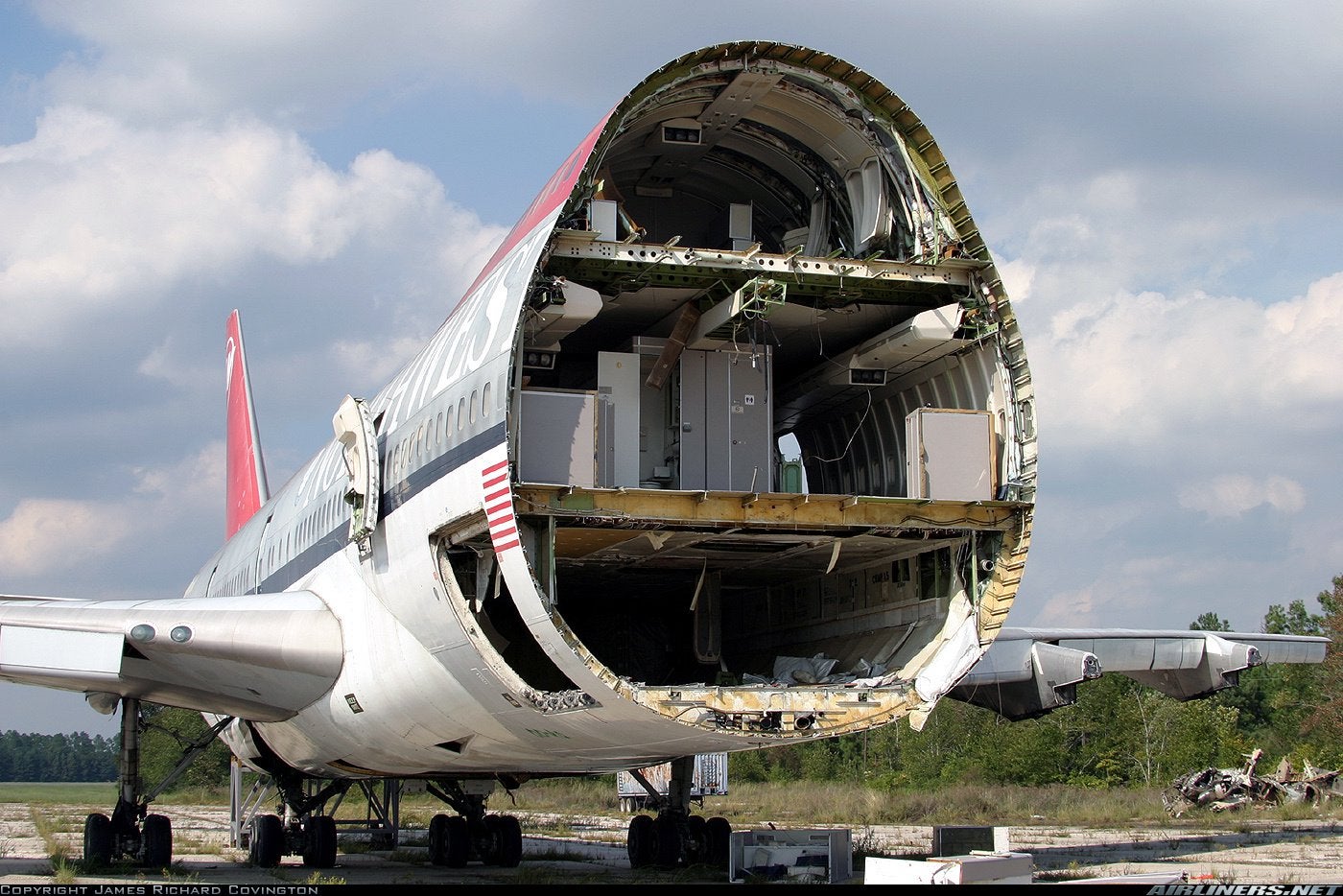

    The scary bit is we have a section of a 747 in the science museum in London its 2 rings of the body about 10 inches apart with a criss crossing diaganal spar section.
    you could snap this stuff with your hands - It is no suprise that the planes didnt make it all the way through the towers.
    This isnt the london section but
