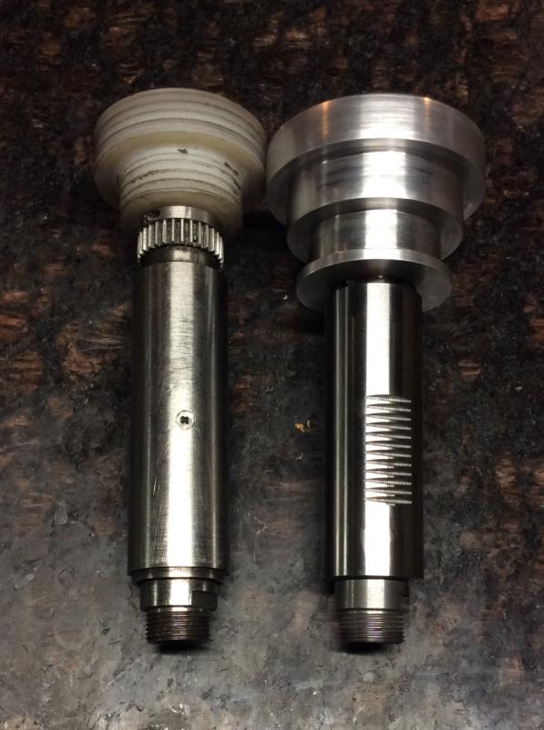

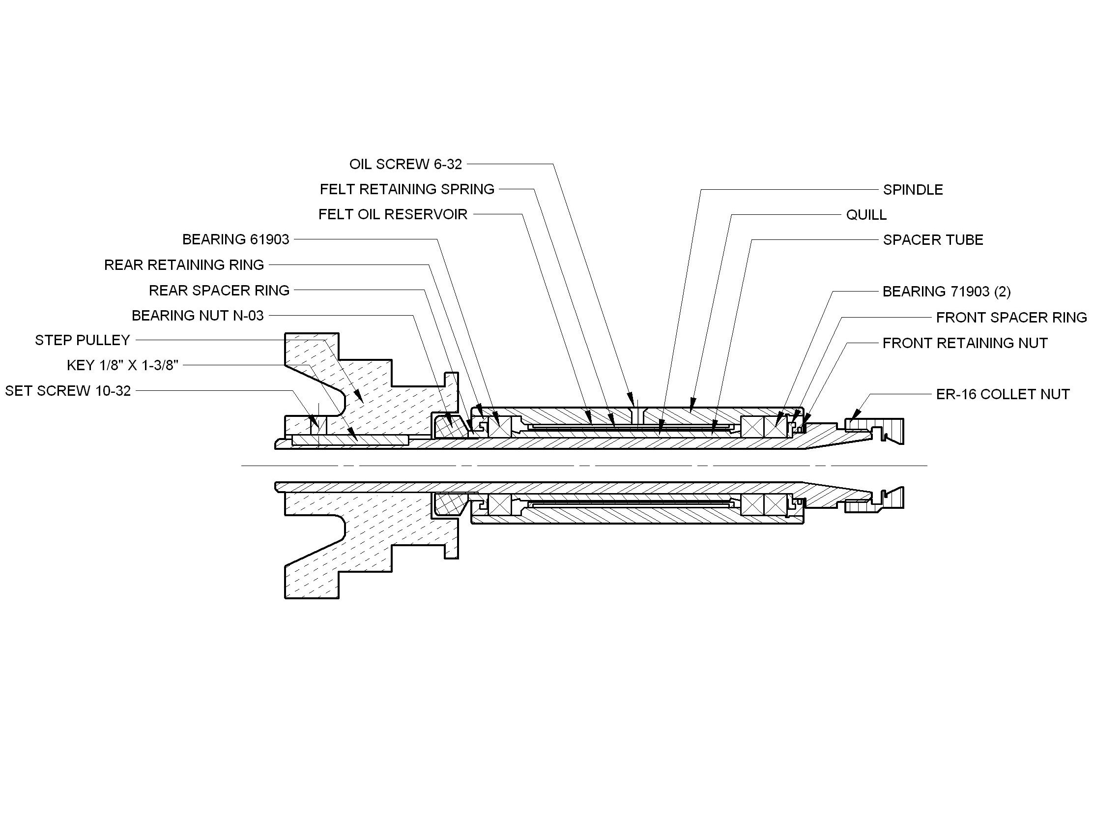

New Unimat spindles to use in different machines - one plain bearing for slower speed and bigger through-spindle capacity, the other, just completed, with ball bearings for higher speed.
Both take ER-16 collets.
Attachment 25066
Attachment 25067

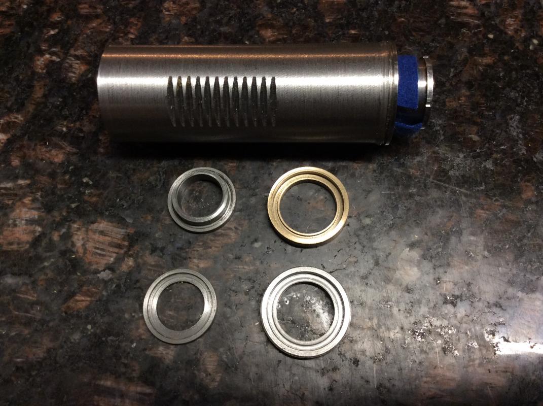

Ball bearing quill parts
Attachment 25068
Felt reservoir and labyrinth dust covers
Attachment 25072

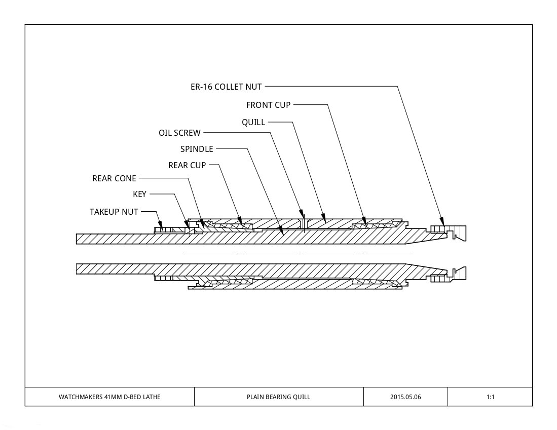

Plain bearing quill parts drawing
Attachment 25070

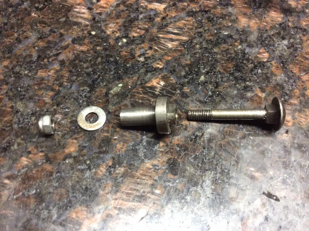

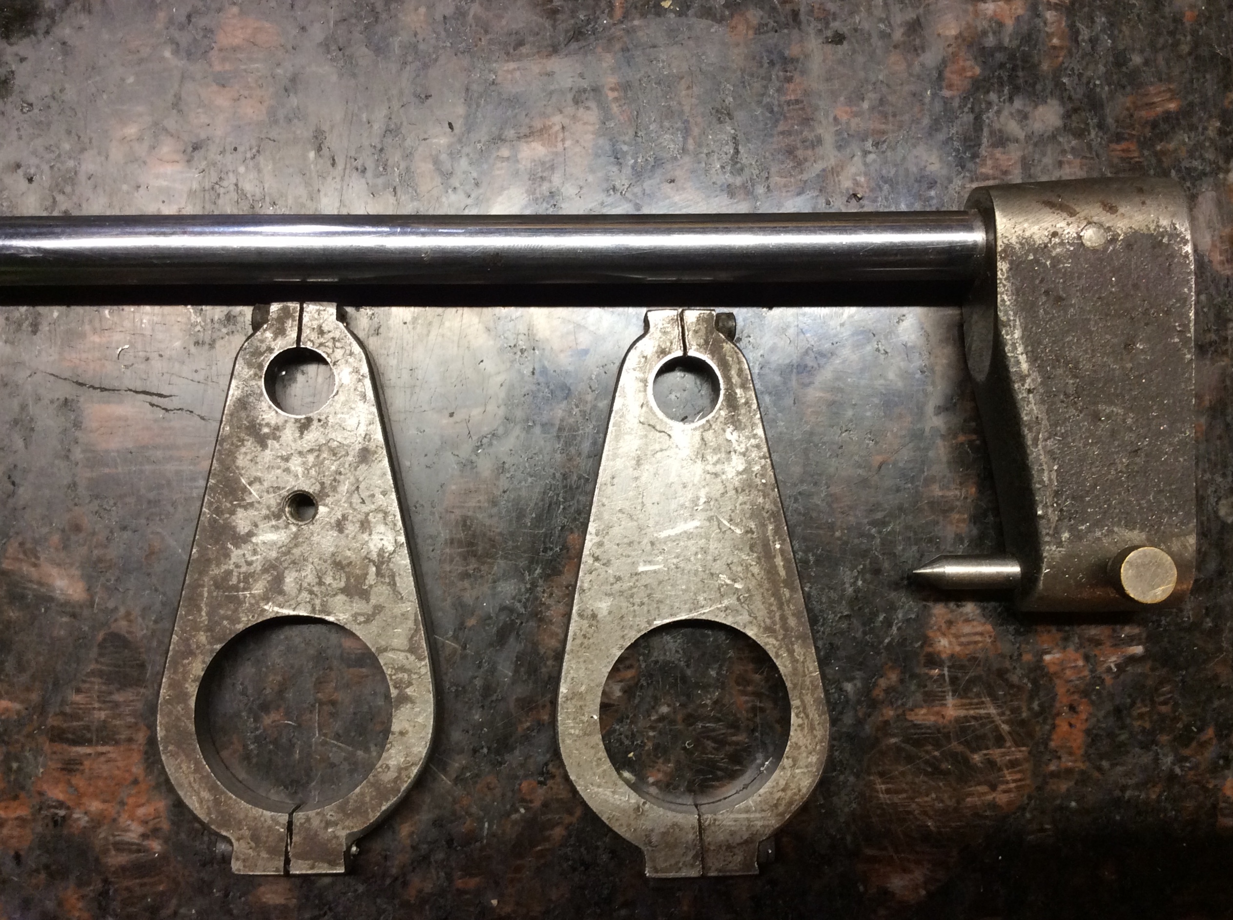

Single-nut movable change gear post for banjo

1 Attachment(s)

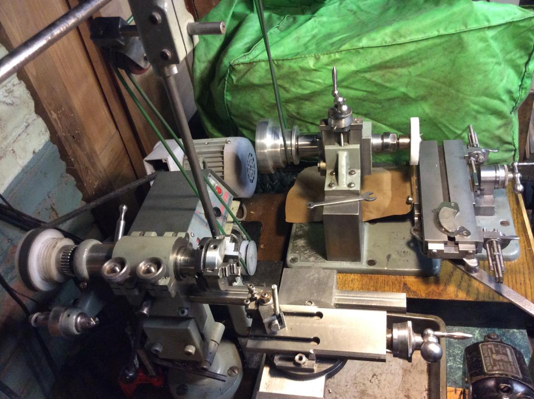

Both in use - they run a lot smoother than the original, partly just from separating the motors.
Attachment 25139

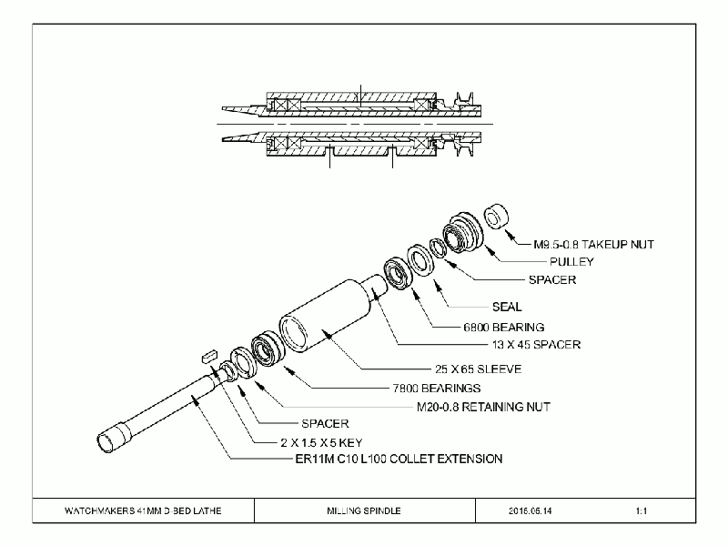

Ball bearing quill drawing

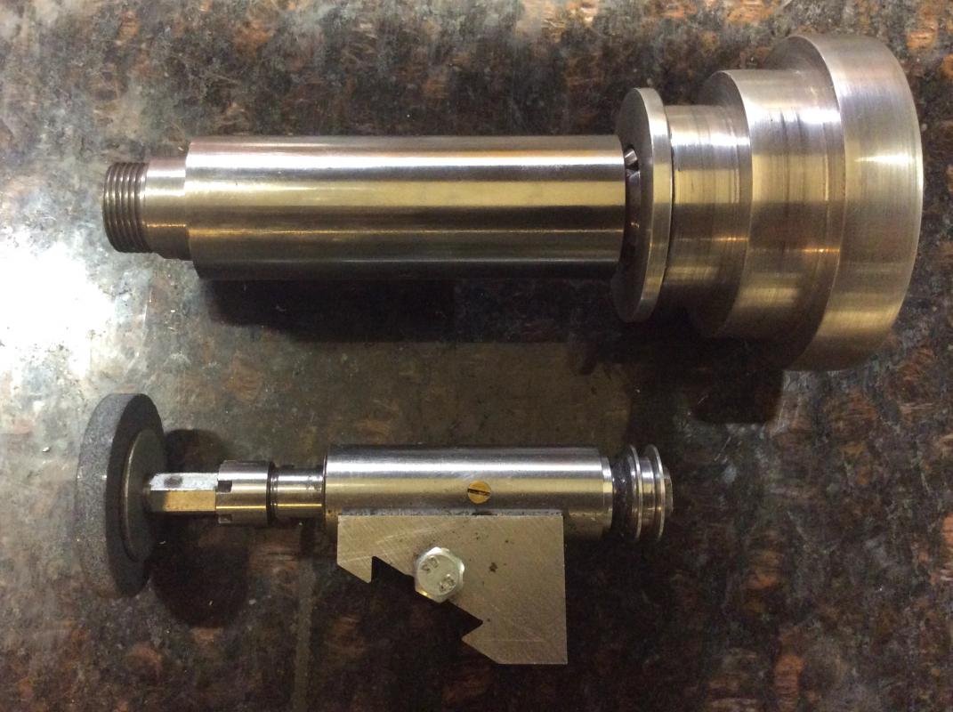

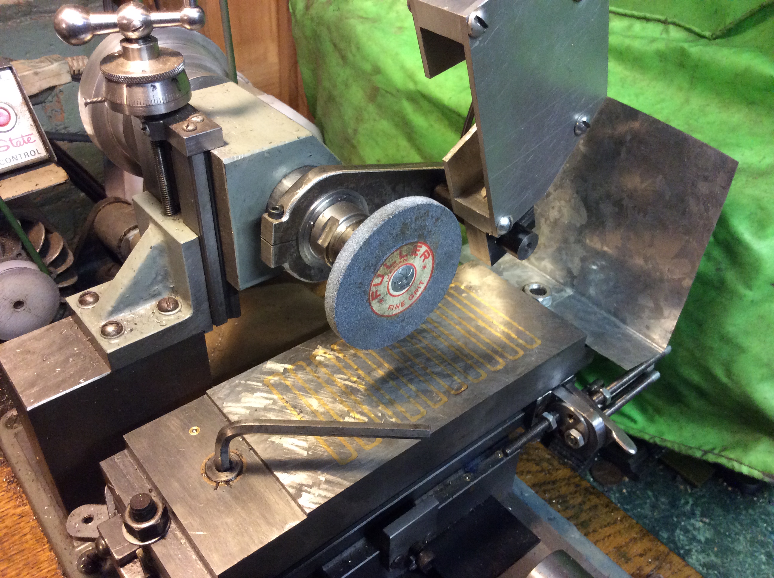

Same design ER-11 quill mounted as a tool post grinder
2 Attachment(s)
