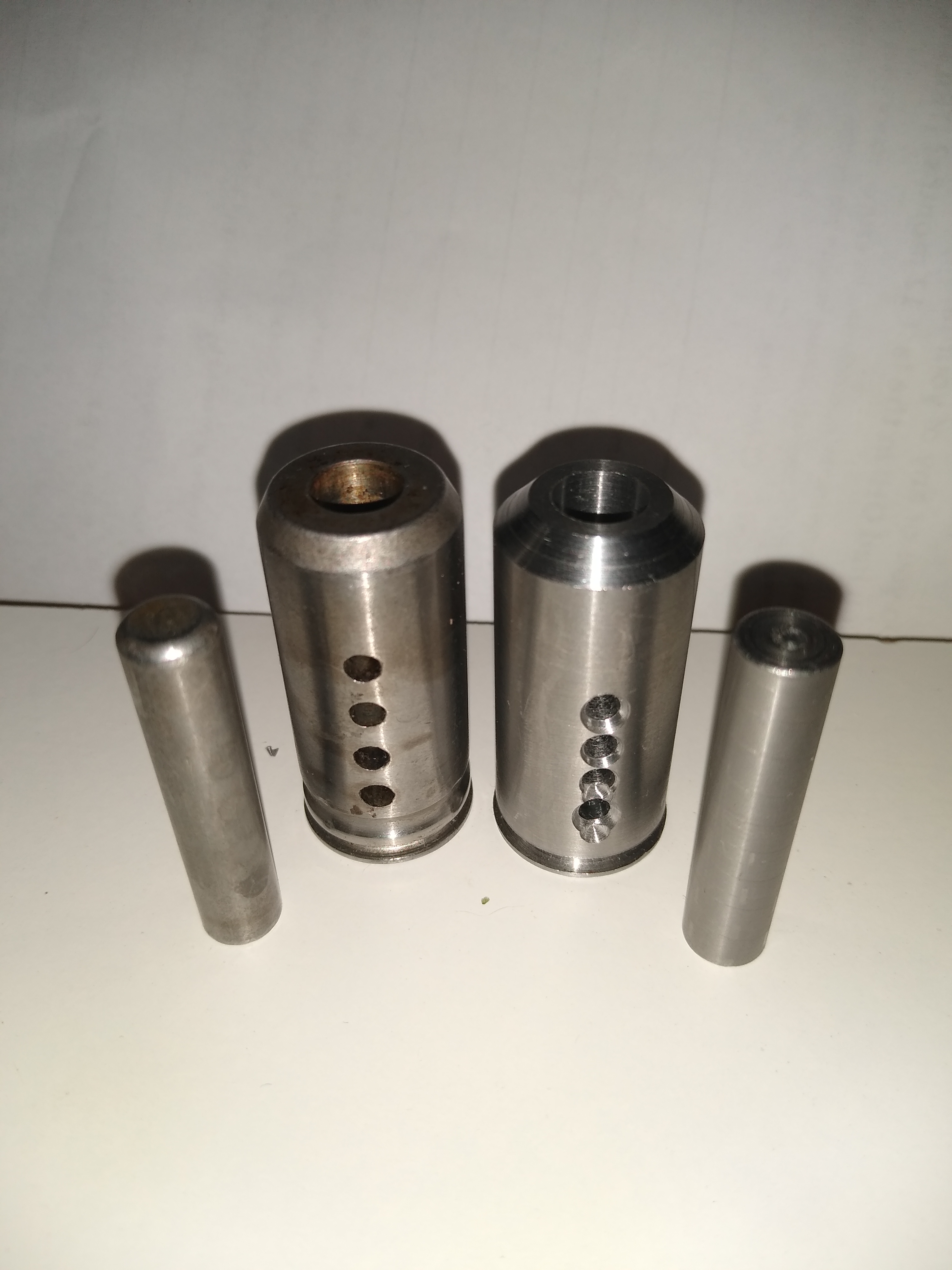

I hope to do similar work, as well! I have made a sizing die for a Lyman 450 lube and sizing press, as well. Attachment 45303
The die and punch on the left side is a factory original, while those on the right side are the ones I made. I have still not gotten to test it to see if I have gotten the size correct. It is supposed to be 0.3160", and is for sizing cast lead bullets for a Mosin-Nagant 91/30 model 7.62x54R rifle with an oversized bore. This was not done on a Unimat, however! ;) Though I believe it would be possible. I did not have the Unimats when I made these parts.

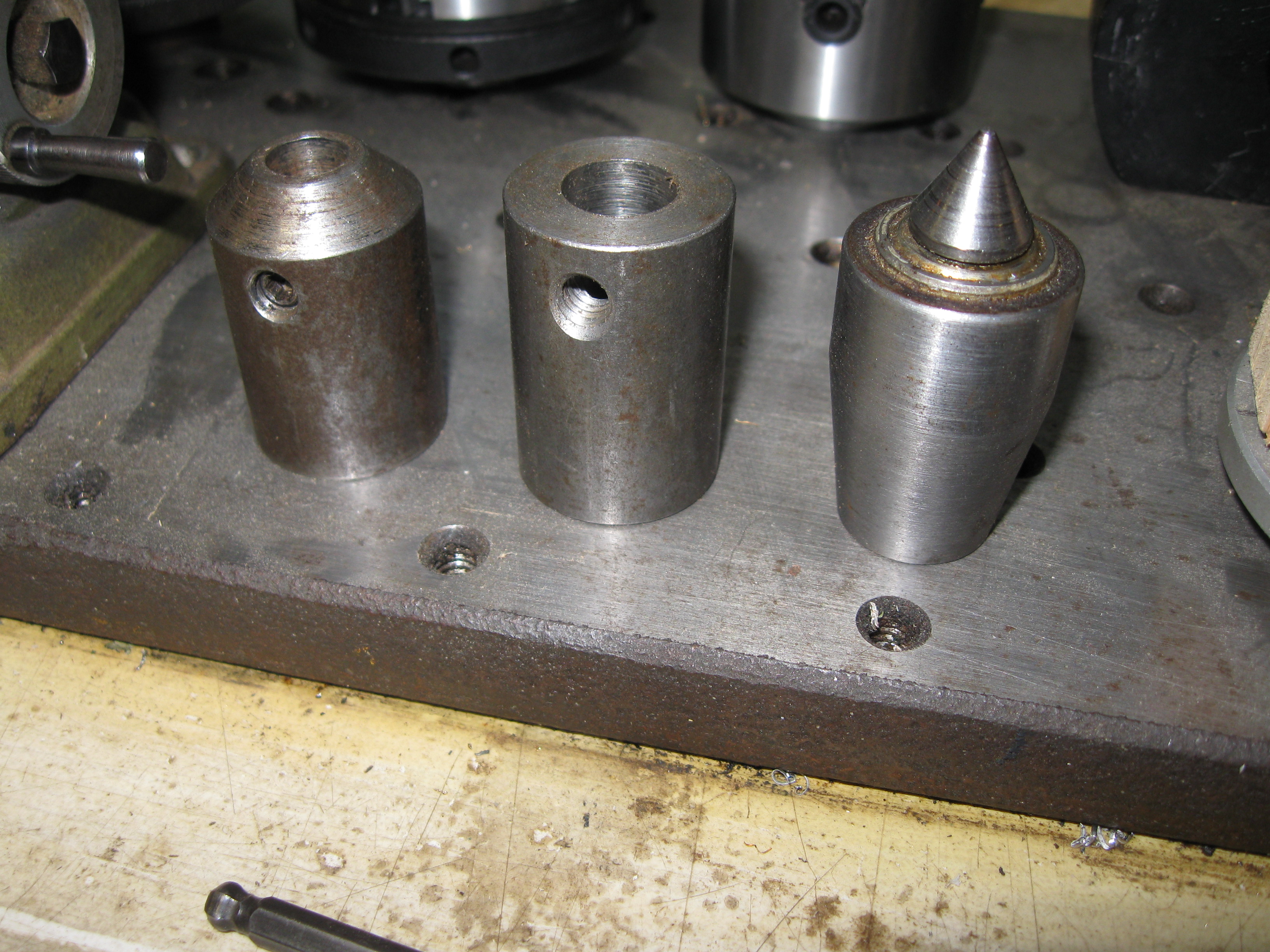

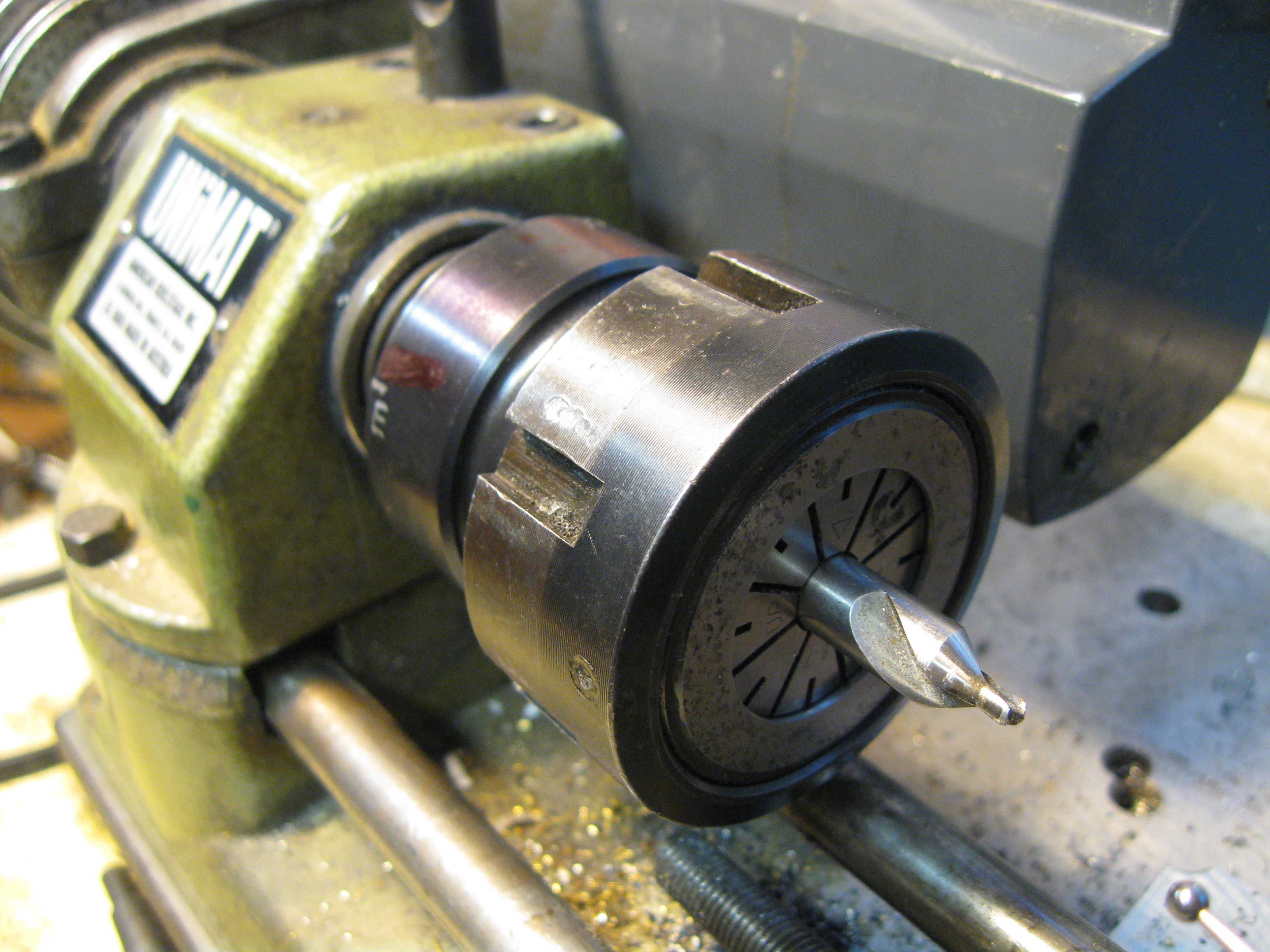

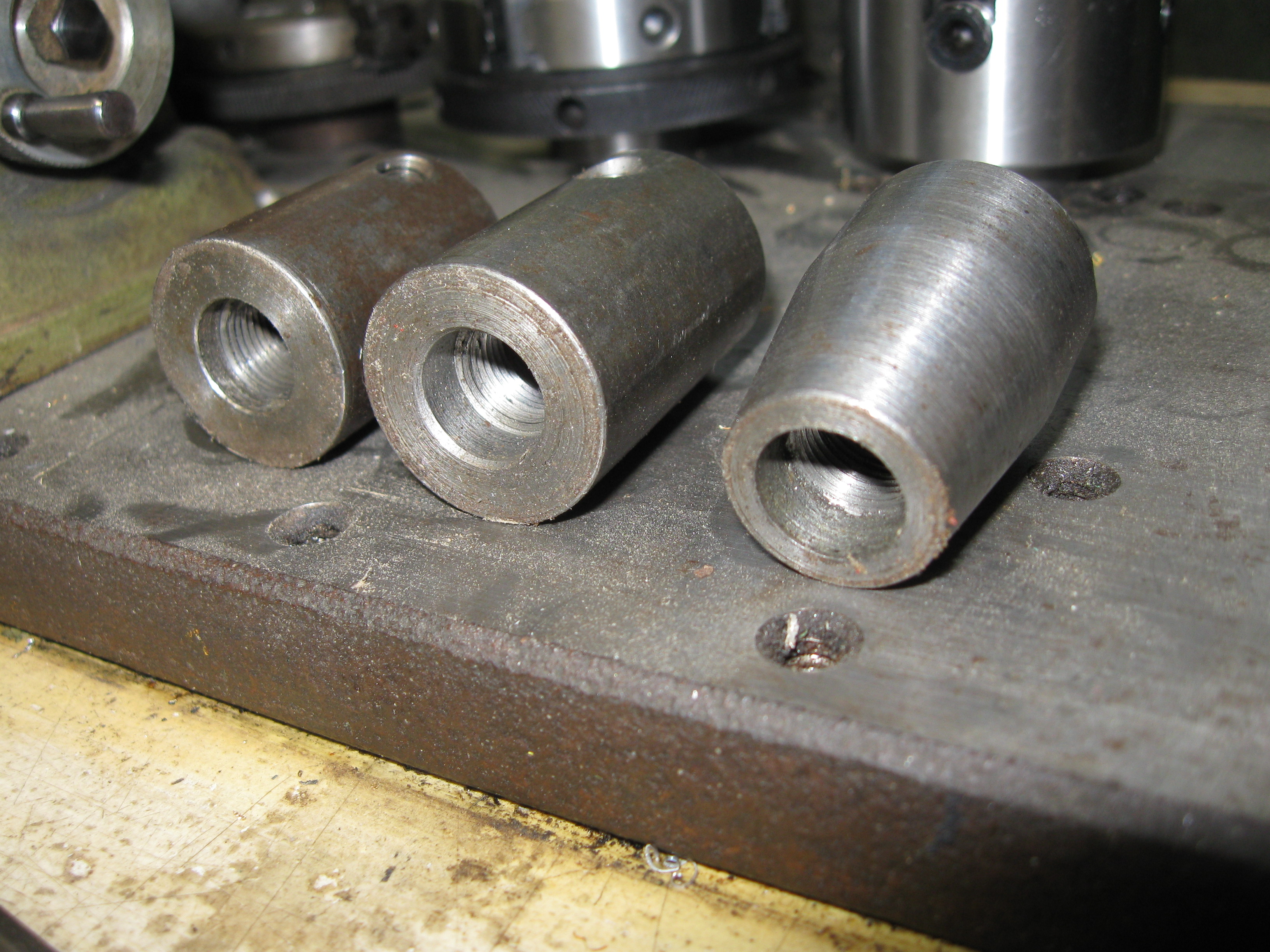

The most important accessory I ever bought for my Unimat is the M12x1 tap. It allows me to modify drill chucks to fit and could turn a 1/2" slab of metal into a face plate, 1" round stock into milling bit holders and a live center. I also use it to build my ER32 chuck:Attachment 49557Attachment 49558Attachment 49559
Carl.
