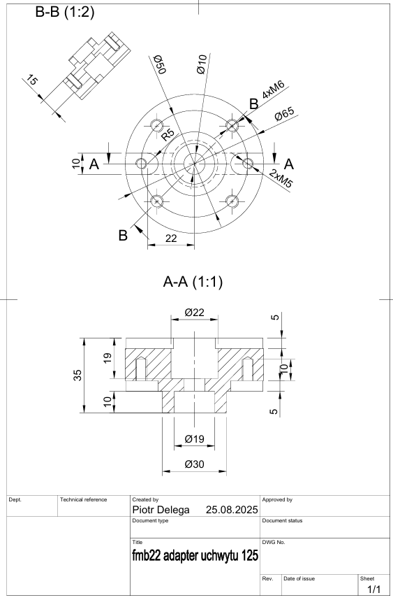

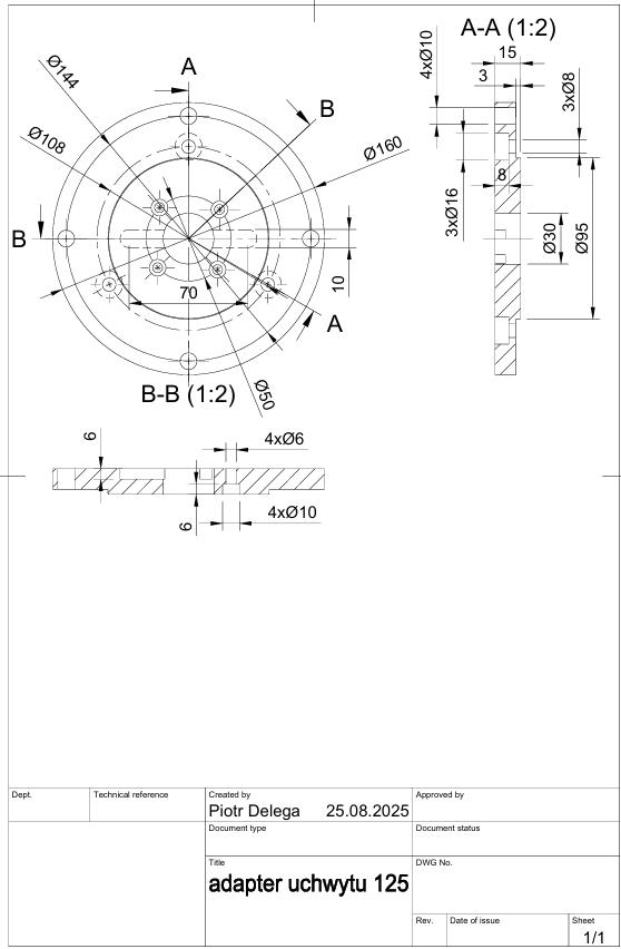

    Hello
    In this video I make a lathe chuck adapter for my milling machine. It was supposed to be use as chuck for turning and rotary milling but my spindle can't handle that much stick out when turning so it's half succes anyway It still gives possibility for mounting something into spindle.
    If someone want to try build something similar there are drawings:
ID:	49674Click image for larger version.
