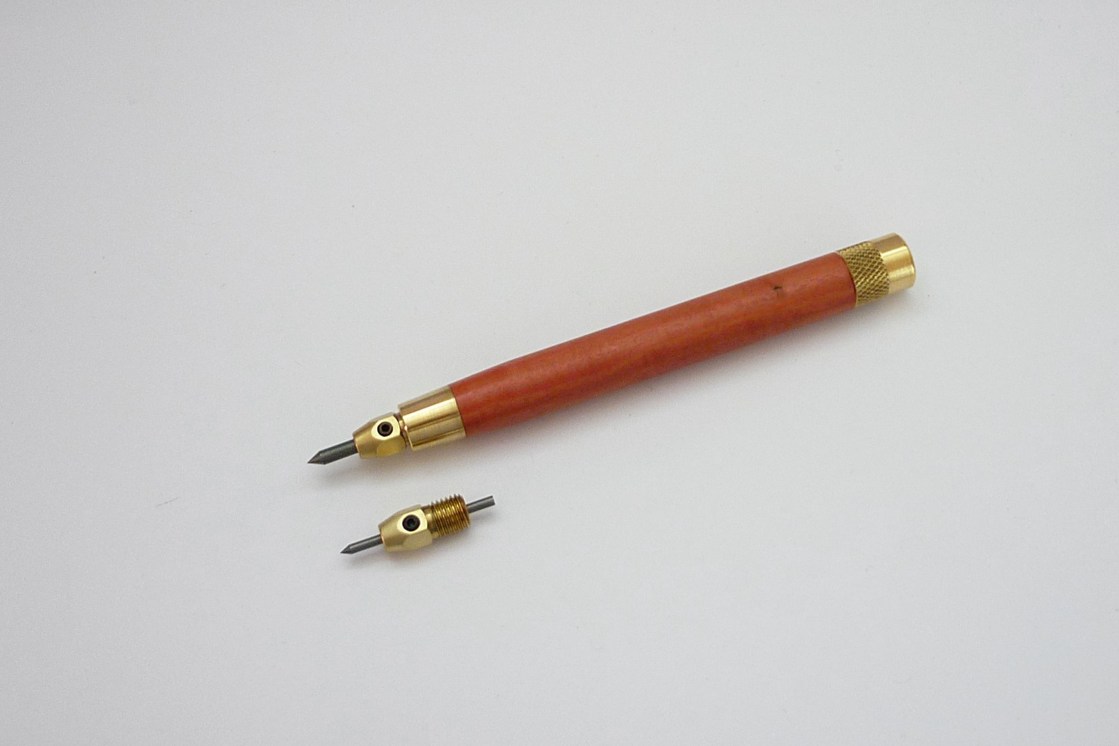

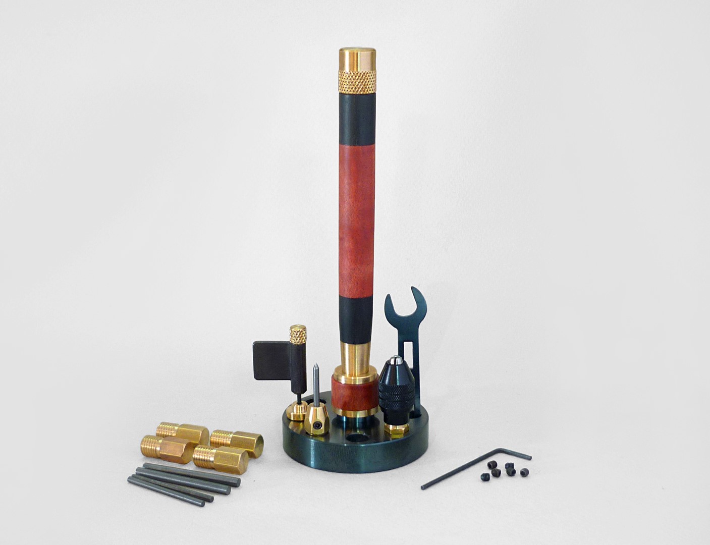

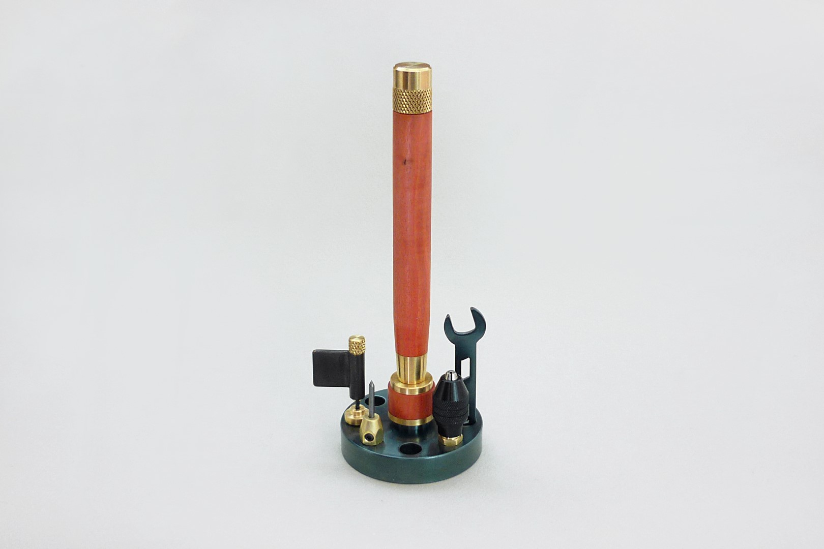

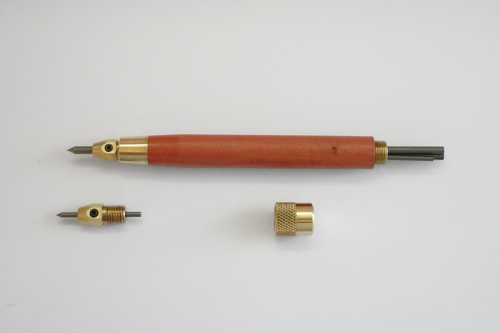

This is a scribing pen I’ve made last year as my contribution to Keith Fenner's - What's in your box giveaway 2017.

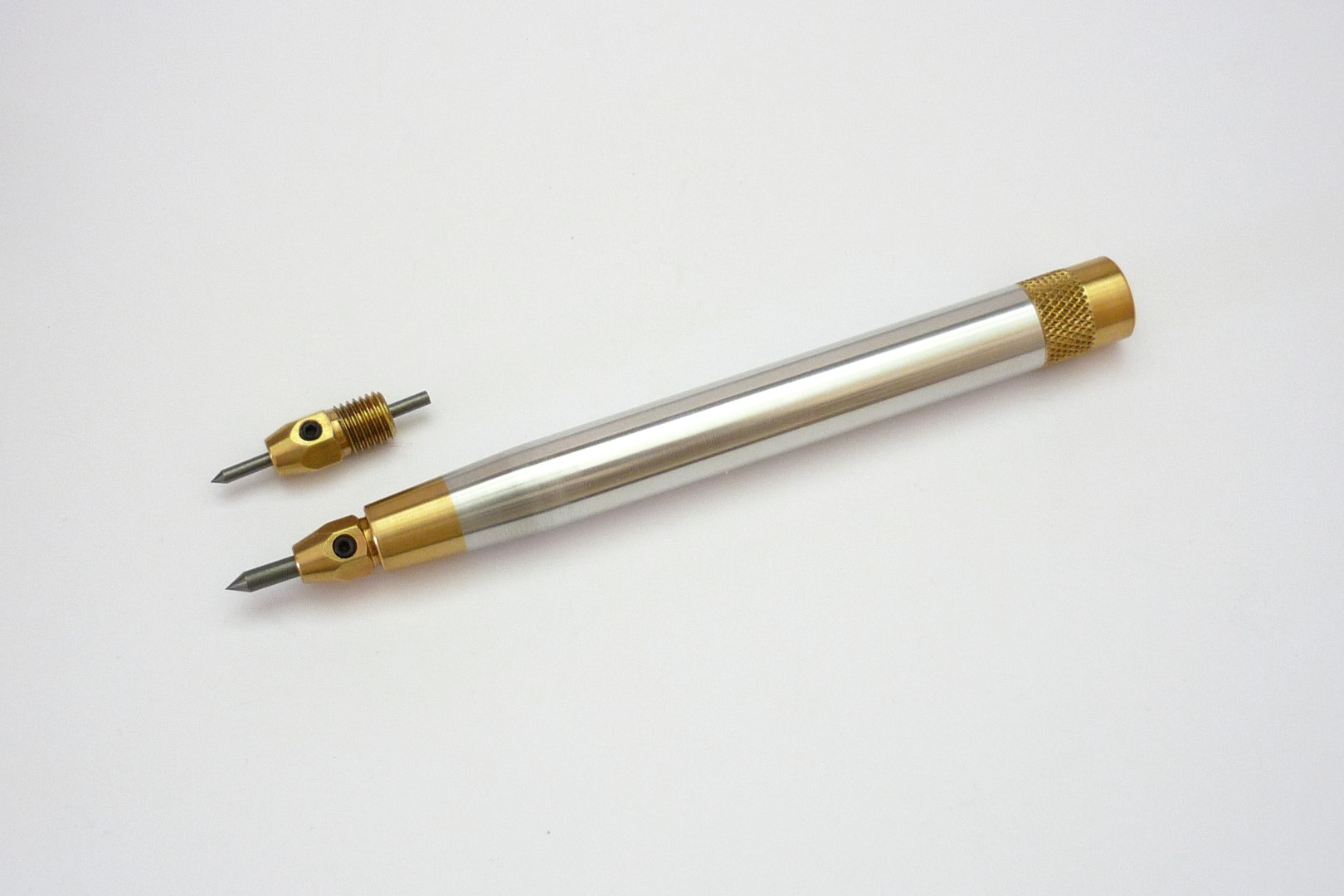

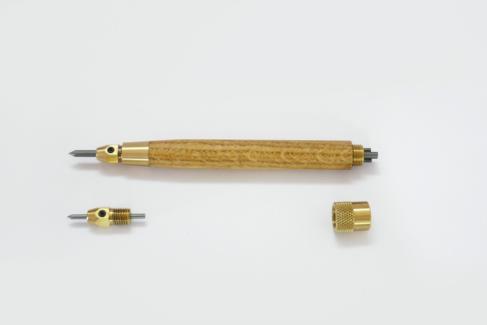

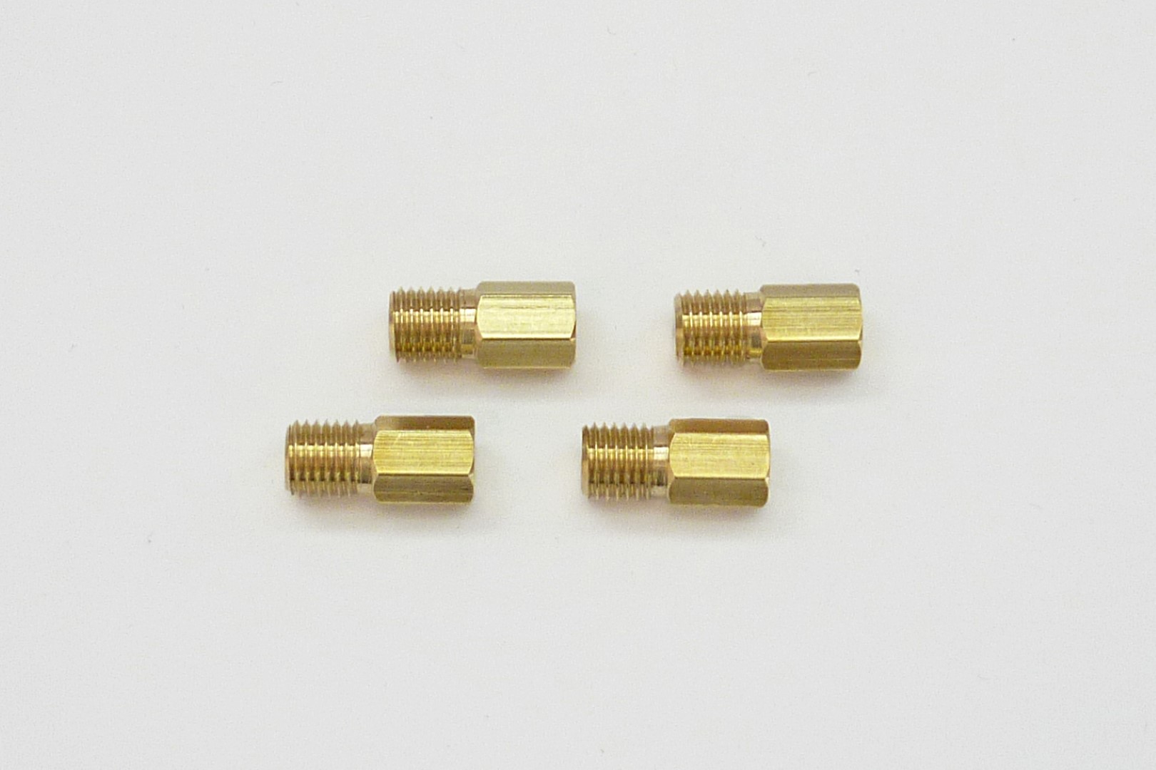

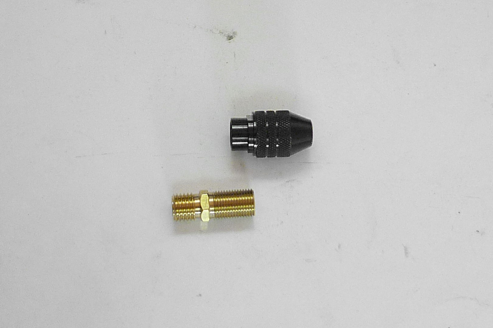

I call it ‘Universal scribe pen’ because it’s a multifunctional tool; with the use of a simple to make threaded adapter it can accept easily a drill chuck from small rotary grinders like Dremel-Proxxon and it can be converted to a pin vise or palm drill.
The scriber is made from Pink ivory wood and brass.
Attachment 27160

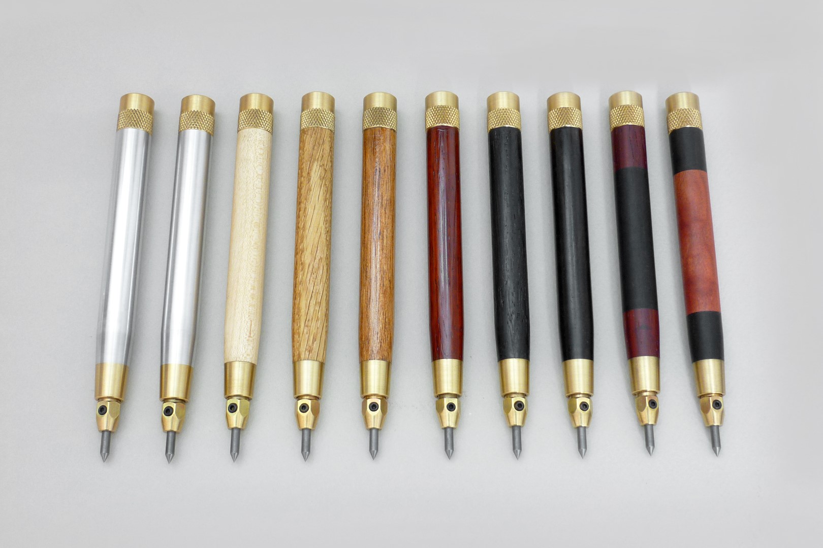

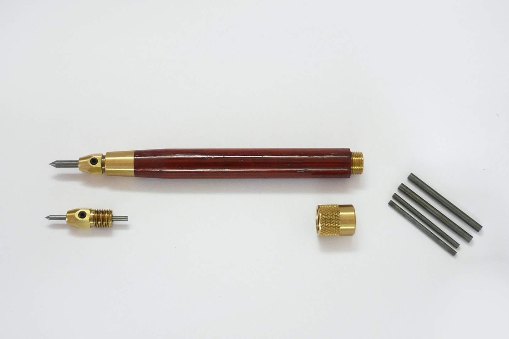

The pen has two scribing attachments
Attachment 27161

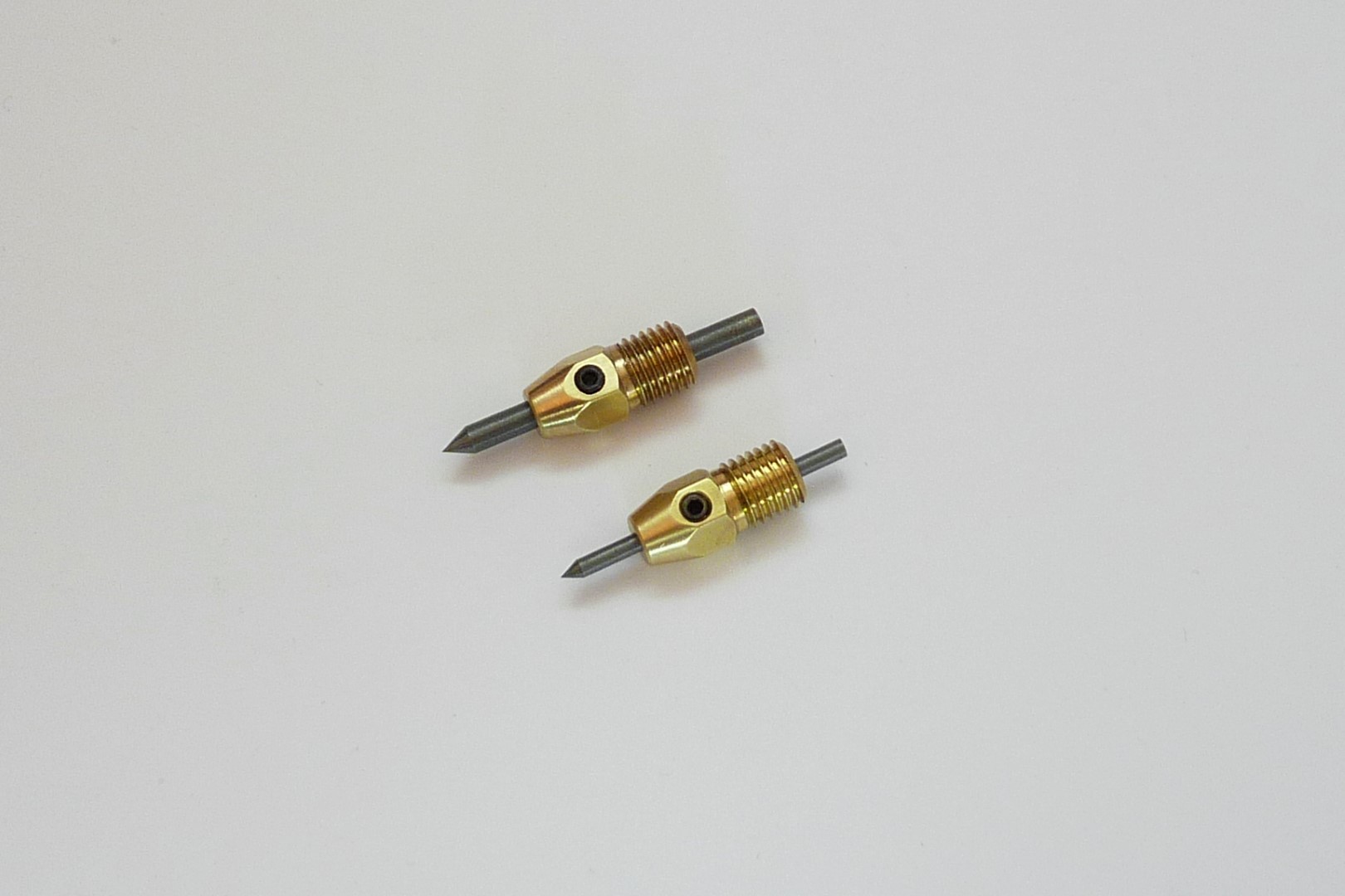

3.15mm and 2.15mm diameter K30 tungsten carbide rods
It can hold 4 spare carbide rods on the case in the upper part of the pen
Attachment 27162

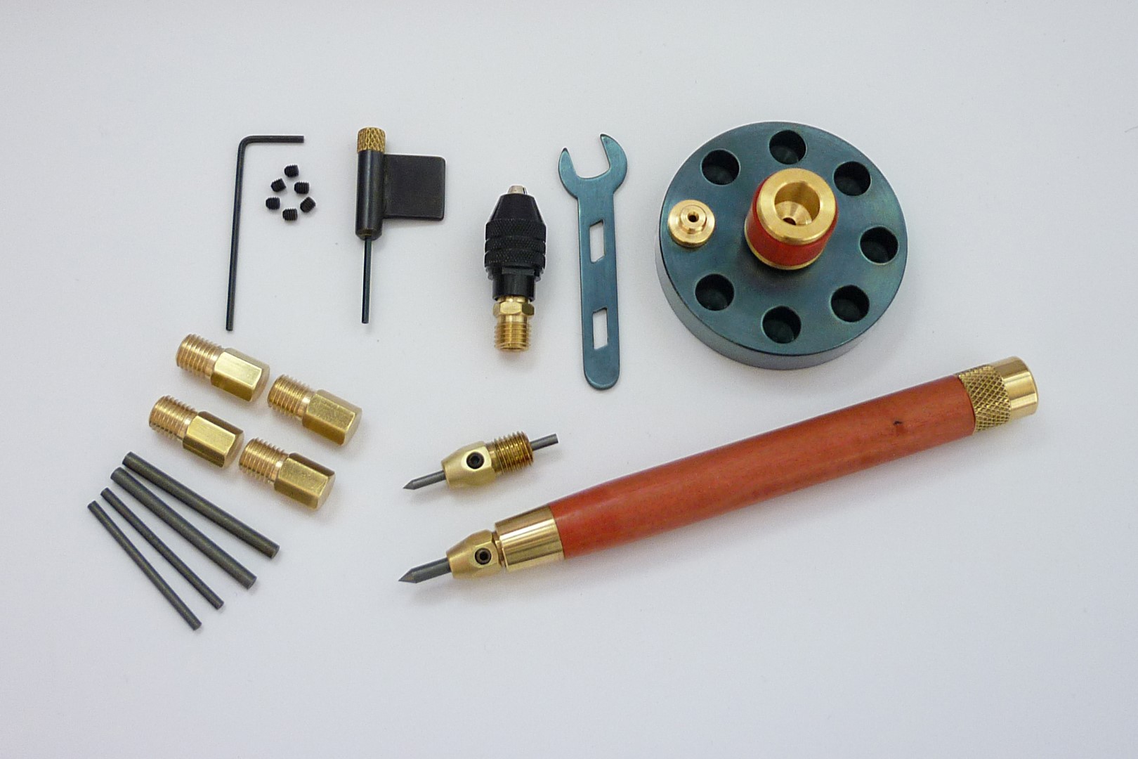

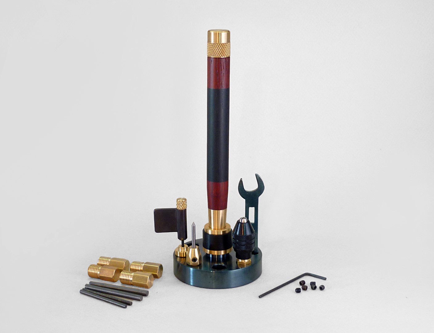

Because I wanted to offer something really special to the giveaway, I made a few more things…

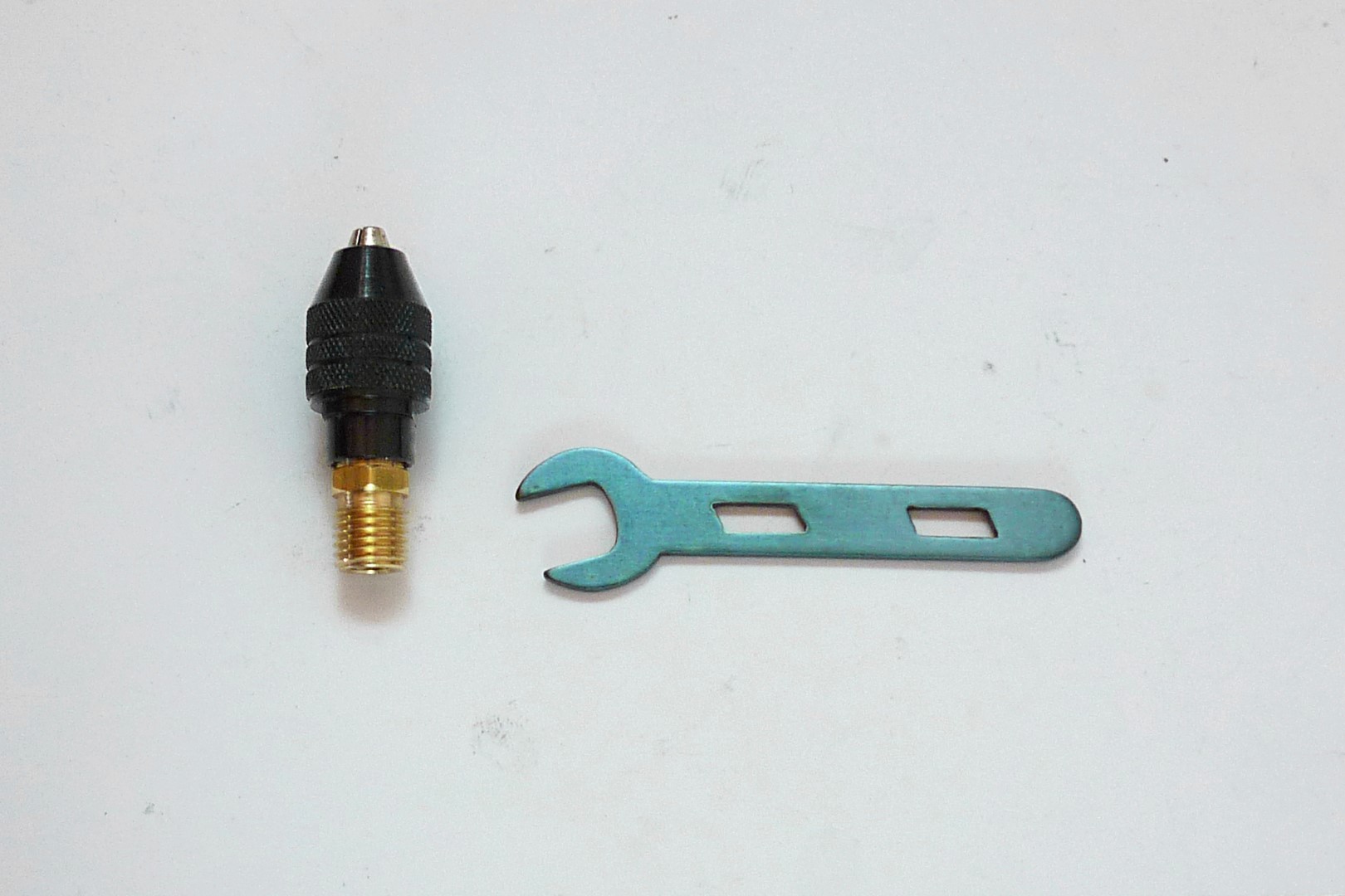

A threaded shaft which holds a small chuck and a wrench for tightening it on the pen
Attachment 27163 Attachment 27164

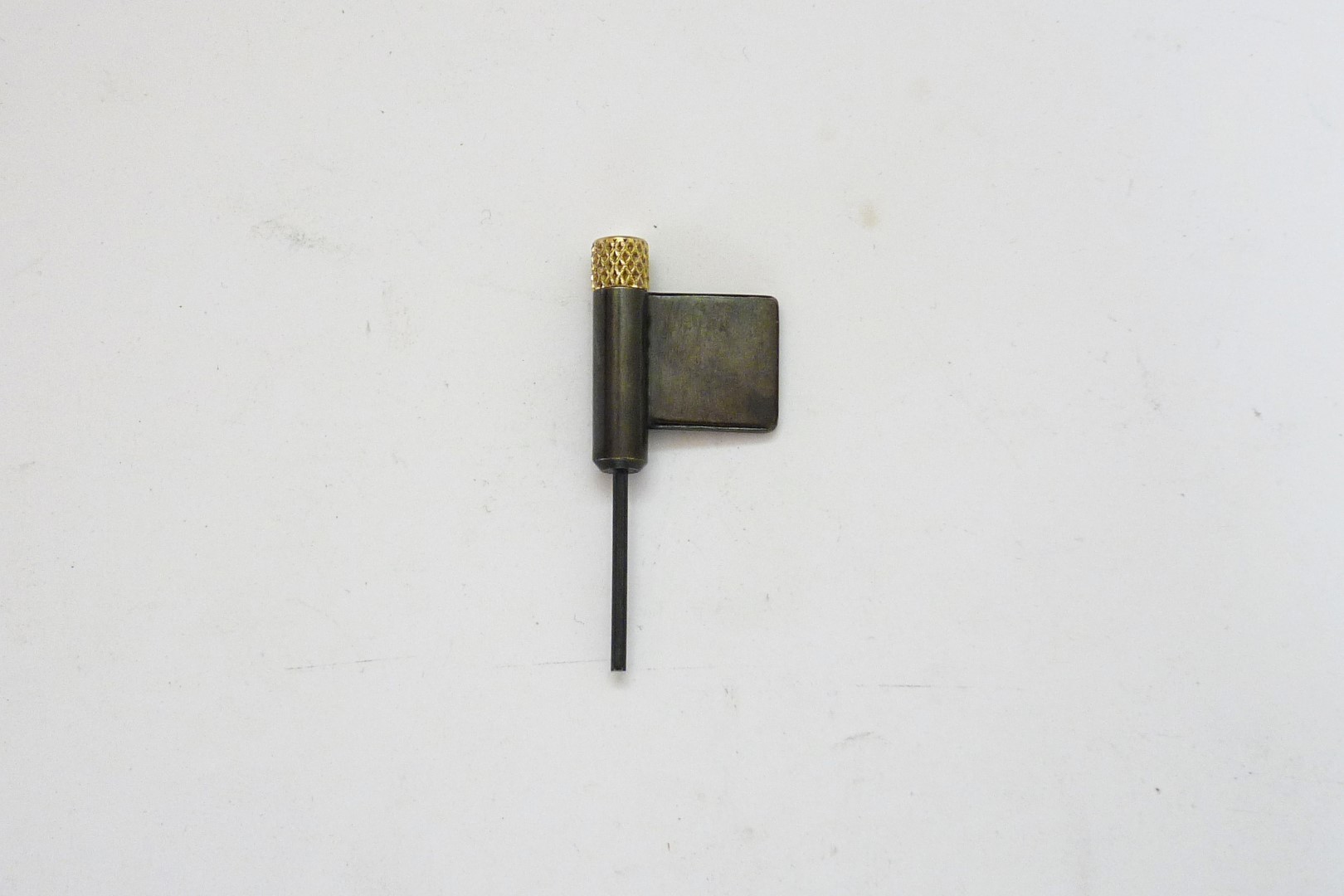

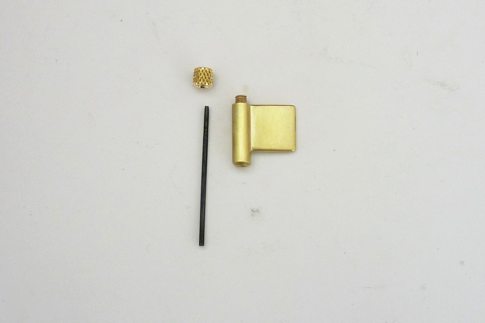

A flag type 1.5mm Allen key
Attachment 27165 Attachment 27166
4 blank scribing attachments
Attachment 27167

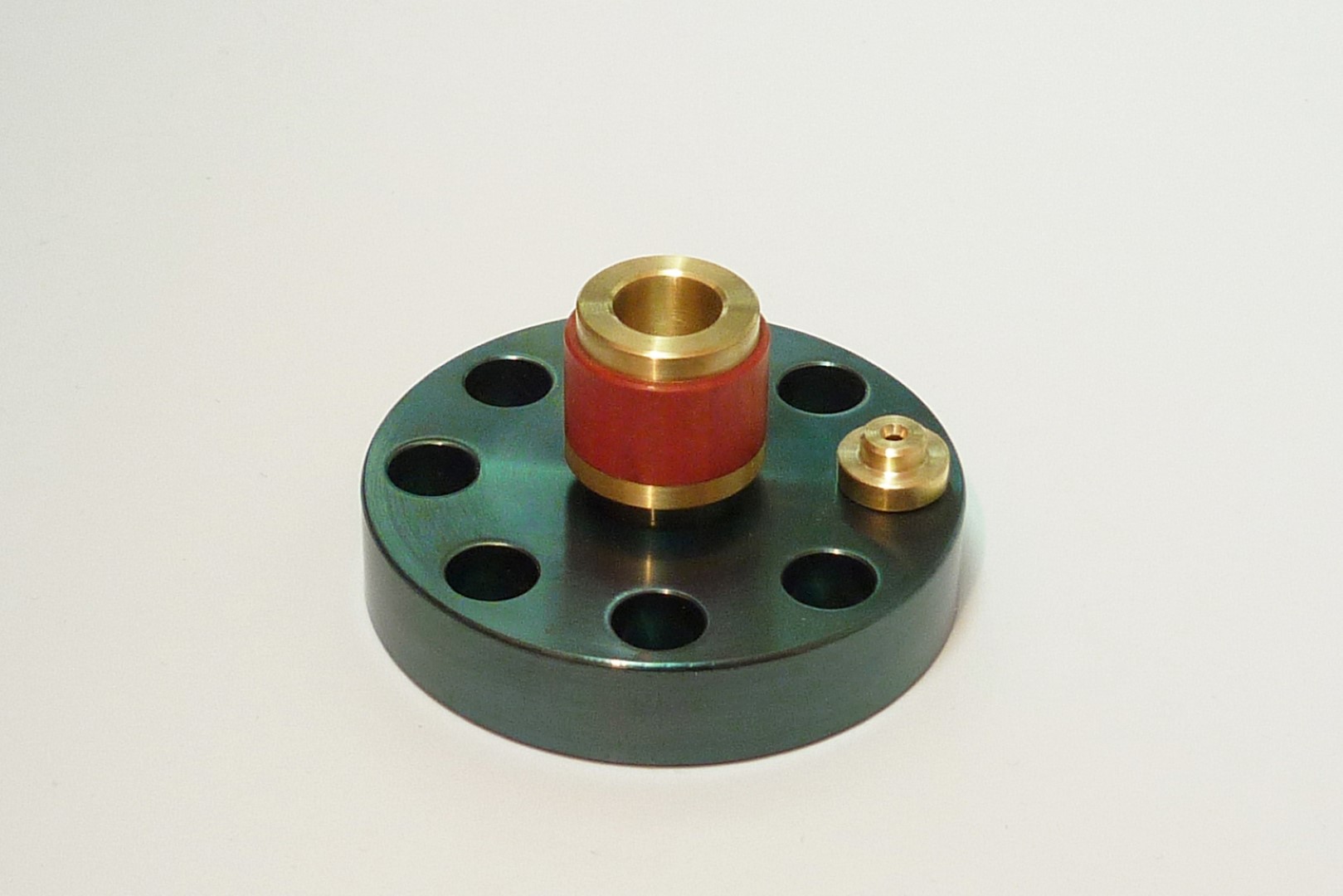

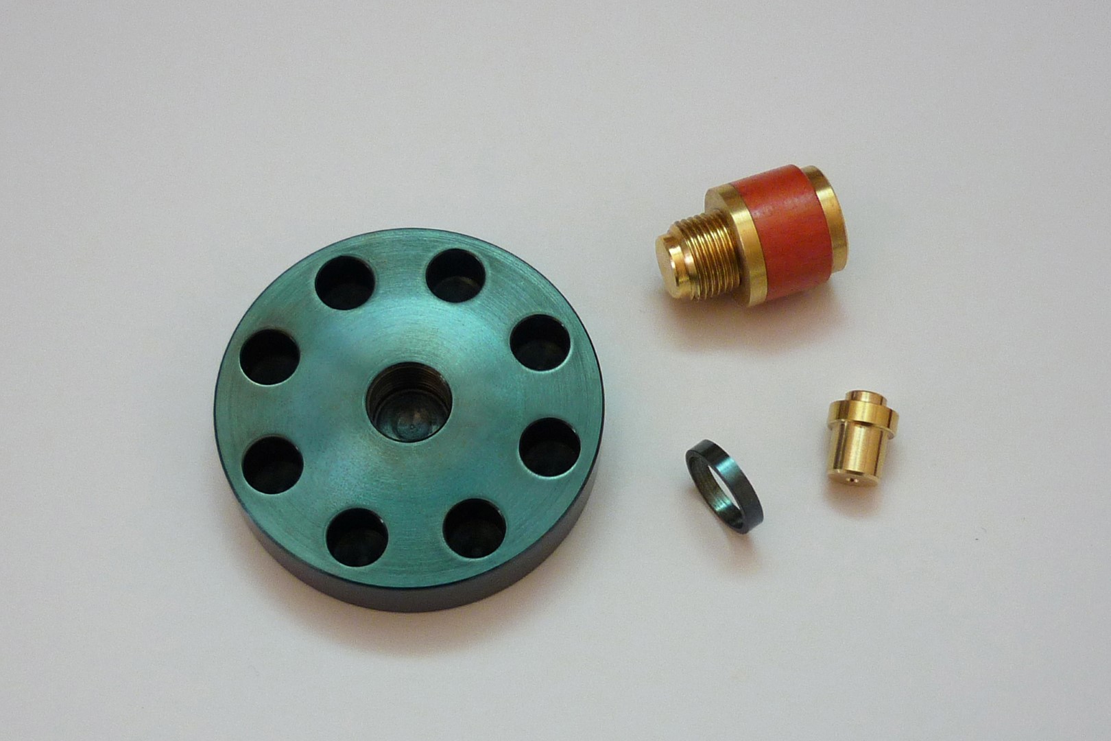

And a base
Attachment 27168 Attachment 27169
Attachment 27170 Attachment 27171
