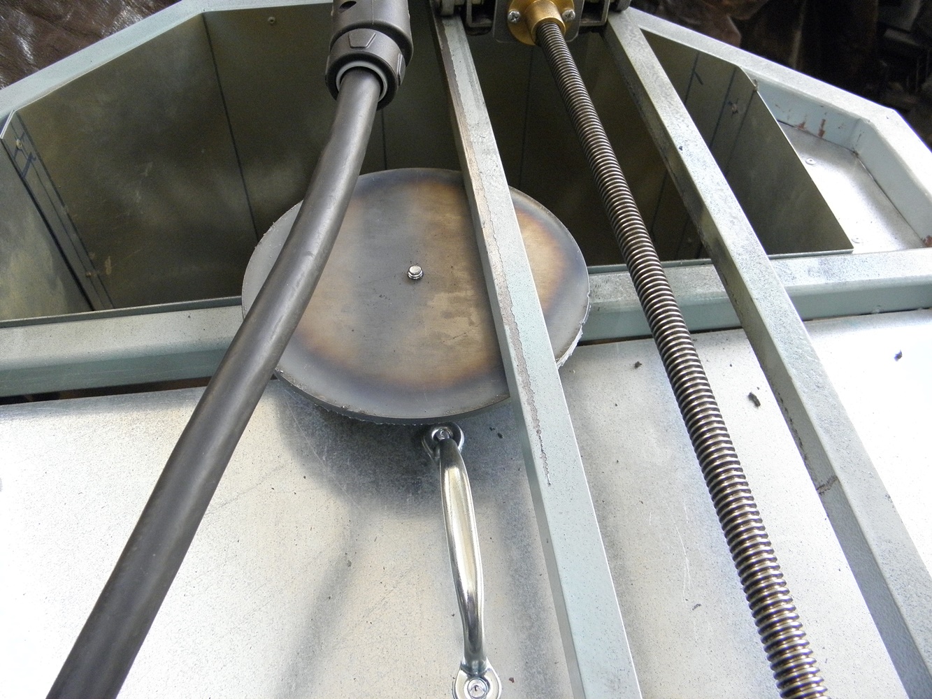

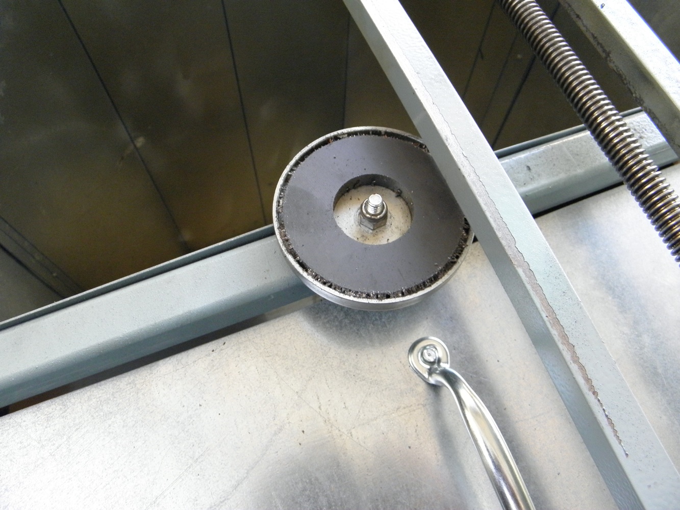

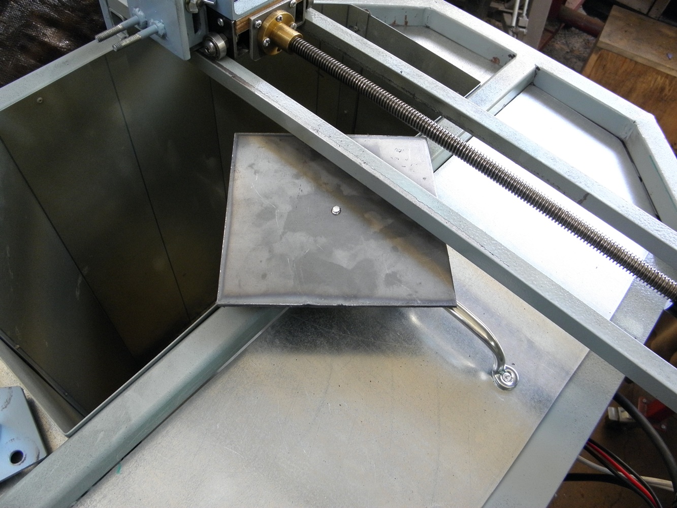

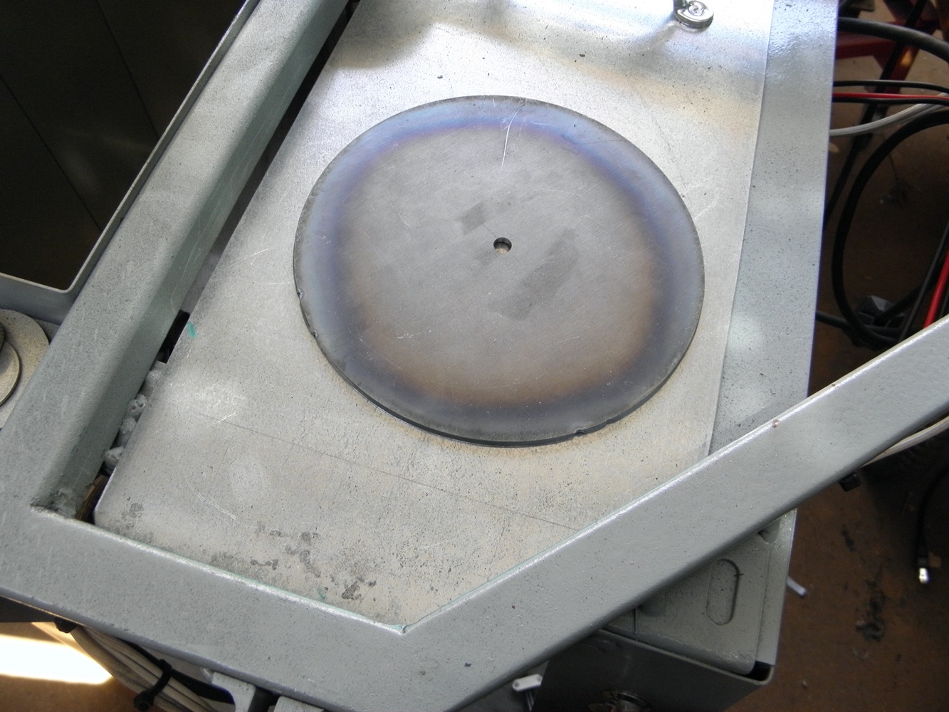

    Update for holding material tie down plasma circle cutter. Made from a HF magnet with hole in the middle.
    Thanks to Frank S. for the magnet idea works much better and is quick to change blanks plus rotates level cuts clean and it has only a 1/4 inch hole instead of 1/2 "....Thanks Frank for your useful ideas.......Cap. you have to be a guerrilla to get that metal off the magnet.

    Hi Cap. Glad you liked my idea, no charge this time
    Now for a tip you may also find useful in removing the part from the magnet. If you will note the steel cover extends slightly beyond the magnet if you carefully file or grind a couple of relief areas wide enough for a screw driver to be forced between the part and the steel cover a slight twist and the part will come free easy peezy
    BTW I'm not charging for this one either
