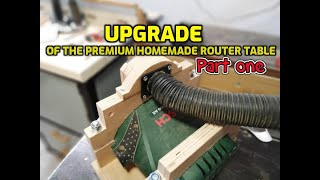

    Main goals of this upgrade is:
    1) Removing old Manesmann router
    On the old Manesmann router, the shaft twisted,
    so that it became unusable.
    2) Inserting a more powerful router BOSCH POF 1200 AE
    3) Enabling independent airflow to cool the router
    To further improve the Premium Homemade Router Table technical
    solution, I enabled an independent airflow to cool the router. That
    prevents sawdust from entering the router.
    A video about that, You can be viewed here:
