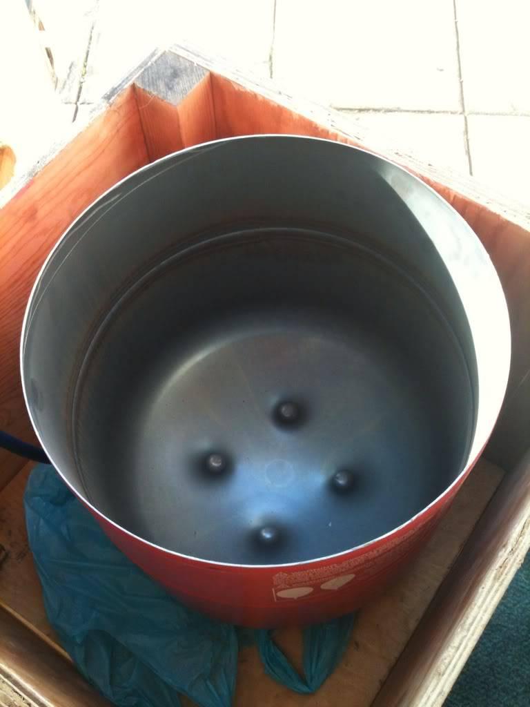

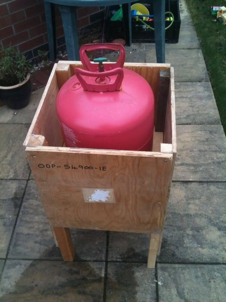

I looked at a plethora of items that could be used or converted, including very large pipe couples, butane bottles and pretty much anything around the 12" x 12" size I was after but in the end I chose a helium bottle as it was free, already empty and met my size requirements. They're also rated to over 200 bar (3000psi) and absolute vacuume is a meagre -1 bar so knew the bottle could easily handle it.
"The build"

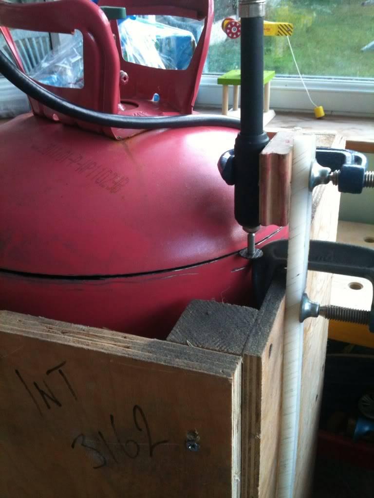

Not being overly equipped with tools, I needed to find a way to cut the top off the bottle, after a bit of hard thinking and fiddling about, I came up with this cutting jig for my dremal:
http://i1225.photobucket.com/albums/...i/6375b4ee.jpg
http://i1225.photobucket.com/albums/...i/dc1c02b7.jpg
2 metal cutting discs and 5 standard ones later.... job done:
http://i1225.photobucket.com/albums/...i/5b648970.jpg

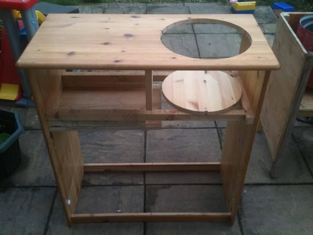

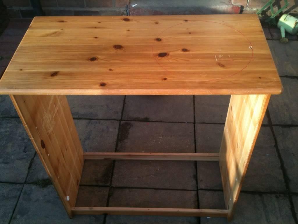

One of the chest of drawers in my kids bedroom was in need of replacing and that provided the perfect opportunity to make a work unit for the chamber and pump.
All striped down
http://i1225.photobucket.com/albums/...i/fd0e60bb.jpg

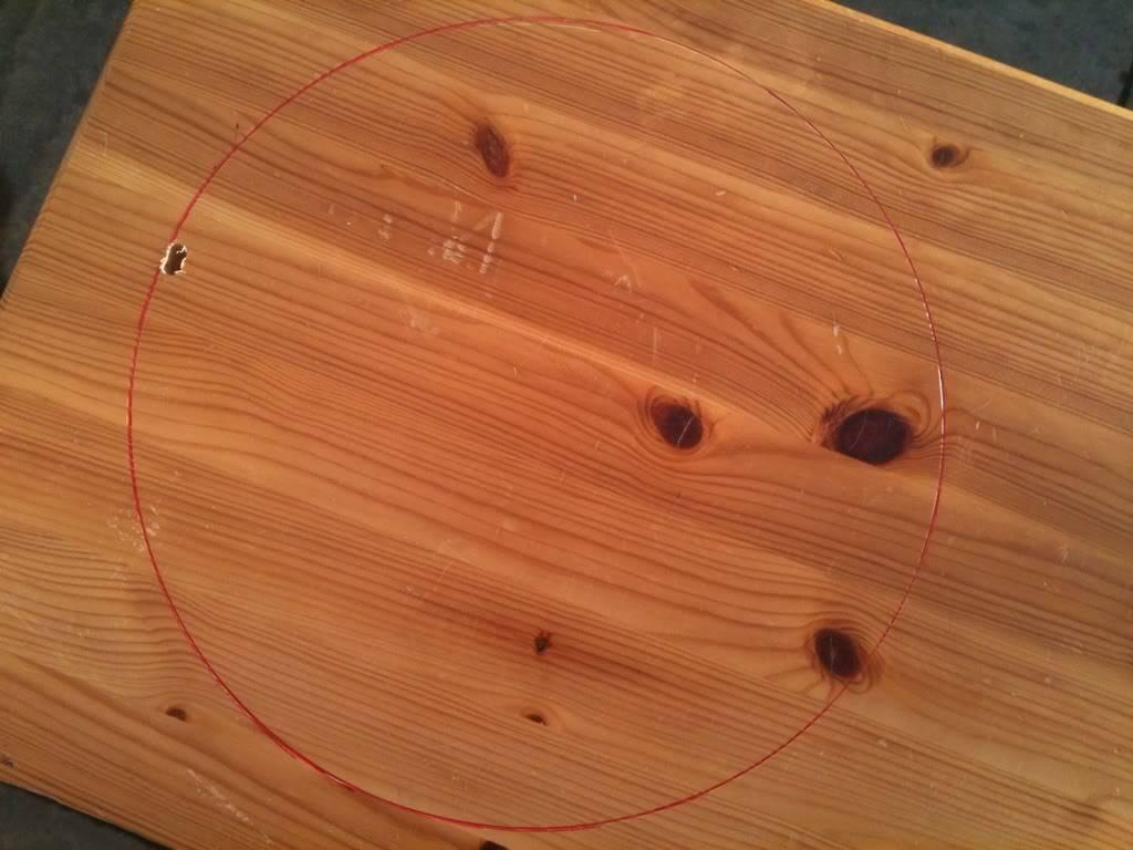

I then drew around the chamber lip and drilled a pilot hole for the jigsaw
http://i1225.photobucket.com/albums/...i/6c1aeeef.jpg

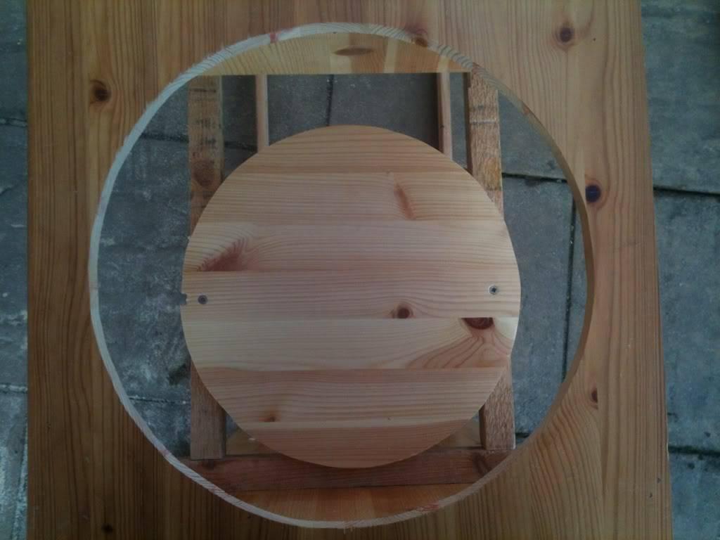

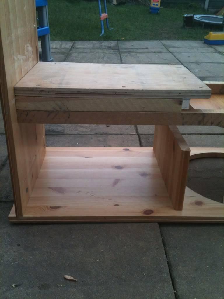

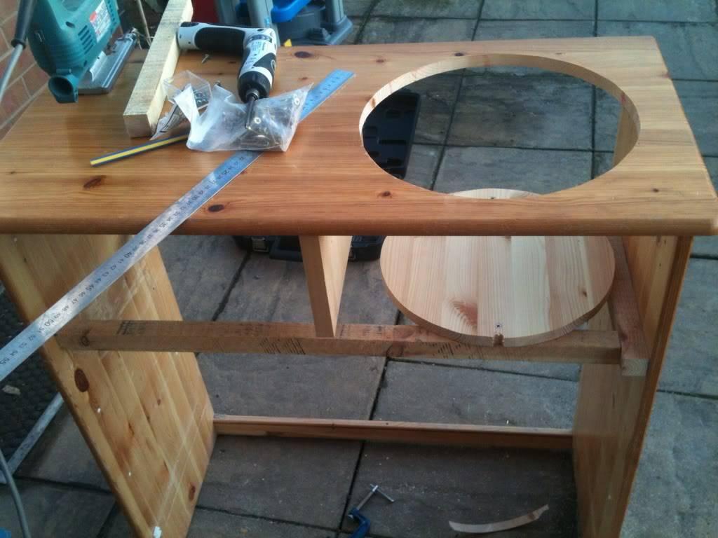

Hole cut, then the plug secured to a couple of cross bars added to set the hight of the chamber (and add a little extra structural integrity)
http://i1225.photobucket.com/albums/...i/2c7988c6.jpg
http://i1225.photobucket.com/albums/...i/a41d7aef.jpg

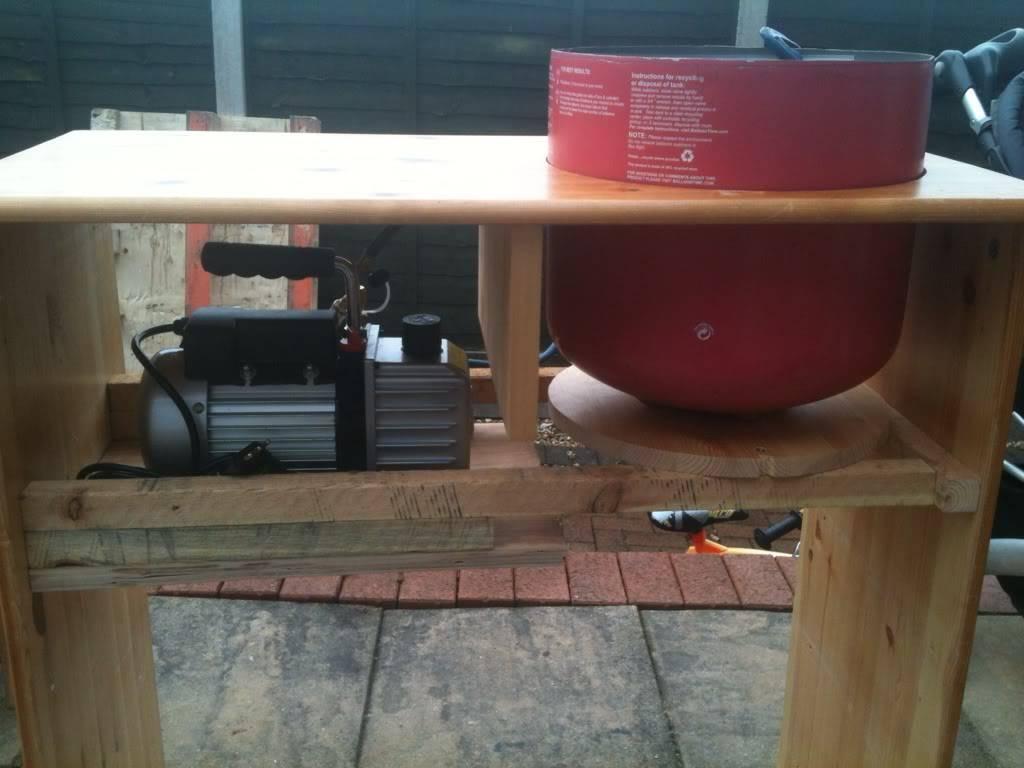

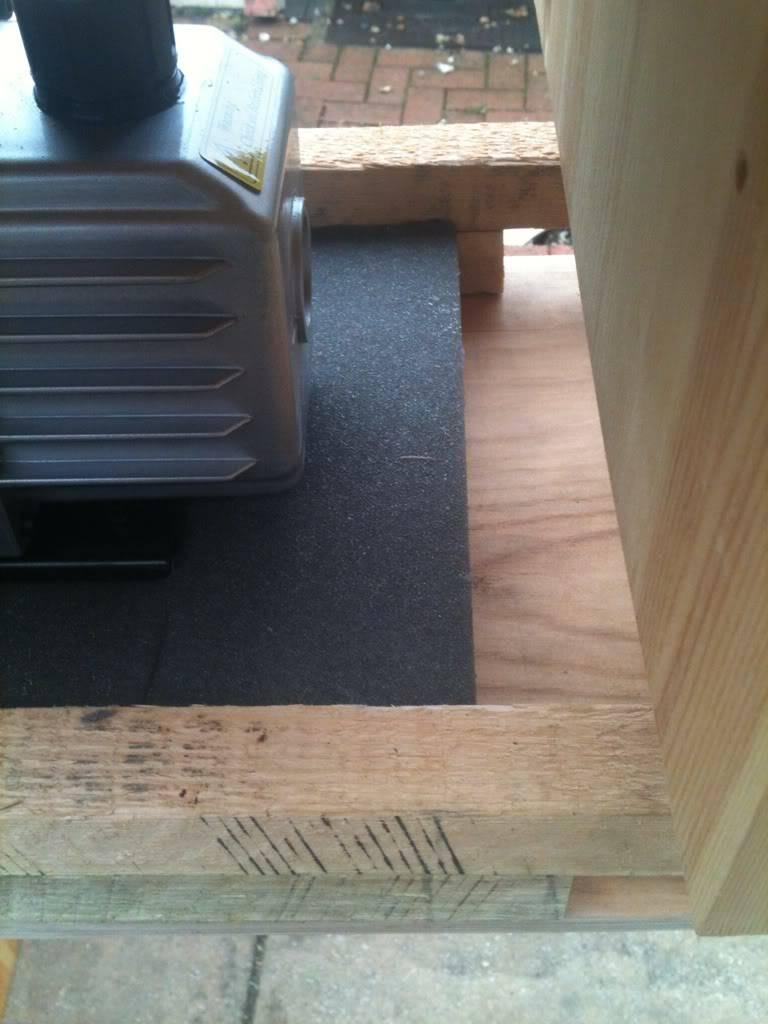

I then added a shelf for the pump underneath the worktop
http://i1225.photobucket.com/albums/...i/ca9da514.jpg
http://i1225.photobucket.com/albums/...i/8de84531.jpg
A quick test fit:
http://i1225.photobucket.com/albums/...i/0659e11d.jpg
And as a neat touch, a bit of acoustic foam I had lying about from my old recording studio that fit the gap perfectly, no cutting needed.
http://i1225.photobucket.com/albums/...i/49df691a.jpg

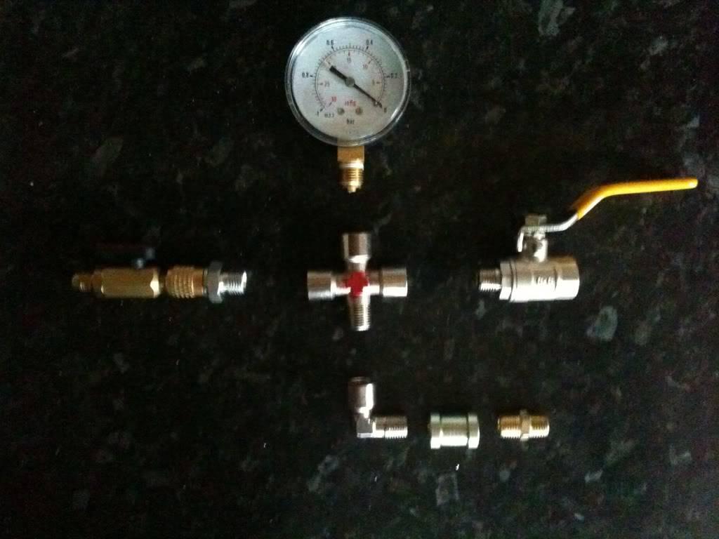

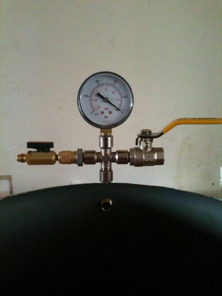

I then set about acquiring a vacuum gauge and other fittings:
http://i1225.photobucket.com/albums/...i/9496a623.jpg
After assembing the parts I used a bit of JB Weld as a thread locker. It was then supported till it was stiff enough to move to a warmer place to cure:
http://i1225.photobucket.com/albums/...i/657a4d5b.jpg
I then drilled a hole near the top of the bottle for the inlet/outlet and test fitted the assembly:
http://i1225.photobucket.com/albums/...i/7c682a3a.jpg
Once the flange was welded on and valve assembly fitted properly, the chamber and pump were installed into the work unit to finish the build:

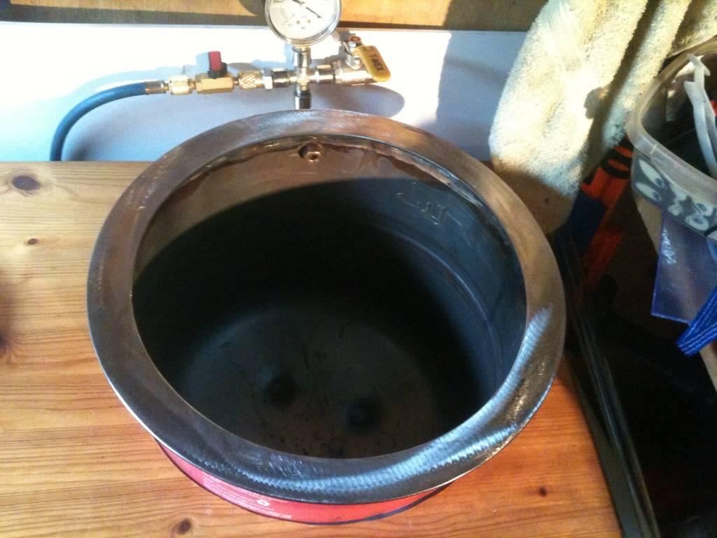

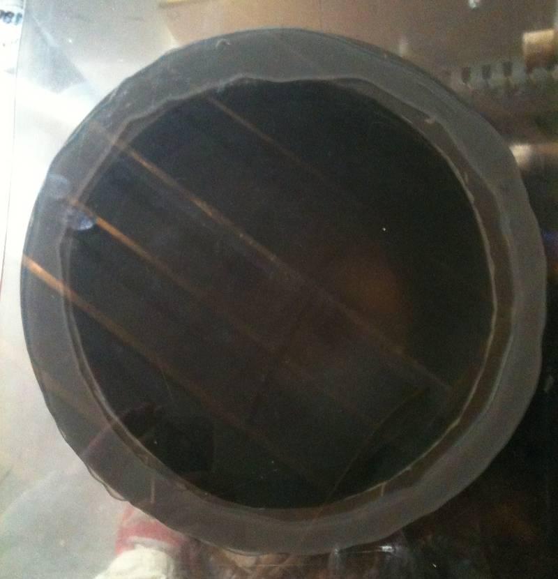

<edit> found a pic of the gasket I made with clear caulking. I used a spare piece of acrylic with soapy water to flatten it. The soapy water acts as a release agent that prevents the caulking from sticking to most surfaces (inc fingers)
http://i1225.photobucket.com/albums/...516_120930.jpg

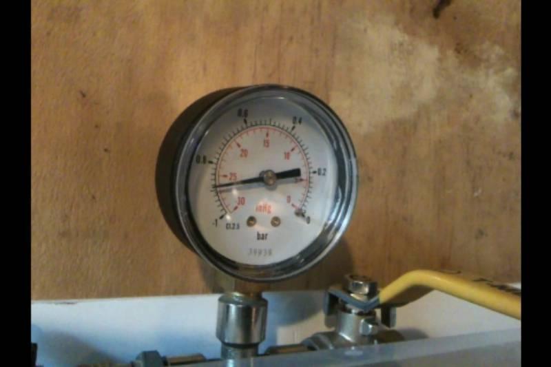

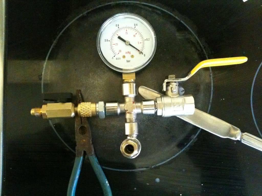

And this one with the guage showing the chamber at near full vacuum:
http://i1225.photobucket.com/albums/...516_121247.jpg
