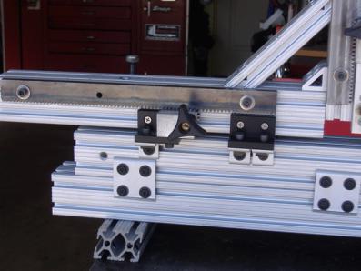

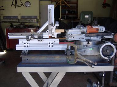

My current project is to do some metal forming so I had to make concave and convex pieces(anvil?foot?) to do the actual forming. Since it was going to be a process where I'd start out with a guestimate and then cut a tighter and tighter radius until I compensated for springback I decided I needed a way to make a repeatable and precise way to do it. I scored some 80/20 2020 10 series aluminum extrusion off the local Craigslist. So I used that and some rack and pinion's I got off ebay along with some 80/20 linear bearings. Along with the rotary table off my mill. I hope the pix will be self explanatoryAttachment 4106.
Nice setup C-bag. Easy to build and precise. :thumbsup:
Al
Thanks Altair. 80/20 is the bomb for doing this kind of stuff.

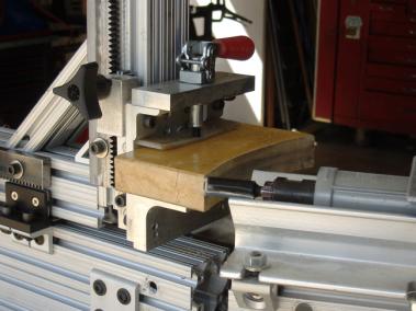

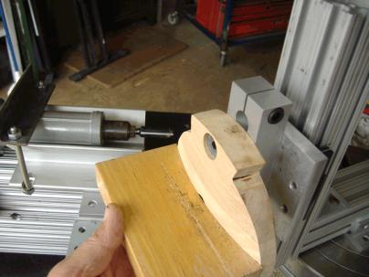

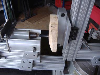

I'm new to this forum but on other forums that seem to run the same software. So I thought the process to upload pix would be the same.....but it didn't seem to want to let me upload more than one pic. I was waiting to see if anybody even noticed this or wanted the other pix to see if I should give it another try for the different views and cutting convex and concave.
