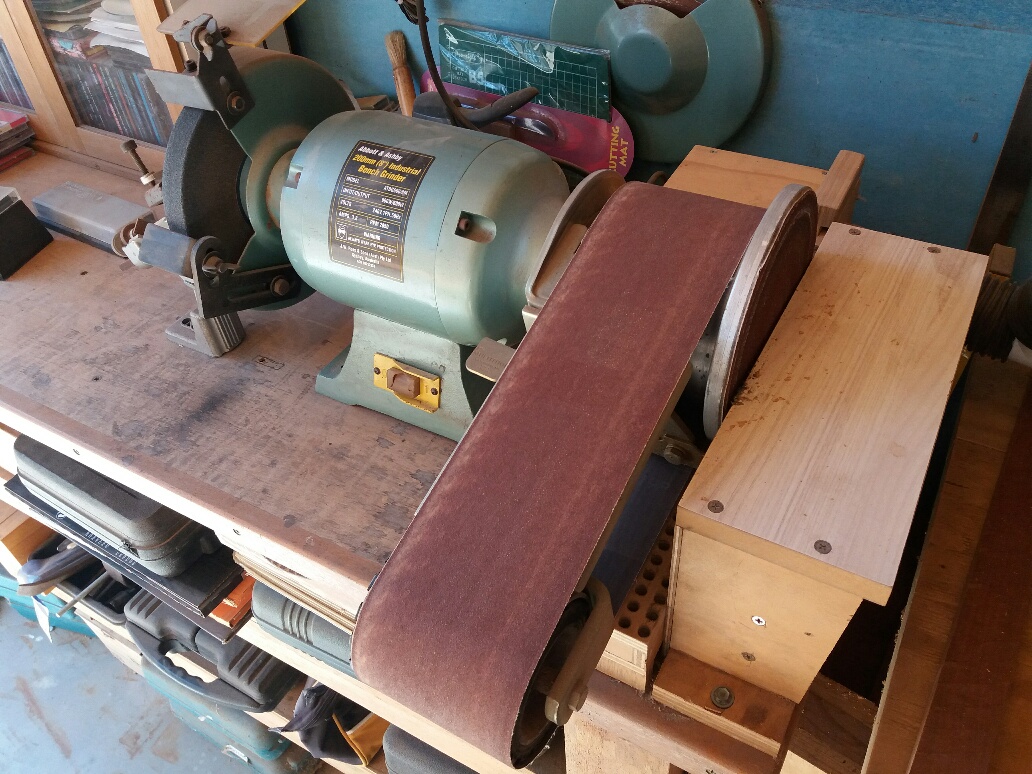

This is my variable speed belt sander created by combining a lathe headstock with a multi tool belt sander. The sander is held using threaded rod studs, it was only meant to be a proof on concept before turning a proper ring on the metal lathe but it's so solid and works so well I never changed it. RPM's are adjustable from 500-2000, it's a great tool.
