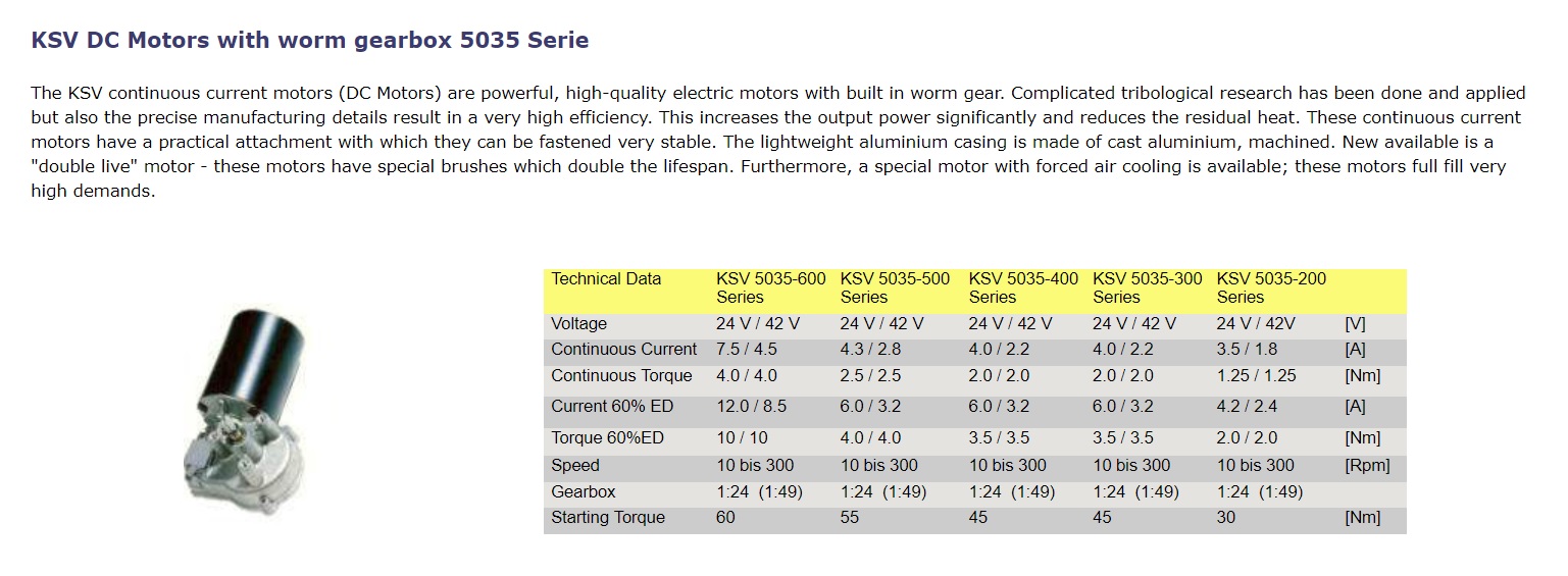

My personal favorite in this area is the KSV 5035:
Attachment 35564
I've had one of these "600"-flavor mothers jam to a stop at 24 VDC & >20 A* in without shredding the Acetal 49:1 worm gear.
They've ripped frozen, stuck windshield wiper blades and arms to shreds over here since the fifties in cars, trucks and buses.

I salvage these from discarded heavy-duty office table pillars at work: +150 kg cast iron on the table: 2"/ sec raise w/o trouble at 18V in.
Made for 100% duty, -20 C Nordic weather, works for decades and they'll take anything below 50 volts and just run.
Haven't fried one yet, their magnets haven't even come close to their Curie points, and they take no prisoners without complaining.
Shortest possible length of 2,5 mm 2/AWG 14 minimum and big-amp DC supplies or SLA batteries in my builds too,
just to get that "no bull" starting torque and as stable rpm/ volt independent of loading I can get.
Just my 2 cents & YMMV
Johan
* My clamp DC ammeter simply maxed out at 20A in that test.

Thank you very much for recommending the KSV 5035 engine, I will try to find it and it will participate in my experiments.
