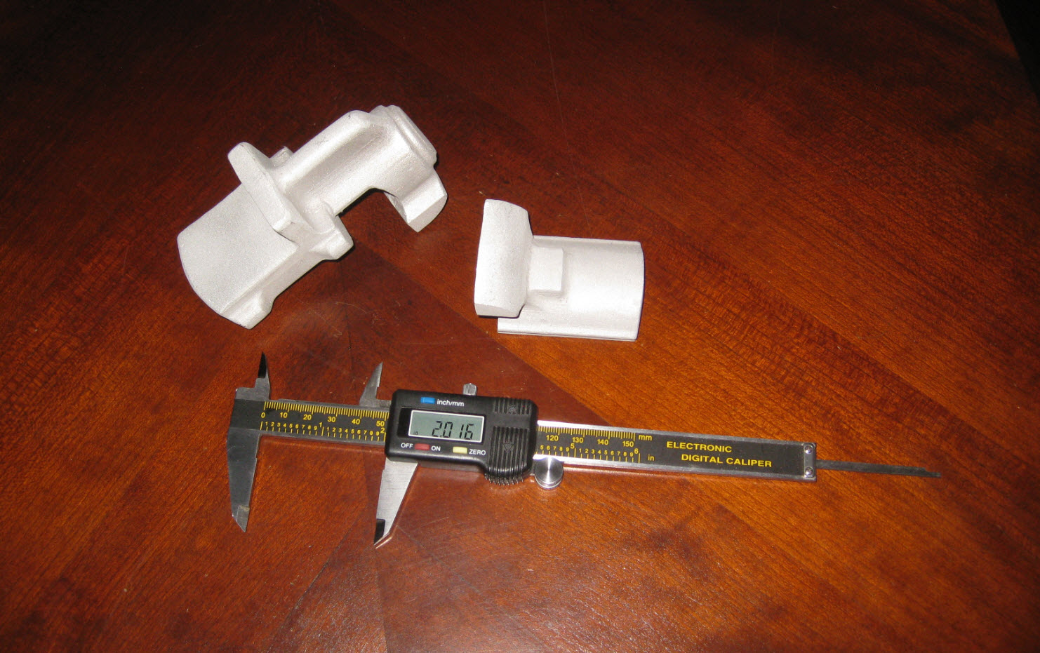

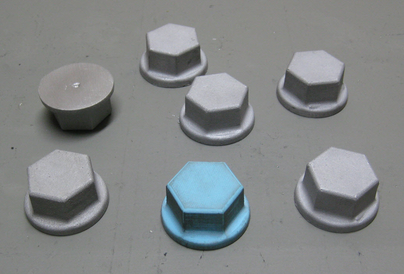

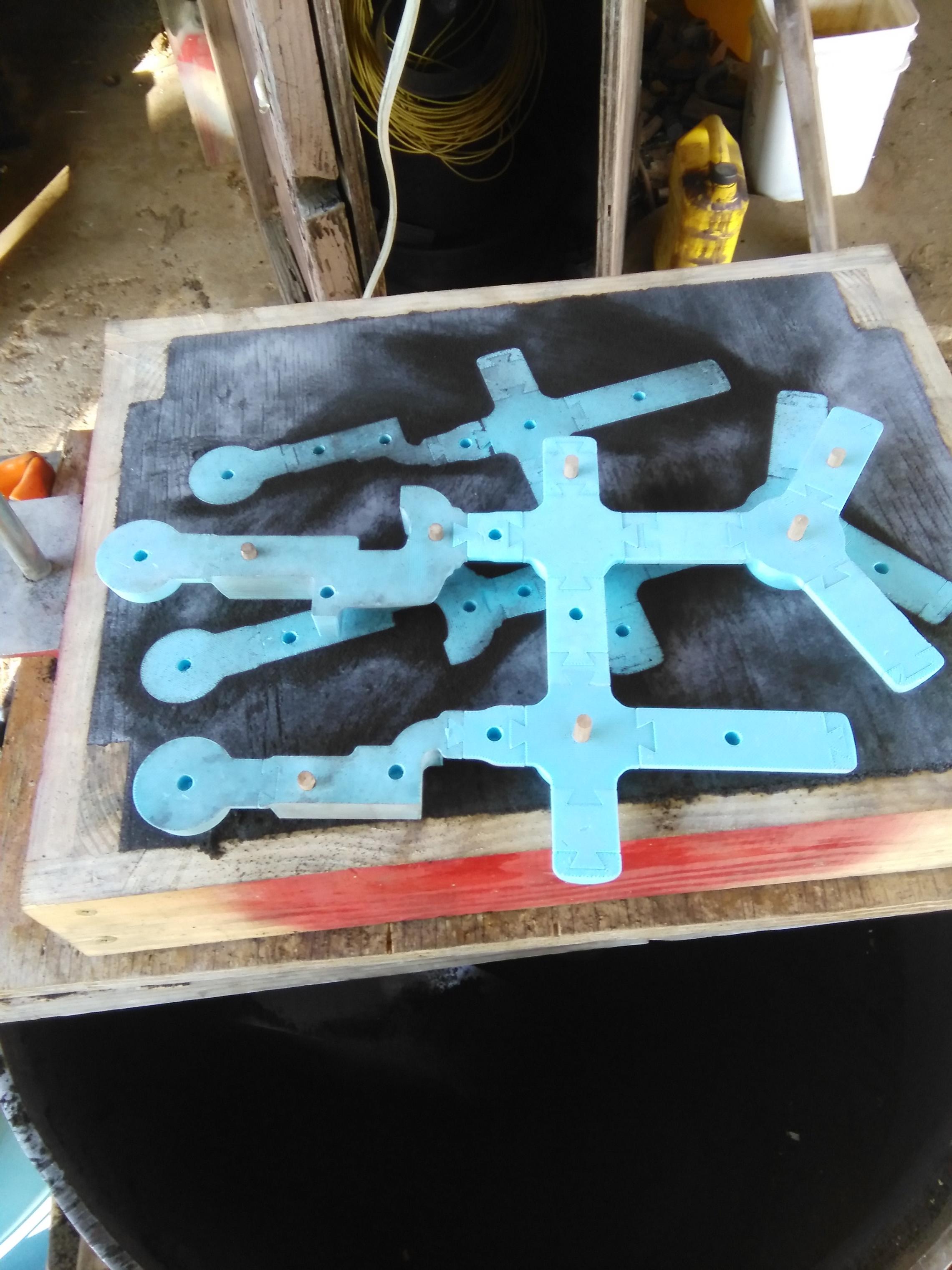

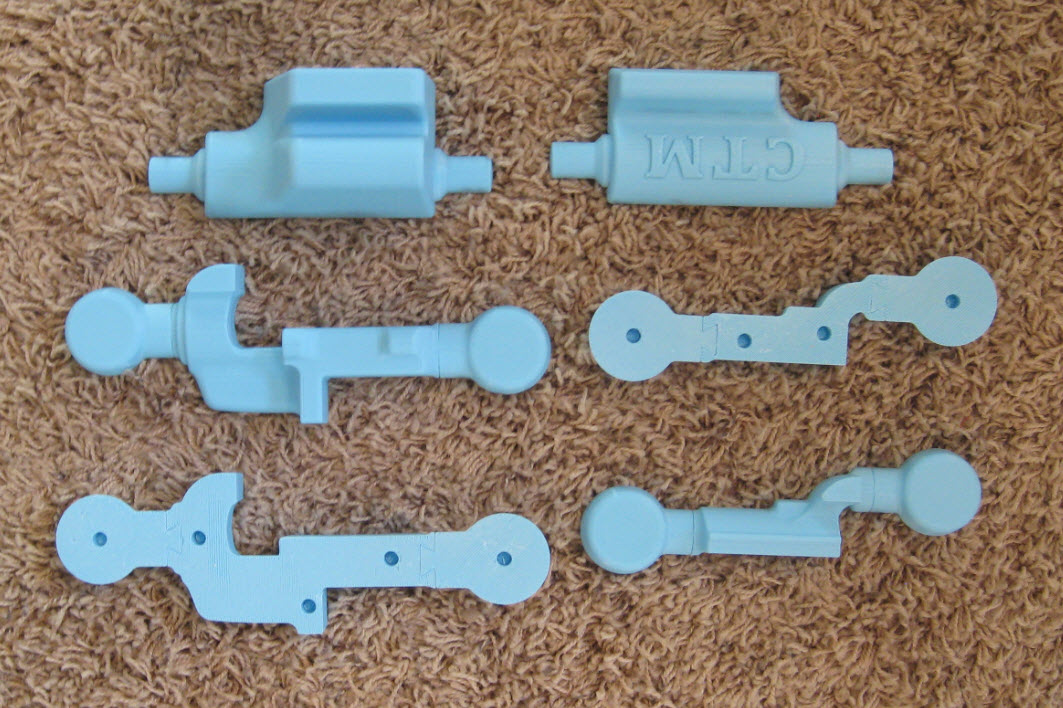

The Short story is 3D-Printers are basically toys right now, but there are some things you can do with them like making patterns for Sand Mold Metal Casting.
Attachment 10042

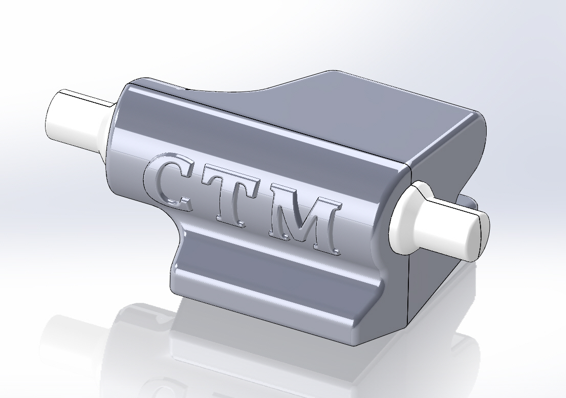

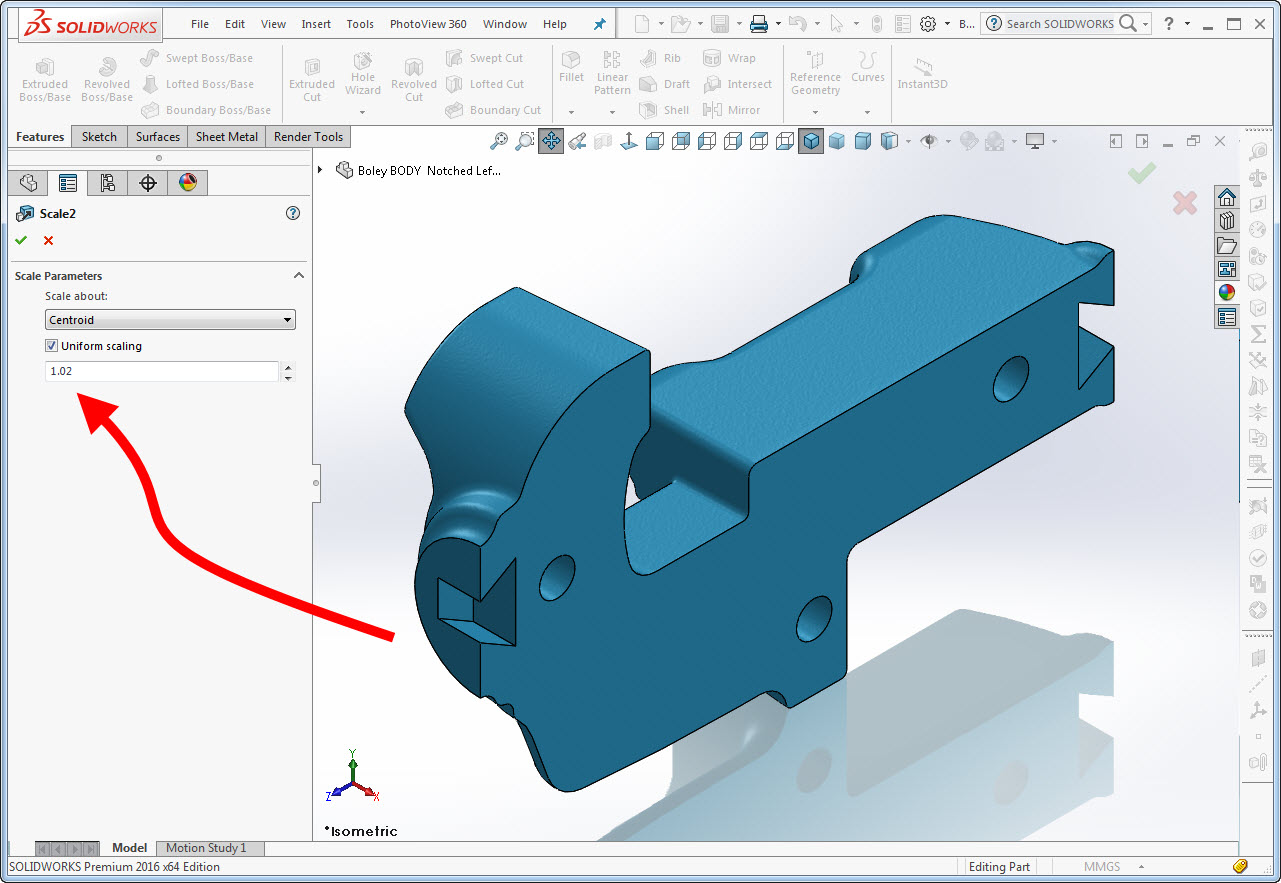

Created the designs with SolidWorks CAD software ... then Split the patterns ... and added alignment holes ... and then converted the files to .STL ... and then 3D-Printed the patterns.
Attachment 10048

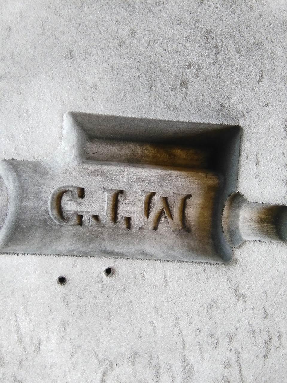

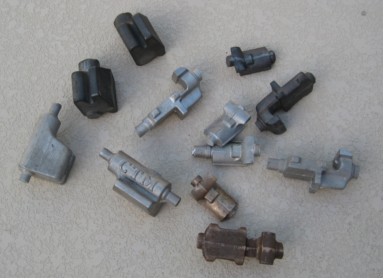

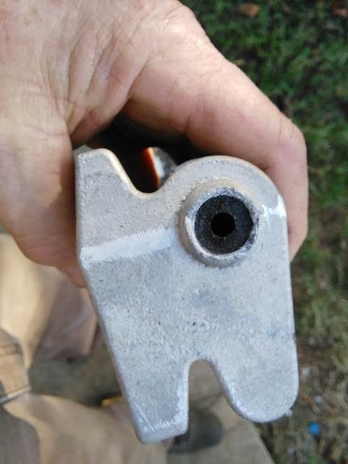

SuperDave cast some of my part designs and some of his part designs.
Attachment 10044
It might take me a while to machine all these castings, but I am looking forward to the practice.

We draw the pattern designs in SolidWorks and then 'Centroid' Scale-Up the patterns to account for cooling 'shrink' of whatever metal going to cast them out of which works very well to create accurate dimension final castings.

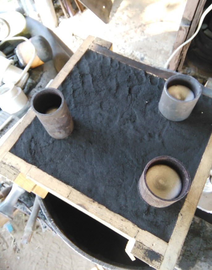

Experimented using carbon rods for cores (Including Air Carbon Arc Gouging Rods)
SuperDave's Idea!! :clapping:

Short 2 minute video showing the SolidWorks Assembly Design ...
https://youtu.be/91v1Hc2XCuE
