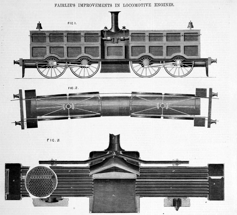

Built as standard gauge series number 2 of the FAIRLIE ENGINE AND STEAM CARRIAGE CO. LONDON.
"Double Fairlies" were articulated, all wheel driven mostly for steep, small radii narrow gauge railroads.
The first delivered were to Ffestiniog Railway in Wales. (Note 1)

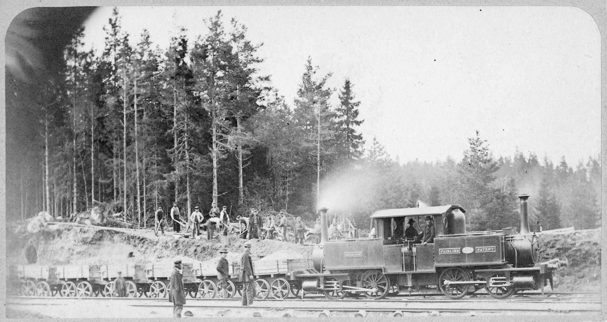

Attachment 32908
#2 was delivered as Nässjö-Oskarshamns Järnväg's locomotive #1, bought and renamed "Hultenheim" in 1874. (Note 2)
It was owned and used by the contractor, Morton's, for building the very same railroad during its first years.

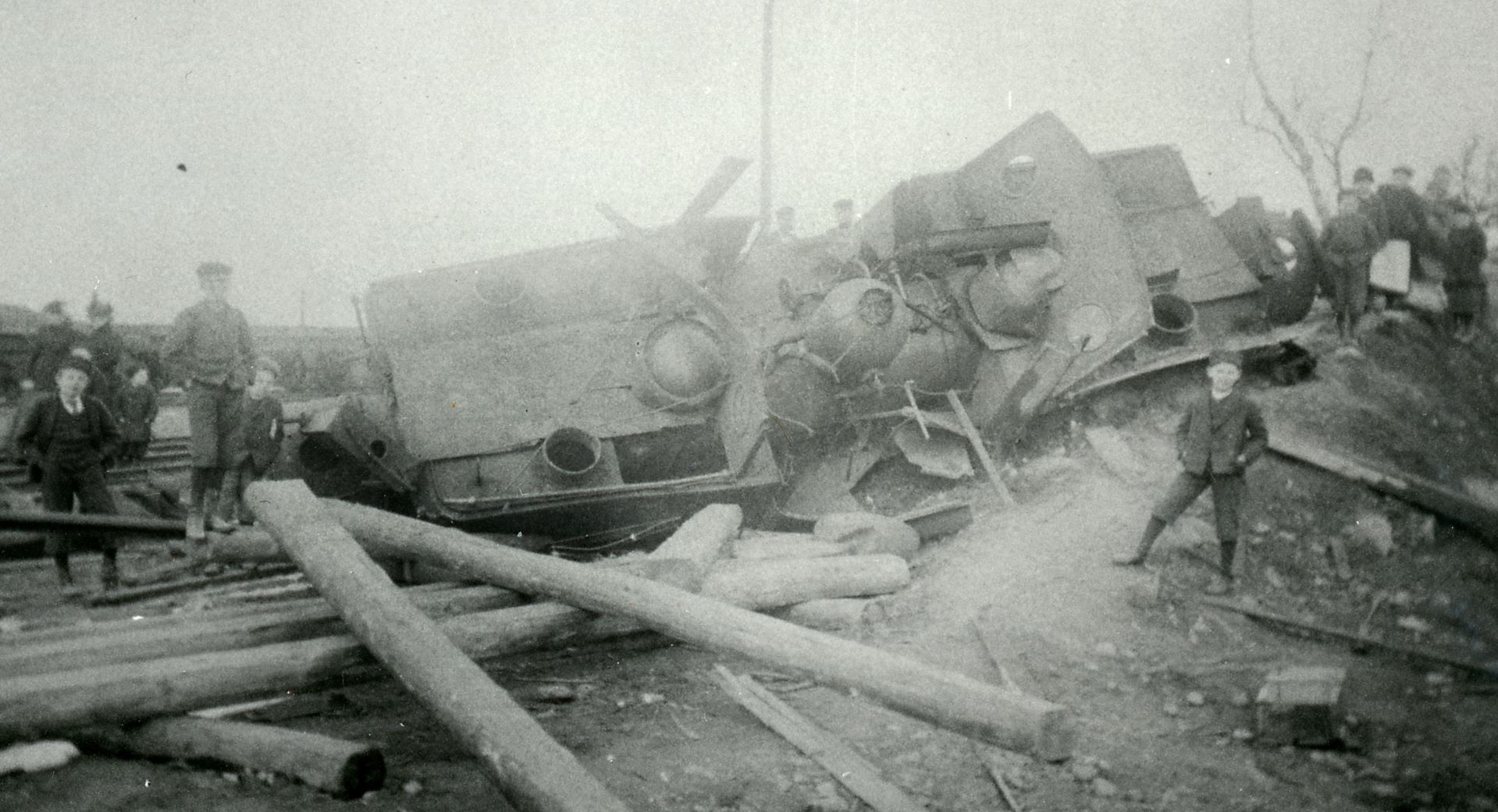

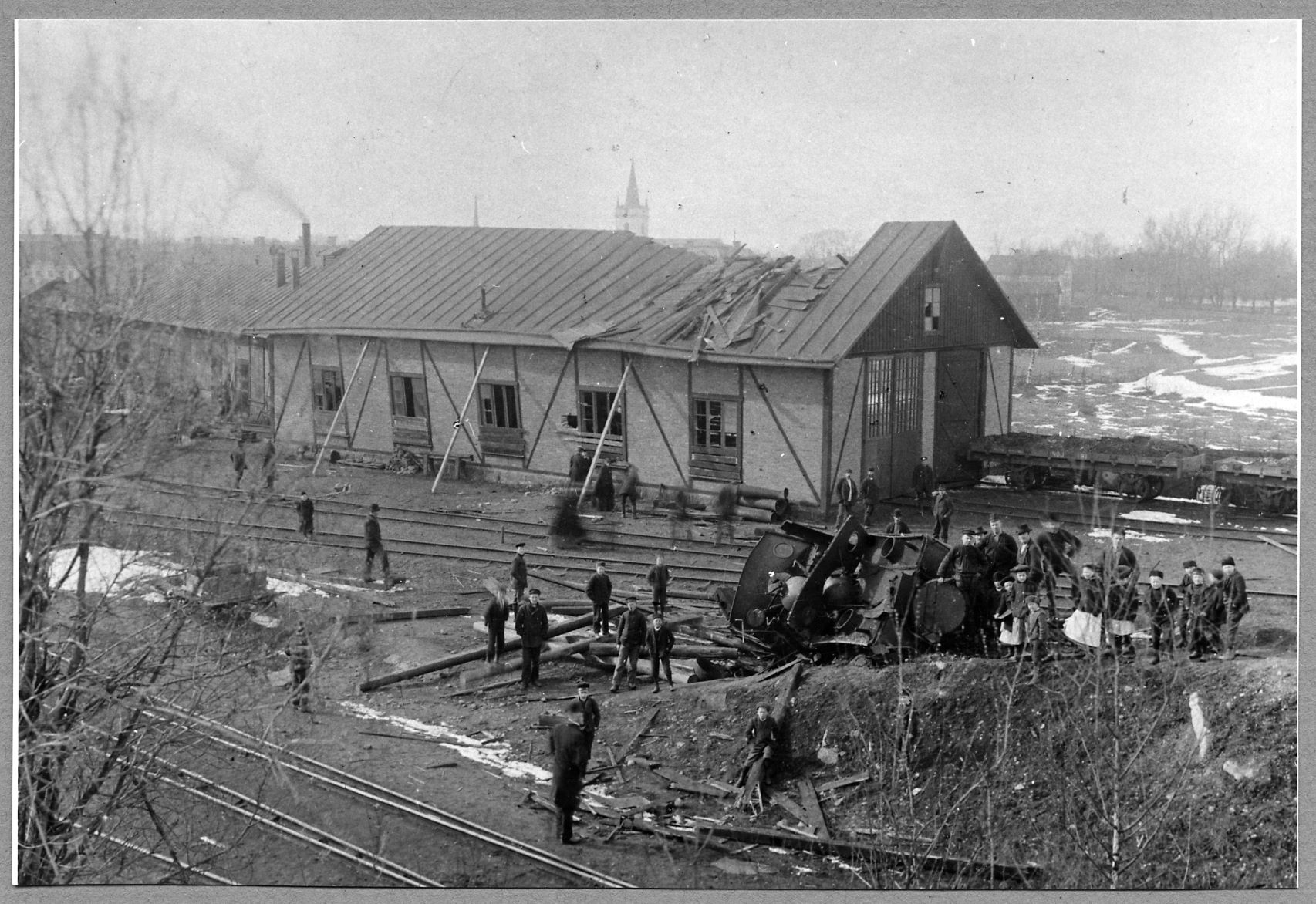

32 years later, at 11.25 AM on Tuesday, April 8th 1902, this had happened:
Attachment 32909
-What series of events led to a 28+ metric ton locomotive levitating upwards, out of its shed
and plummet down on a small hill 25 metres away?

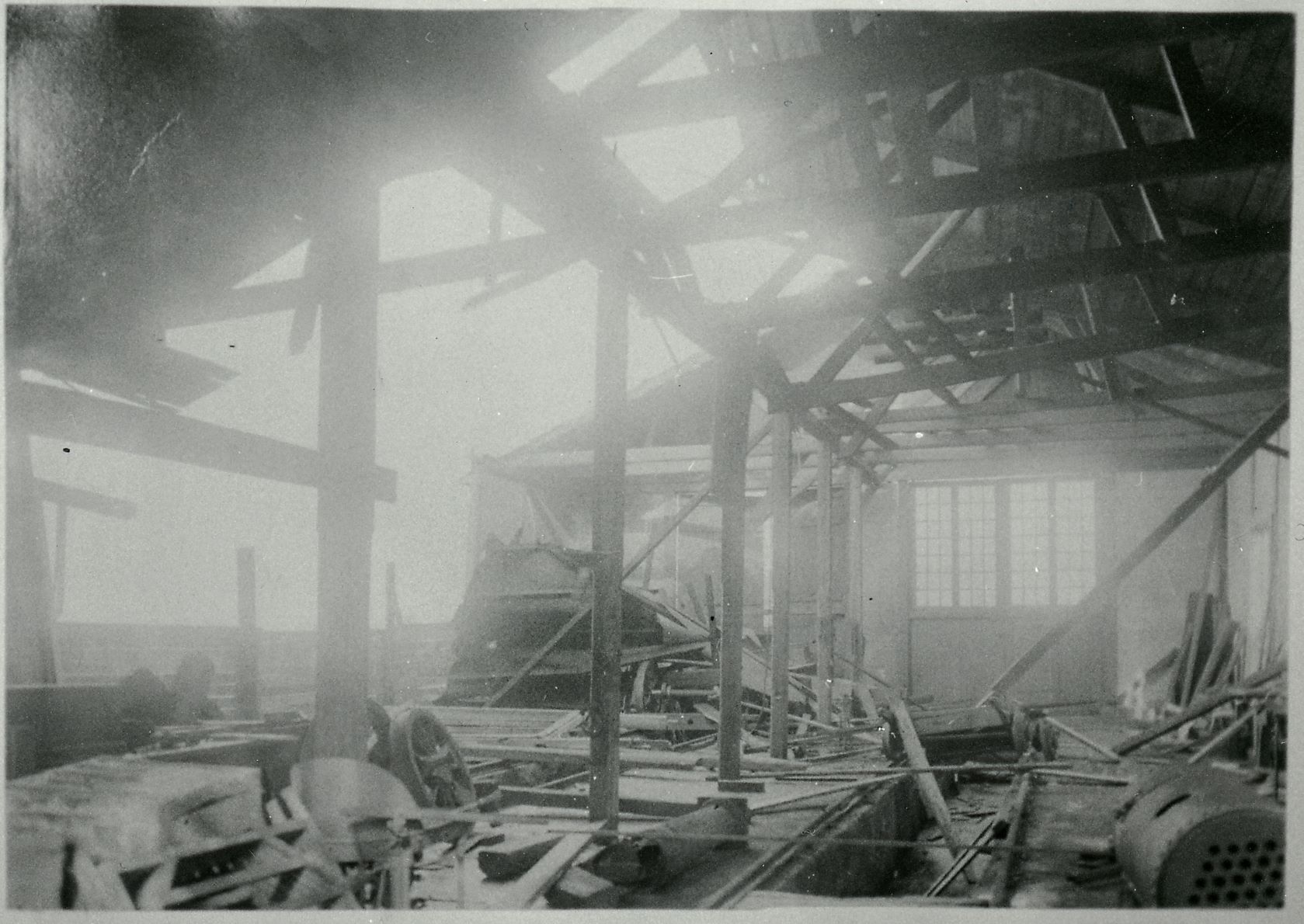

Closest shed brick wall is gone, the other propped up, the ceiling blown off.
Attachment 32910
Amazingly, no one of the seven persons in the shed was killed in the accident.
Casualties:
C.M. Sand, Chief Engineer (also young stoker at the top pic) had one lower leg broken off and lacerations.
J. Nilsson, Supervisor, also suffered a leg broken as well as lacerations.
C. Petterson, lacerations and concussions from getting hit by flying wooden beams from the former ceiling.
So - what happened, and why?

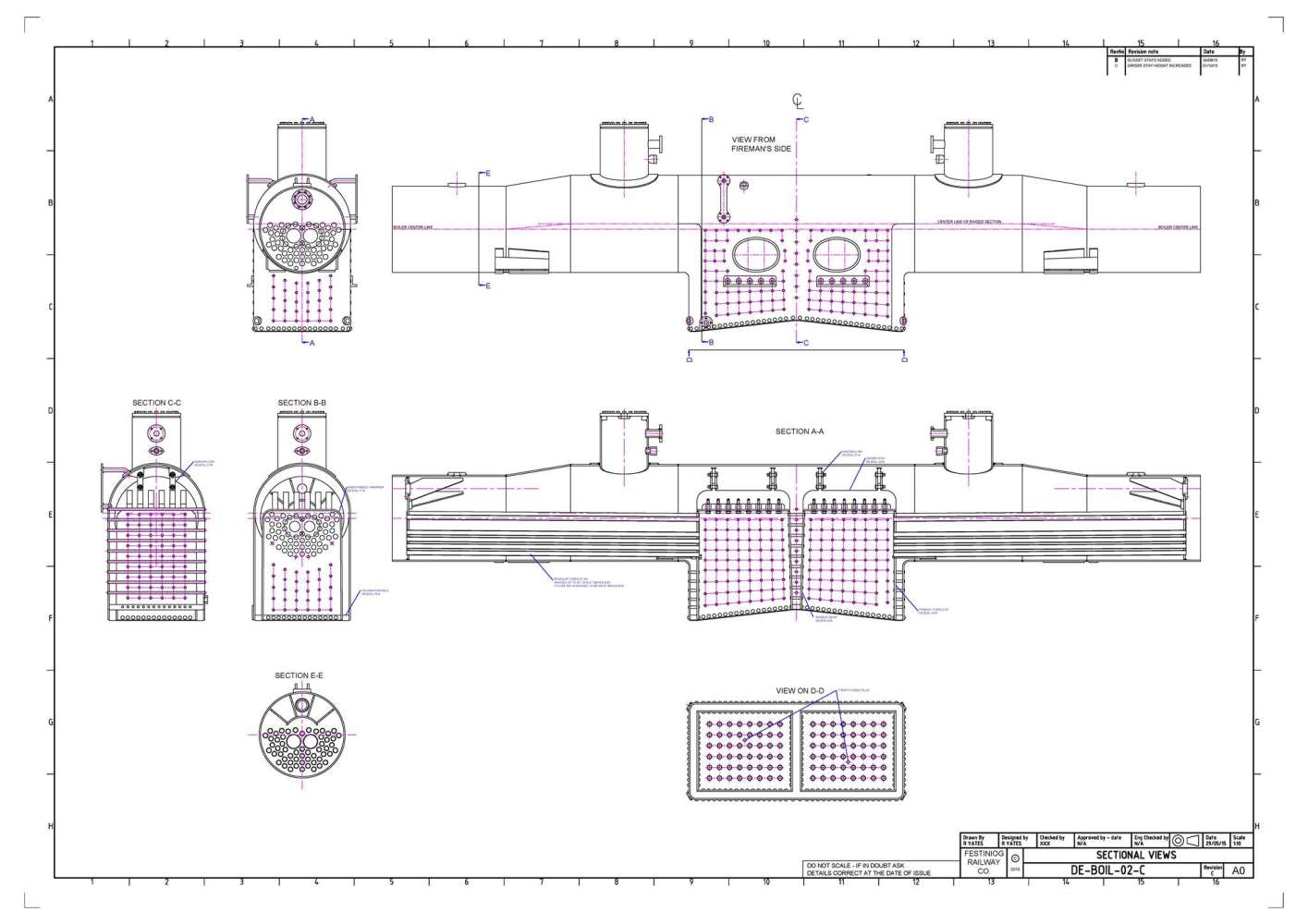

Attachment 32900
The #1 loco have had a 30 year service, and was overhauled at Eksjö to finally become a shunter.
Note the boiler pic above - rather two boilers back-to-back with a firebox each.

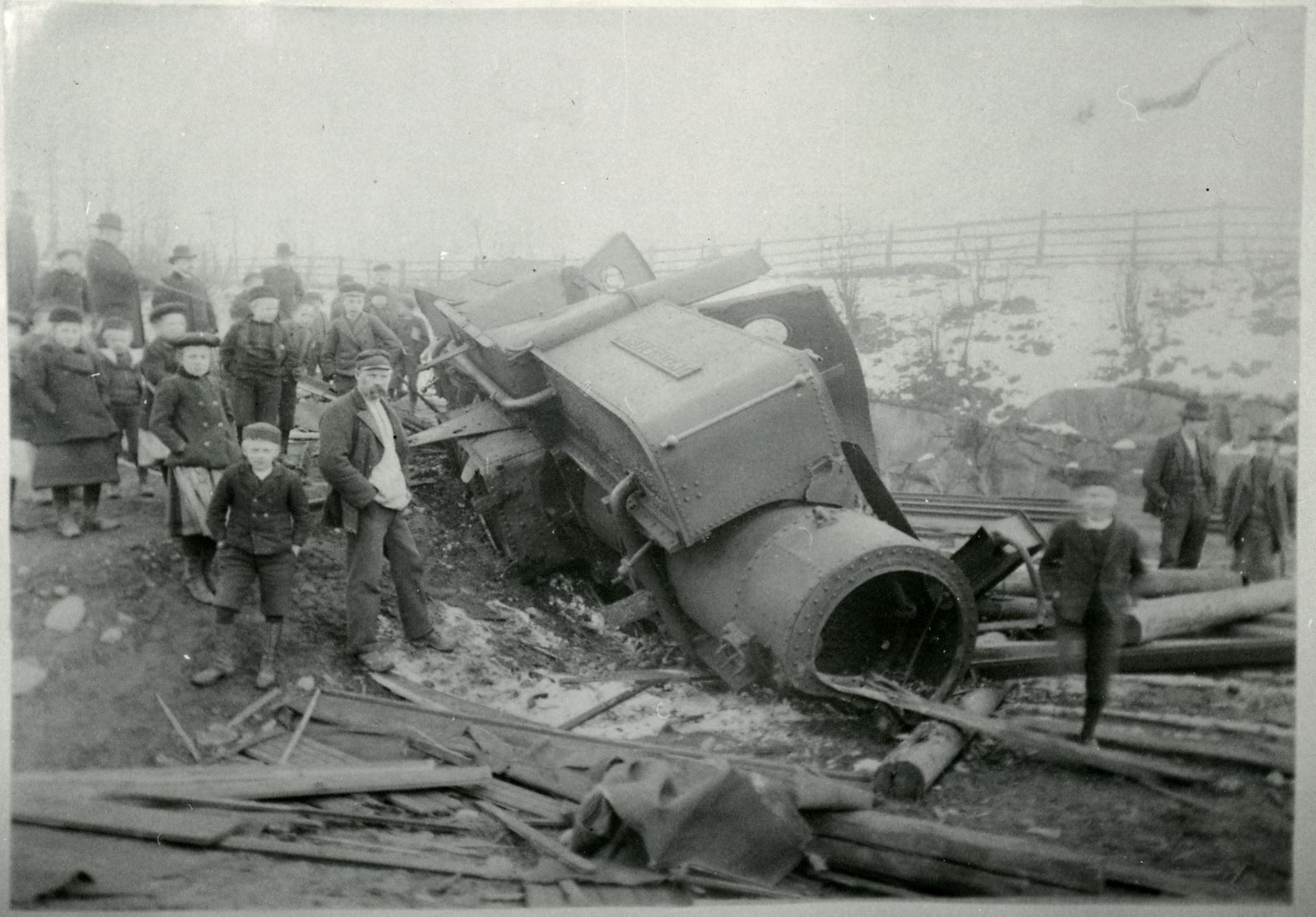

Hot pressure testing had started without realizing that a lead washer,
used from the previous cold pressure test to protect the gauge, was still in place.
-Did I forget to mention the safety valves had also been firmly tightened down?
This washer apparently had a smallish pore in it - as the gauge climbed during firing,
finally to set at at an comfortable 8 atm (130 psi) in spite of further stoking.
This continued for a good while, but when the Chief Engineer perceived something was very wrong,
and finally yelling for the fire to be put out, the loco took off thru the ceiling, just leaving its two drive bogies behind.
Attachment 32901 Attachment 32902

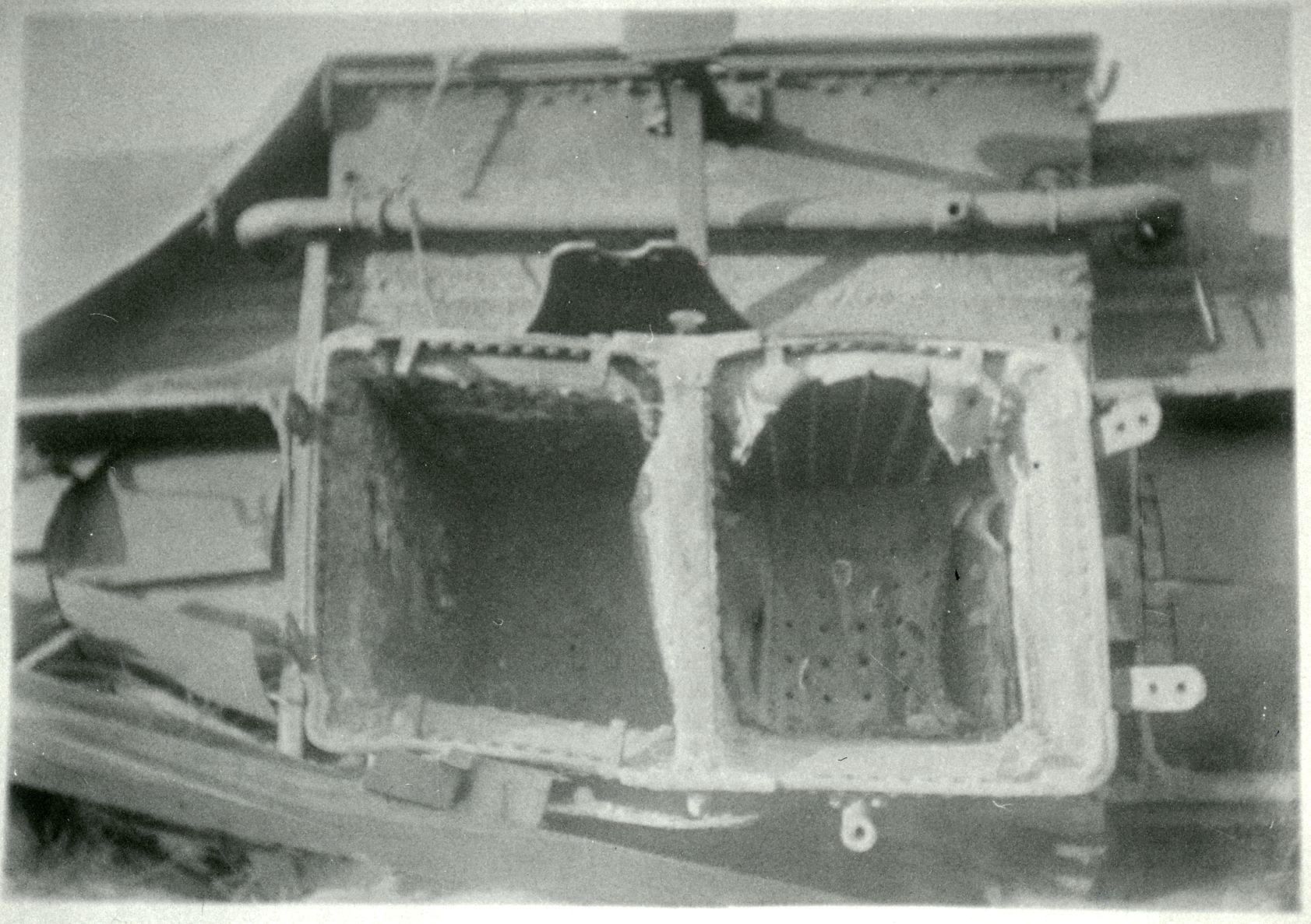

-Why UPWARDS, you probably ask?
Seems like the 2 boiler ends towards the fire boxes gave in (or rather out), converting the superheated liquid water
into a pillar of expanding steam going downwards, blowing away the grates and ashpans, lifting the upper loco part,
tearing off the steam tube bogie pivots leaving the cylinder frames on the shed's track.
View from below, upwards into the fireboxes:
Attachment 32903

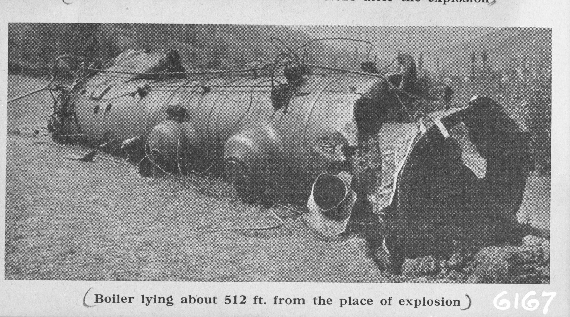

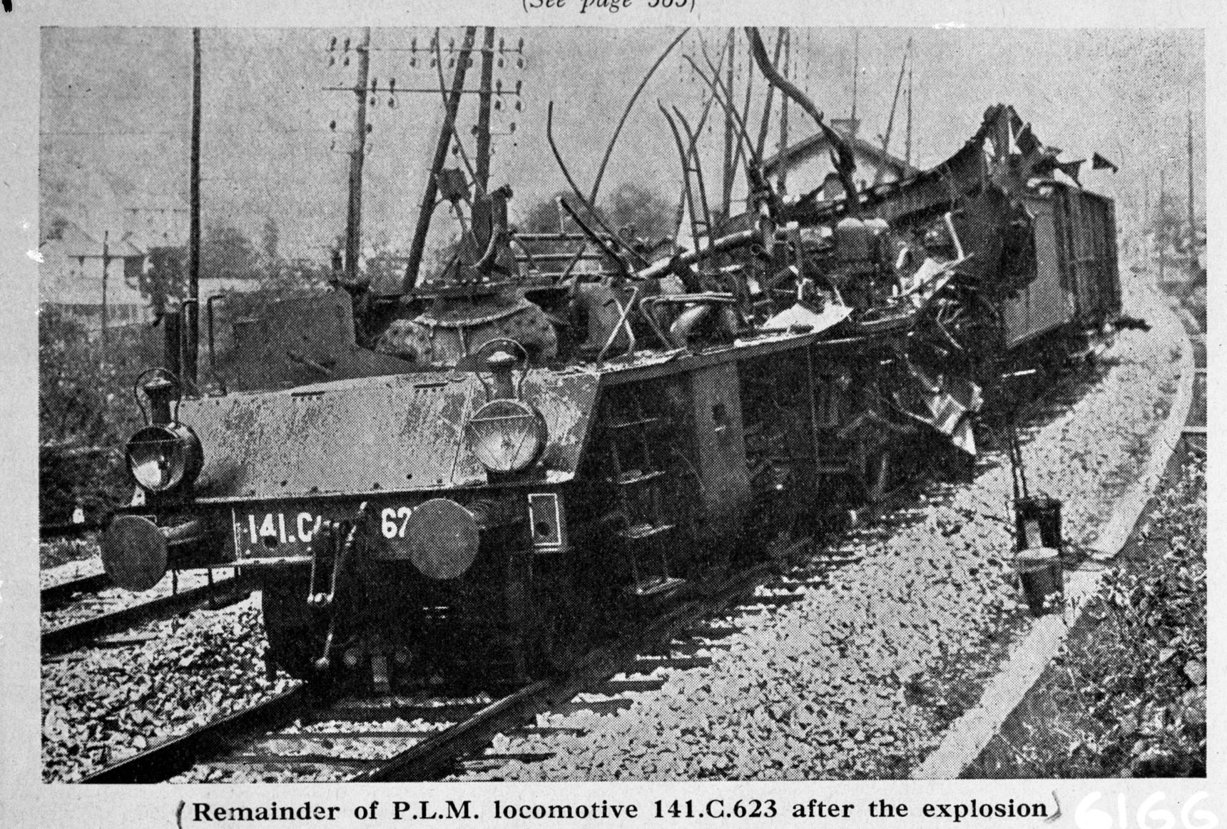

Boiler explosions from firebox failures in ordinary locomotives usually result in more horizontal missiles:
Attachment 32904 Attachment 32905
But as the Fairlie had two boilers back-to-back, the steam had nowhere else to go but downwards,
thus raising the loco up, up and away. Pretty simple, eh? Case closed.

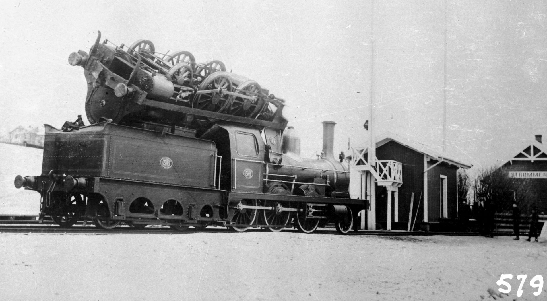

-Now try to figure out the reasons for this pic from Strömmen, Norway in 1889:
Attachment 32906
Thanks for putting up with my story this far!
