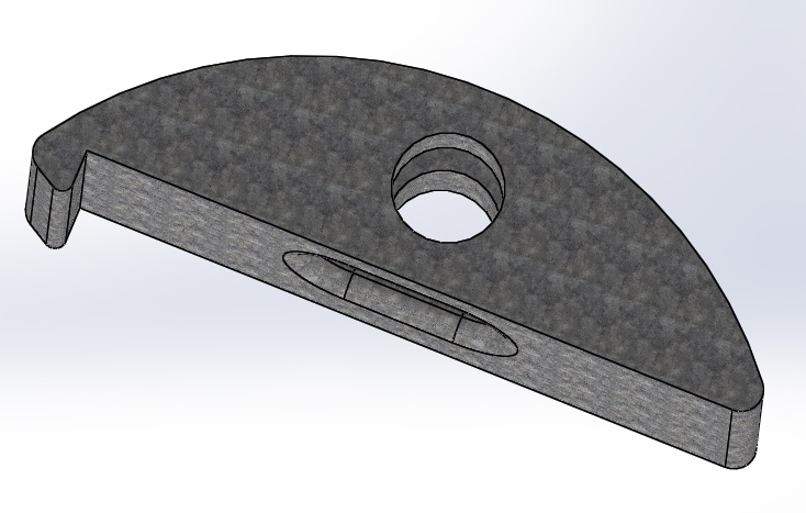

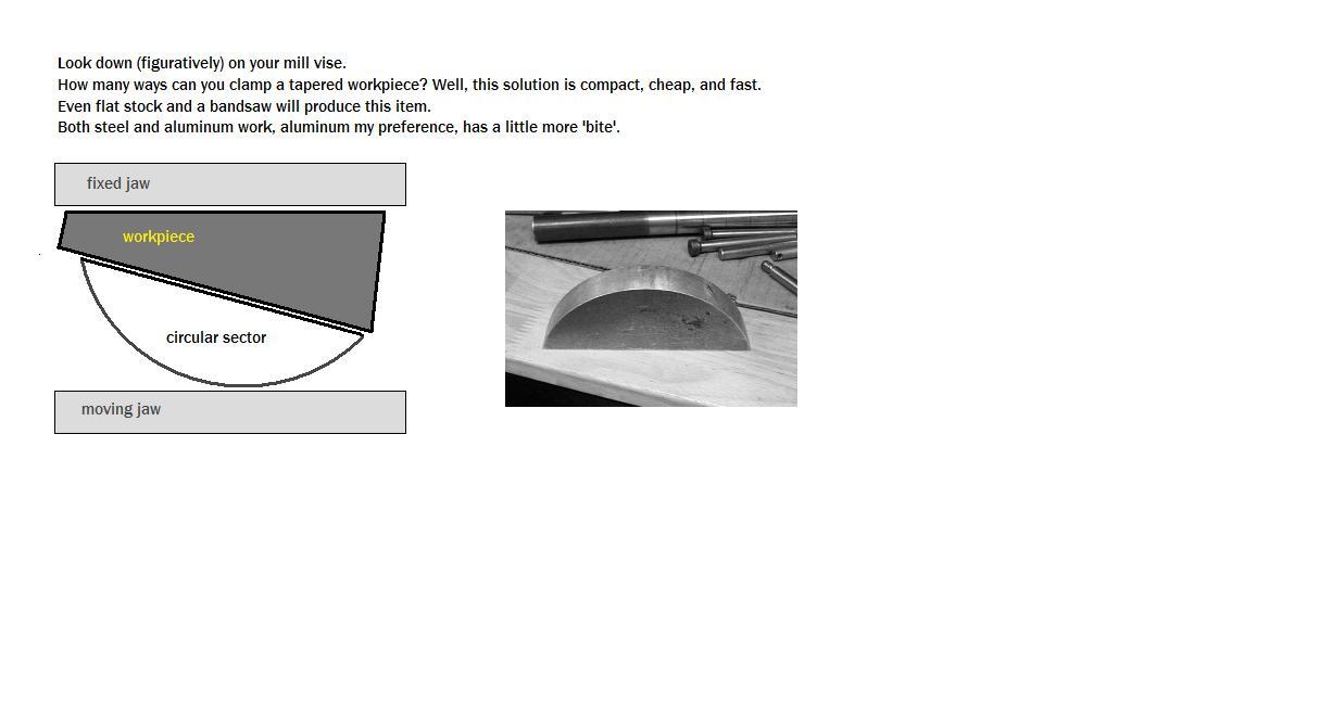

TM 51 this tool is yet another fine example of the often times simplistic approach to HMT's yielding un-imagined use results prior to their addition to ones tool inventory.
I have used similar shaped pieces with a single protruding tang extending a ways out from the flat face which would engage a dibbit or indention to hold extremely odd shaped parts when using my 4 jaw. Many times no matter which way you try to position the part you just cannot get that 4th jaw to engage in a secure position these little cord segments can be used where the grip surface is just too accute to successfully clamp the part the tang will provide a bi-angular clamping forceAttachment 12903
Excellent Frank S! The simple projection engages corner of part; a vast improvement. Great use of mechanics/ physics to rectify an issue. Mine will 'spit' off steeper angles, without some material to increase friction. Mechanical engagement beats coincidental friction every time.

TM 51 if you will note there are also holes drilled and slotted cross angular in the center this adds to the versatility of the cord segment clamp with the use trunion toggles or just bolting it in place on a mill table or it might come in handy

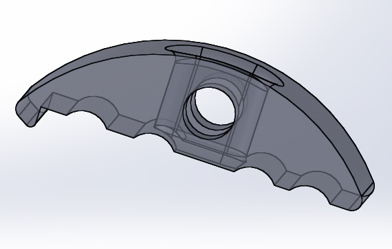

Adding semi circular indention's to the flat face increases the holding possibilities on misshapen parts Attachment 12910
Yes, serrations direct x-amount of force to reduced area increasing bite. Cross hole is good idea, still blind to the feature of perpendicular slot, maybe to clear an ear-like projection a casting may have?
Frank replied it makes it a hold-down with milling clamps, makes sense. Wring a project for multiple usage, why not?

The slot allows the clamp to be used on a mill table making this a hold down clamp as well

TM51 and FrankS. It's crazy how just as I'm contemplating how in the hell I'm going to hold a tapered arm like what is in the original drawing by TM51, here's the solution. I never would have thought of this, thanks guys.
I'd add knowing you have a bandsaw, heavy wall pipe works too. Might need to weld a brace to control spreading, but the chord ends make good teeth.
