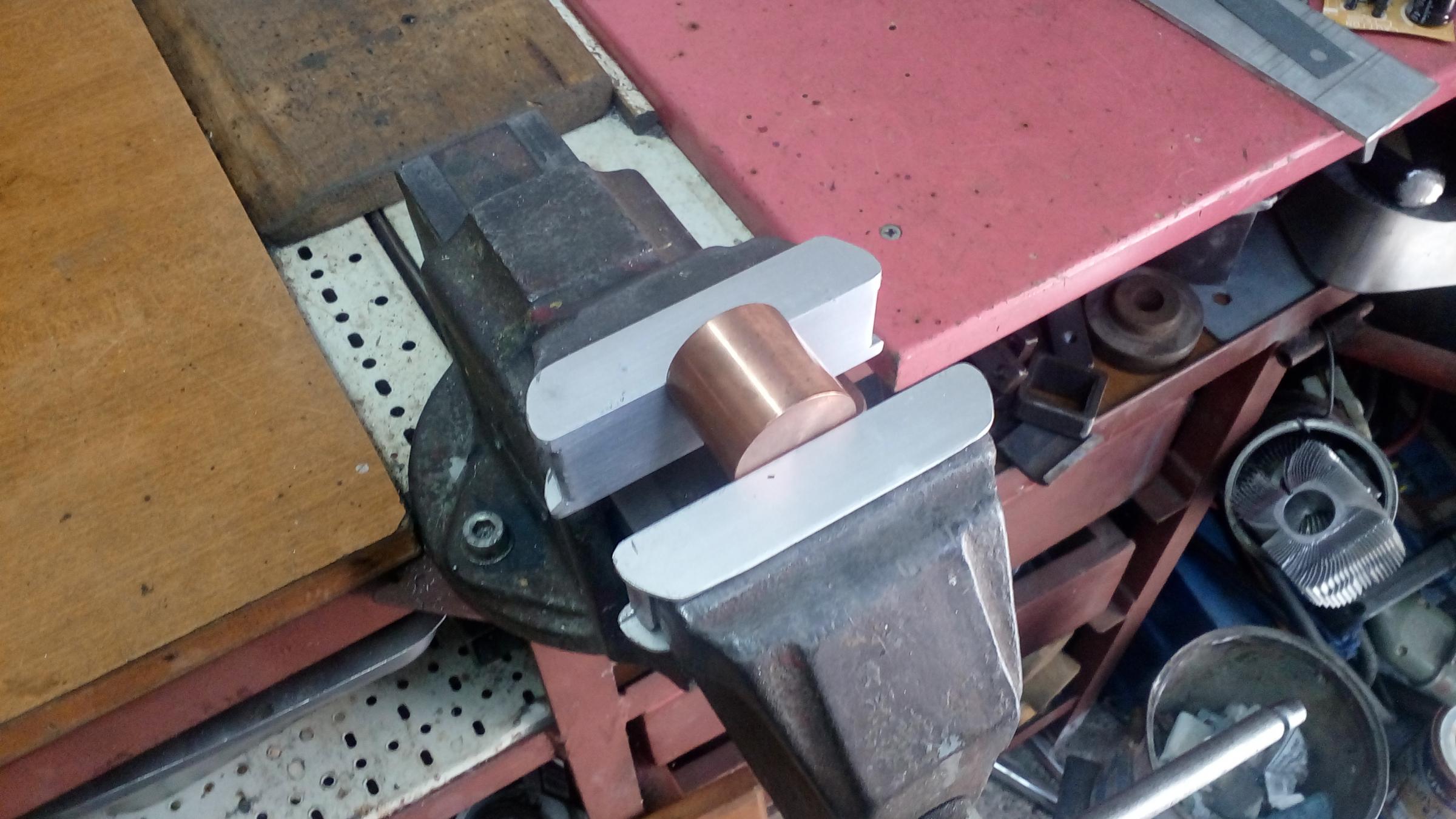

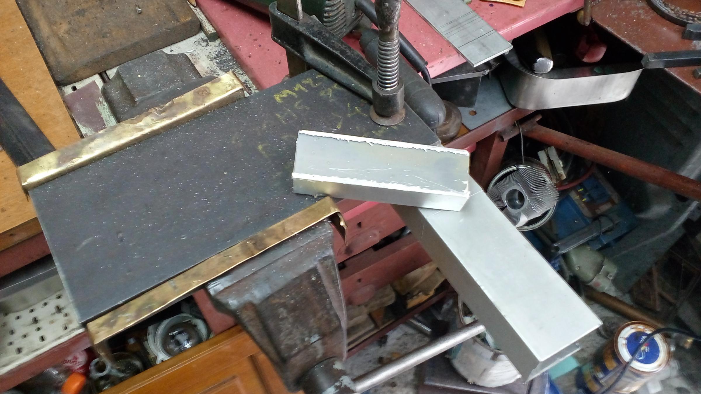

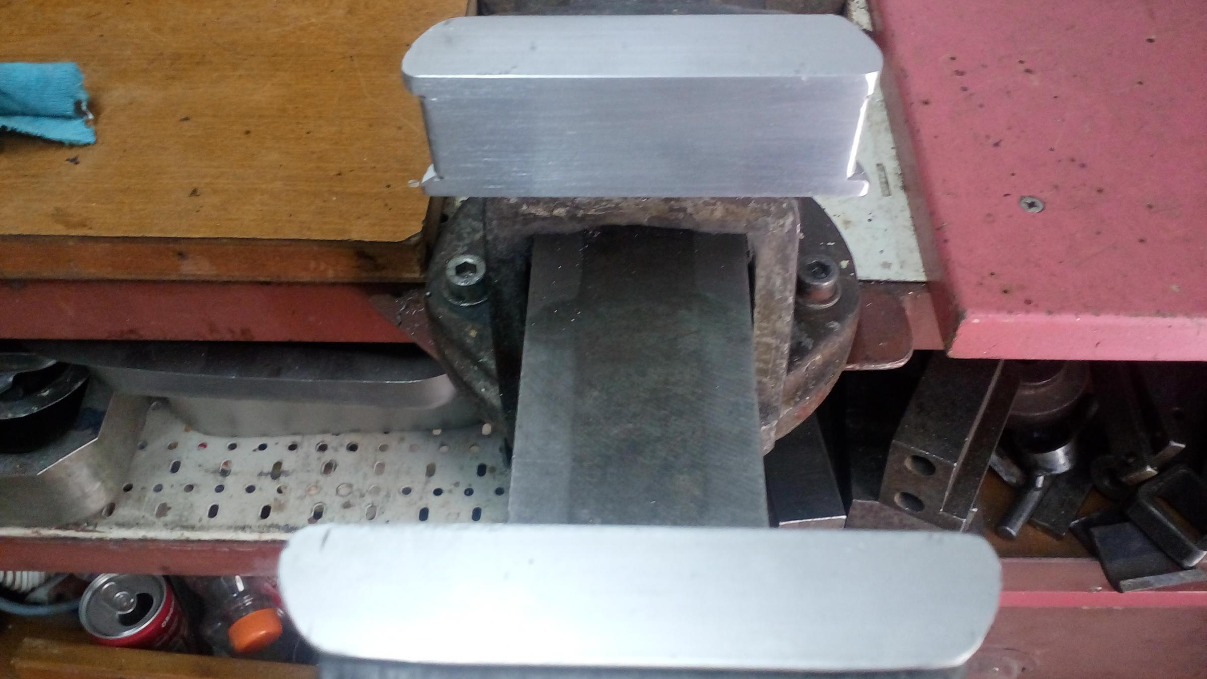

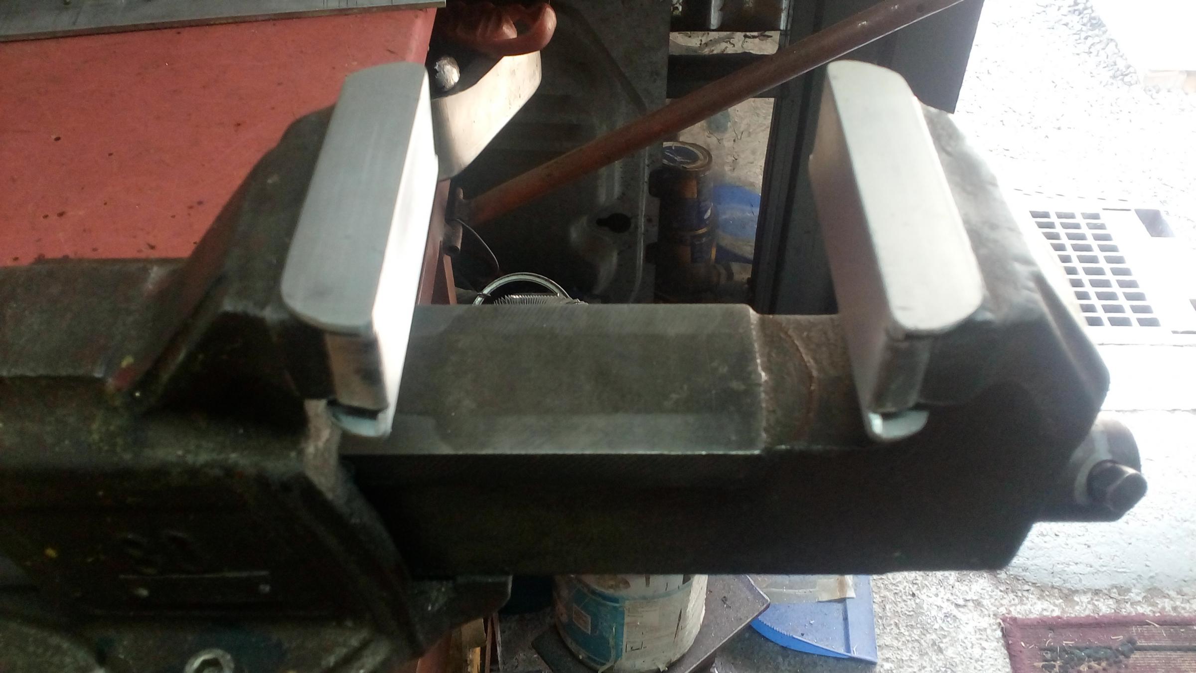

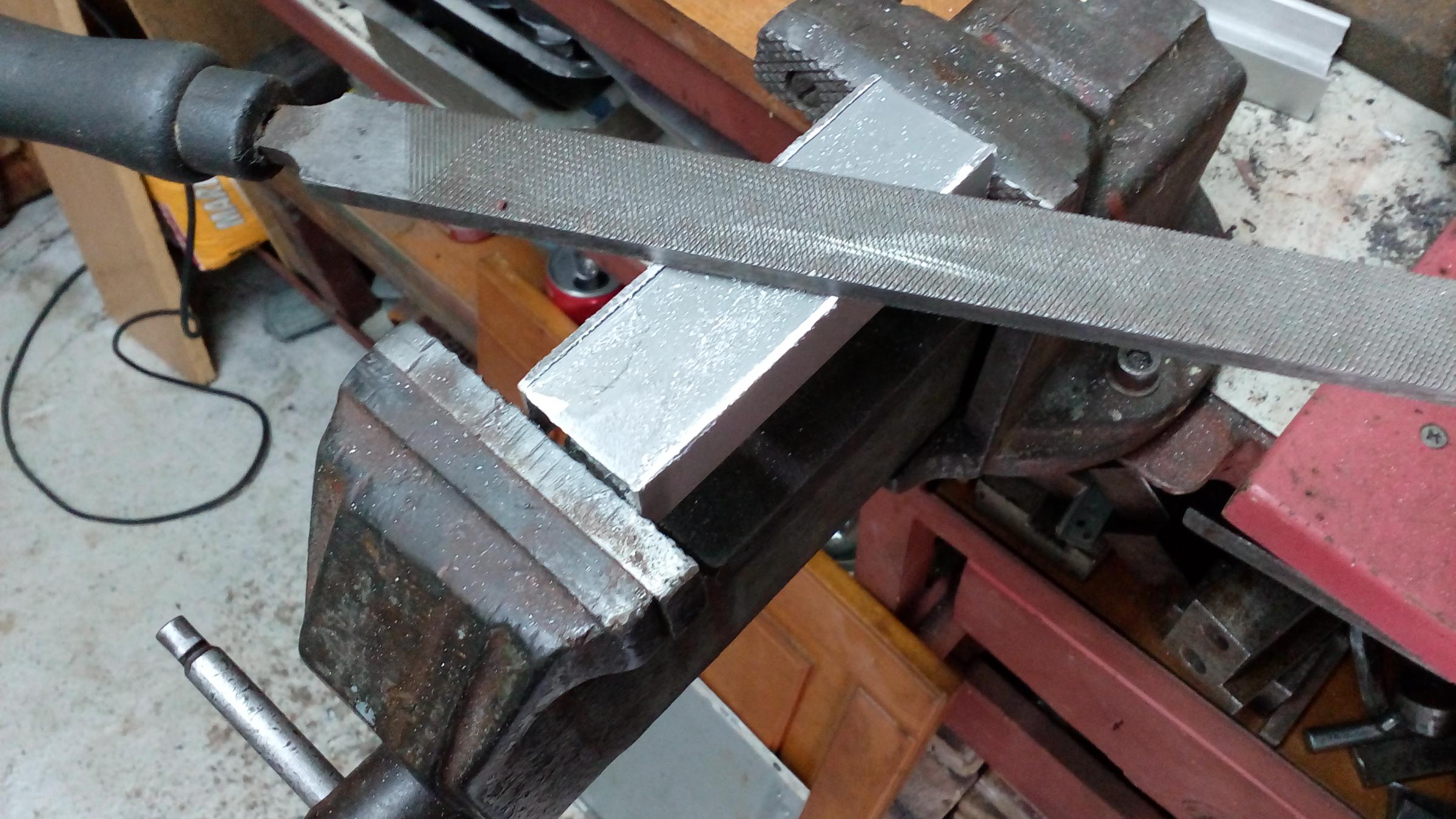

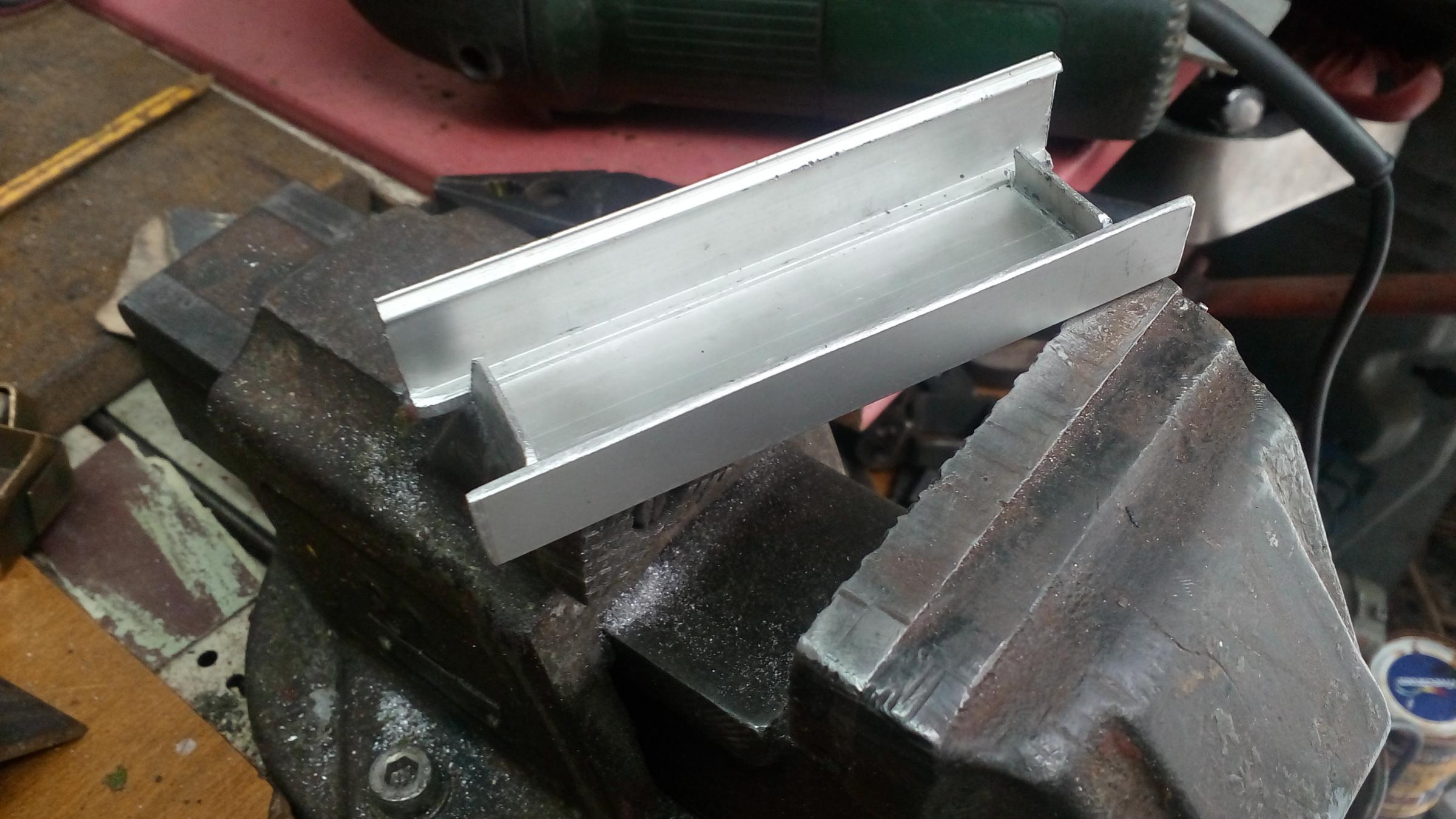

It is often a problem when working that the hardened steel serrated jaws on the bench vice will mark or damage the surface of the pieces while machining.
This is especially a major problem when working on soft materials.
To prevent this problem occurring soft jaws or jaw pads are used.
Usually soft jaws are made from Aluminum Bronze Copper or Teflon.
For this build I have use a piece of aluminum profile.
Attachment 36401 Attachment 36402

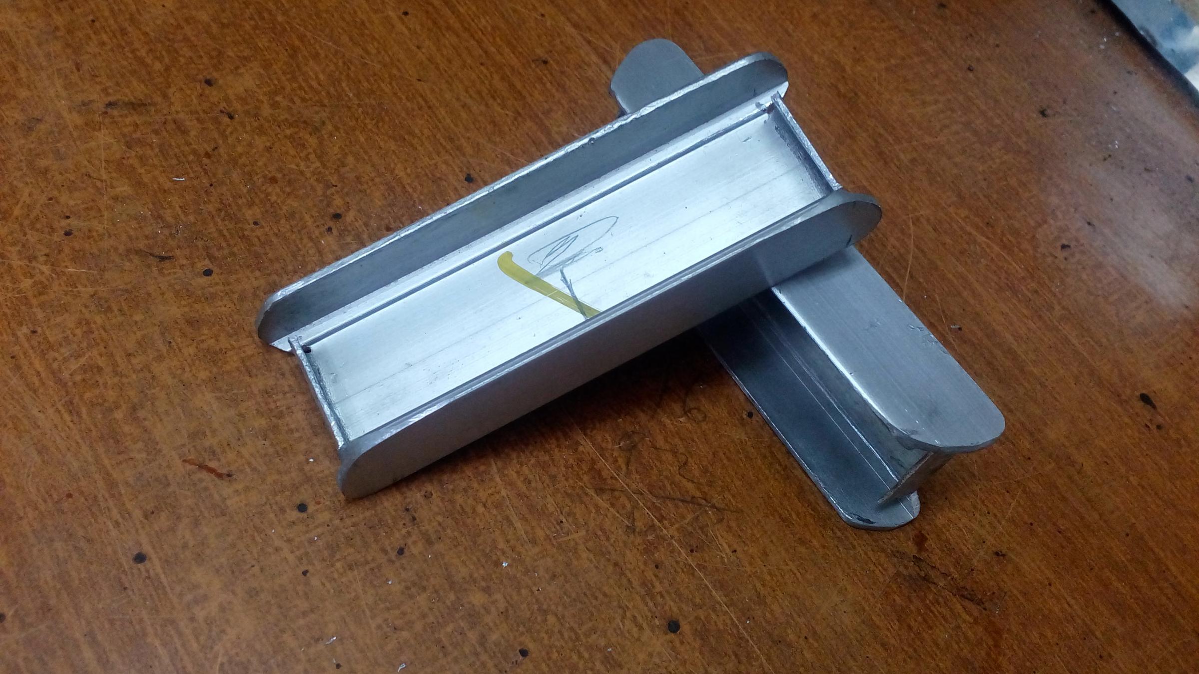

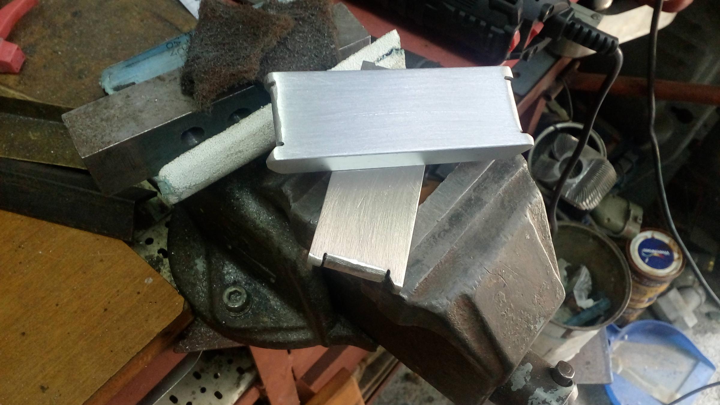

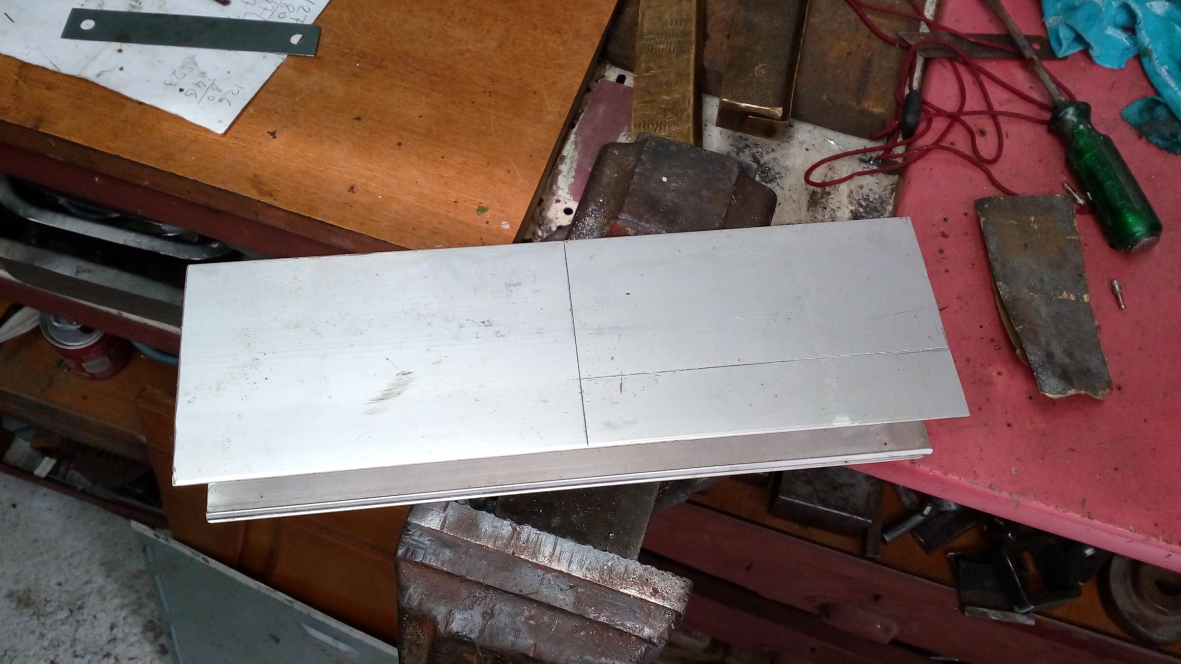

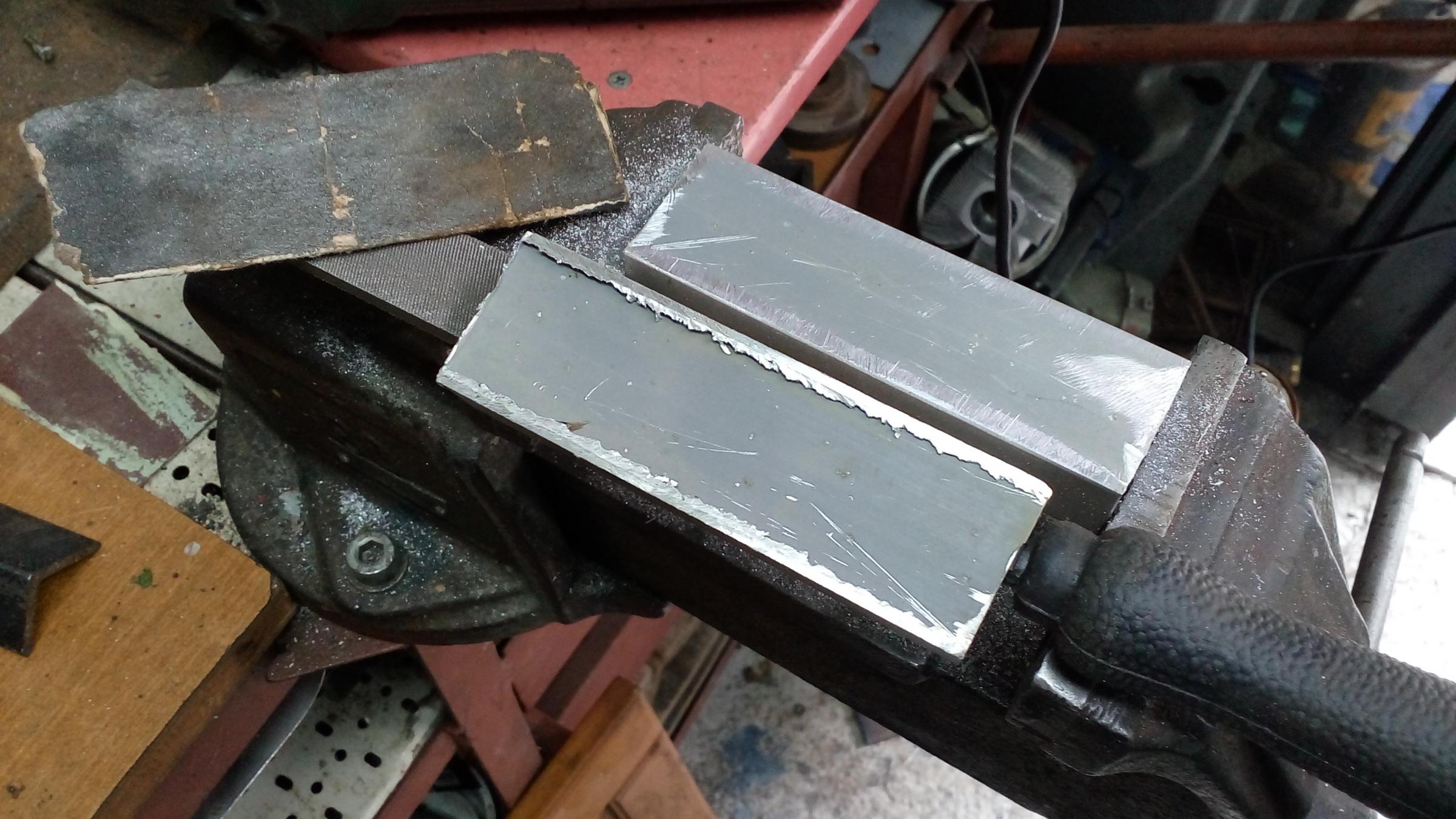

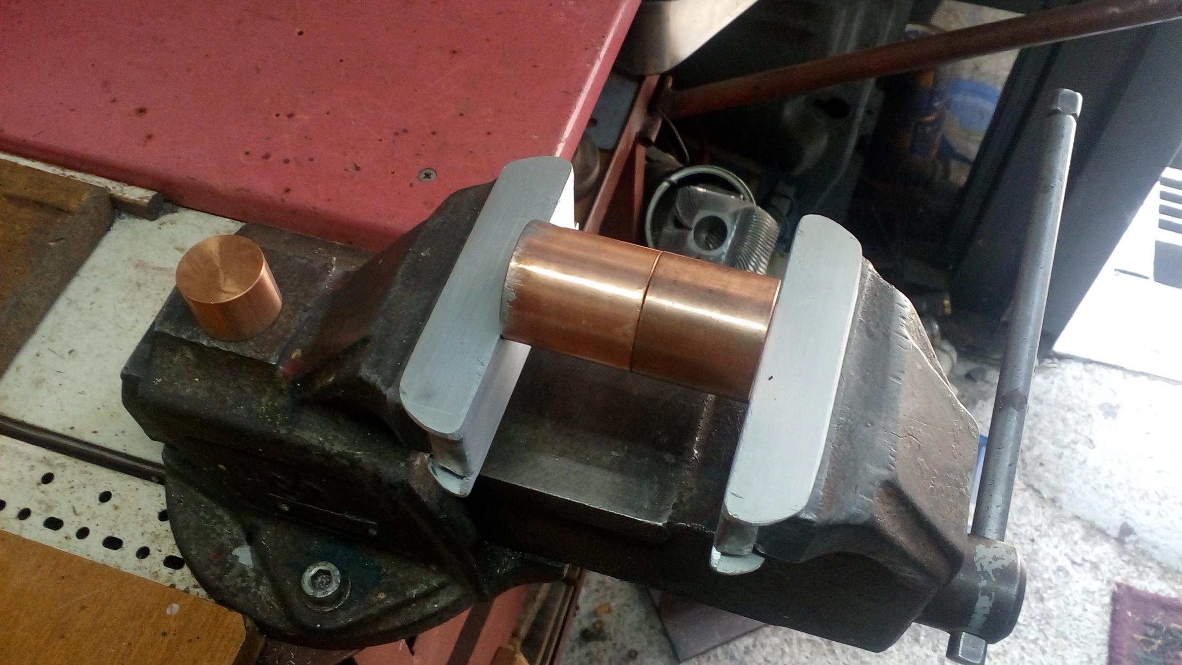

Attachment 36403 Attachment 36404
Attachment 36405 Attachment 36406
Attachment 36407 Attachment 36408
Attachment 36409 Attachment 36411
Attachment 36412 Attachment 36410
