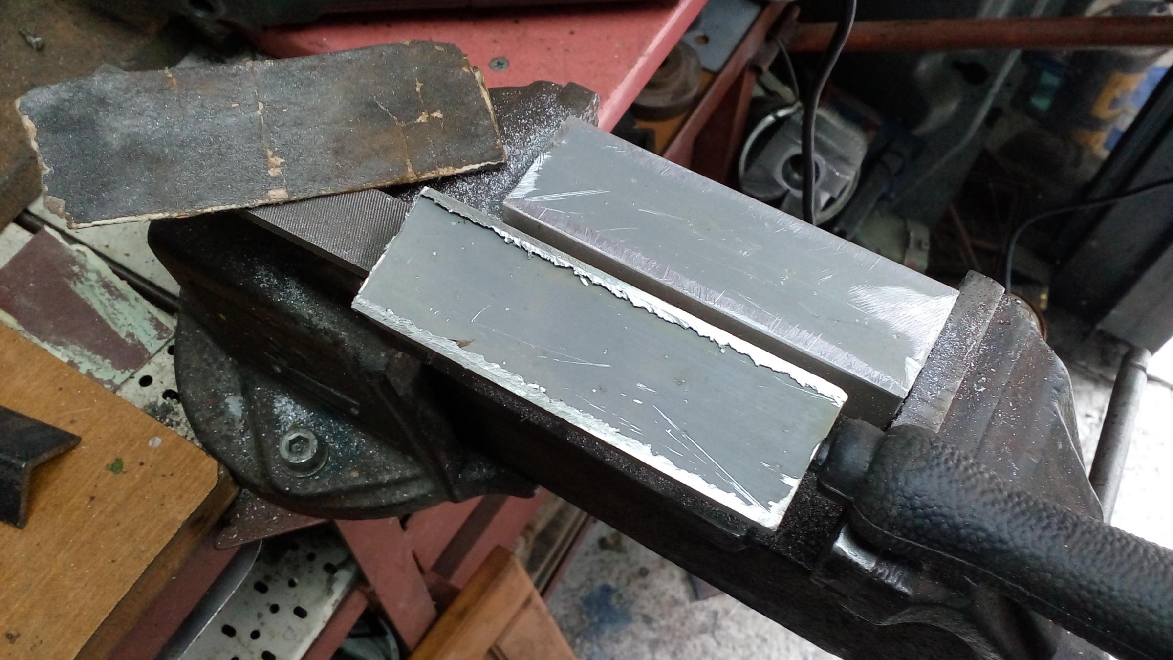

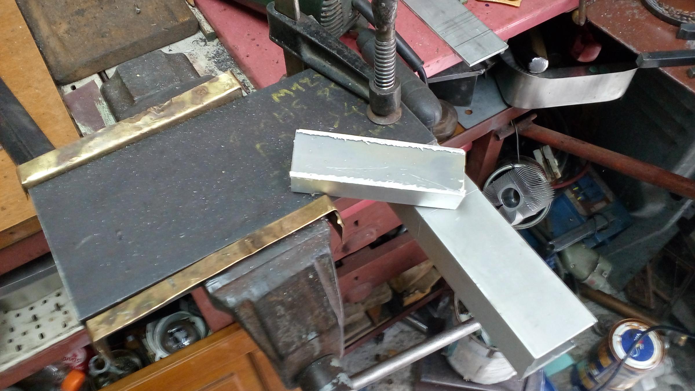

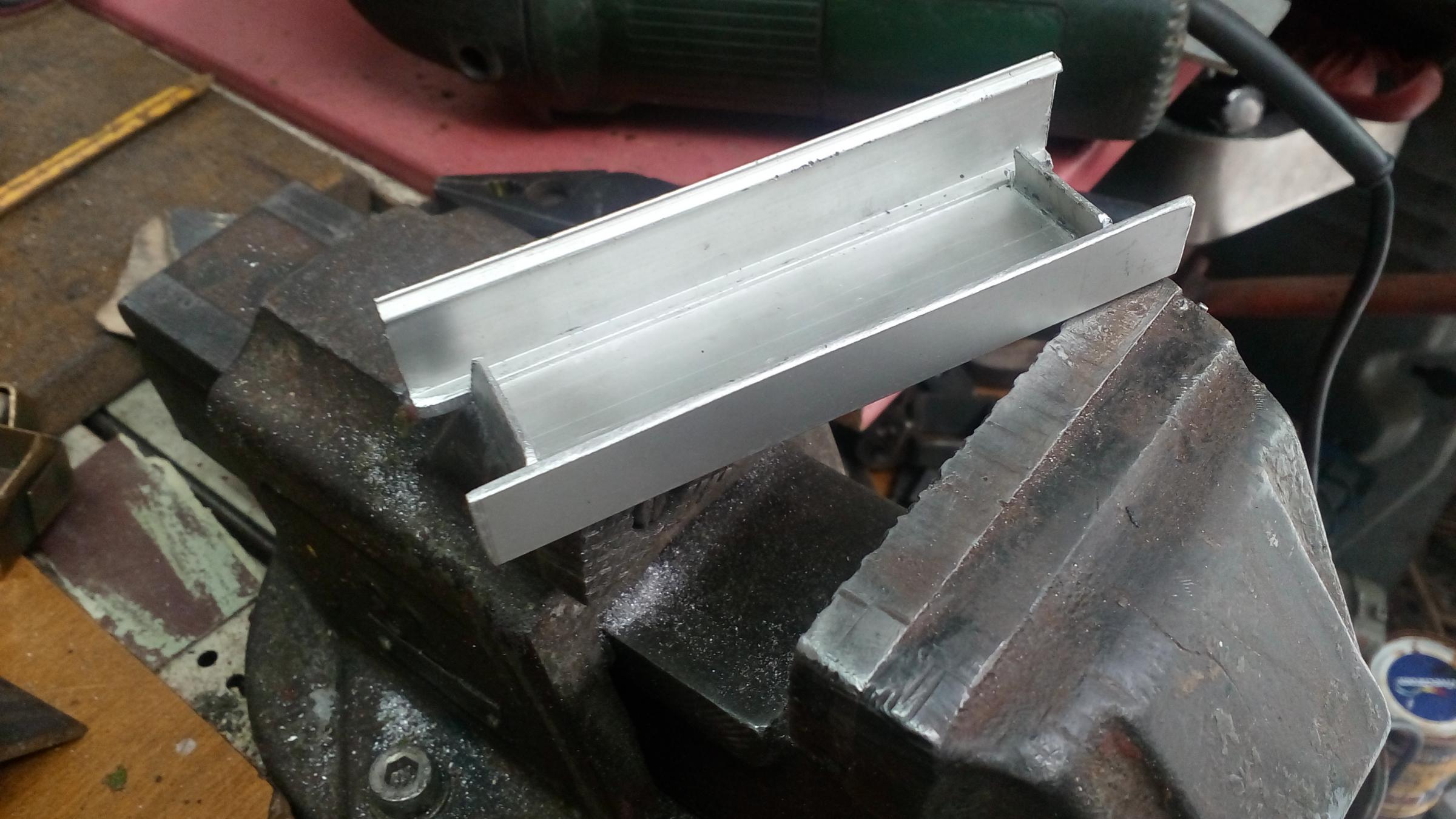

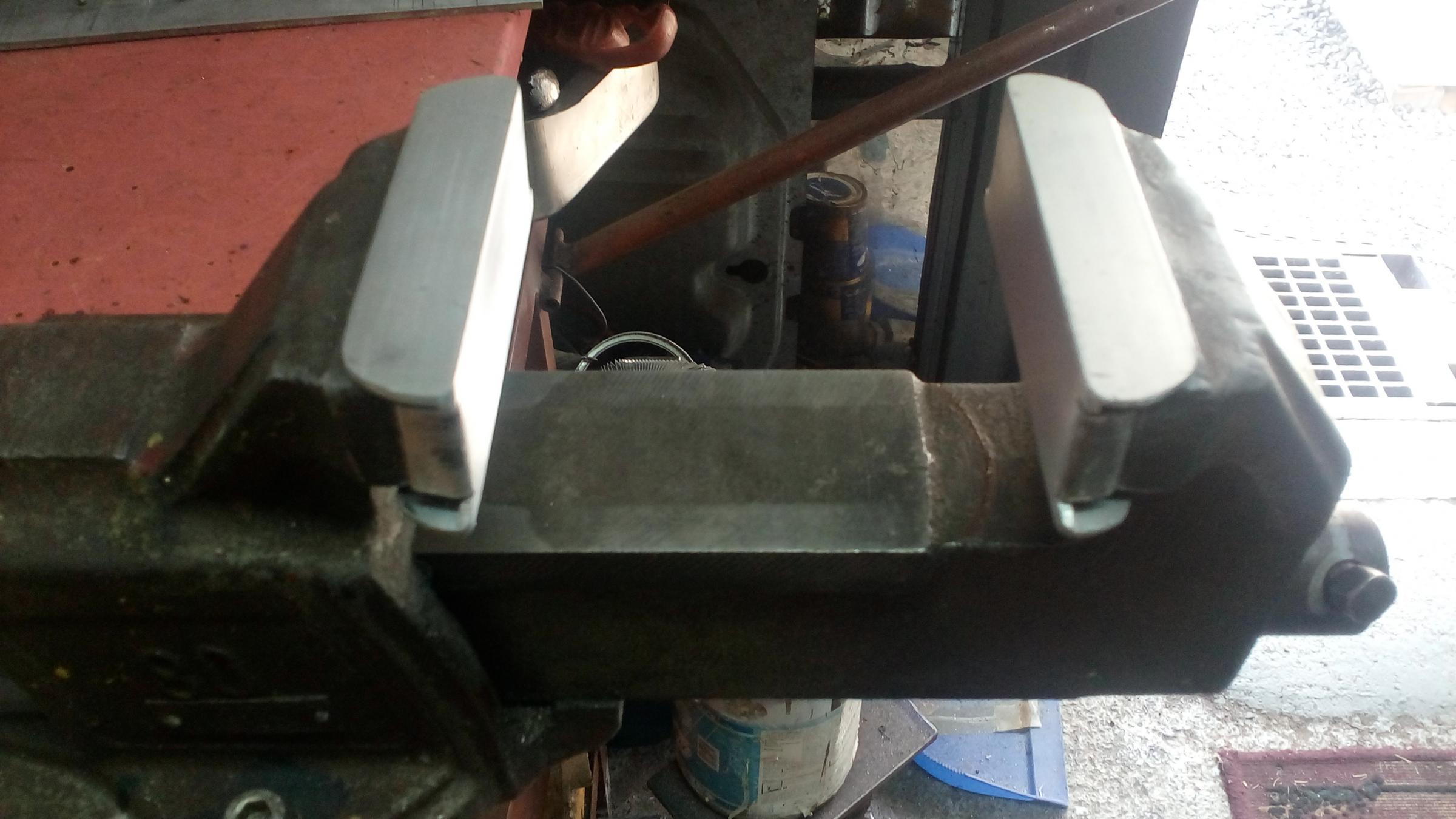

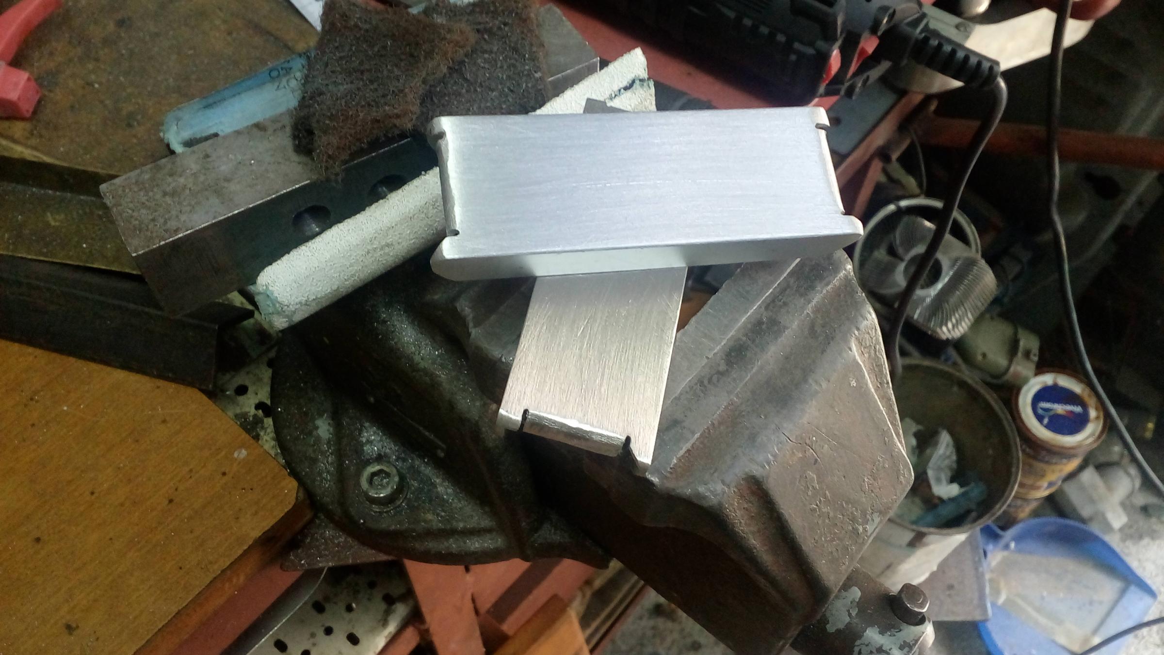

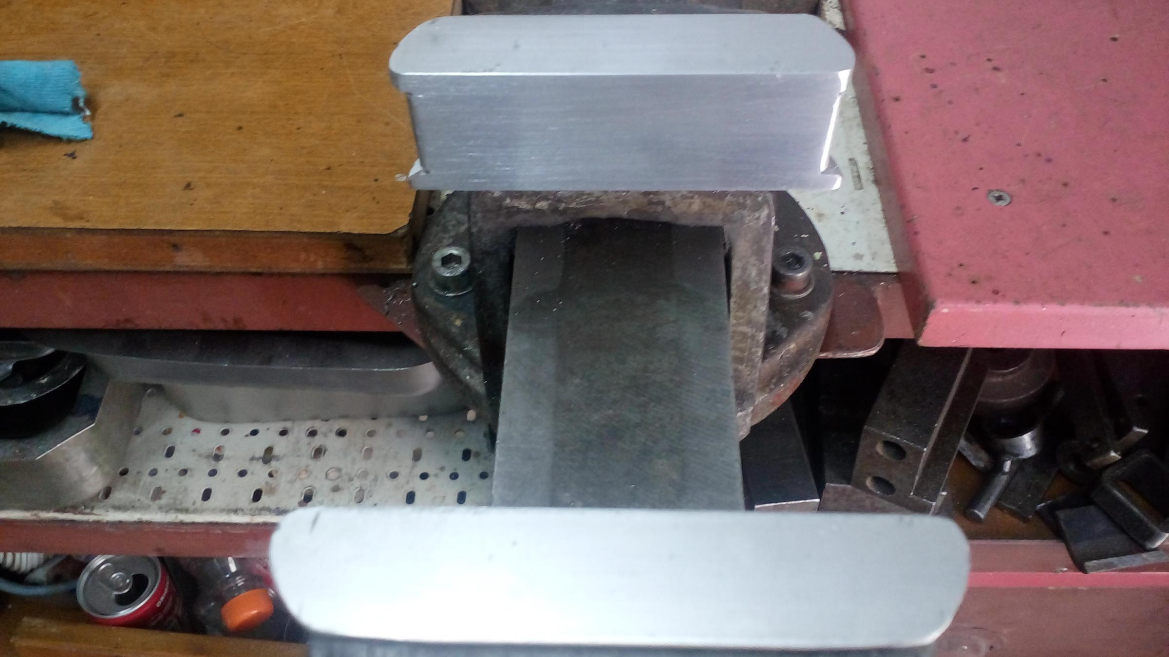

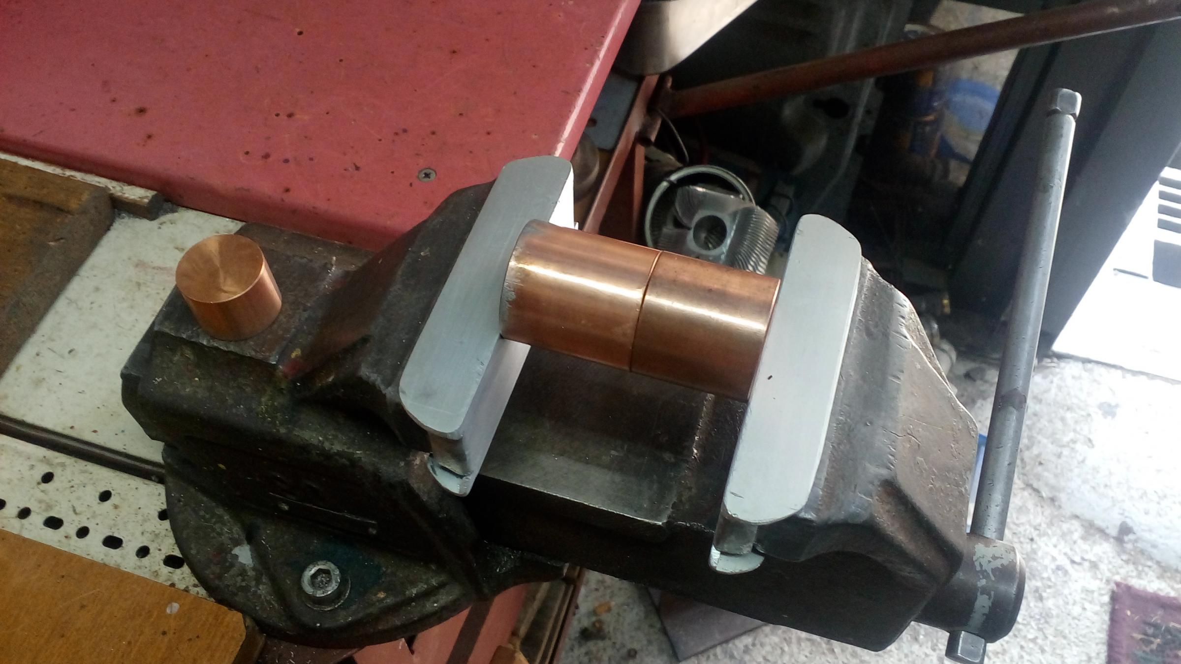

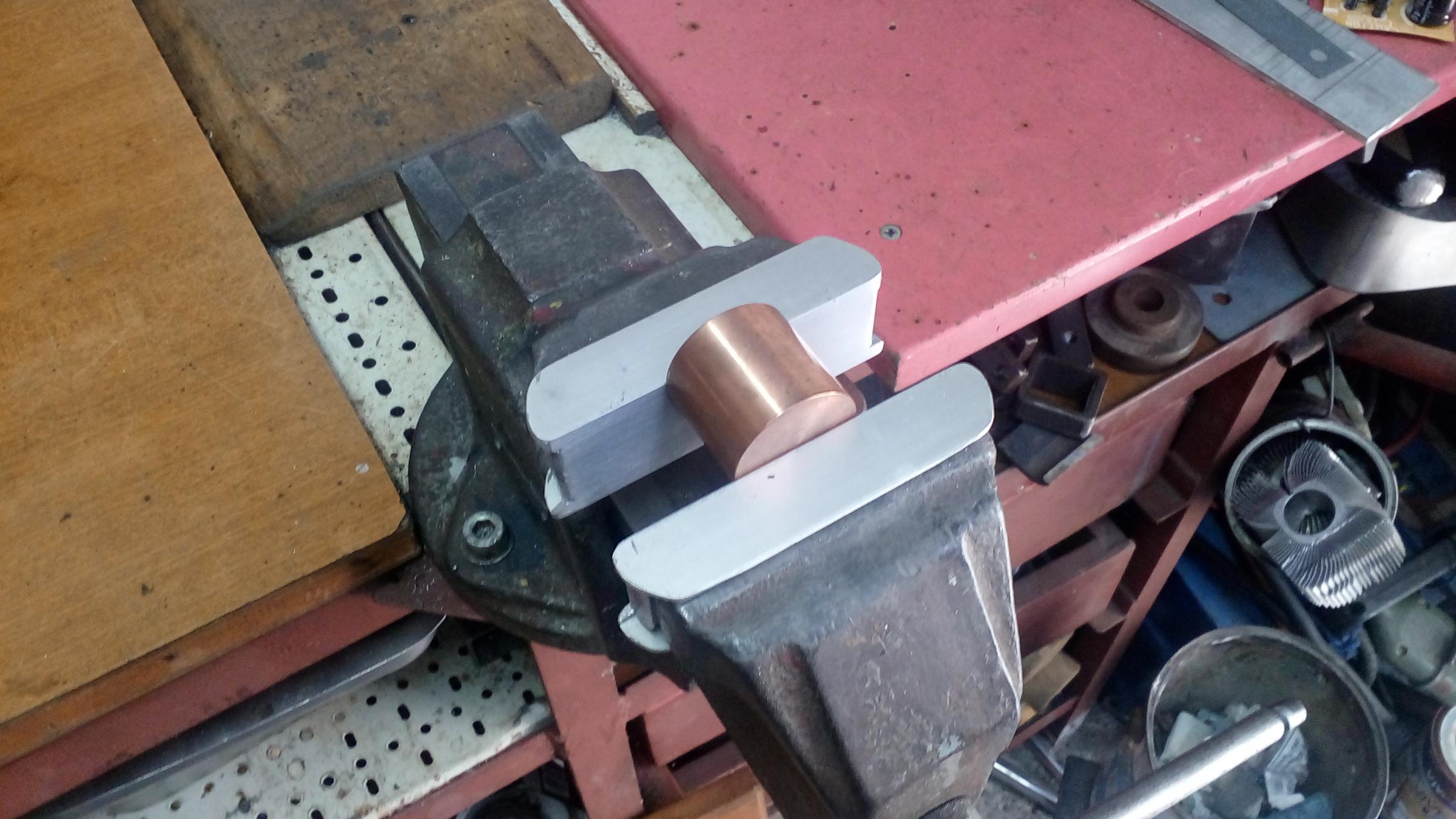

    It is often a problem when working that the hardened steel serrated jaws on the bench vice will mark or damage the surface of the pieces while machining.
    This is especially a major problem when working on soft materials.
    To prevent this problem occurring soft jaws or jaw pads are used.
    Usually soft jaws are made from Aluminum Bronze Copper or Teflon.

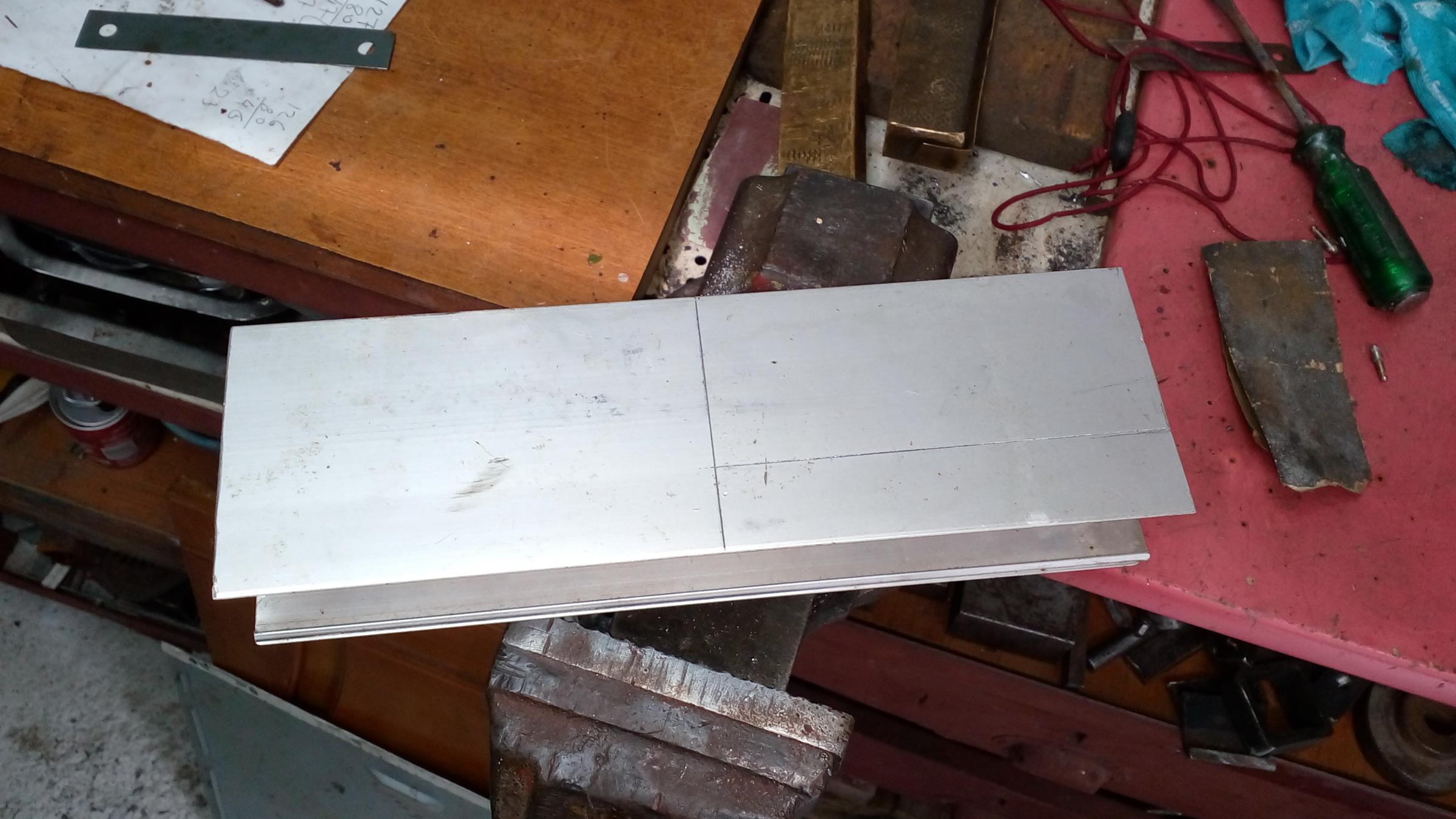

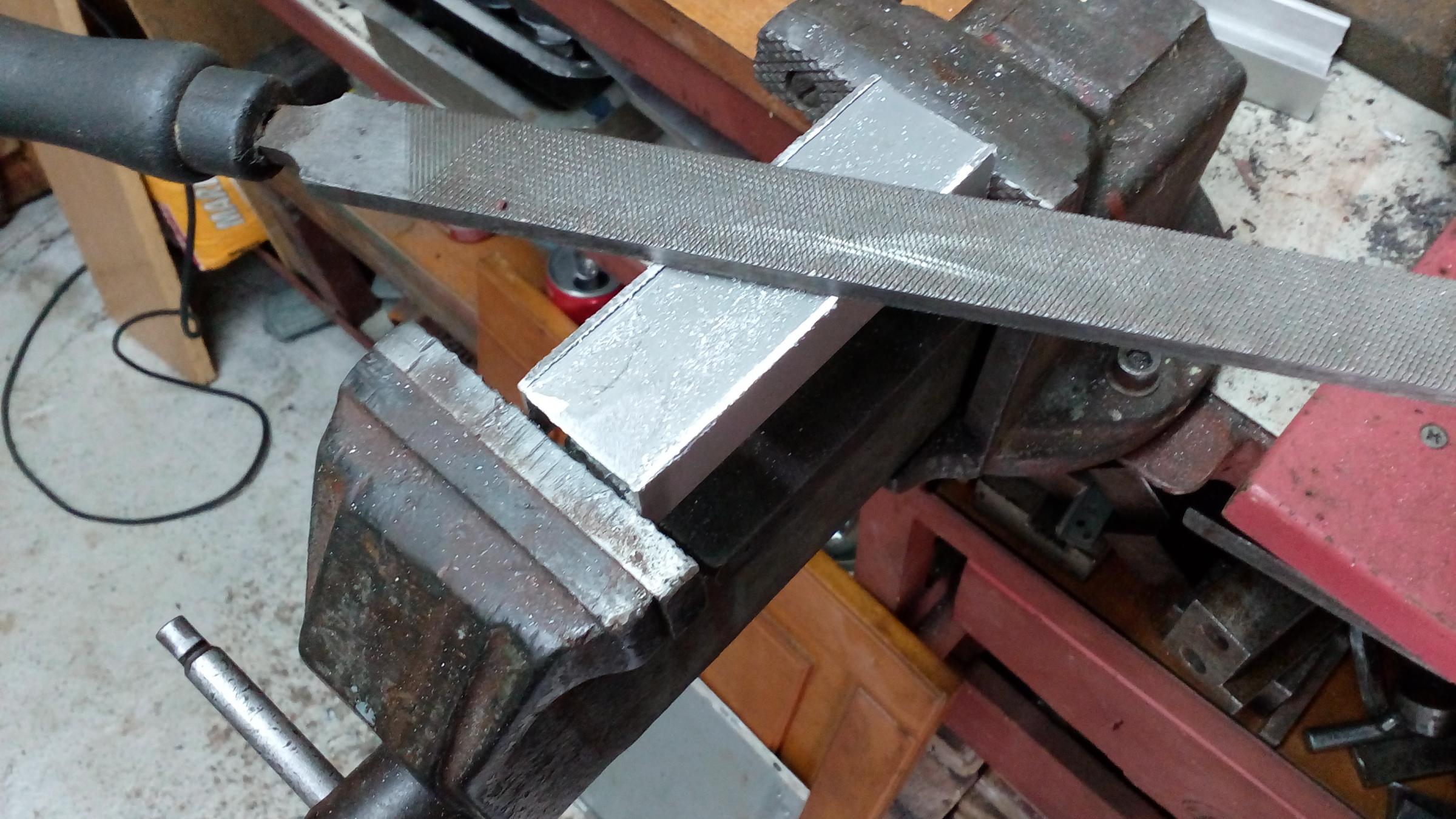

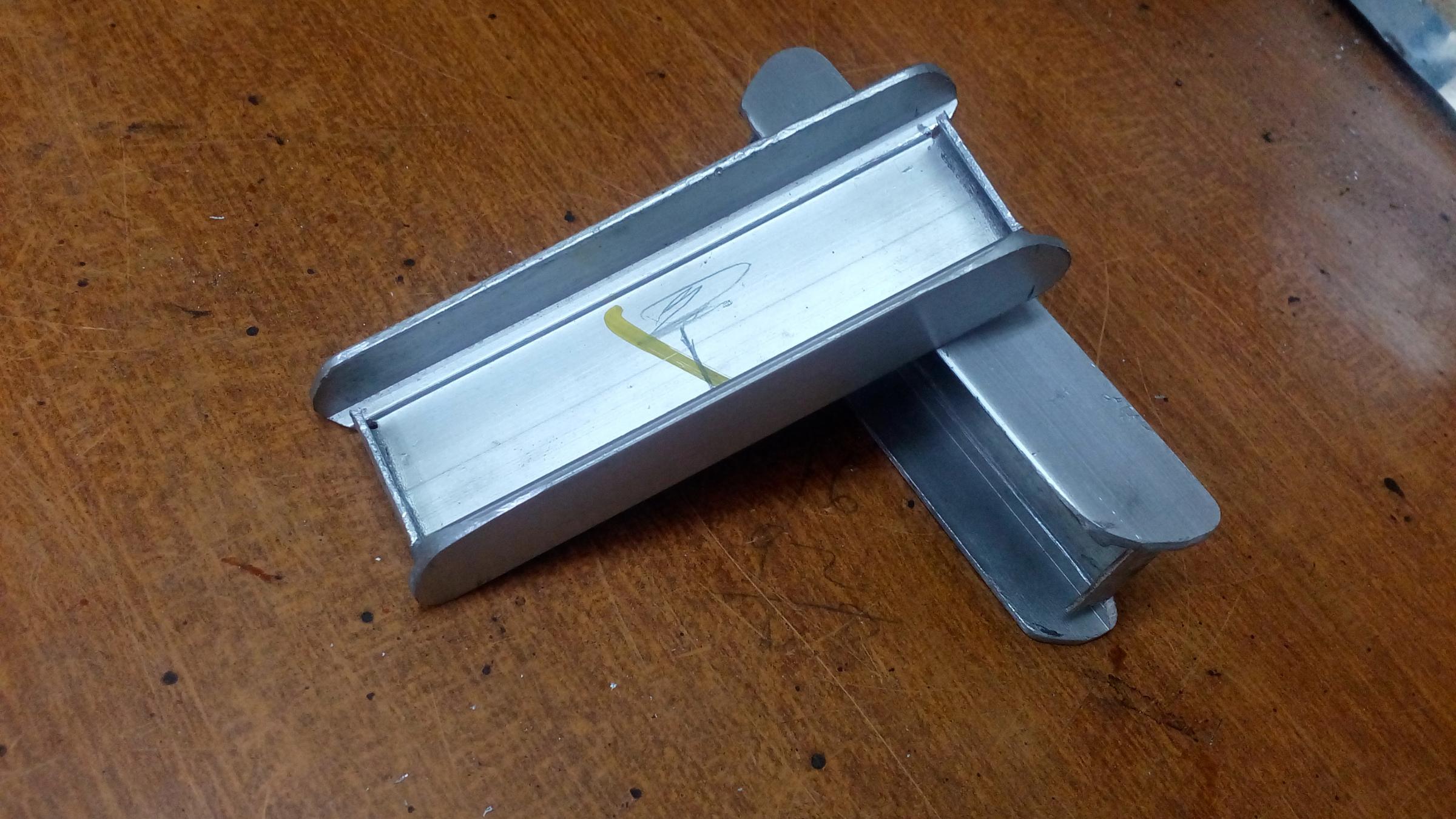

    For this build I have use a piece of aluminum profile.
    Vise Soft Jaws.-img_20200809_110639.jpg Vise Soft Jaws.-img_20200809_114331.jpg
