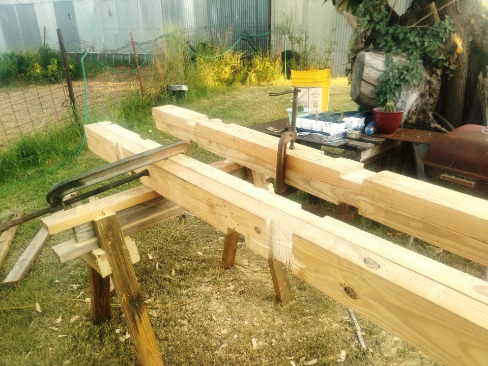

So I notched up 4 3x6 timbers to become the legs for the new water tower
Attachment 40481.

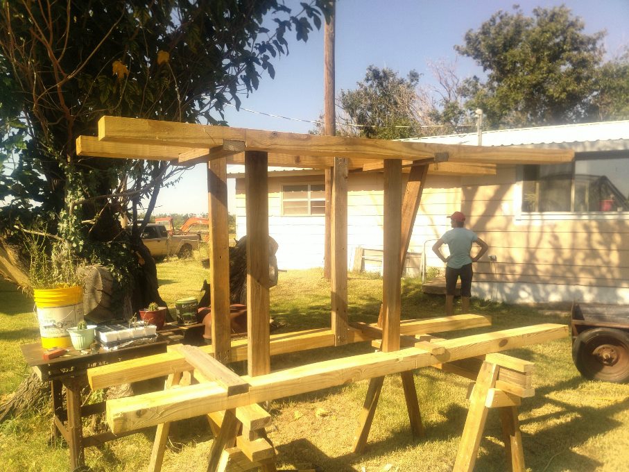

Then added the 2x4 cross and end pieces
Attachment 40482
Erected in place some odd colored paint slathered on it to slow the aging process

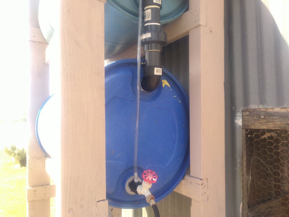

and dropped in the 55 gallon drums and connected them with threaded sch 80 gray PVC pipe& fittings
Attachment 40483
Added a sight gage made out of clear tigon tubing.
One additional thing is I used a washing machine hose on the bib, this way I can fill the storage drums or dispense the water from the same hose.
This also gives me access to up to 100 gallons of gravity discharge water should the need arise

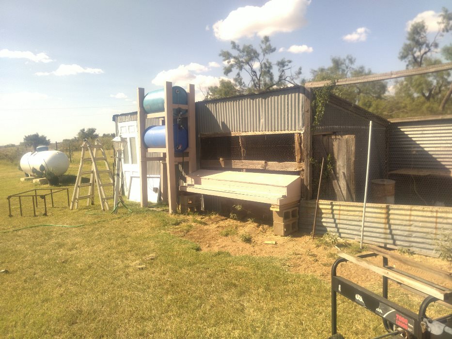

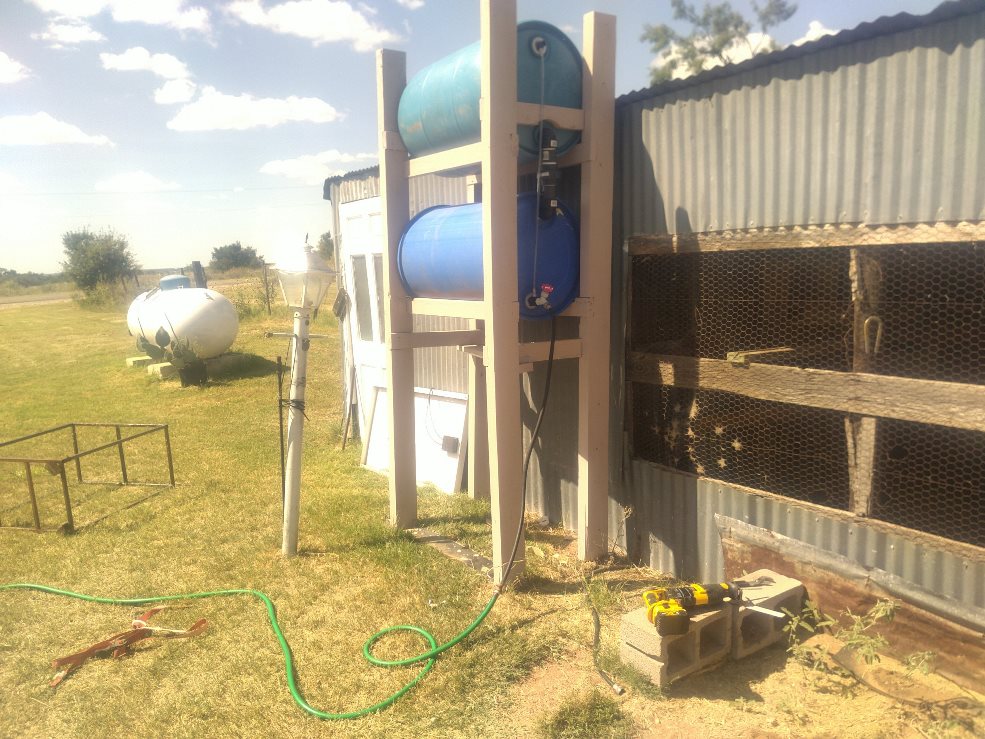

Tower and next box in place
Attachment 40485
