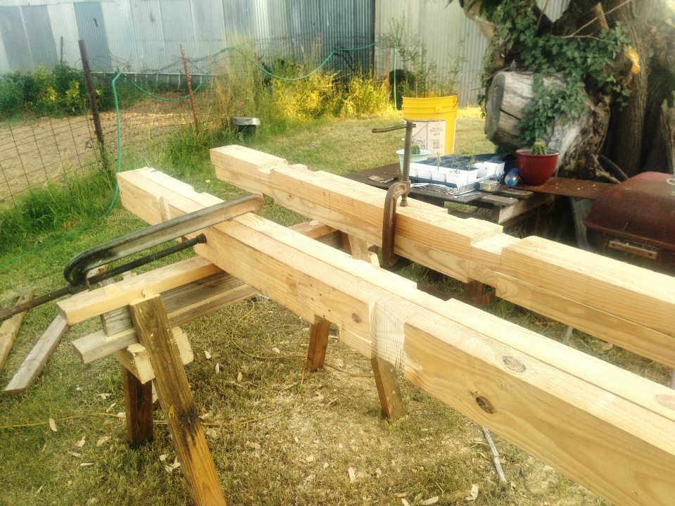

    So I notched up 4 3x6 timbers to become the legs for the new water tower
    water tower for chicken house-img_20210913_185756wt.jpg.

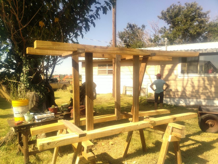

    Then added the 2x4 cross and end pieces

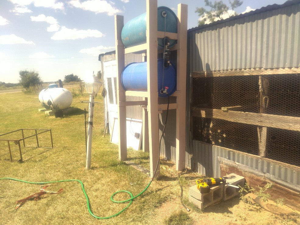

    Erected in place some odd colored paint slathered on it to slow the aging process
    and dropped in the 55 gallon drums and connected them with threaded sch 80 gray PVC pipe& fittings

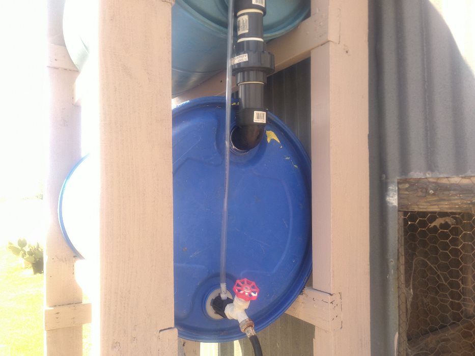

    Added a sight gage made out of clear tigon tubing.
    One additional thing is I used a washing machine hose on the bib, this way I can fill the storage drums or dispense the water from the same hose.
    This also gives me access to up to 100 gallons of gravity discharge water should the need arise
    water tower for chicken house-img_20210914_152124wt.jpg.

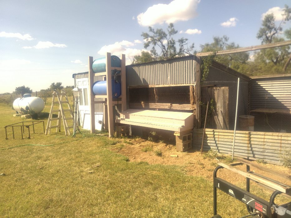

    Tower and next box in place
