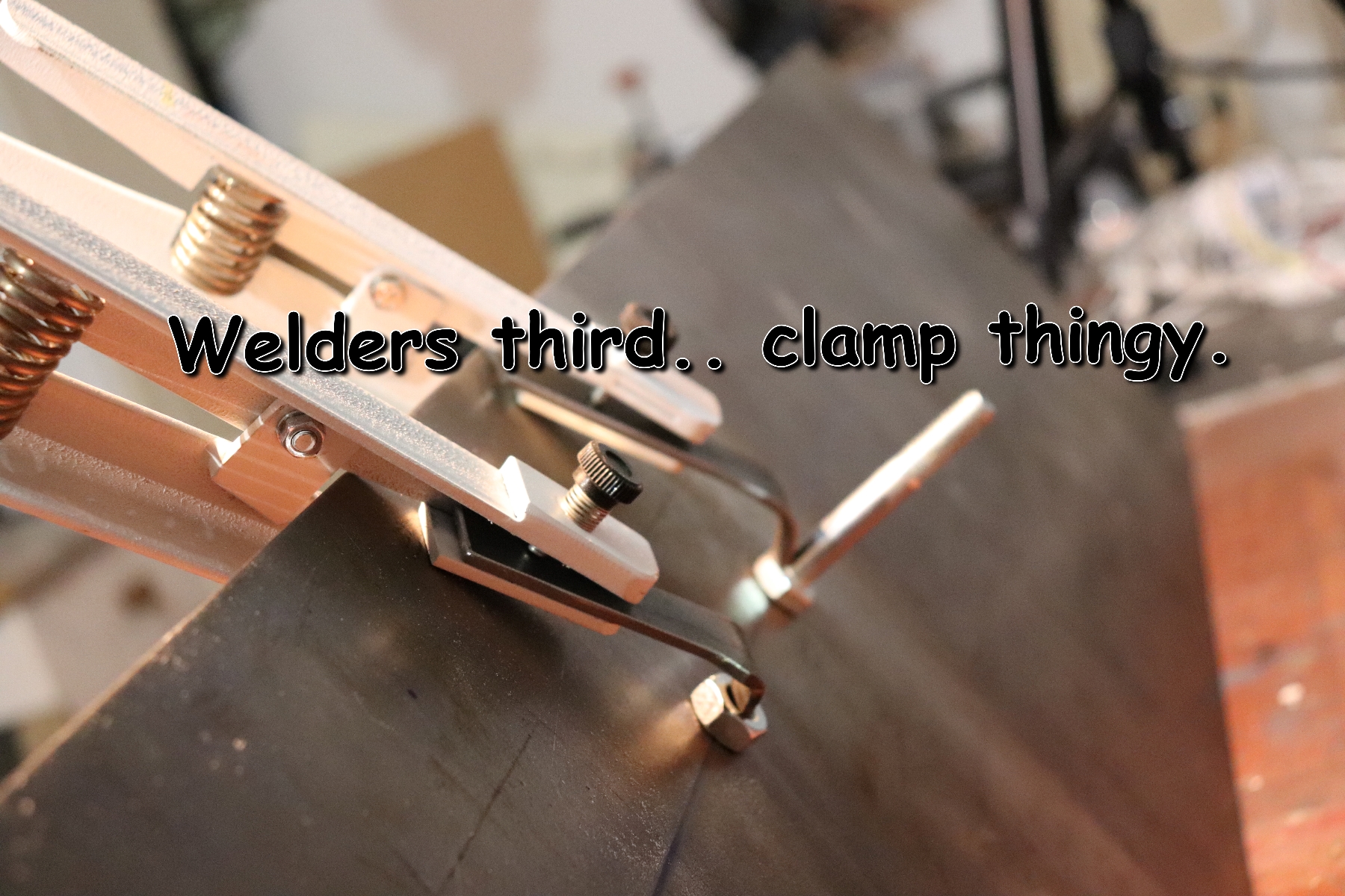

    Welders third.. clamp thingy.
    Video:

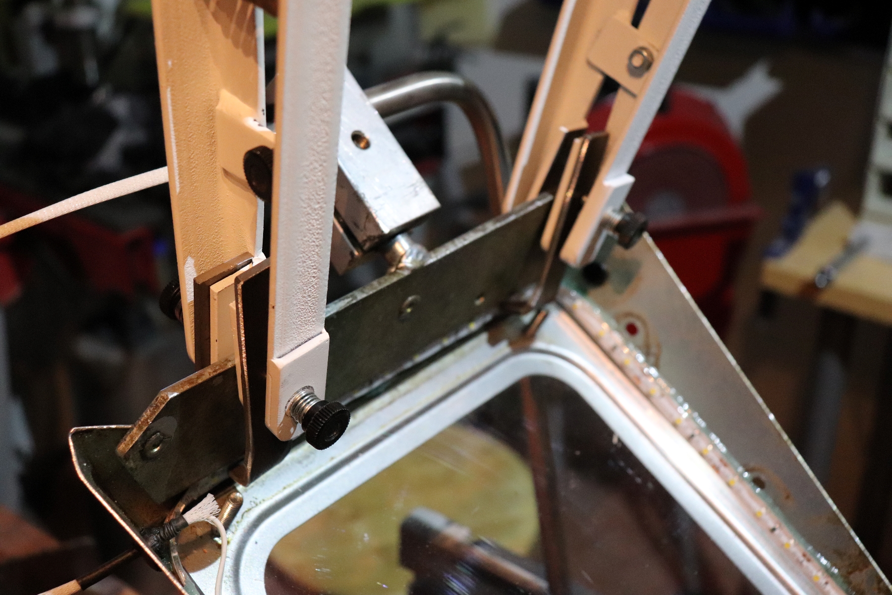

    Takes about 15mm to make, costs about 5$.
    Material angle iron, flat bar, spring (s), bolts.
    -Tuomas-

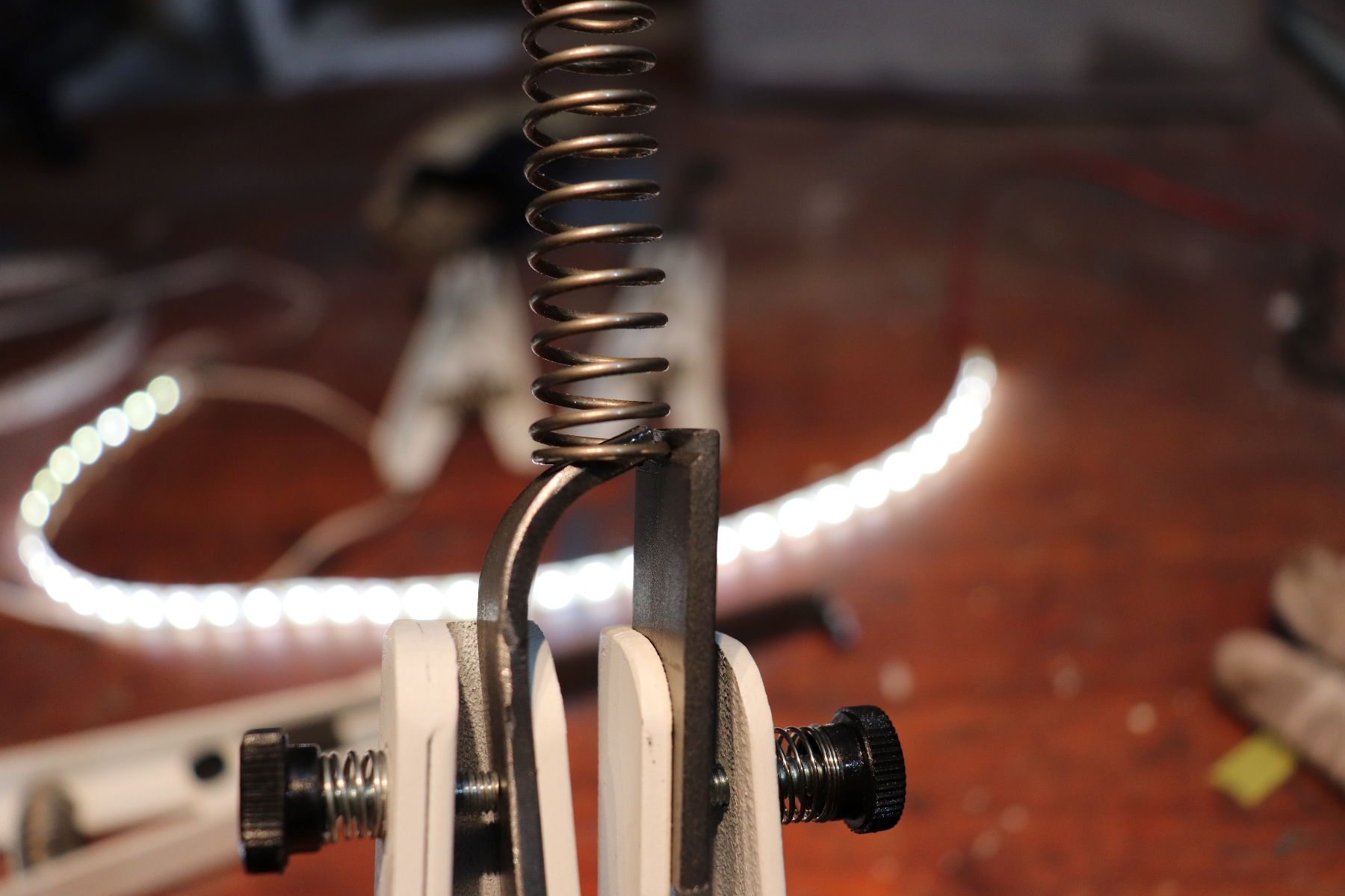

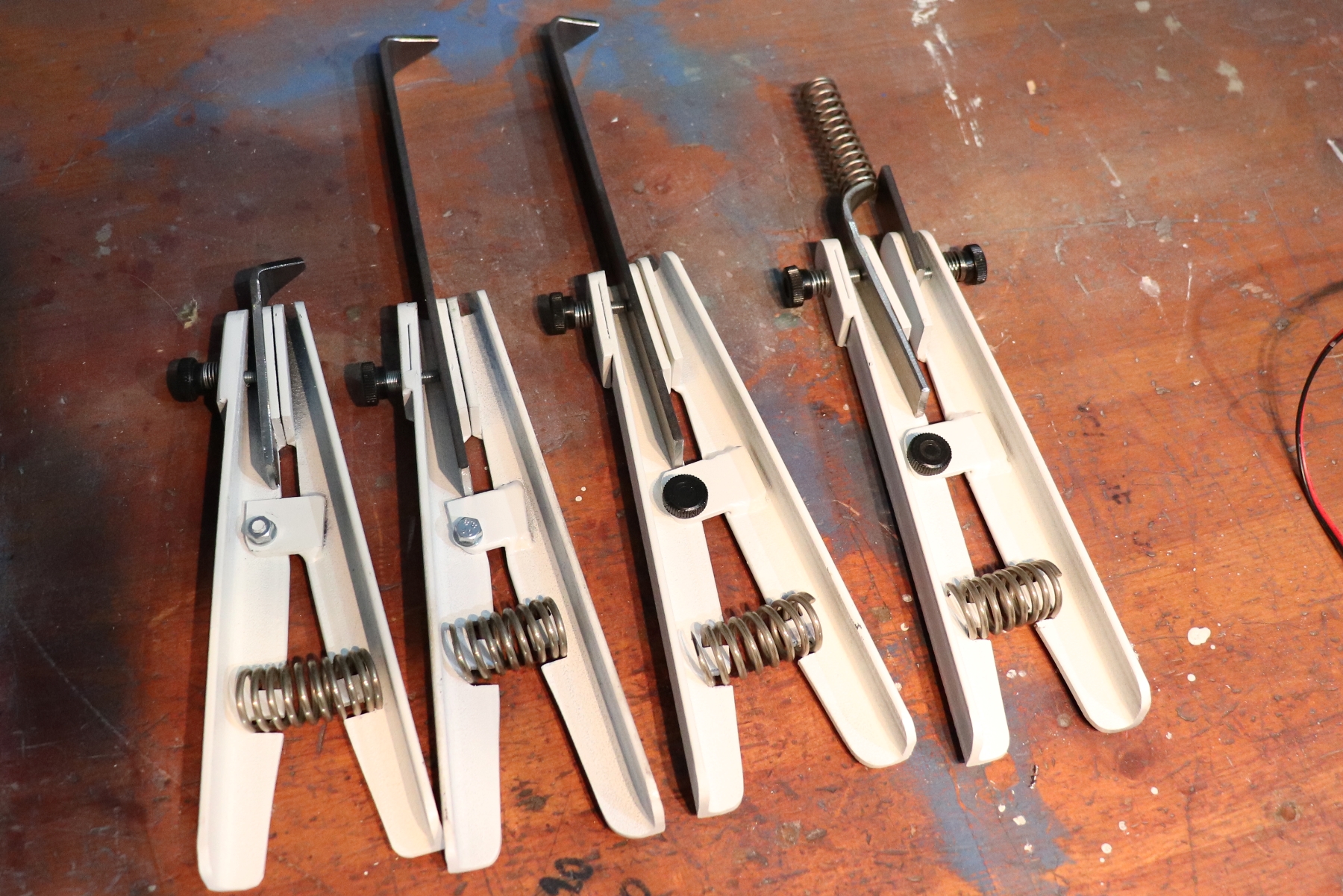

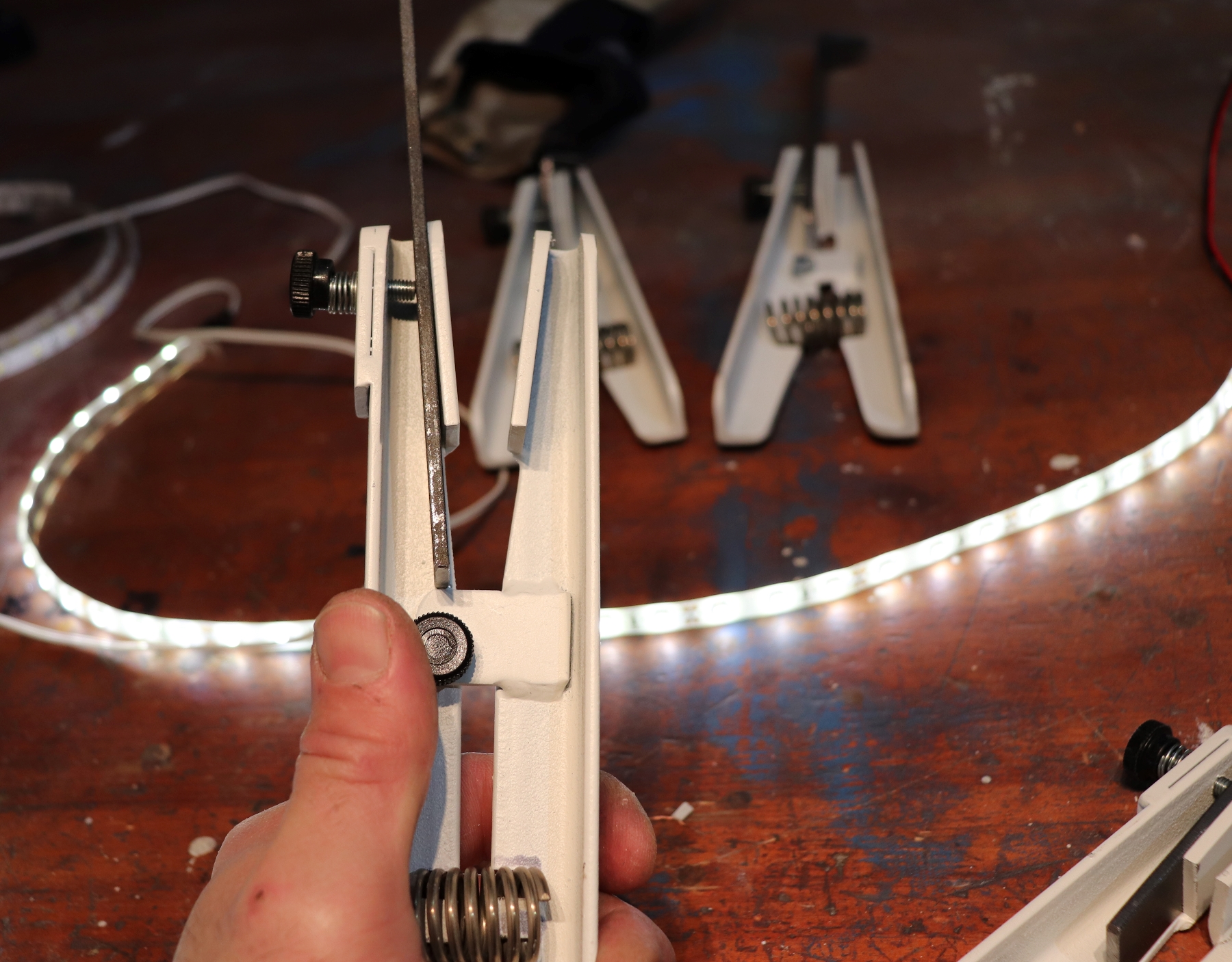

    Made simple modification..
    Also did two more of them. I used 120mm springs, got two from one, so i choosed to use them all.
    ( springs cost 4$ )
    New clamps are with little wider opening:

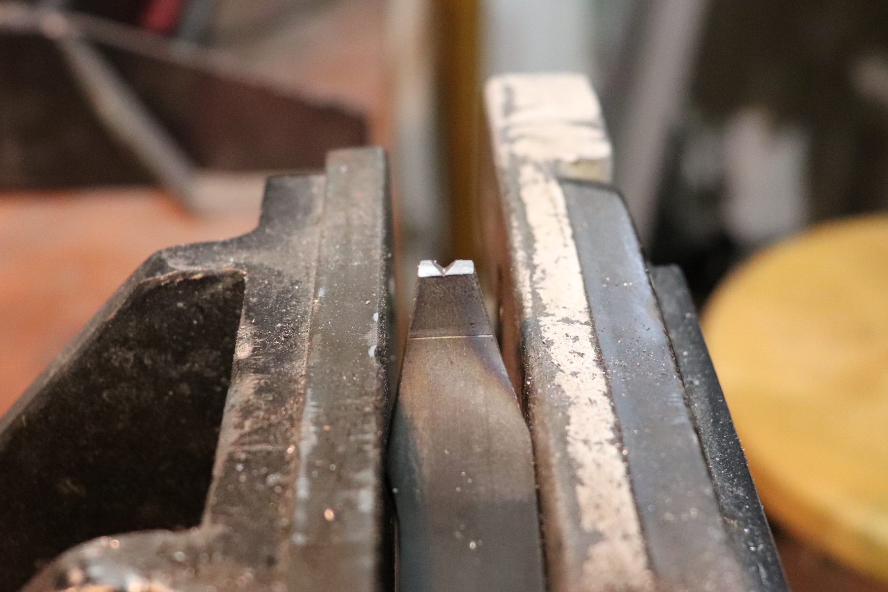

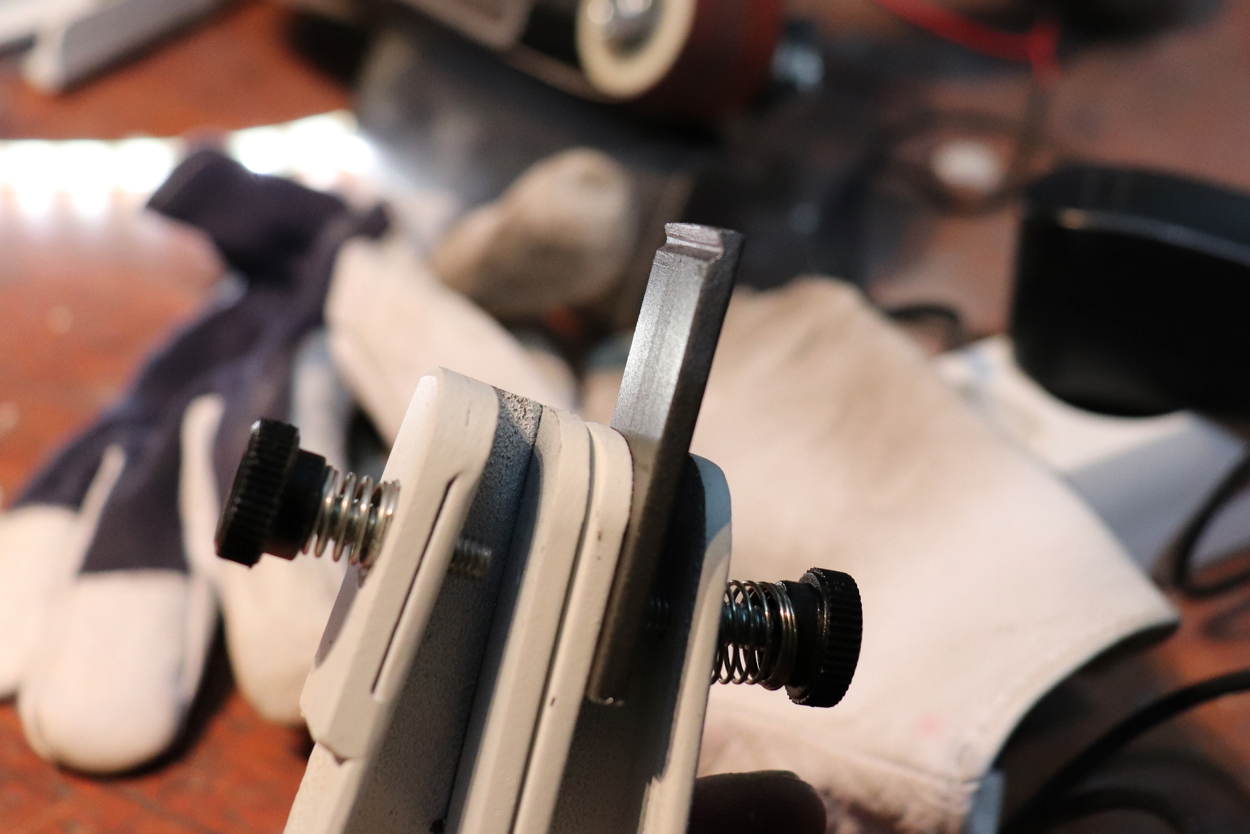

    Also made this simple mod for holding small, and round objects. Tought it could be usefull when brazing small rings, and stuff like that.

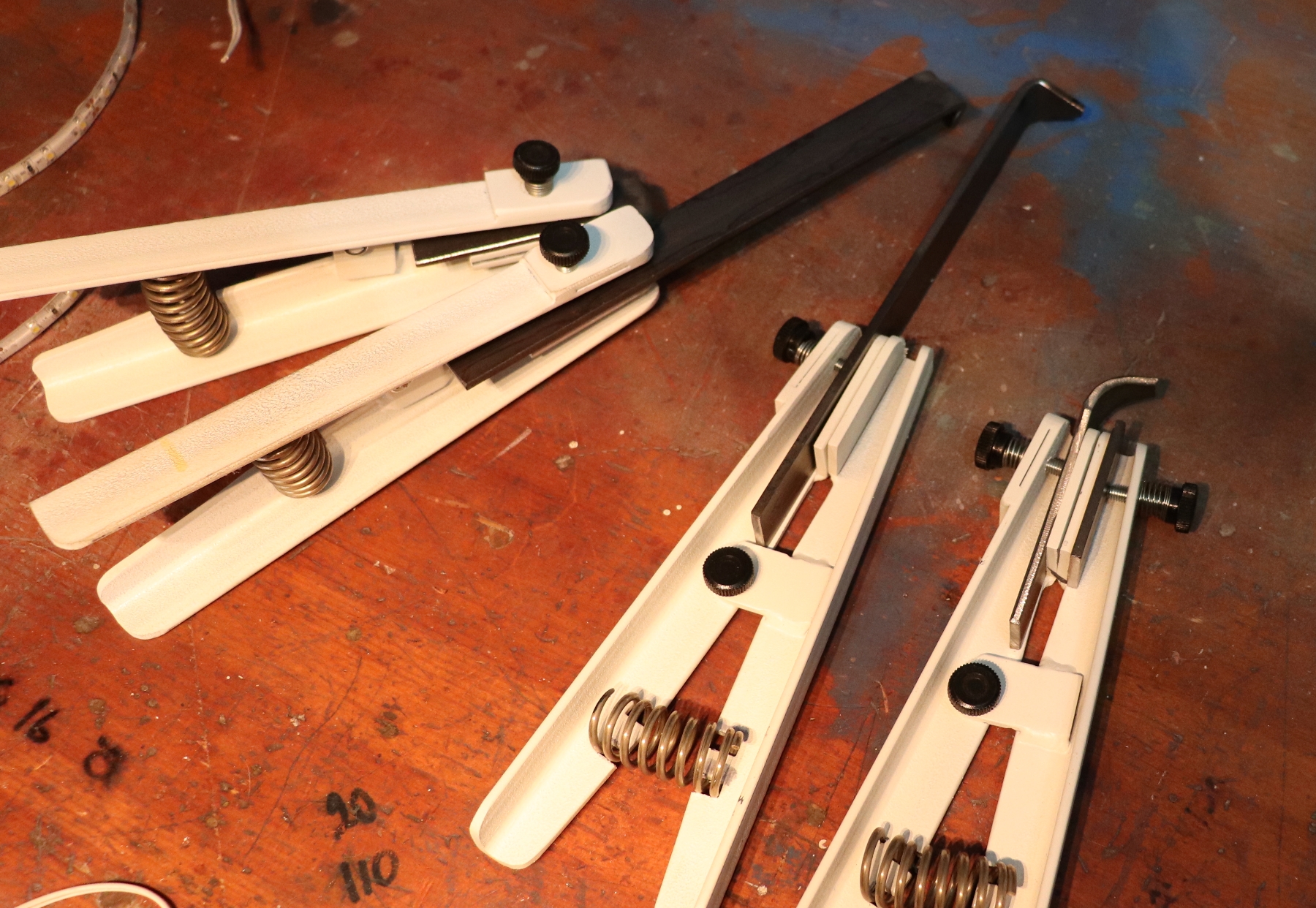

    Even that the title says " welders.."
    These extentions work nicely with gluing tasks too..
    That was a little hard to reach spot to my "traditional" clamps.
