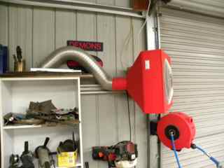

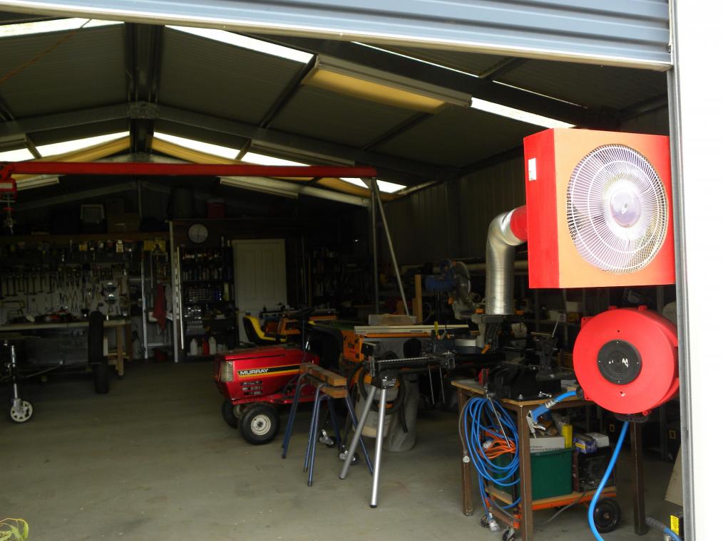

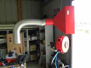

Welding Fume Extraction made from desk fan being enclosed in MFD housing and wall mounted on hinge so as it can be swung out to exhaust fume from out of my shed. Note switch on side of casing.
