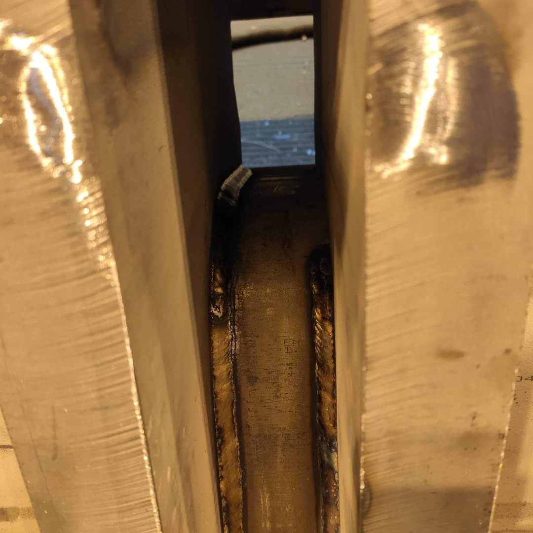

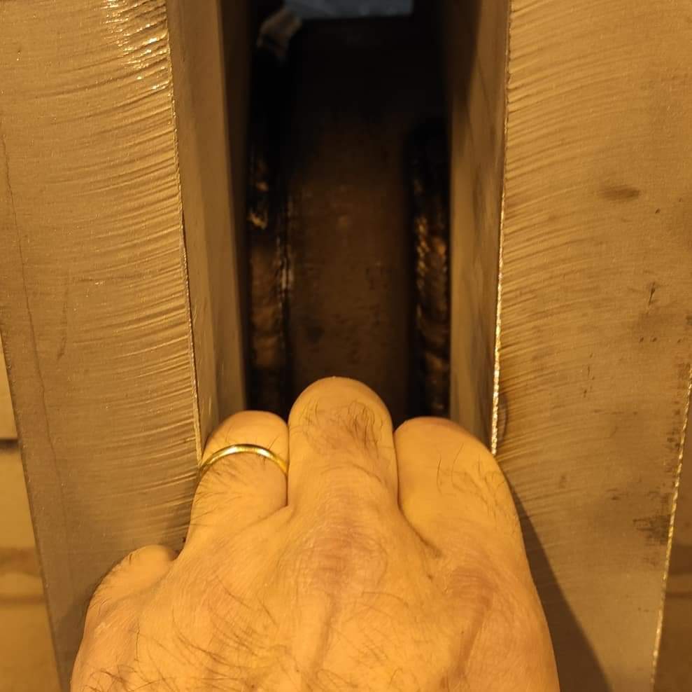

    There was a little tight places to weld yesterday..
    32 similar welds through opening that's 300mm wide and 320mm long.
    Took a short video about it.
    Material is 316 stainless. Wire is Kobelco Premiarc 316Lp, dual shield.
    Sometimes being a metalworker feels so funny. 😁

    Tuomas, so did your friendly design engineer measure minimum area required for helmet and hand, or did others try to enter and not fit?
    That bead though, left handed to boot! Beautiful!
    Metal work can be 'funny', I don't recall any such contortions in my work.

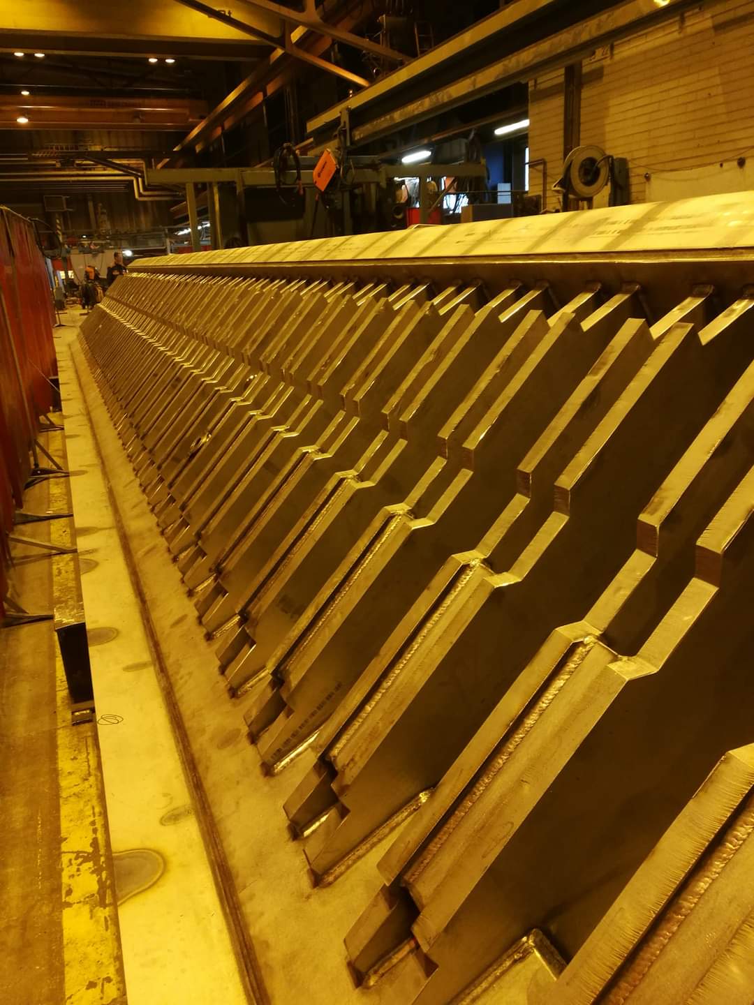

    This was a part from a new design from paper machine "lower hull frame". Previous versions has wider space. Most likely gap will be adjusted at the next version.
    I think design engineers doesn't even measure how it can be done. Mirrors are their answer if one tries to say that its too difficult to weld.

    Here is some pictures.
    Some vertical welds.
    Difference between right and left handed vertical welds can be seen..

    After welding, frame was flame straightened to 2mm level.
    Finished frame was shrinked 15mm shorter than it was build.
    This needs to be considered at the beginning, otherwise it happens that there is no enough machining allowance.
    Drilled holes goes thought heating water casings, or something like that..
    Build has several water casings, to heat and keep frame straight in use.
