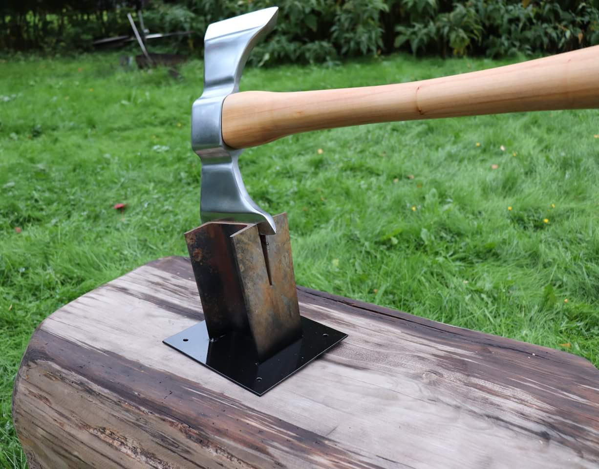

    Re-uploaded it.
    Step 1. Cut 10" long piece of H-beam.
    Step 2 . Smash axe to one end of it.
    Step 3. Weld a little mild steel plate to other end of the H-beam.
    Very simple but working solution

    Thanks Tuomas! Good one and Fun!! Hope it doesn't scratch that fine finish work you did on the axe head!!
    No, it won't scratch..
    Axe is weld to the stand inside the "split section".
    3M borrowed it to the faire starting tomorrow, they hoped it to be attached so that it doesn't fall off and hurt someones feets.
    I tought welding is the best option. So, i need to finish it again after the faire.
