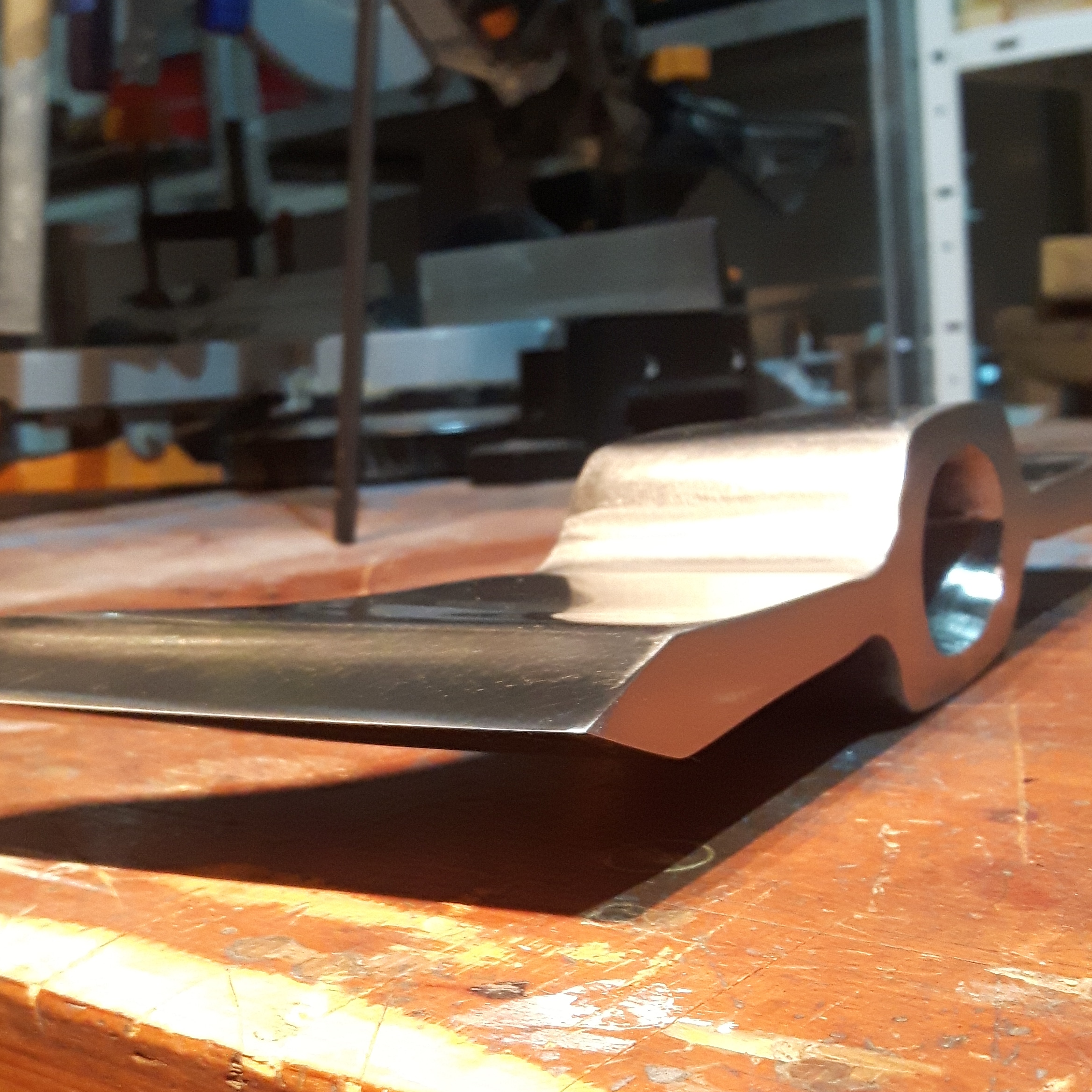

Next step is to make handle for it.
Attachment 25535
Attachment 25535
Looking good are you going to flash treat the blade area?
RR track is high in manganese and reasonably hard already but the blade could probably benefit from some hardening.

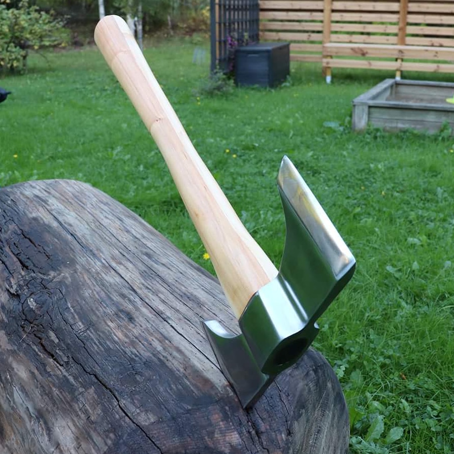

Tuomas;
Saw still photo, which made me watch axe video. Saw the surface finish DONE BY HAND, but still can't believe my eyes. It appears so perfectly uniform, I'm amazed. I must start in on this angle grinding method of fabrication. :clapping:x10
Exceptional build, Tuomas. Also enjoyed seeing where you normally work. Awesome skills and machinery.
Quite the Handsome Axe Tuomas! One day there will be a bronze of you and your angle grinder somewhere in prominence in Finland overlooking a Grand industrial park! :thumbsup:
That belt grinder was a Beautiful build!!! Was also Awed by the 70T capacity CMM in the work video...Holy Kadoodle. Definitely Heavy Industry by anyone's book.
Thanks for sharing the build and your work video.
An amassing build. I own 8 angle grinders 2 9 inch a 7 inch 1 5 inch and the rest are 4 1/2 inch all of them have different types of grind wheels, cobs, brushes, and sanding disks on them I figure that I would wear out everyone of them trying to grind away that much materiel.
I must say you have perfected the art of using an angle grinder.
Thanks buddy!
Those shapes are actually very easy to make.
Those fiber discs are great for removing material quickly, and also for grinding straight surfaces.
There's more info about used accessory on the description box.
O tried to copy the text, but links doesn't work if i paste them here. :( That's some weird issue in youtube app.
