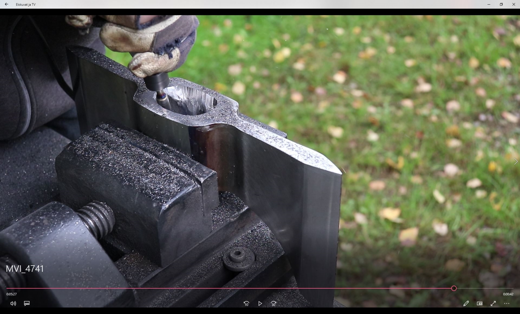

I used one 1.6mm cut off wheel.
Partly one 2mm cut off wheel
One 36 grit fiber sanding pad and partly one 60 grit.
Partly one 4.5mm grinding wheel
And just a little from one 80 grit flap wheel.
Four 40 grit sanding drums..
About 10 pcs different grade sanding pads for finishing.
All those are 3M Cubitron 2 brand.
Didn't supposed to advertise, but those really lasts well.
Price for the used accessory is about 20 $.
Of course these sanding backing pads costs more than that 20$
But i can use them in the future too, so i don't count them.
