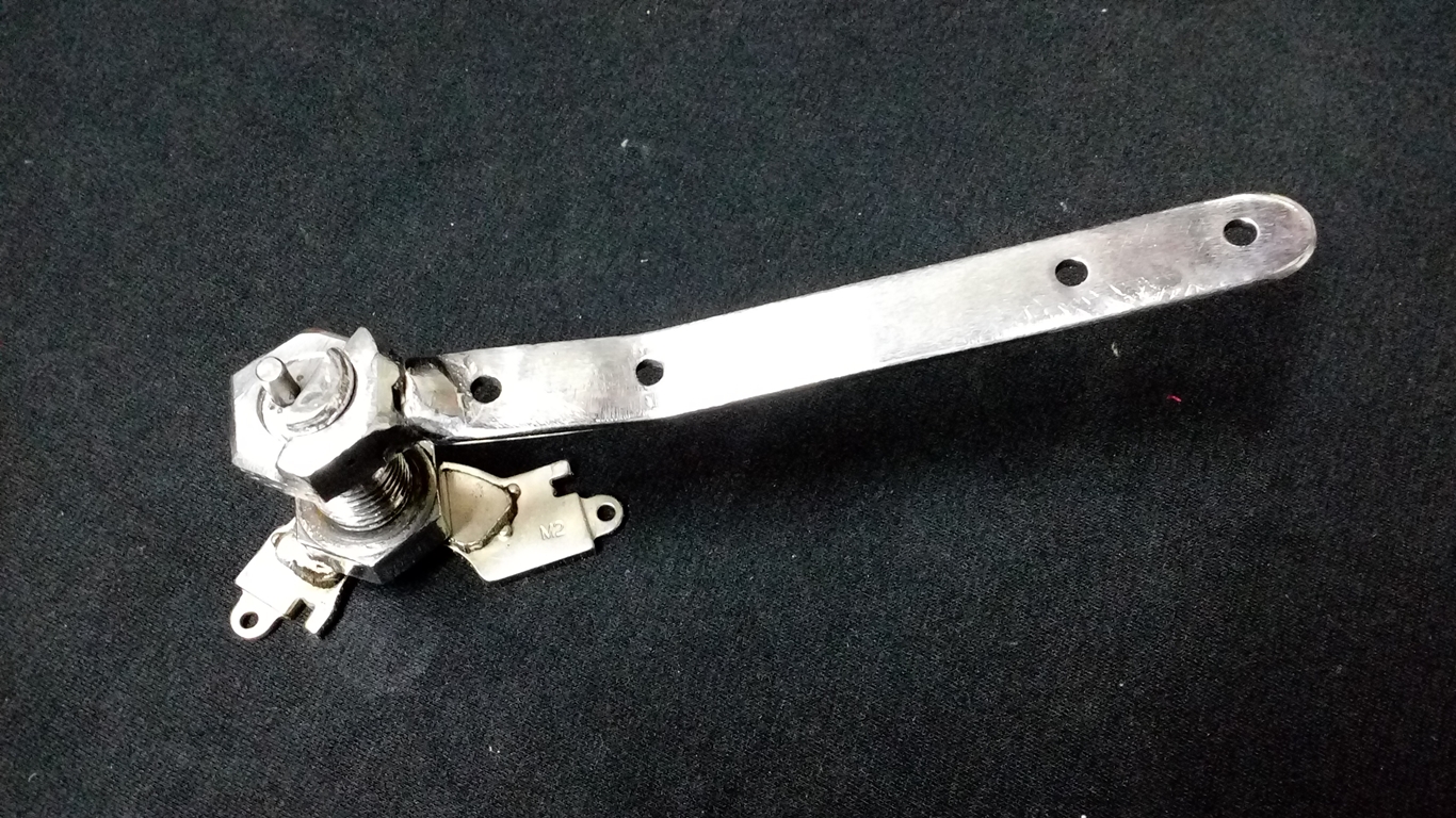

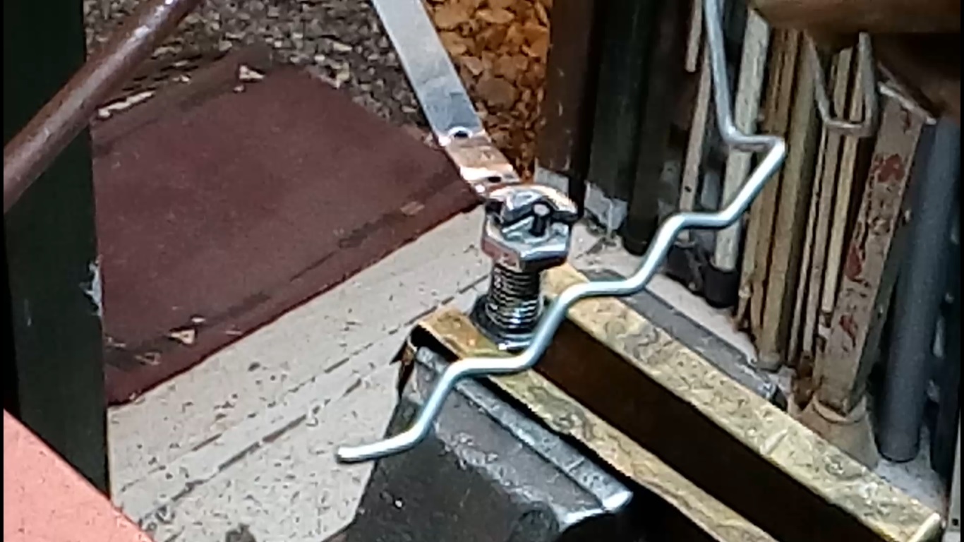

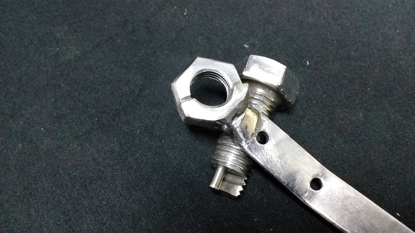

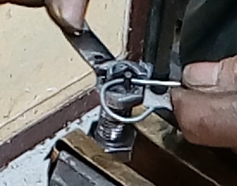

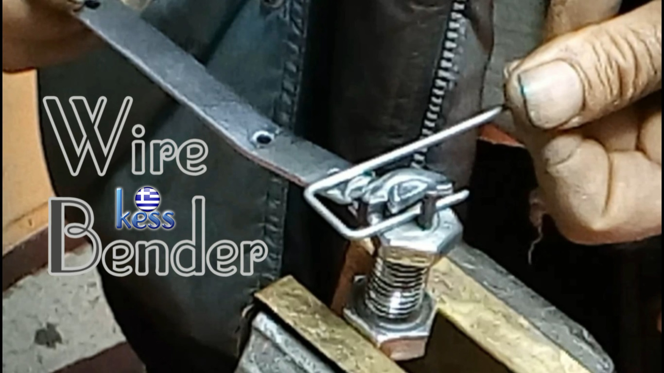

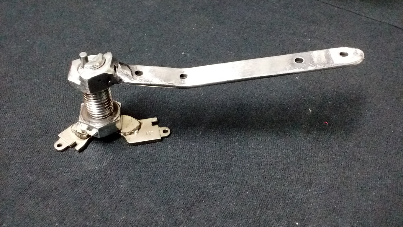

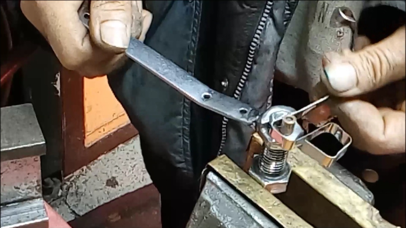

Wire Bender mini tool.
https://youtu.be/KdxbVXxZvZk
Suitable for wire bends up to Ø4mm as well and sheet metal strips (steel, stainless steel, aluminum, brass, copper, tin can)
by the addition of one small cylinder with internal dia 4mm over the shaft.
Materials: one set M16 bolt/nut, a broken drill bit Ø4mm and a piece of flat bar 15x3mm.
For bigger wire diameters is needed the use of a bigger size bolt/nut than M16 or 5/8".

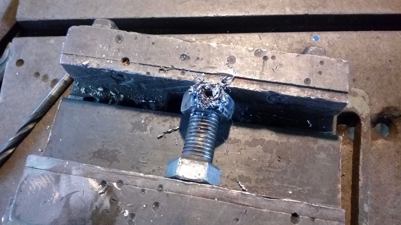

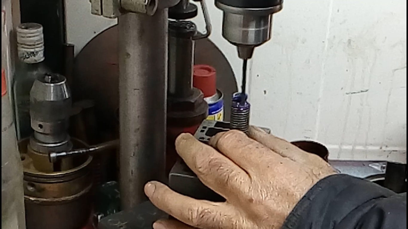

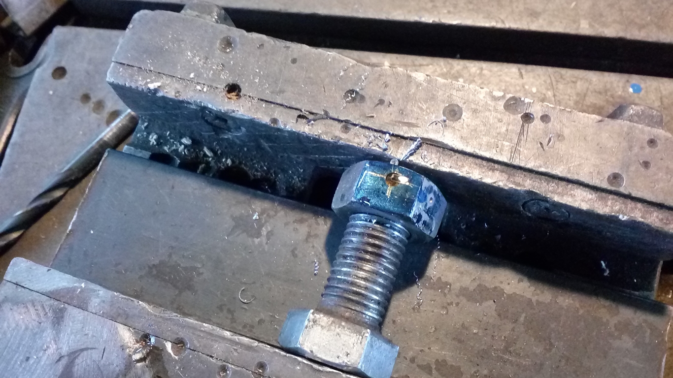

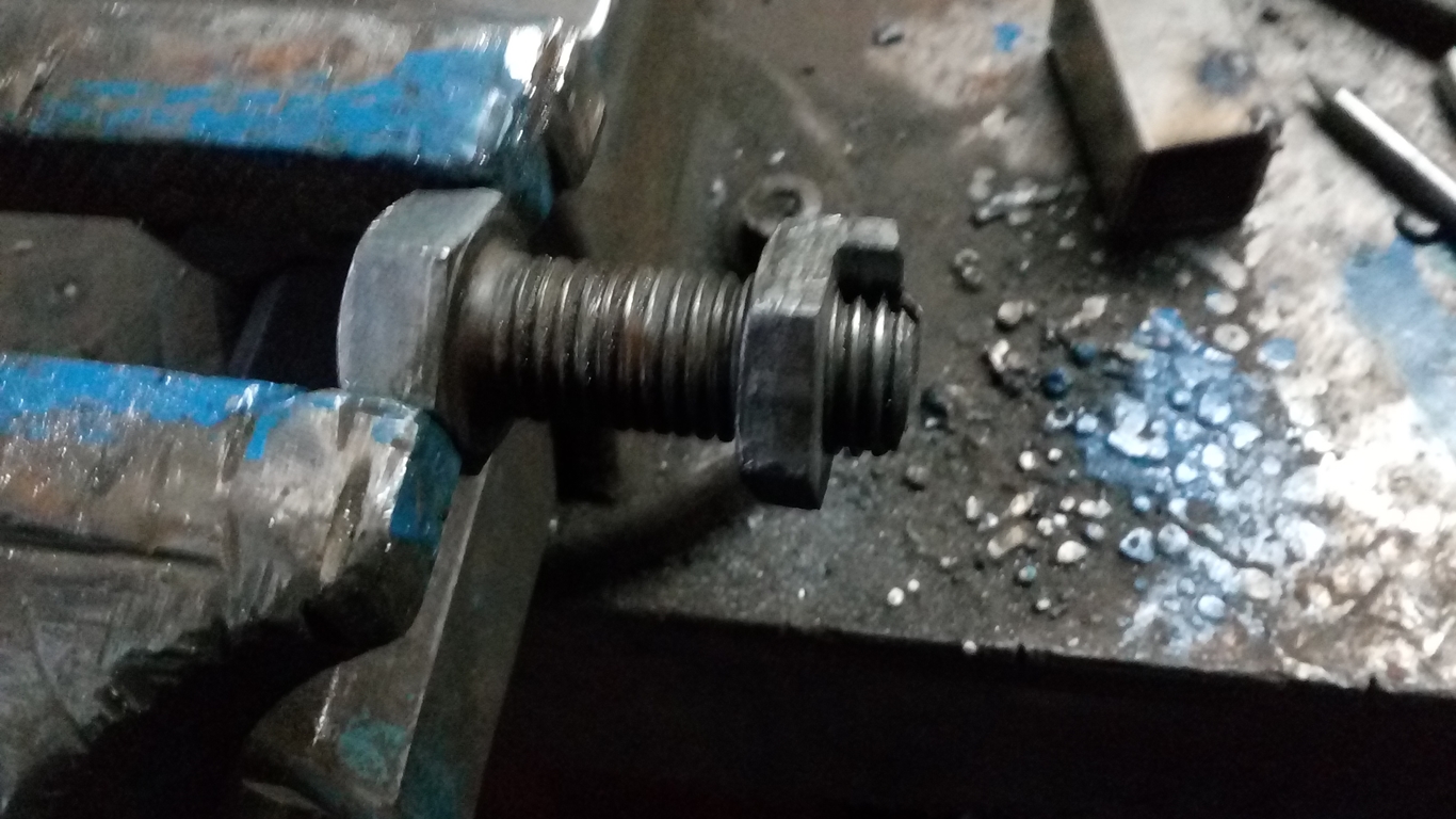

Bolt nut M16. Using an Ø3.5mm drill bit do a hole from side to side.
Attachment 32515 Attachment 32516
Attachment 32517 Attachment 32518

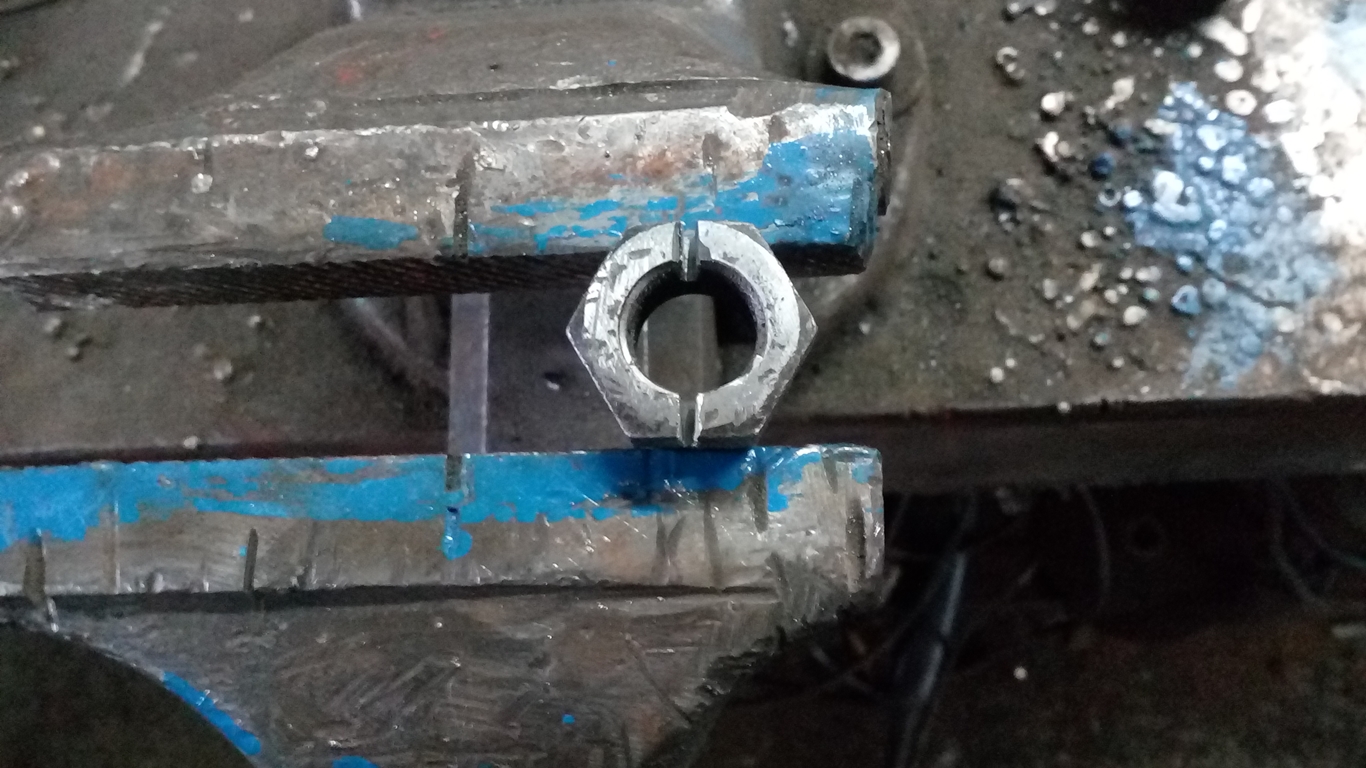

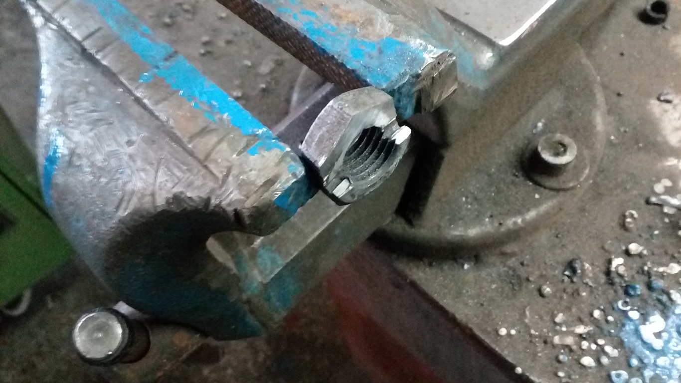

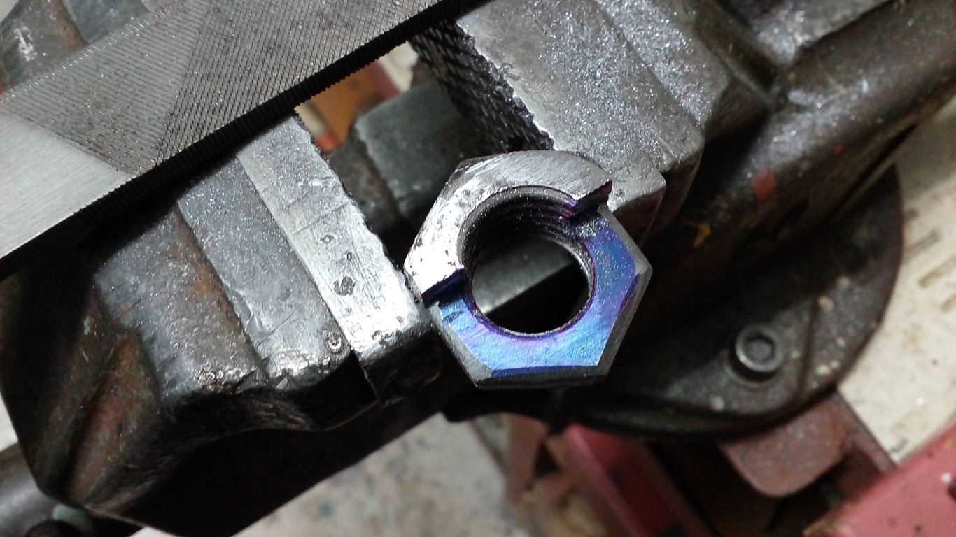

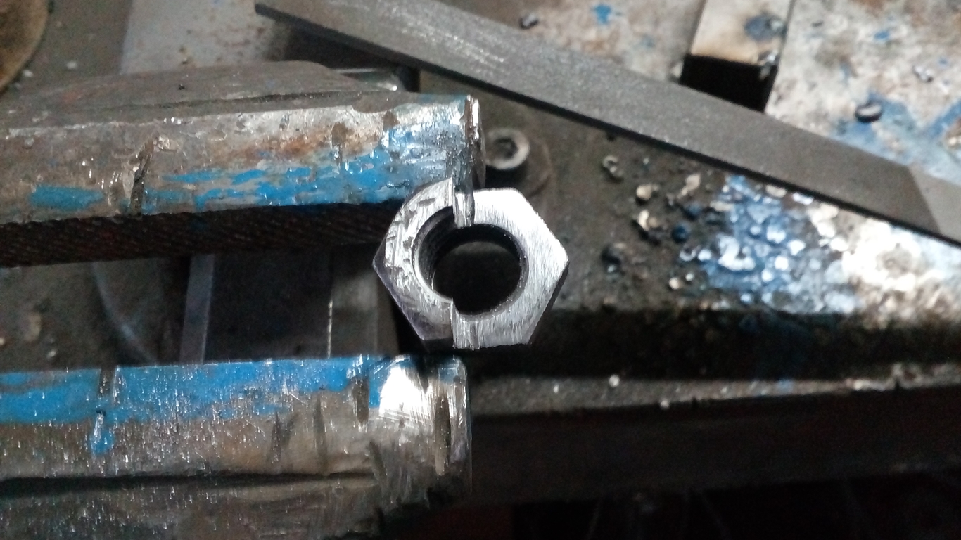

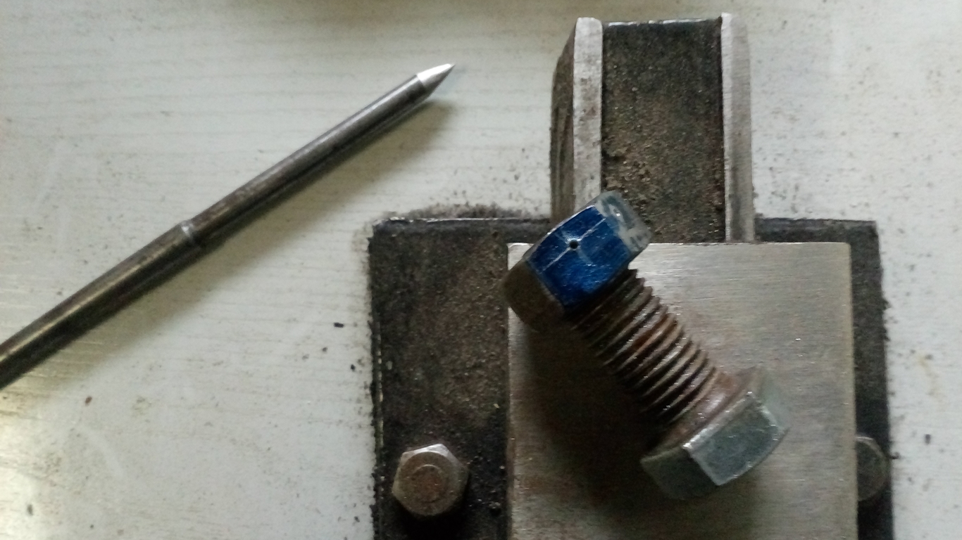

Do at first a cut at the nut's center till the hole
Attachment 32519 Attachment 32520
and then a second cut removing the half 1/3 of the nut.
Attachment 32521 Attachment 32522

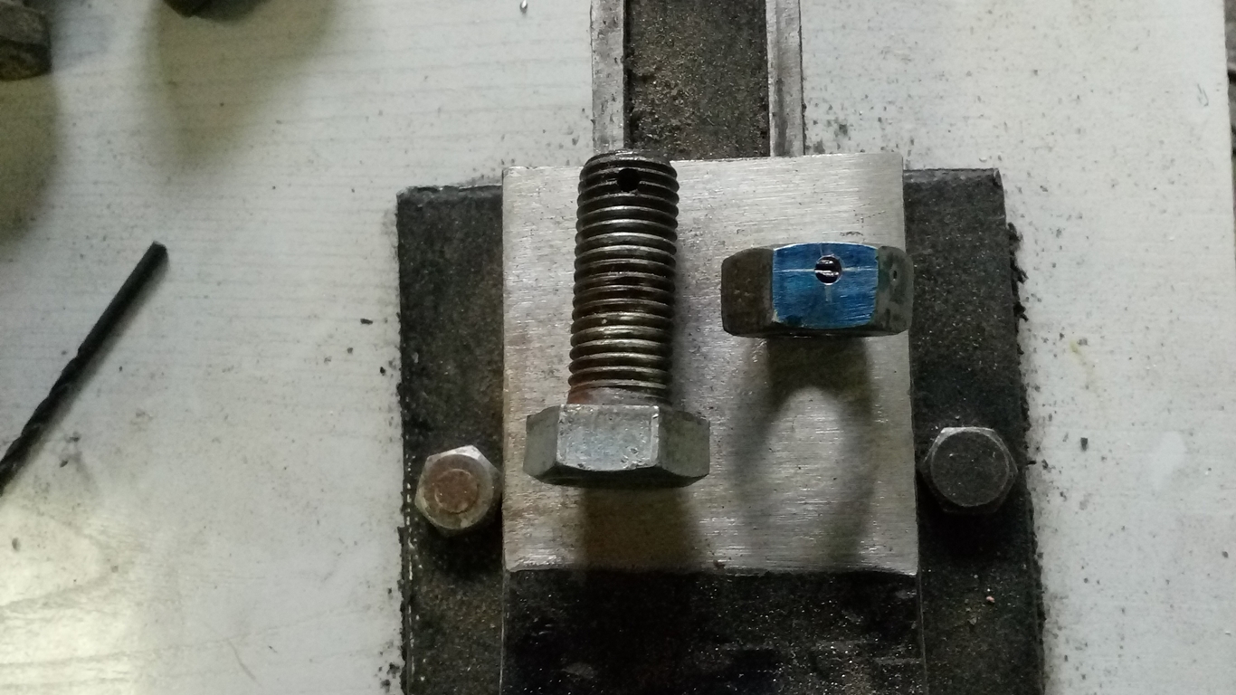

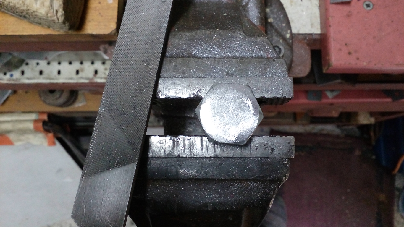

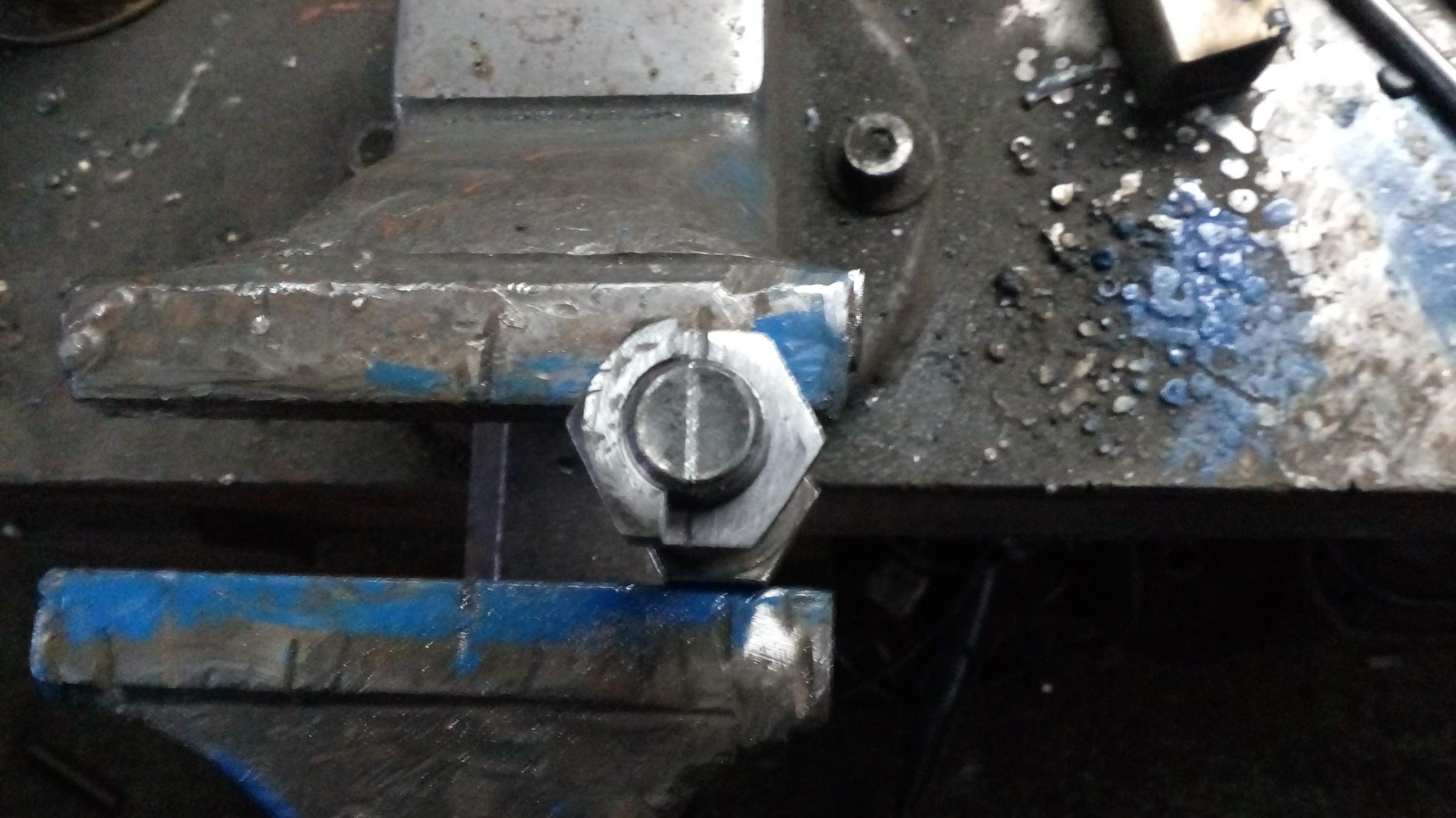

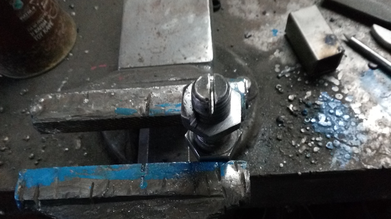

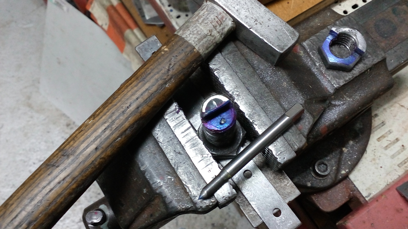

Cut the bolt at center till the hole.
Attachment 32523 Attachment 32524
Attachment 32525 Attachment 32526

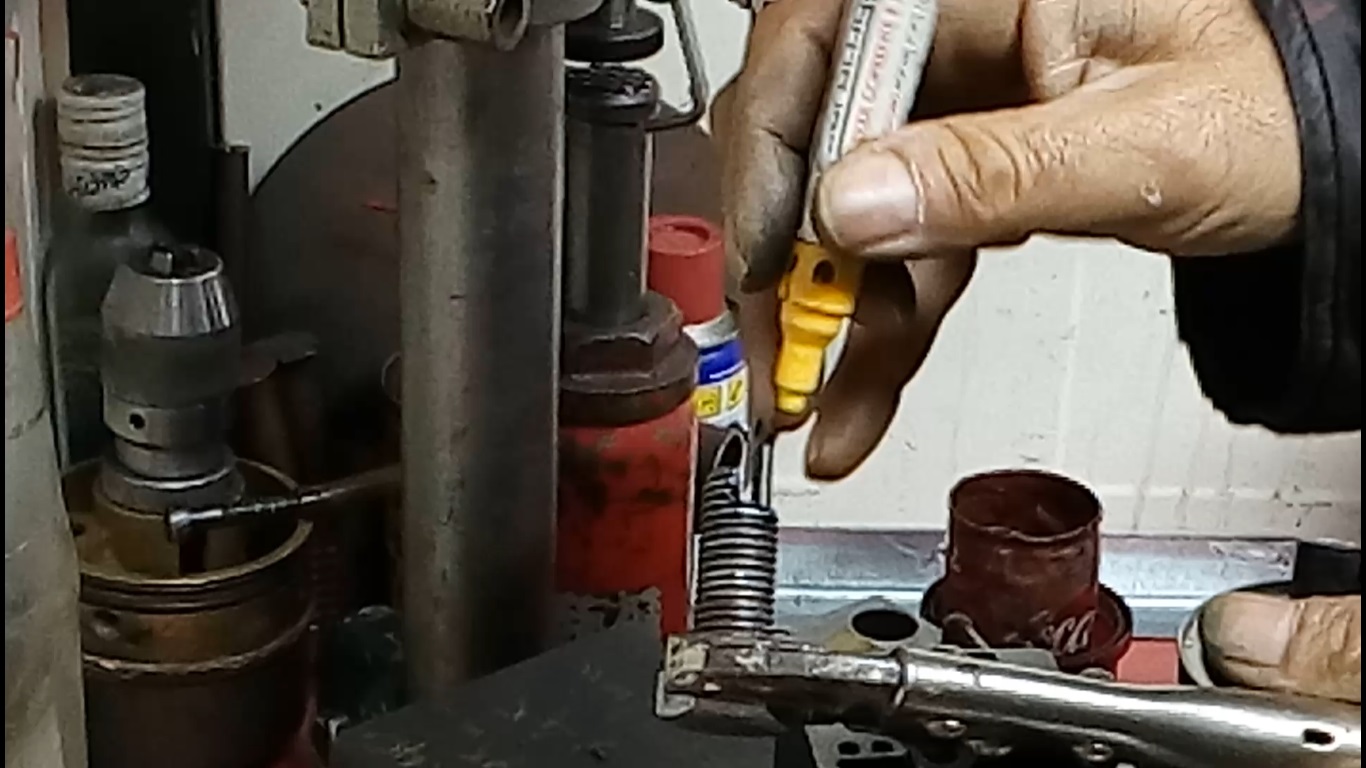

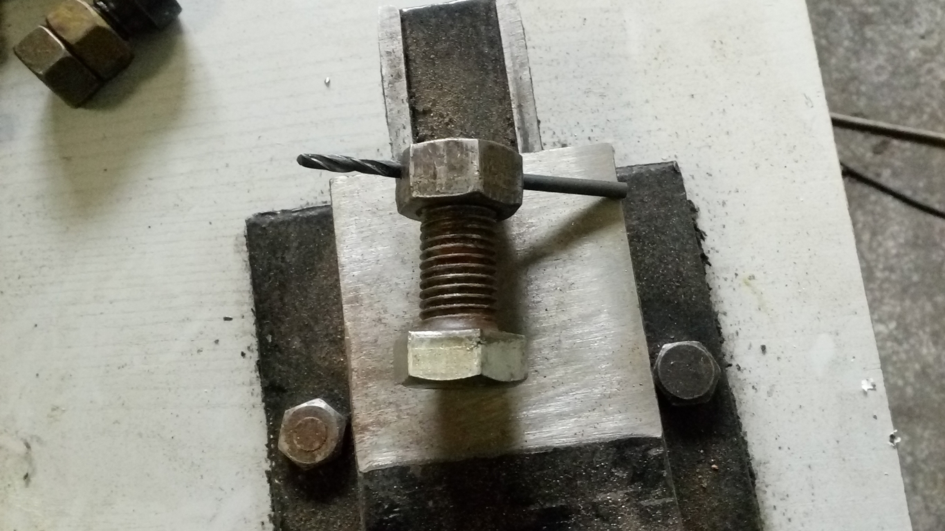

Mark the nest hole for the shaft.
Attachment 32527 Attachment 32528

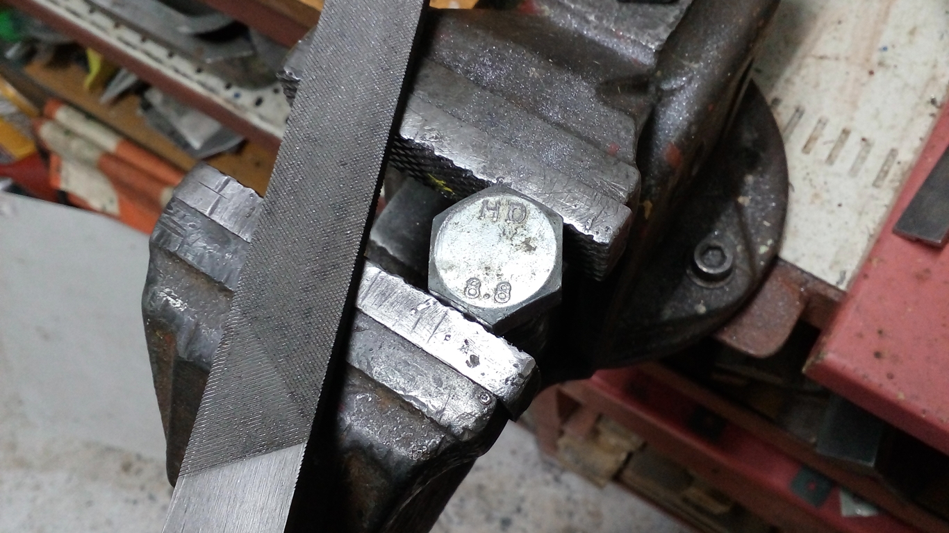

Use a file to clean up the letters and numbers.
Attachment 32529 Attachment 32534

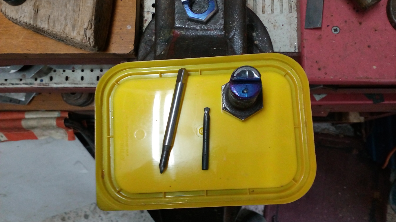

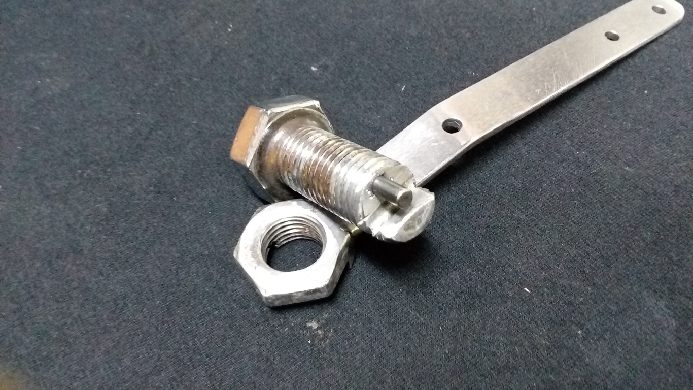

Use at first an Ø3.5mm drill bit and then an Ø4mm to make a nest hole with 15mm depth.
Attachment 32535 Attachment 32536

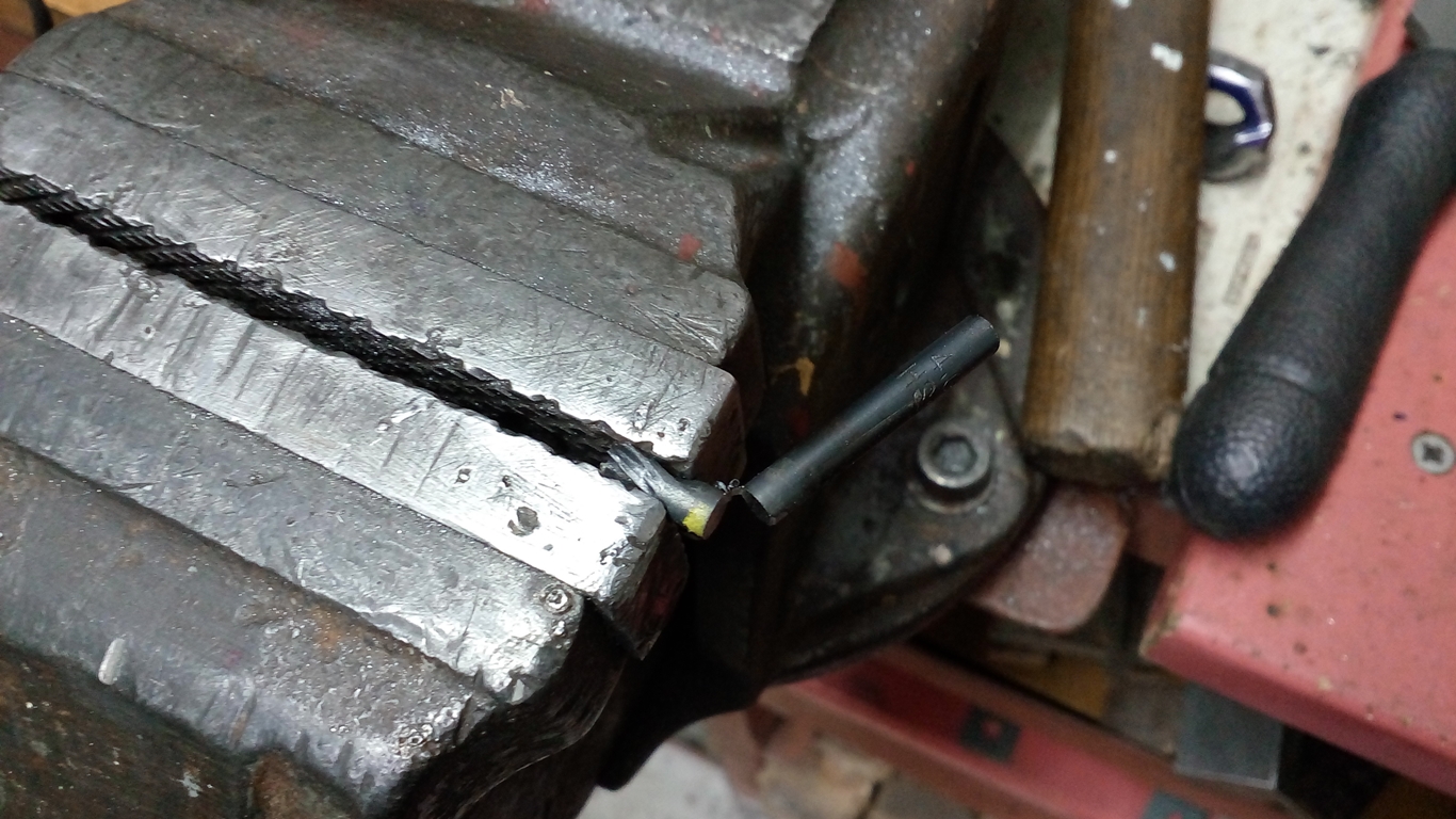

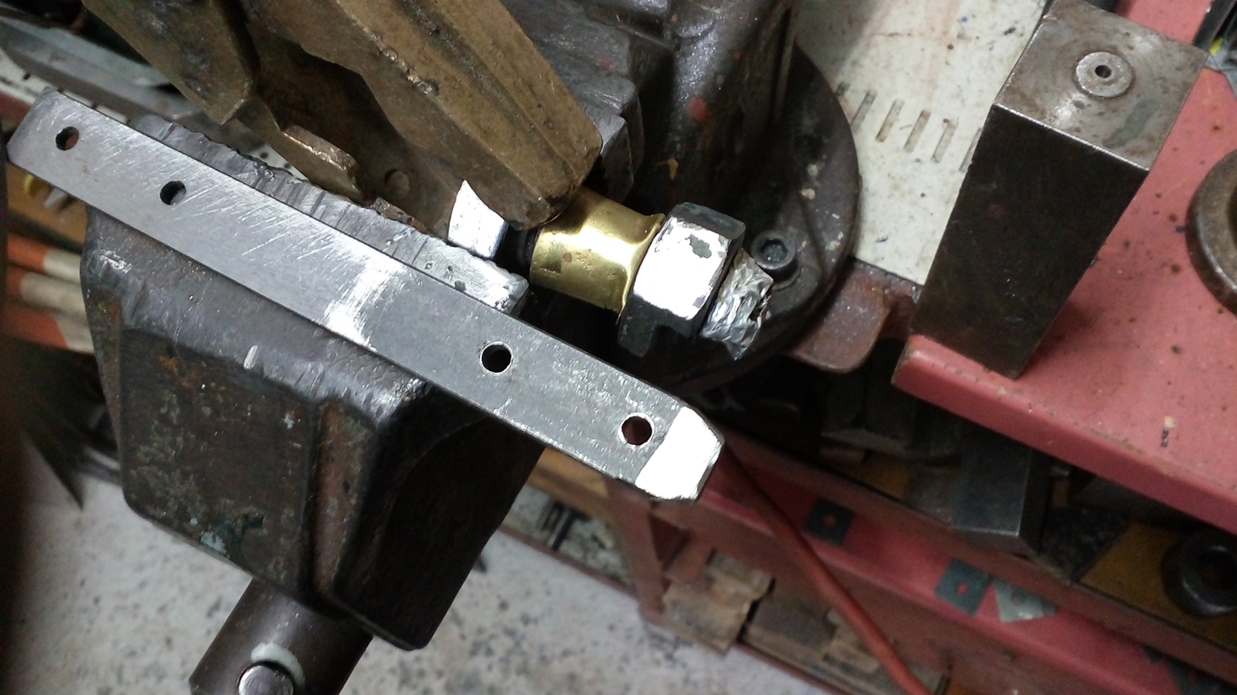

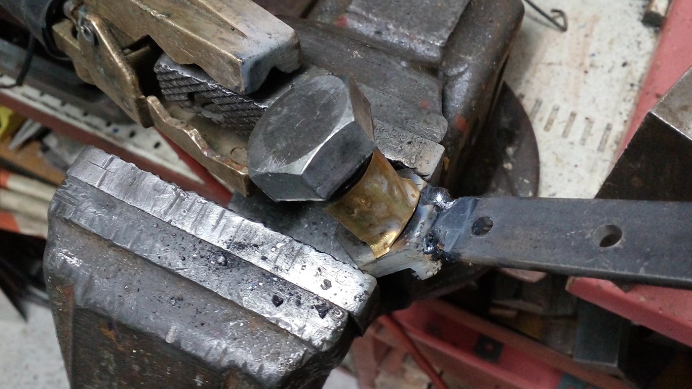

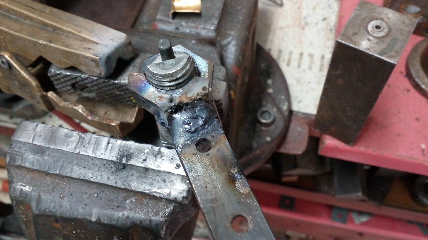

Cut of from the broken Ø4mm drill bit the needed piece and then weld the handle at the nut.
Attachment 32537 Attachment 32538
I have used a piece of brass and a piece of aluminum foil for threads protection.
Some bends are available on my YouTube vid.
