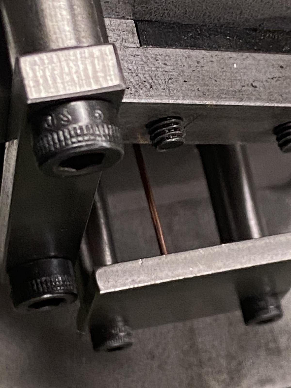

Following on from the chains I made for my 1" traction engine https://www.homemadetools.net/forum/...in-links-77714 I thought I would share the wire cutting guillotine I made to support the manufacture of the chain links.
There are commercially made wire cutting guillotines mainly used in the jewellery trade that can be purchased from the normal websites, but reading the reviews I decided to make one that would be a little more industrial for my purpose.
The criteria for the tool was to be simple to use and a stop that could be accurately set. The cutting blades to be made interchangeable so if worn or damaged can be replaced. Commercially made cutters don't offer this so once worn the whole tool will need to be replaced.
The stop on my guillotine is set by using slip gauges.

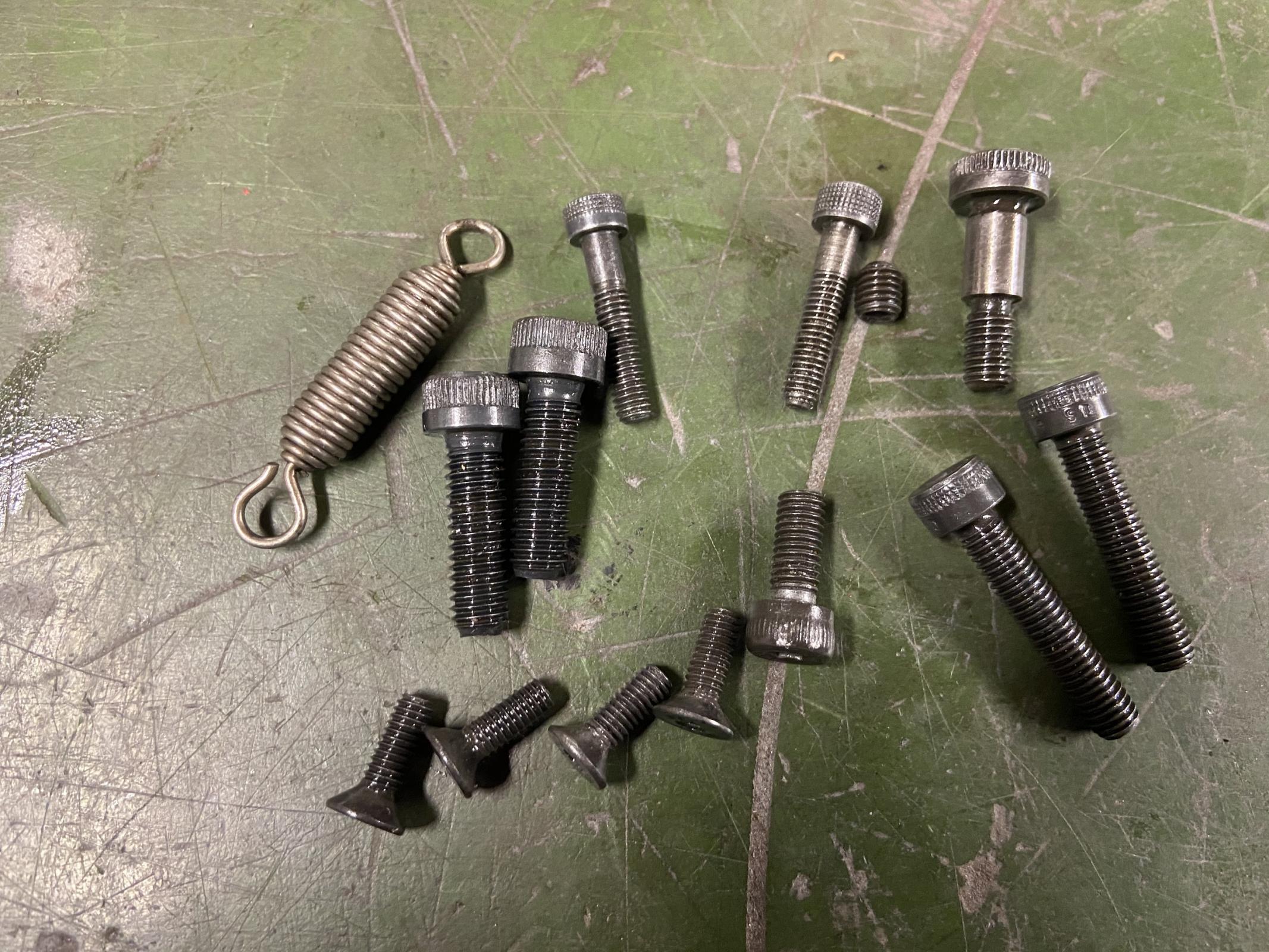

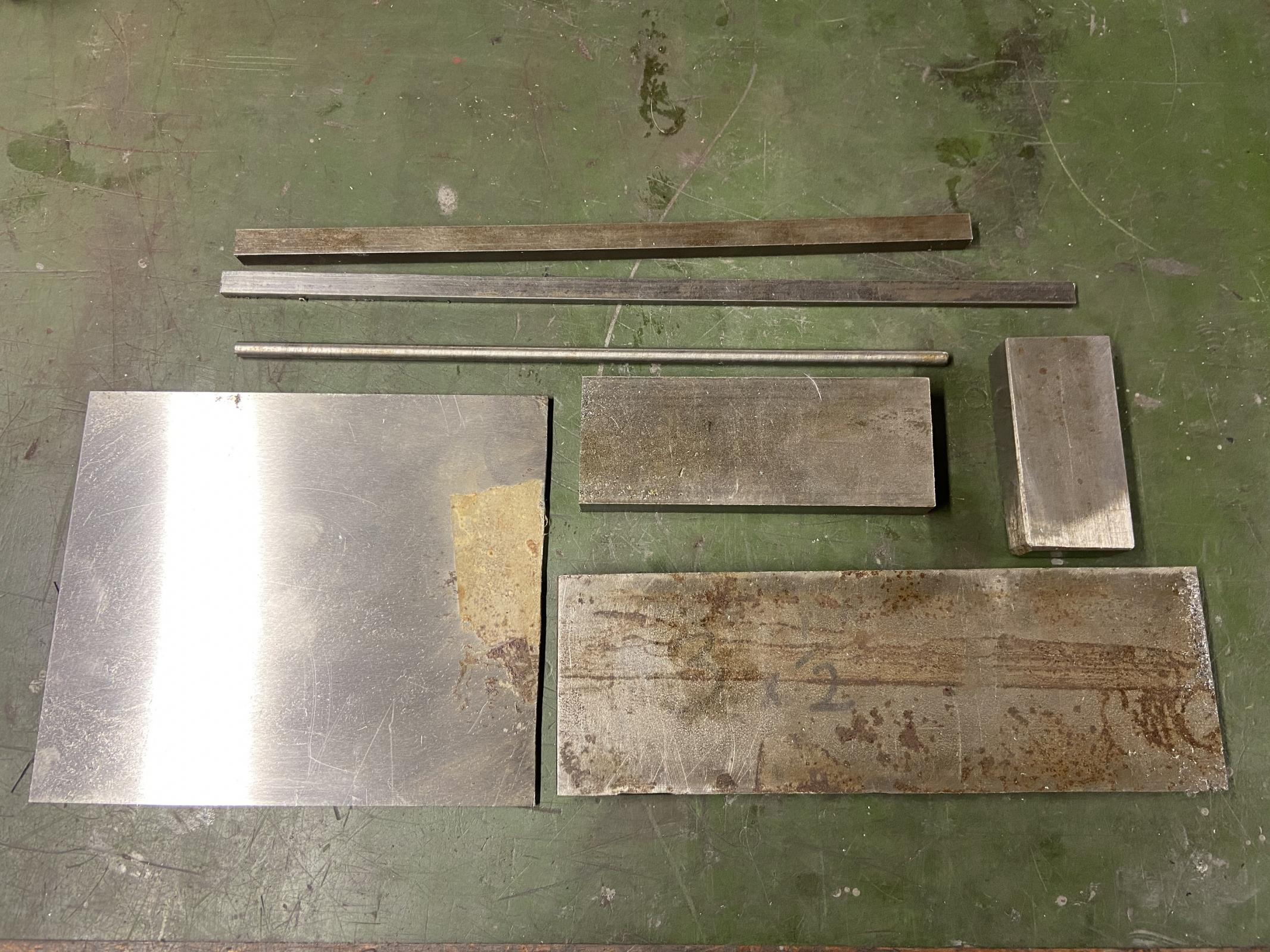

The stock material is a combination of mild steel and gauge plate. Stock metric screws and spring also used in build.

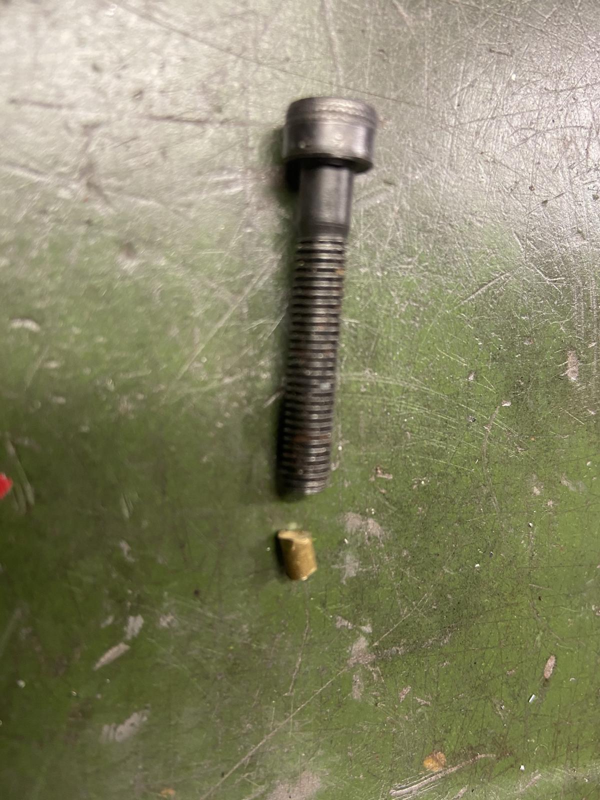

Brass slug used to prevent stop shaft being damaged from screw, see link for more details
https://www.homemadetools.net/forum/...721#post108247

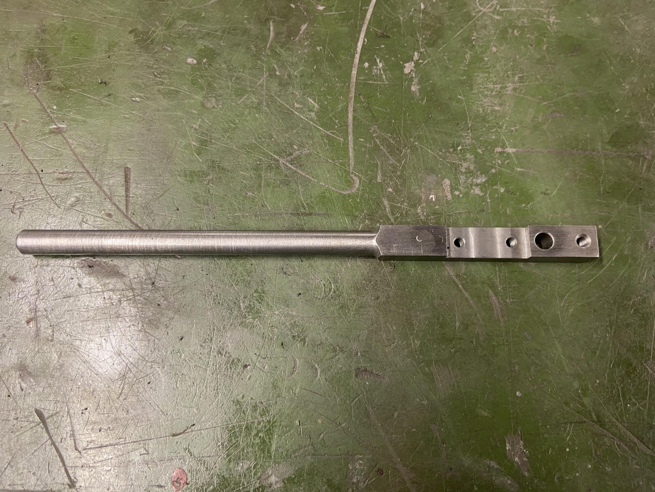

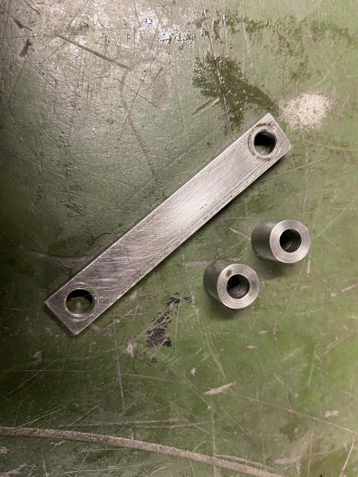

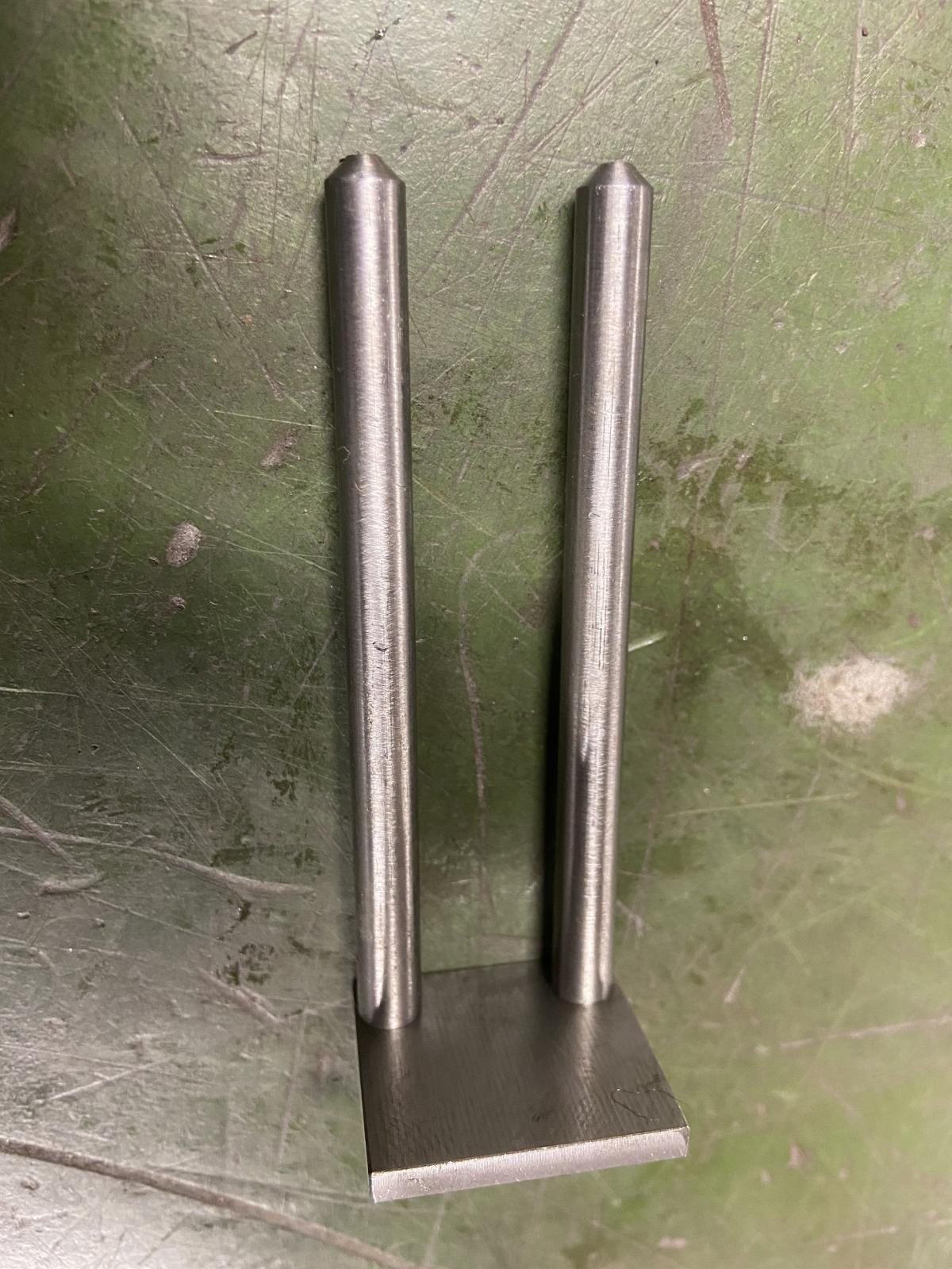

Stop and shafts

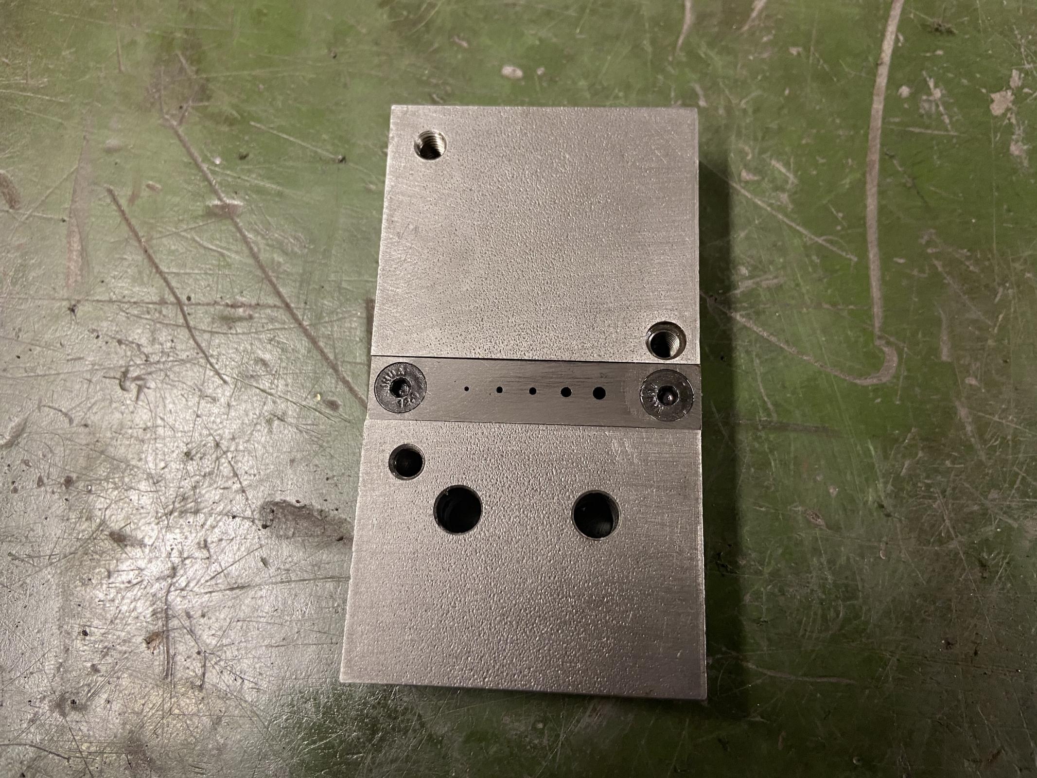

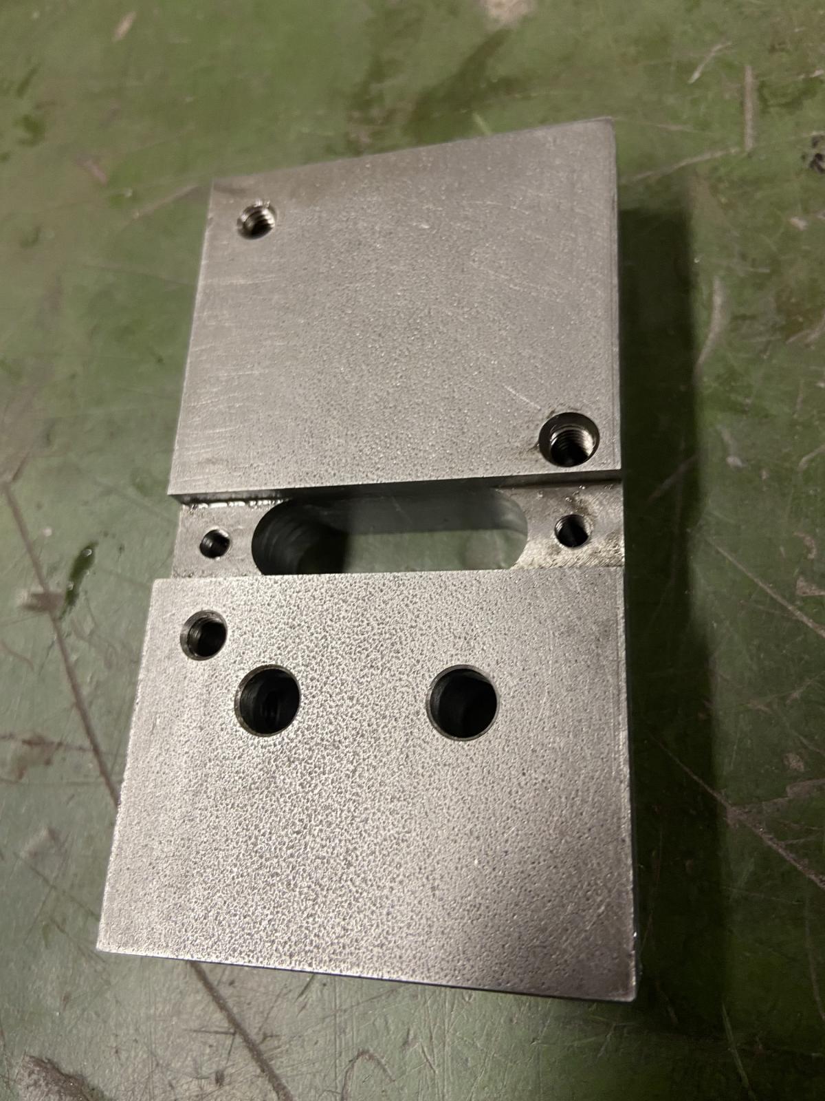

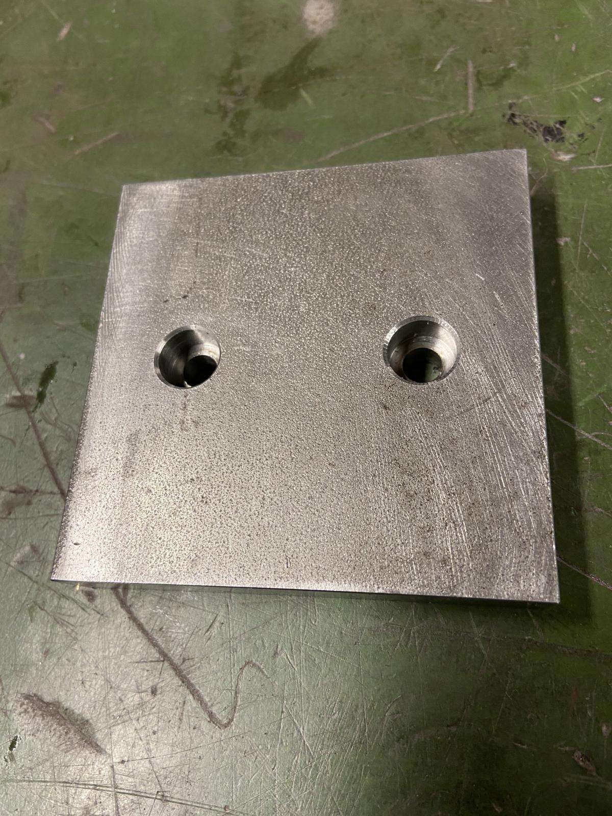

Main body and base. The base allows for the tool to be held in bench vice.
Attachment 33558 Attachment 33560

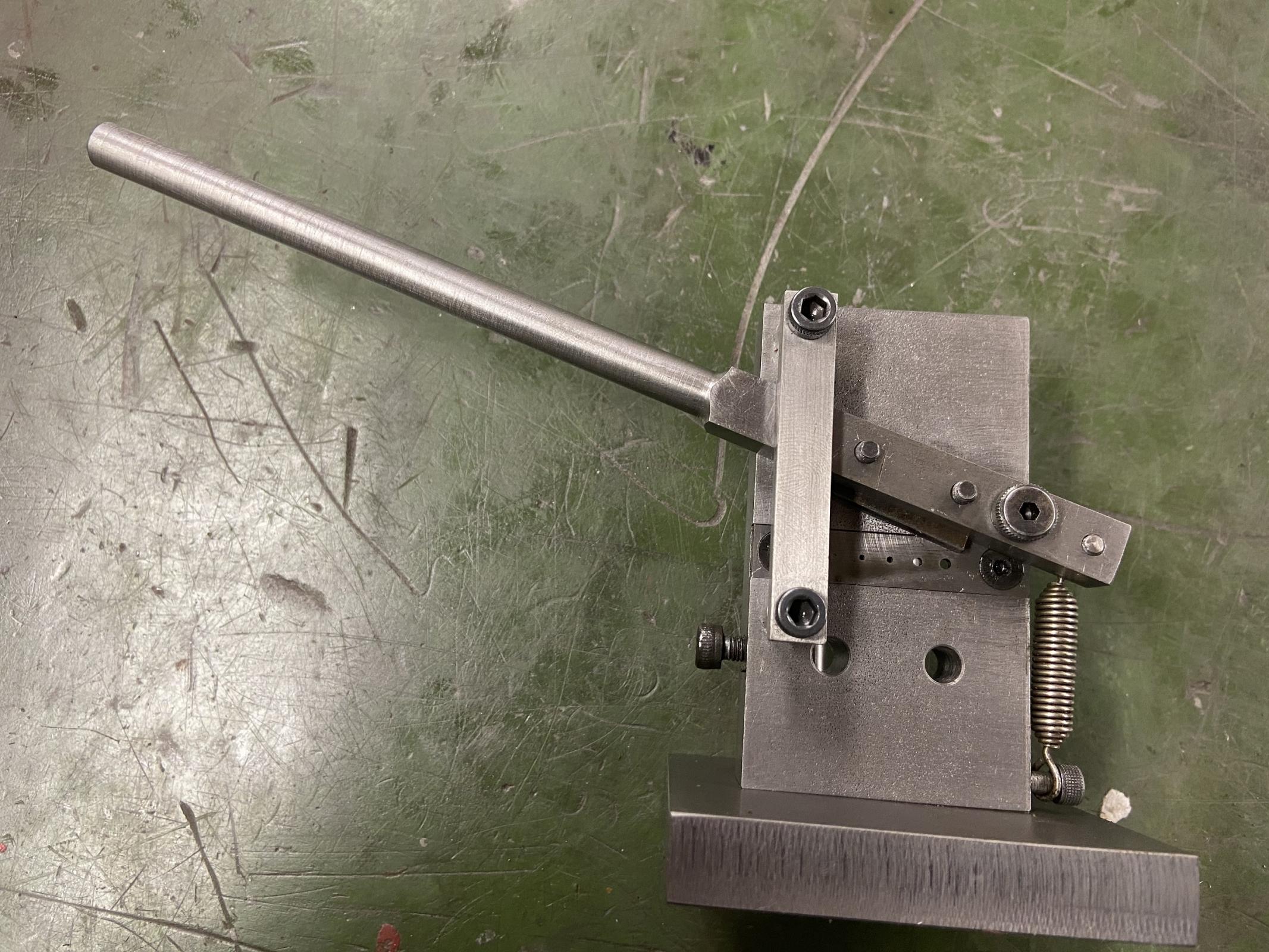

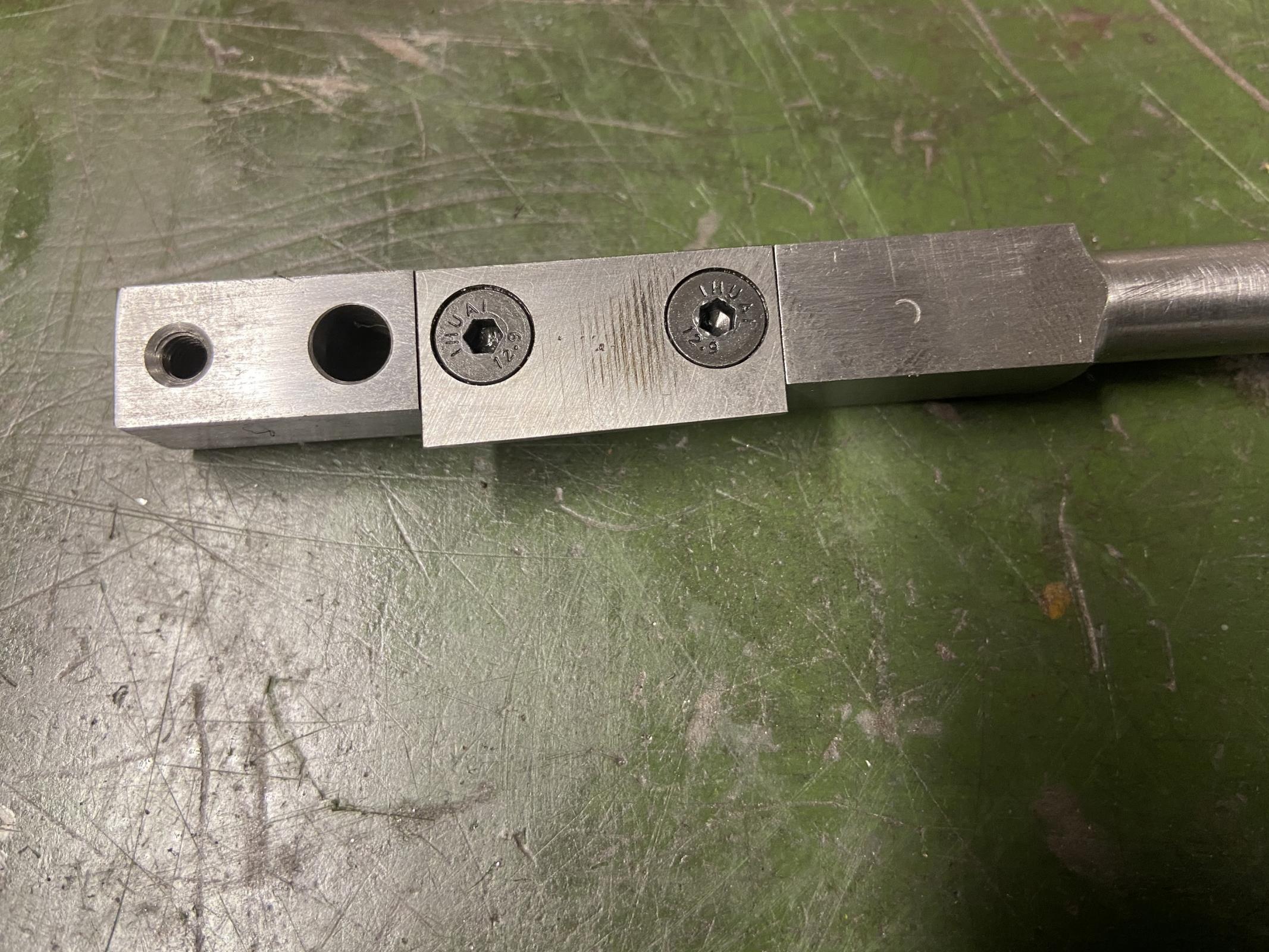

Guillotine handle and handle retainer.
Attachment 33556 Attachment 33557

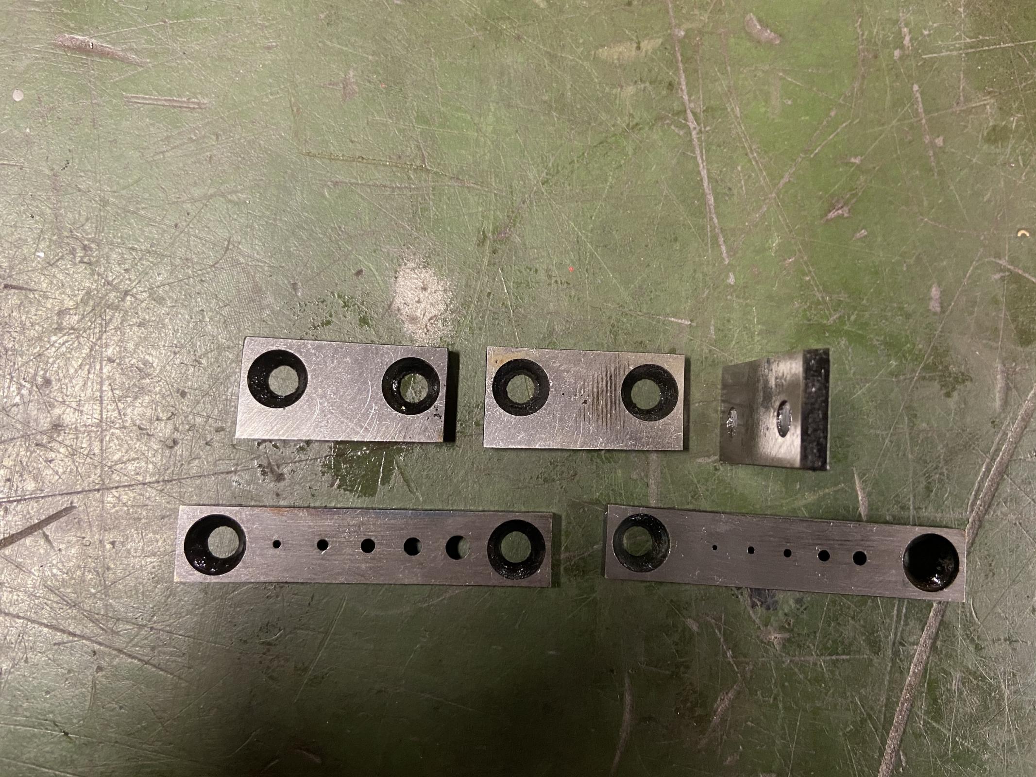

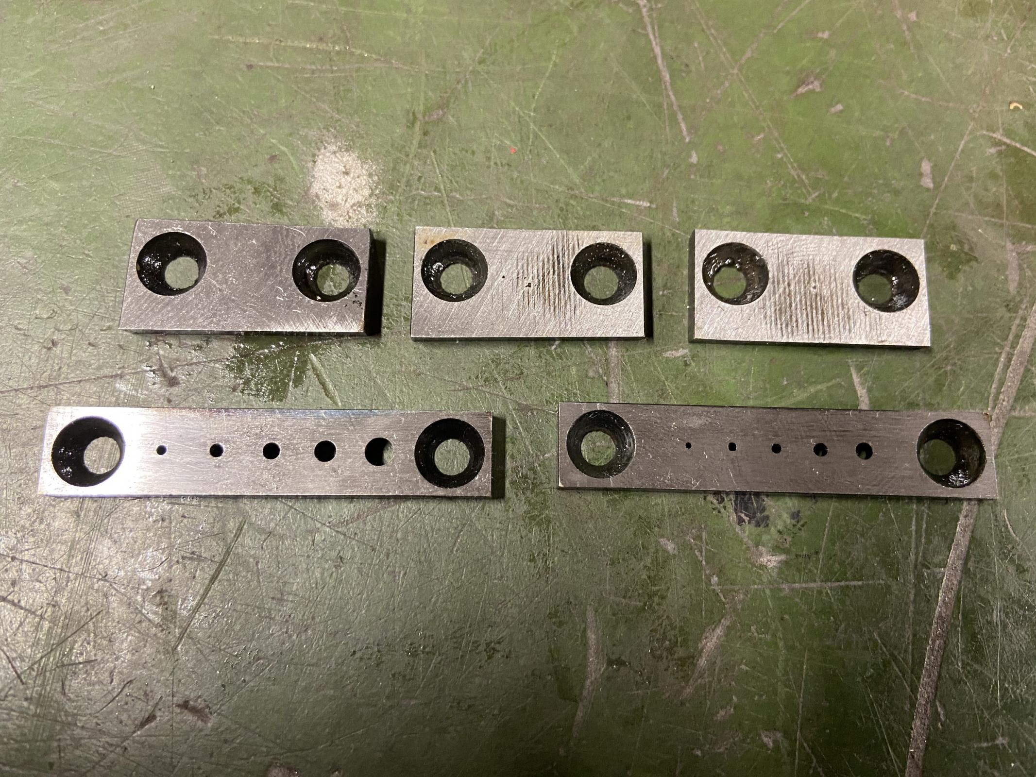

Gauge plate blades hardened and tempered. Several size wire diameters can be cut.
Attachment 33553 Attachment 33555

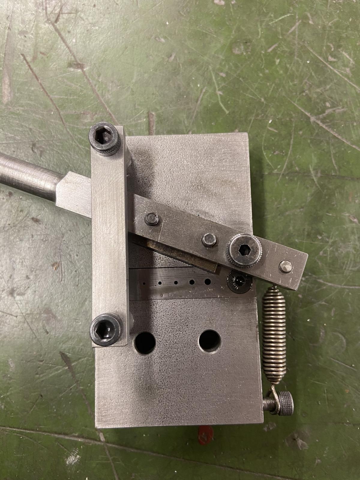

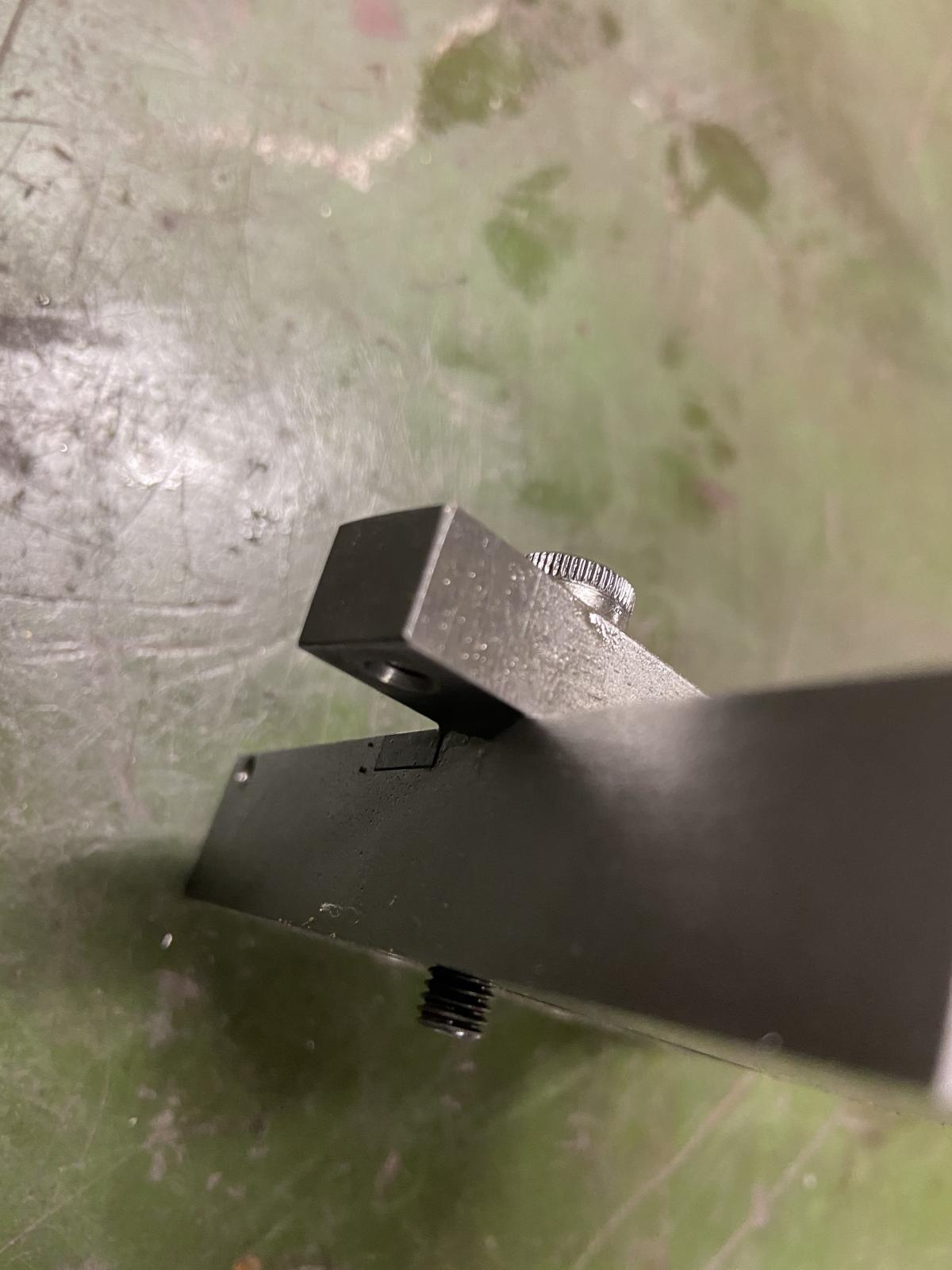

Removable cutting blades in place in main body and handle

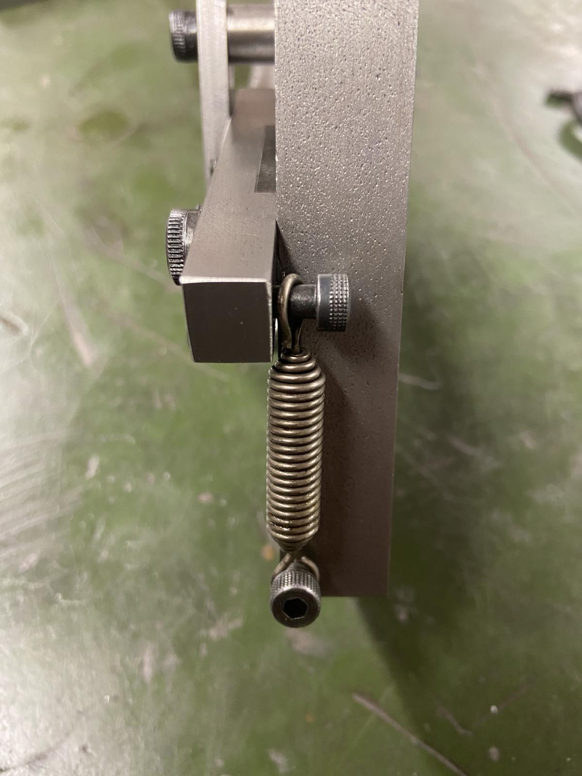

Spring return of handle

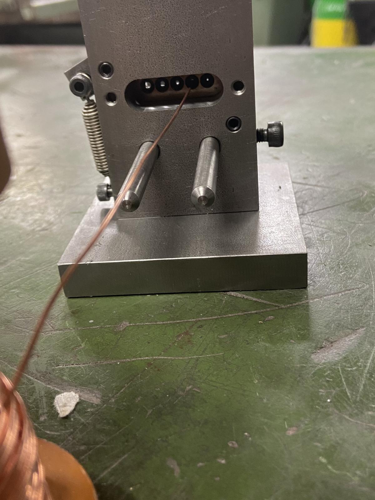

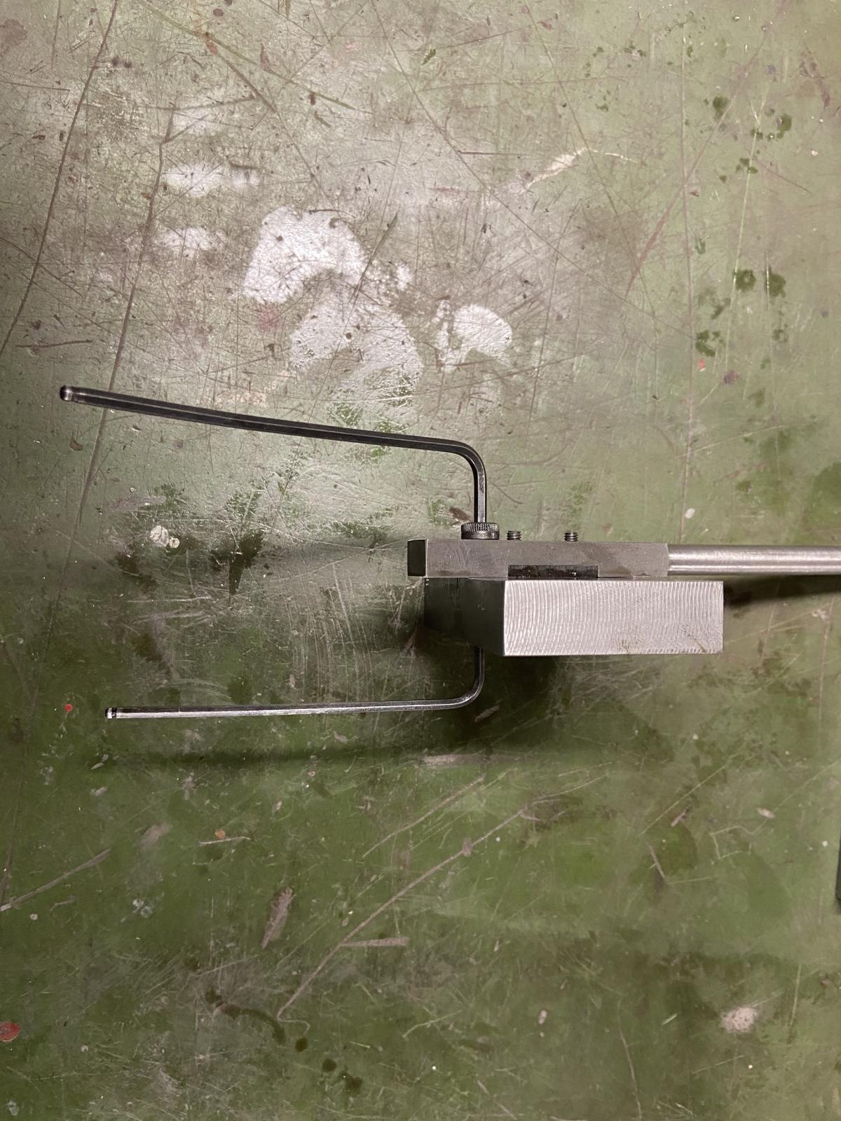

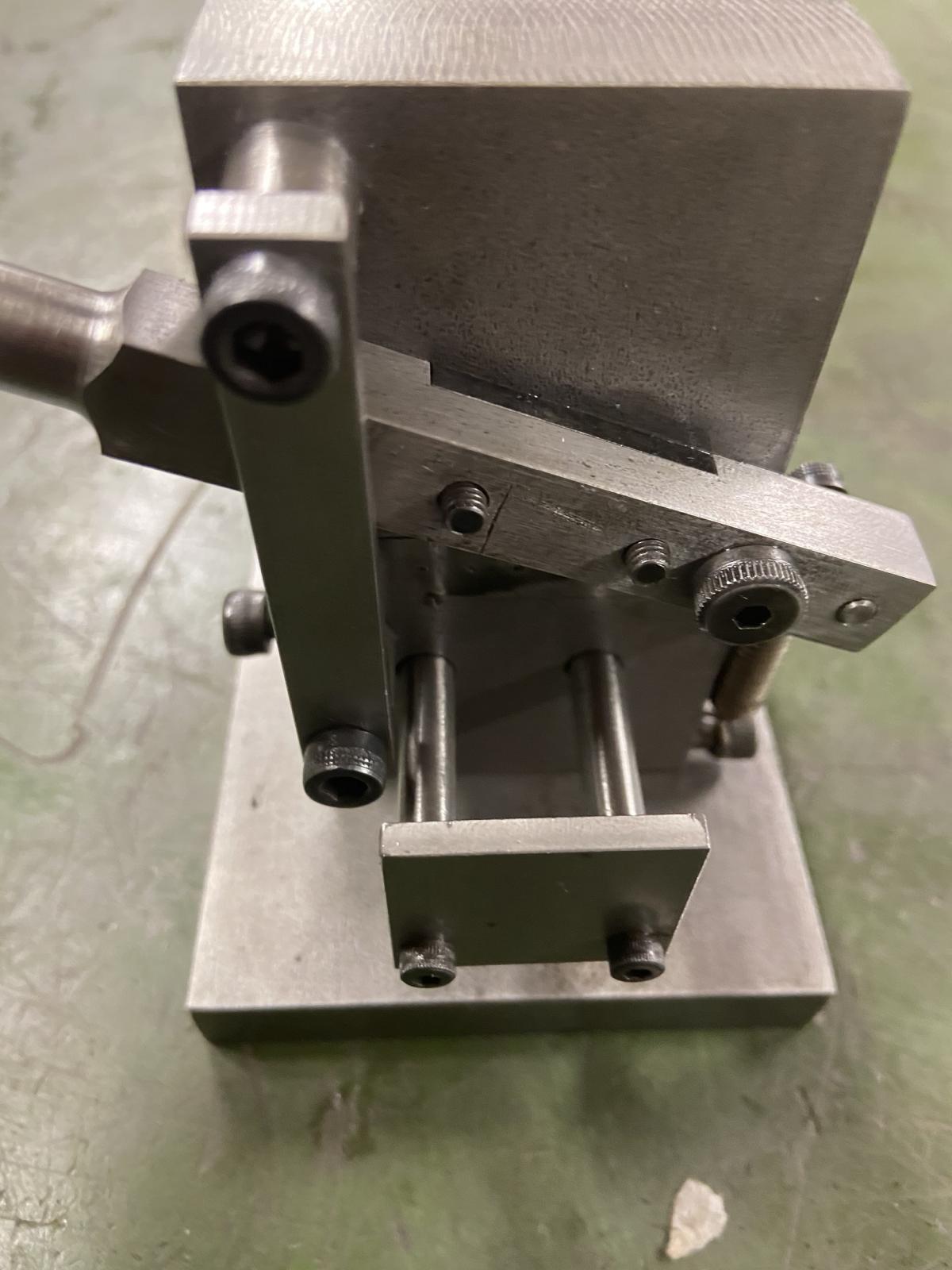

Stop and wire being fed into guillotine.
Attachment 33569
Completed tool
Attachment 33570

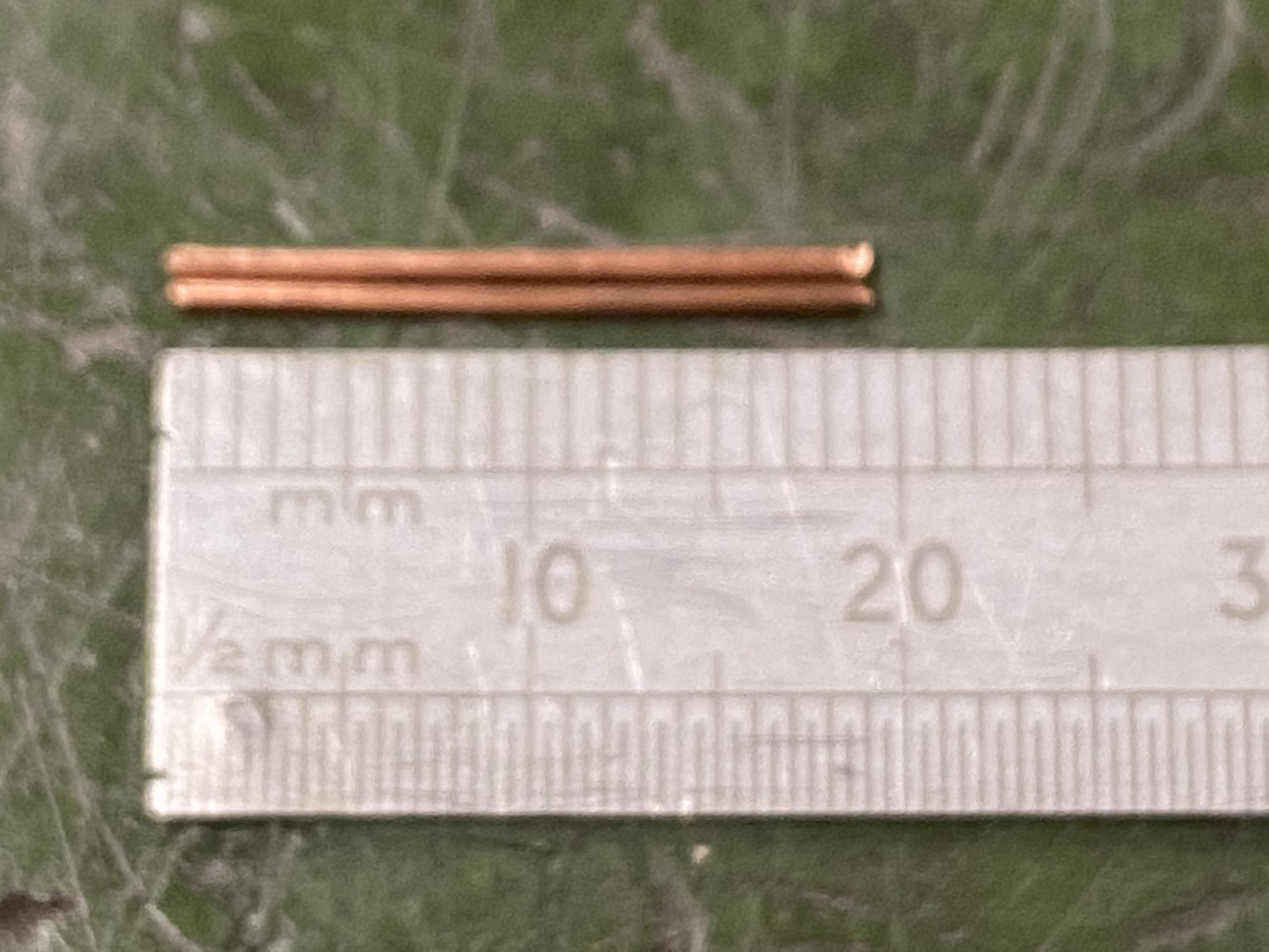

Wire cut to length.
