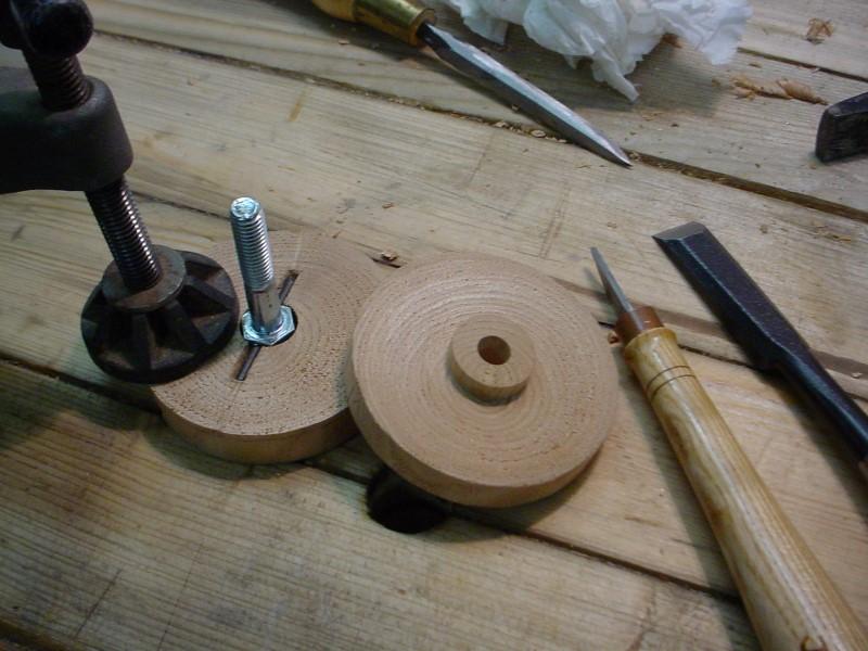

I would like to highlight my technique for making wooden knobs.
People often think that a wooden knob could be too fragile for a strong tightening or think that the screw could too rapidly turn into the wooden part ...
That's not true and here is how I make my wooden knobs :
http://www.labellenote.fr/file/Woodw...pidaire_20.jpg
Two wooden disks are turned out of a same piece and are then parted in two pieces.
An hex head screw is then drilled across its head, and a pin is inserted in that hole.
In one of the two wooden disks, a hole is drilled, just the size of the outer diameter of the screw head.
Then a little groove is carved to let the head with the pin to be inlaid entirely in the wood.
Both wooden disks are then re-glued with epoxy.
After drying, the screw shaft is chucked back on the lathe, and the knob is turned to its final shape.

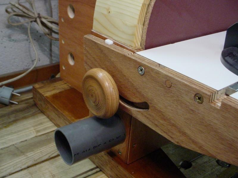

Here it is :
http://www.labellenote.fr/file/Woodw...pidaire_28.jpg
Here are some other examples where I have used this technique :
