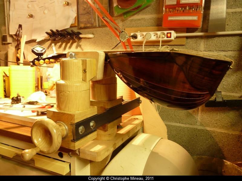

A wooden vise for instrument making
I didn't look too far for inspiration, but I made this one (nearly) entirely of wood, except the slides and the screw.
http://www.labellenote.fr/file/Luthe...lutherie_1.jpg
All the details on my site, here :
La Belle Note - Instrument making vise
Funny, no ? But it is very usable in practice, I use it every day.
The interest of this kind of vise, for those who are not familiar with, it's the soft jaws that allow to grip even on a finished piece, and the fact that the jaws are not parallel, they can rotate and follow the geometry of the piece.
The opening also, is quite deep.
