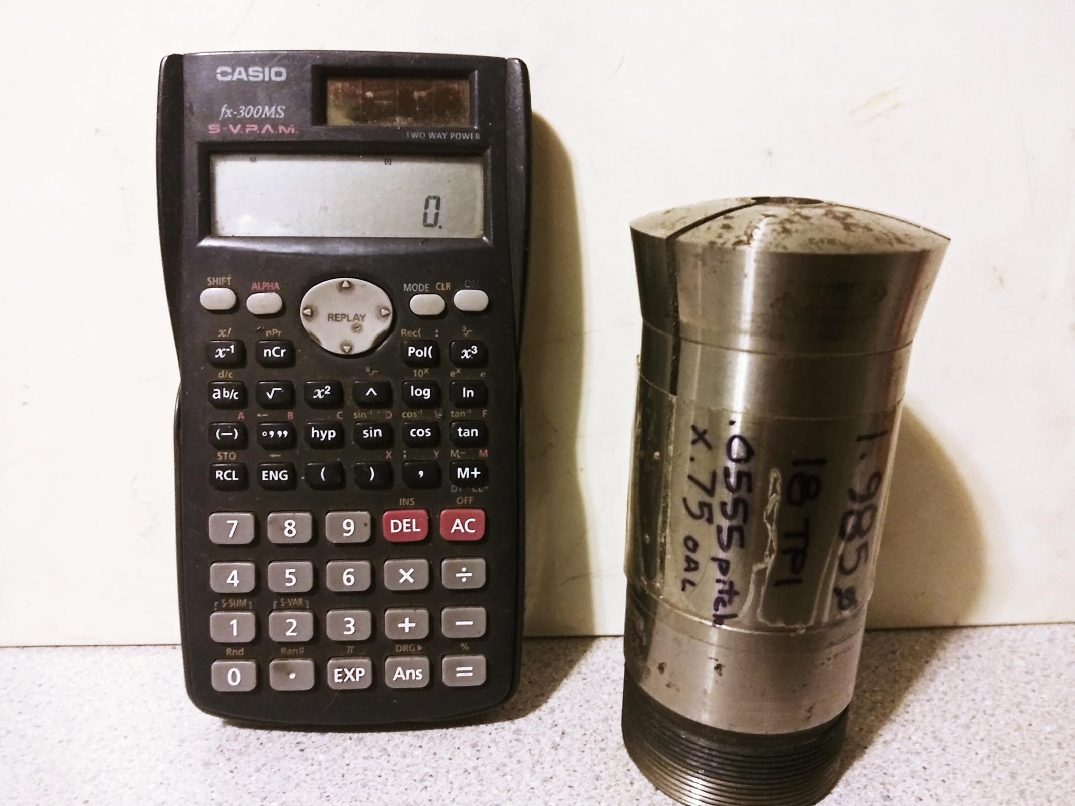

In a distant galaxy, there is a lonely set of big 215 collets.
Attachment 38320
Acquired for a song, but misjudged as 2J's, (imminently more popular design) they await a spindle nose in D1-6. Alas, that beast is so elusive (expen$ive) and burdened with it's own 215 set, to cause a transaction.
Why not, TM51 said to himself, make a spindle nose? Despite pouring over gear-cutting tomes, solving acute angled pinions and rings is not a setup I can leave start to finish without interruption, it's a lot of teeth! So, haven't bought cutters yet either.
But there's more than one way to close a collet! Worm gear is a new solution. Room for everything; radial and thrust faces, grooved for lube, ID thread length, and a couple spares should last decades. It will increase overall diameter, shorten length, reduce weight.
