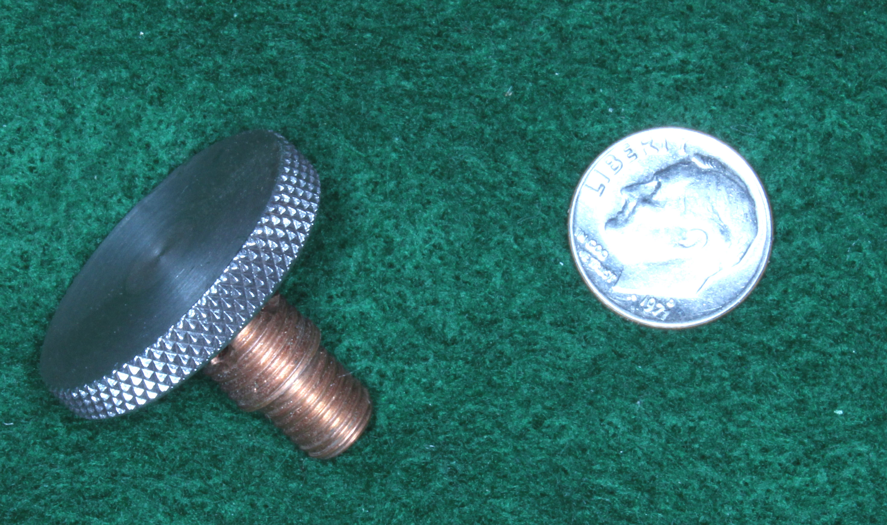

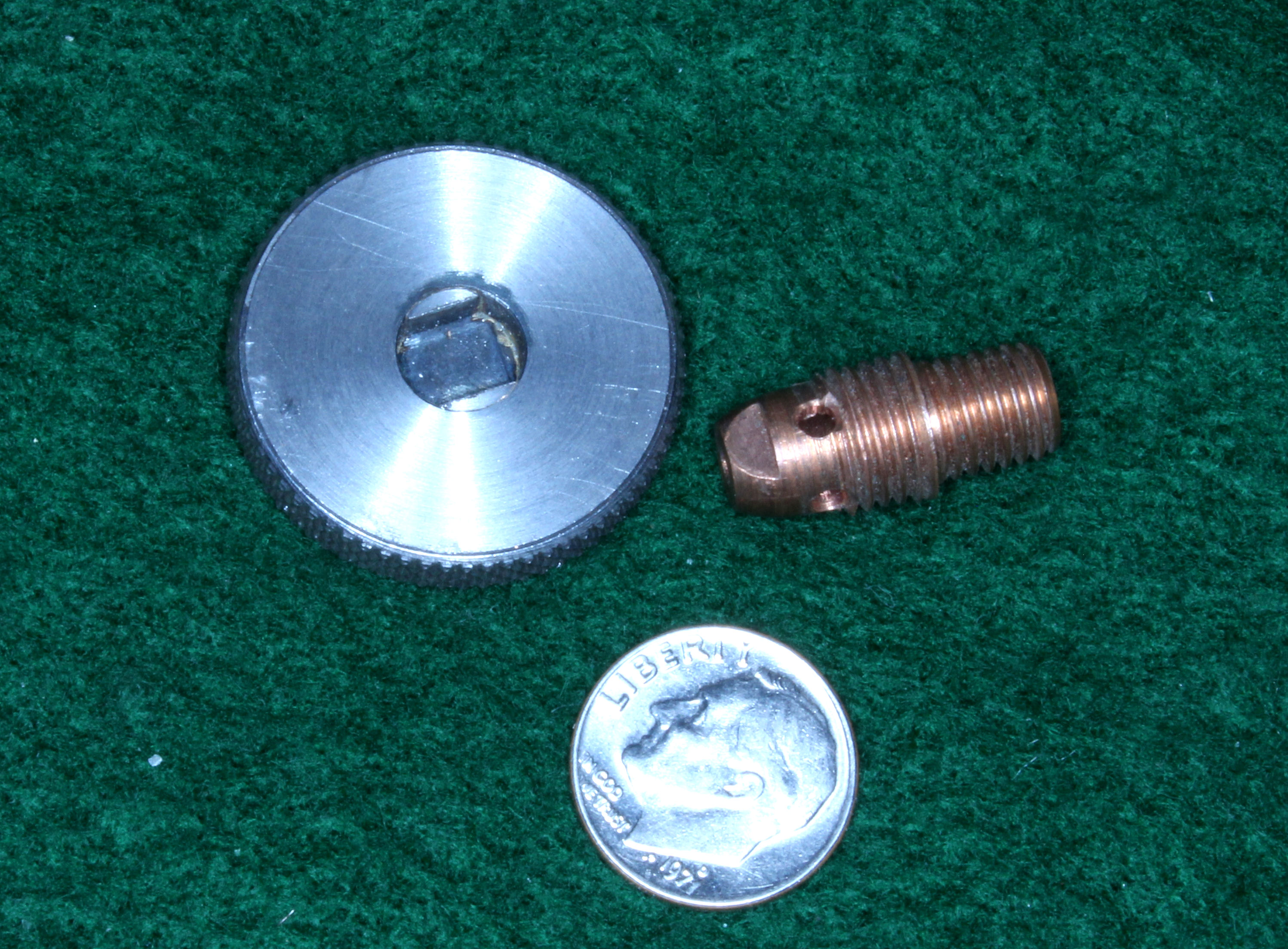

Hokay, so I was changing the collets on the torch because I’d changed tungsten sizes; I reached for the vise grips to tighten the piece into the torch.
“Foreman”, I thought, “you have been doing that far too long. Make a proper wrench fachrissakes, today, RFN!” I know better to disagree with my stubborn self so I said, “yeah, OK, sure Foreman, right now yoo betcha.” Foreman said, “and skip the brownnosing.” “Screw you, Foreman.” “That’s more like it.”
The flats on the copper tips measure .223” across flats, no standard dimension either metric or imperial that I know of other than it is the caliber of standard M4 and M16 military rifles. But OK, I can make it whatever, it ain’t rocket parts.
The tips don’t need to be torqued in with any notable force; they just need to be snug enough to stay put. I decided that a knurled disc would work well, and it’d fit in one of the little square compartments of the little tackle box where I keep the tips, collets and ceramic gas cups for the TIG torch all organized and tidy.
I milled a .225” slot in the end of a piece of .312” dia mild steel rod stock. The .225 is not a typo, I purposely left a coupla thou of clearance. Wrenches should fit fairly closely but they need not be precision fits. Then I made a knurled steel disc in the lathe, about 1” dia and about 0.200” thick with a .3125” diameter hole drilled and reamed in it. Then I silver-brazed the bit of slotted rod into the hole. Then I wrapped the knurled assembly in a skinny strip of thin aluminum roof flashing to protect the knurls, grabbed that in the lathe chuck and machined off the excess part of the rod. The copper part in the photos is the nosepiece of the TIG torch; they are consumables and I have several for each size of tungsten.
Attachment 25875 Attachment 25876
I’ve never seen a tool like this in a welding store but it certainly works a treat. It’ll be right there in the little tackle box of TIG torch parts whenever I need to change tungstens. I’ll grin every time I use it, pretty much every time I fire up the TIG welder.
