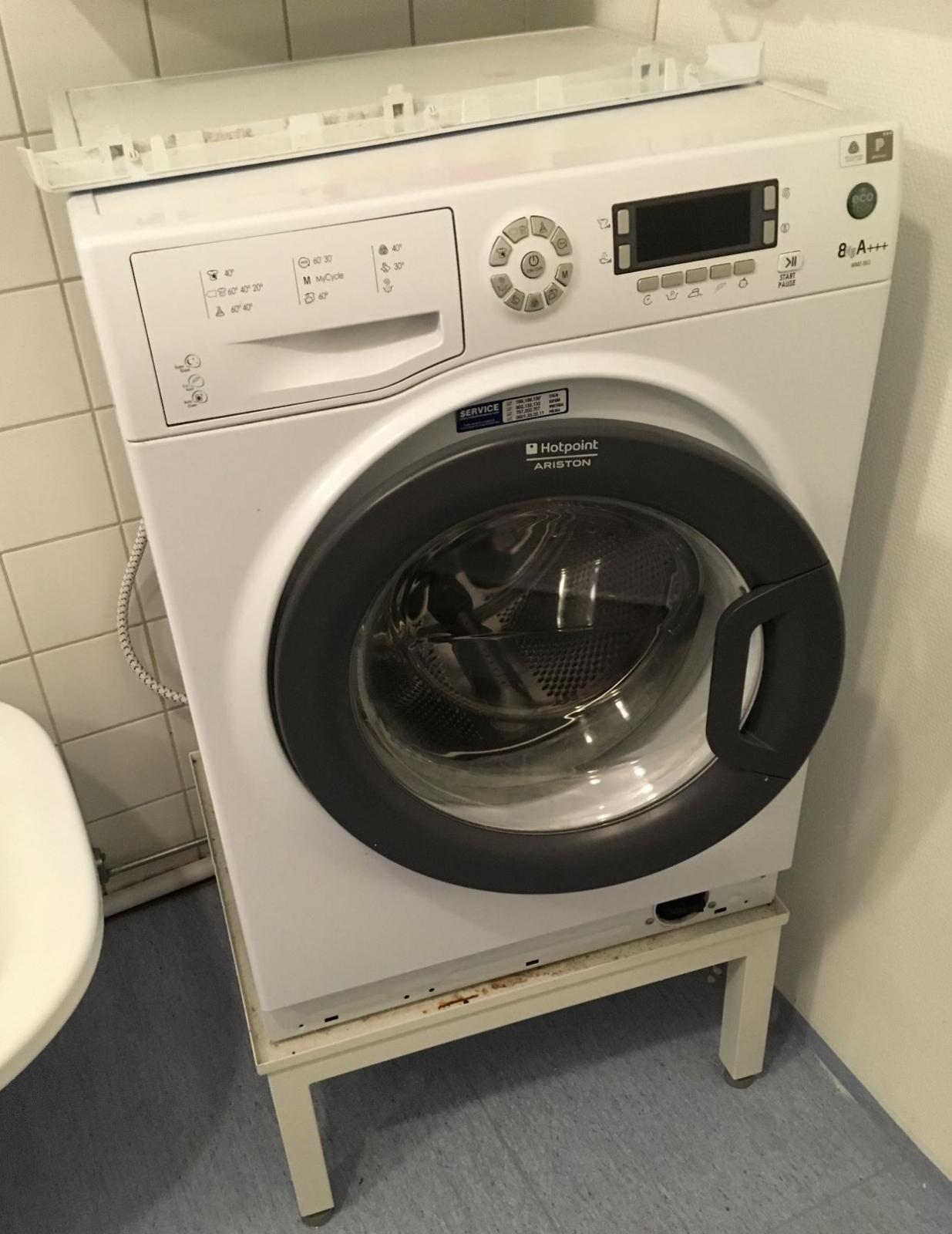

After some 7 years of immaculate service our Ariston Hotpoint "ECO" 8 kg capacity & 1600 rpm spin, "WMD 863B EU" model,
started some "growling" in its spin cycle, driving my beloved up the wall (see pic - the machine: neither the partner nor the wall):

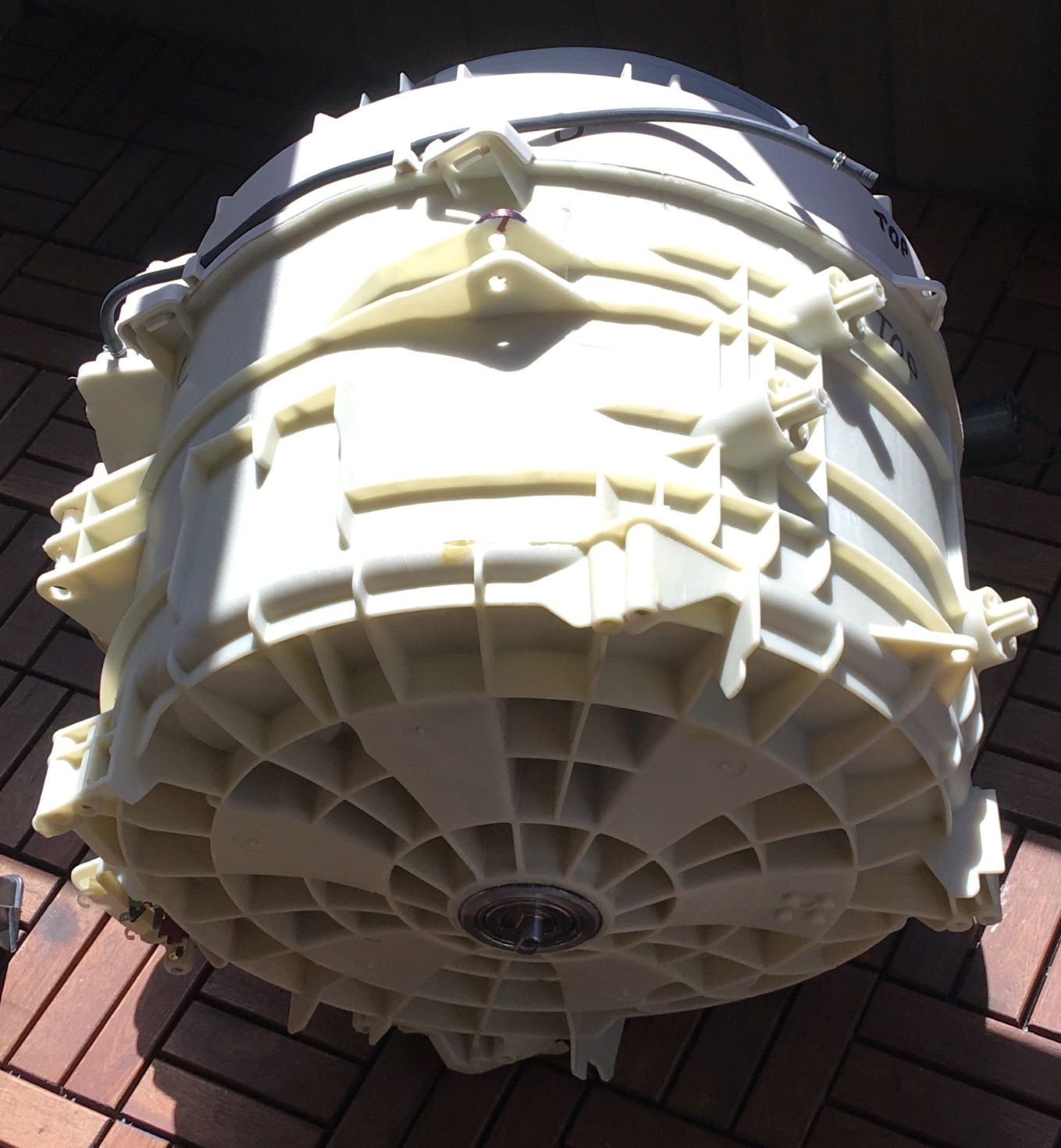

-Voila: "The Unit".
Attachment 35071
The Greeks called their fundamental constituent particle "Atom", "ἄτομος": greek for "inseparable",
only to be proved false some 25 centuries later.
Consequently I was very much in the mood for dividing "The Unit" (alleged by some manufacturer) into its constituent parts:
Attachment 35072
Trying to prove I'm not entirely nuts, I had previously drilled a lot of 5,2 mm holes through the "weld seam" in the two halves,
providing a means of rigidly holding them together with M5 screws and nuts in the bright, promising future.
Hypothesis for keeping the previously "Sealed Unit" water-tight will probably be revealed and tested,
given I can get the old bearings out, and new ones could be found and delivered.

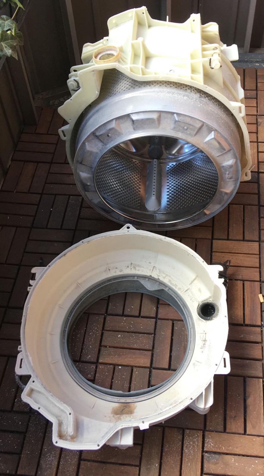

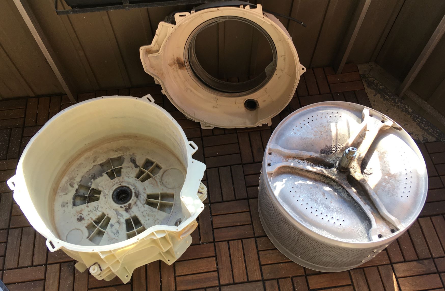

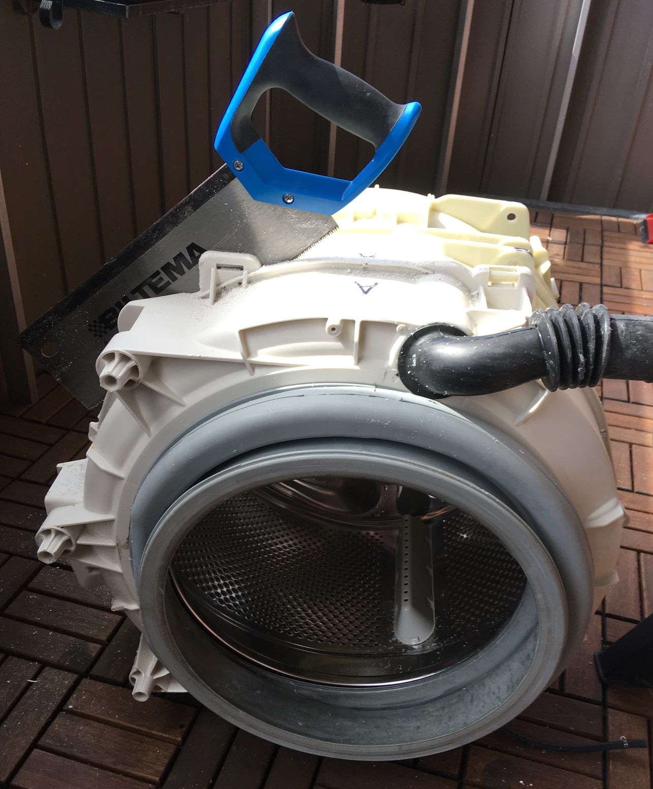

Being at it again, as time is money and winners never quit - successfully sawed the previously "Sealed Unit" apart.

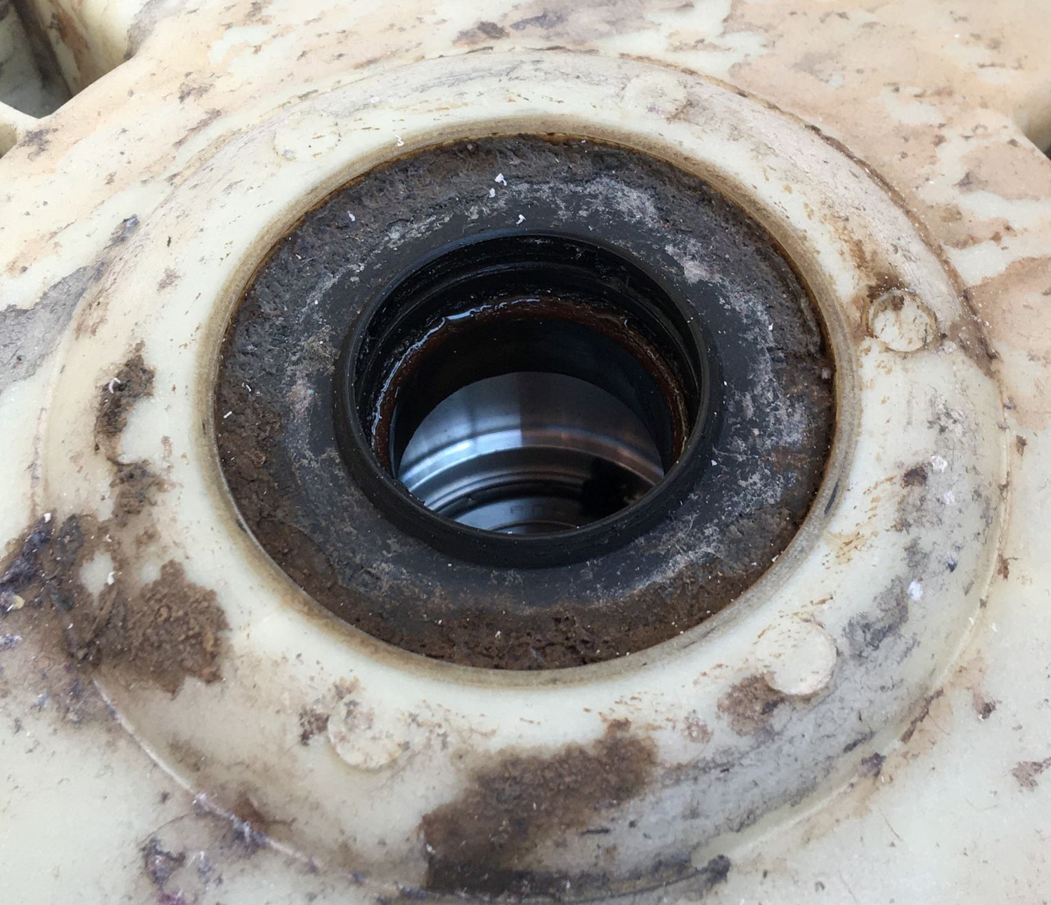

Drum and its axle spider intact from rust, but the insides carry app a pound of organic and non-organic yecchy compounds...

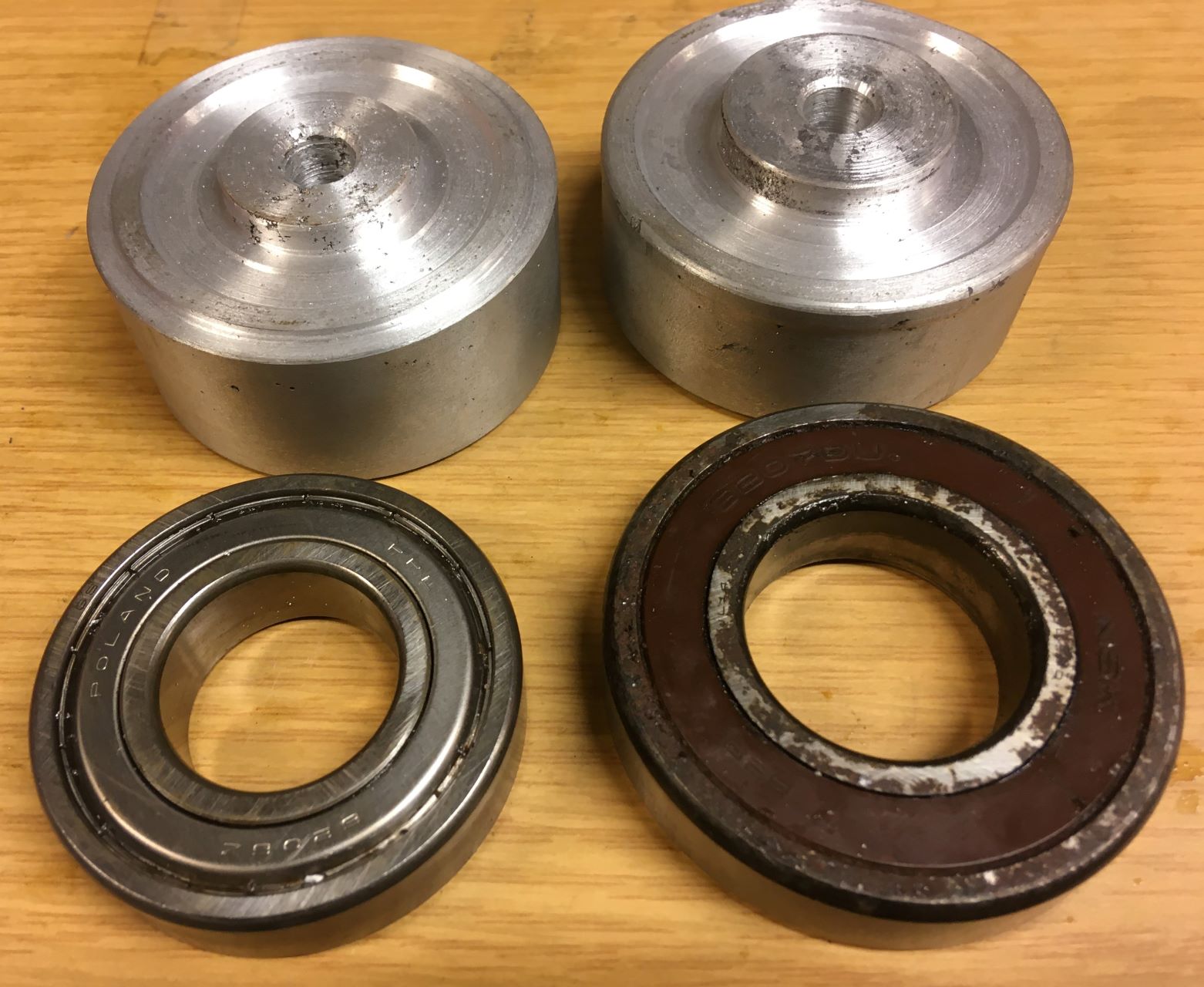

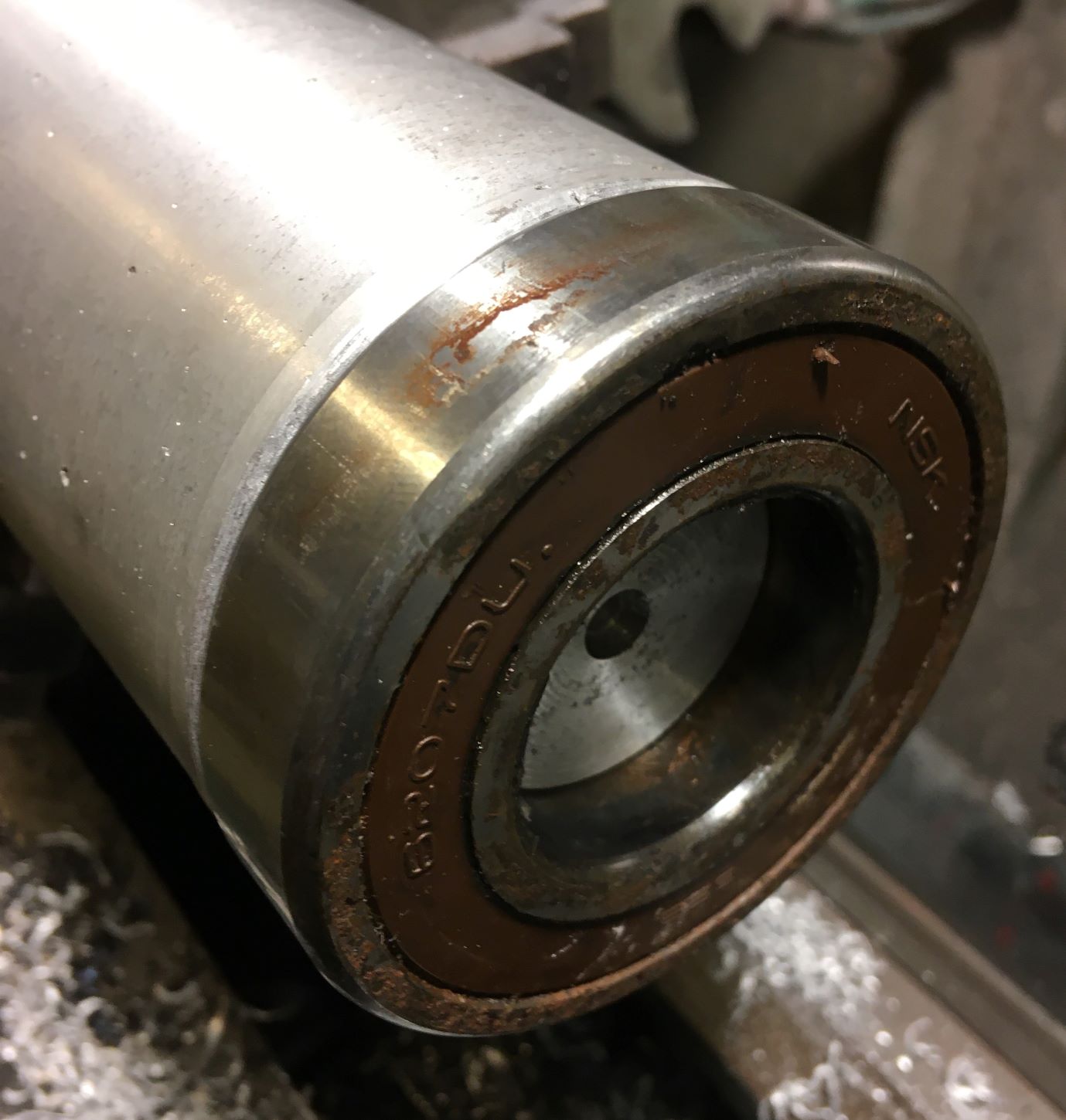

Reason for failure: Oil seal (ROLF 40,2x72x10/13,5mm) had cracked its inner lip,
ruining the balls in the first NSK 6207 DU sealed bearing, the Polish rear PPL 6206 Z still intact.

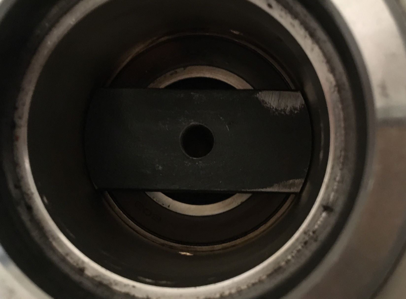

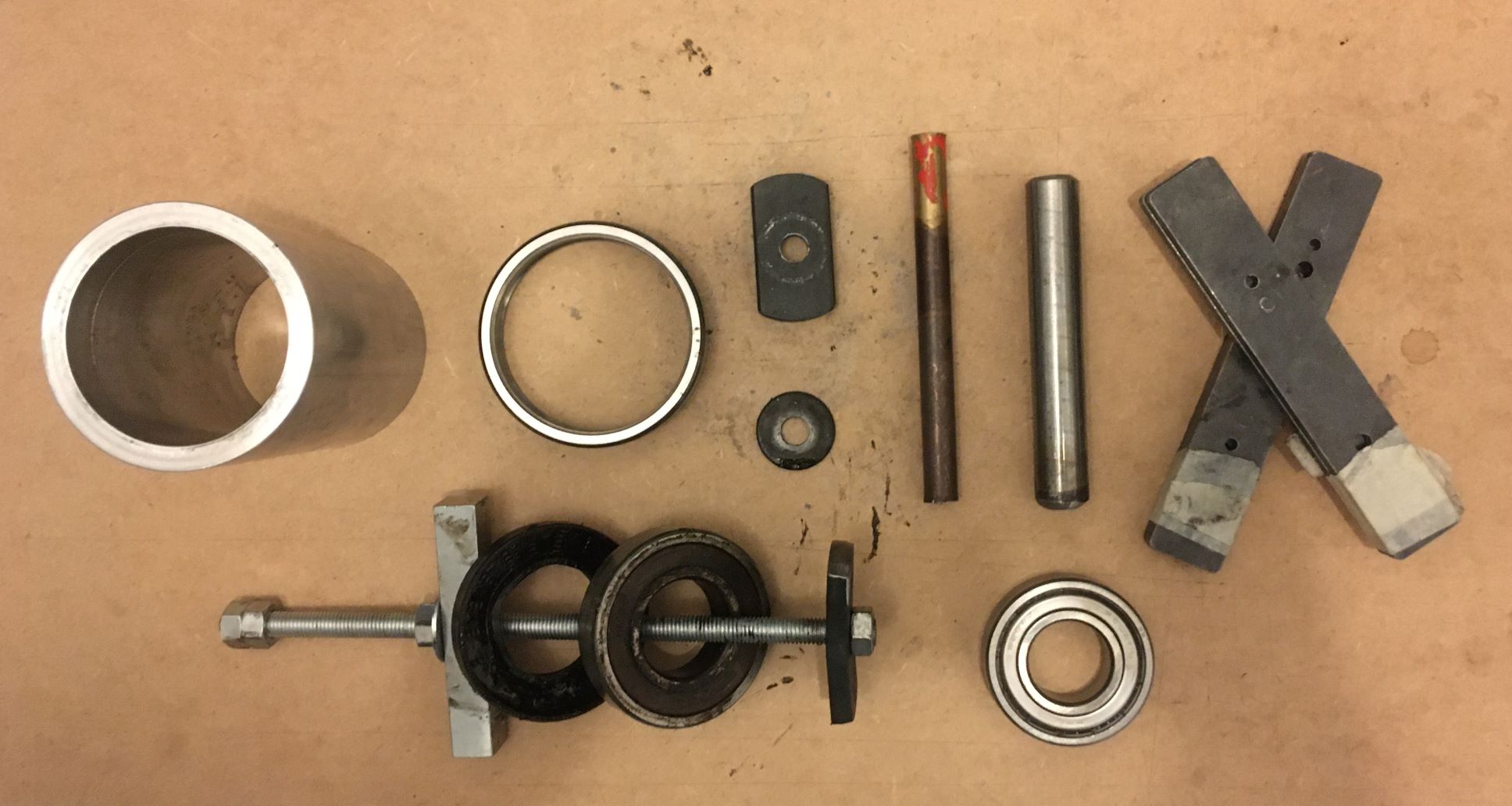

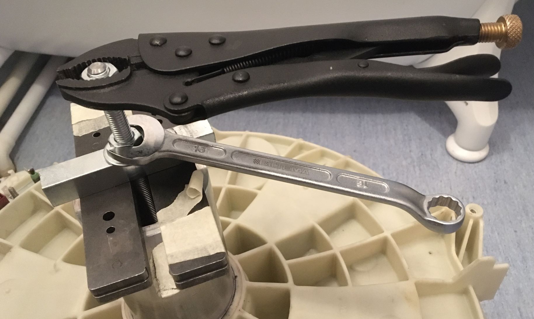

I had to provide a few quickly improvised tools for taking out the bearings, their housing being a tapered affair:
Attachment 35110 Attachment 35114 Attachment 35115
Heat from a hair dryer, application of homebrewed "Ed's Red" creep oil, yanking the wrenches and knocking from the rear,
finally got the bearings and the remains of the oil seal out. Real tight press fit taking its toll on the impromptu tools:

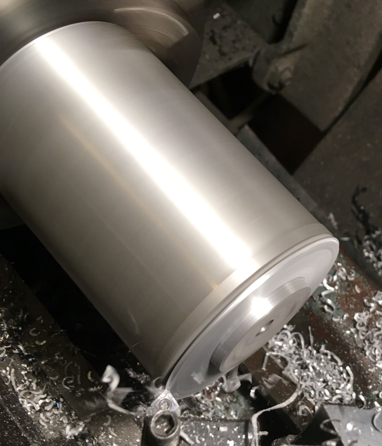

Growling washing machine, Pt 3...
While awaiting arrival of the new bearings and oil seal, I might as well get prepared for their installation.

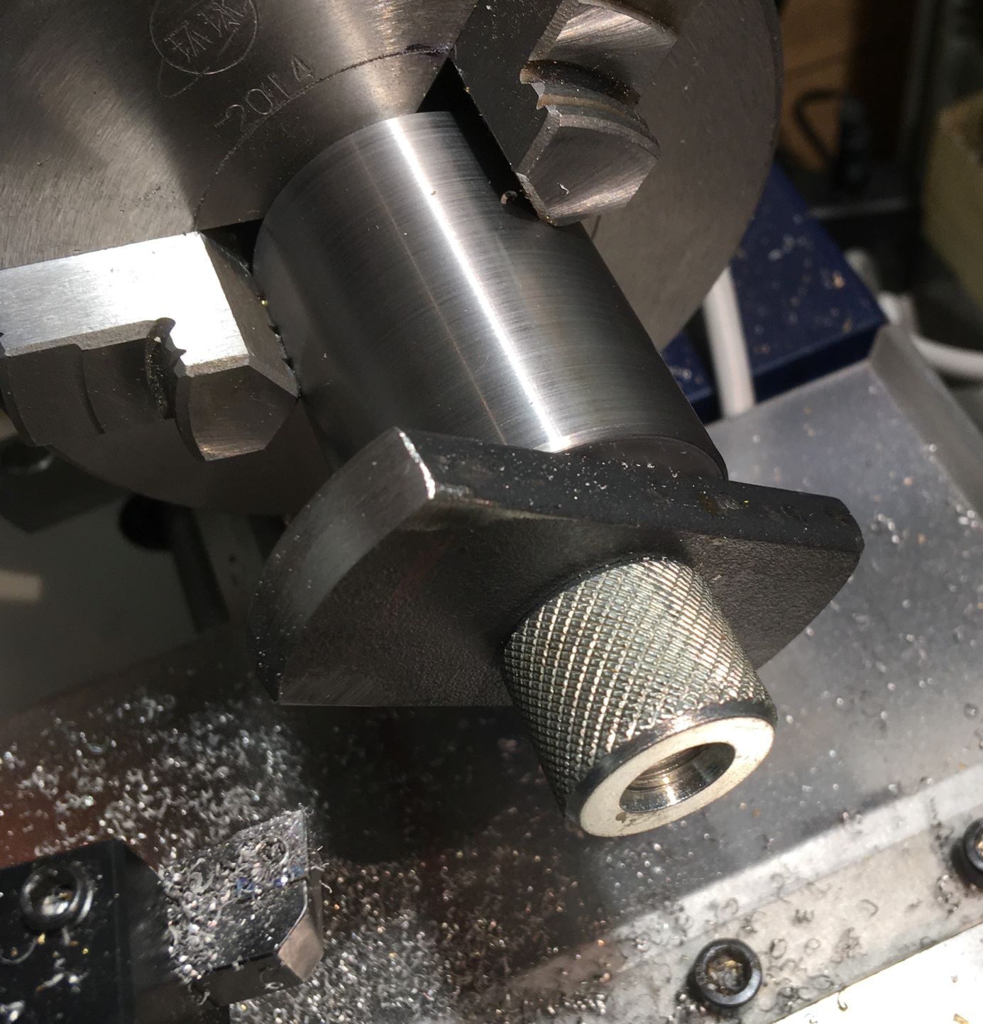

The first casting I ever made a few years ago was dirty and porous, so I might as well use it for some temporary job.
All DIY: pouring the melt into Cocoa Milk cans, hence the small groove (from the can's mouth) near the cutting tool.

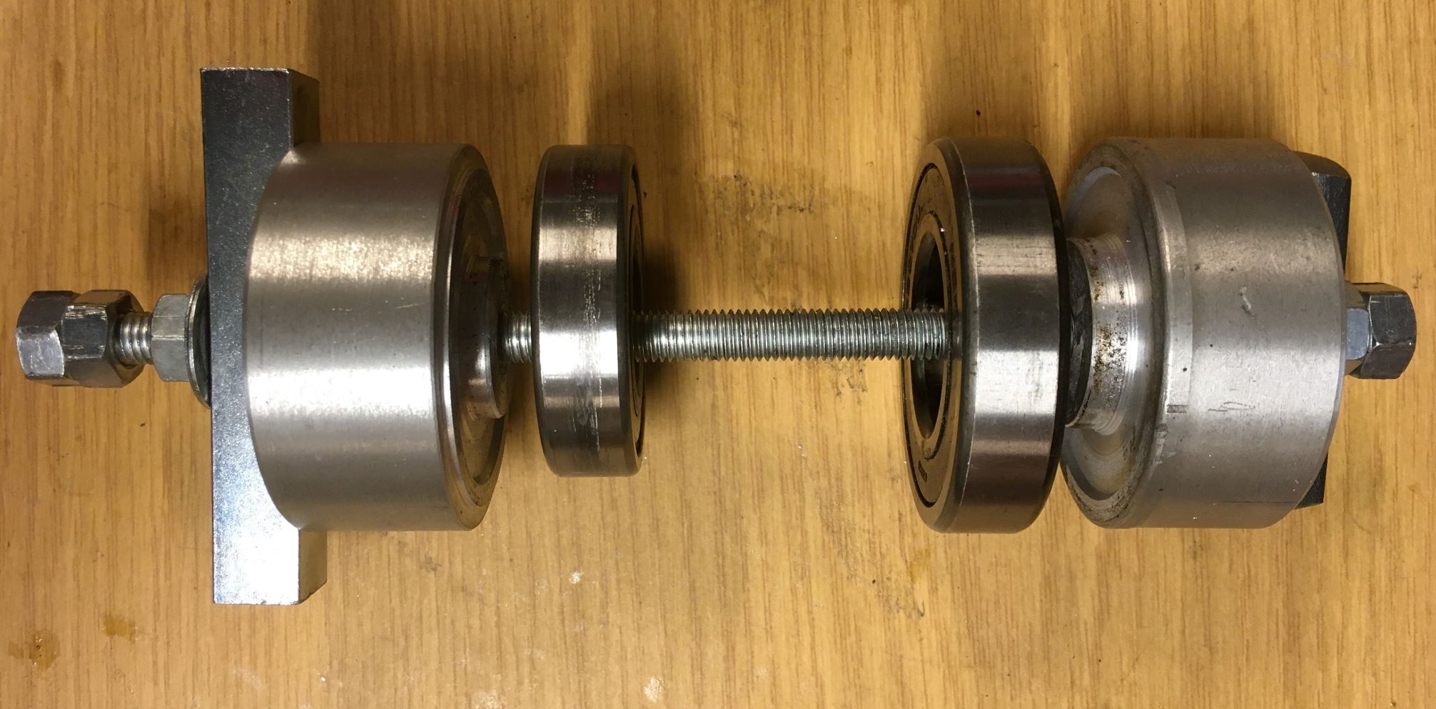

AlSiZn (of unknown proportions) billet in the chuck, making a pair of bearing mandrels:
Attachment 35136 Attachment 35137
Machines excellently, as the high Si content makes for short, curly chips.
Carbide insert at high revs still makes a decent satin finish outta this POS,
though inner porosity is really bad at the center. AlSi dulls HSS tools pretty quick
(I've since learned to only stick to remelting with previously diecast stuff containing AlSi9Cu3Fe)
These mandrels will only bear on the outer race - the rest is relieved. Right pic: Entire "2nd line of defense" unit.
Attachment 35138 Attachment 35139

1) Heat the bearing aluminum housing up to ca 80 deg C (175 F, well below the glass temp of the surrounding plastic)
2) Freeze the bearing and its aluminium mandrel in the (upside down turned) nozzle of an (upside down turned)
CO2 extinguisher, releasing the liquid CO2 (inside at 20 deg C & 850 psi) to -78 deg C (-108 F).
3) Drop the now smaller bearing & mandrel/ cold sink into the now biggie bearing seat.
4) Clobber in place if needed.
5) Rinse and repeat for the other side's bearing.

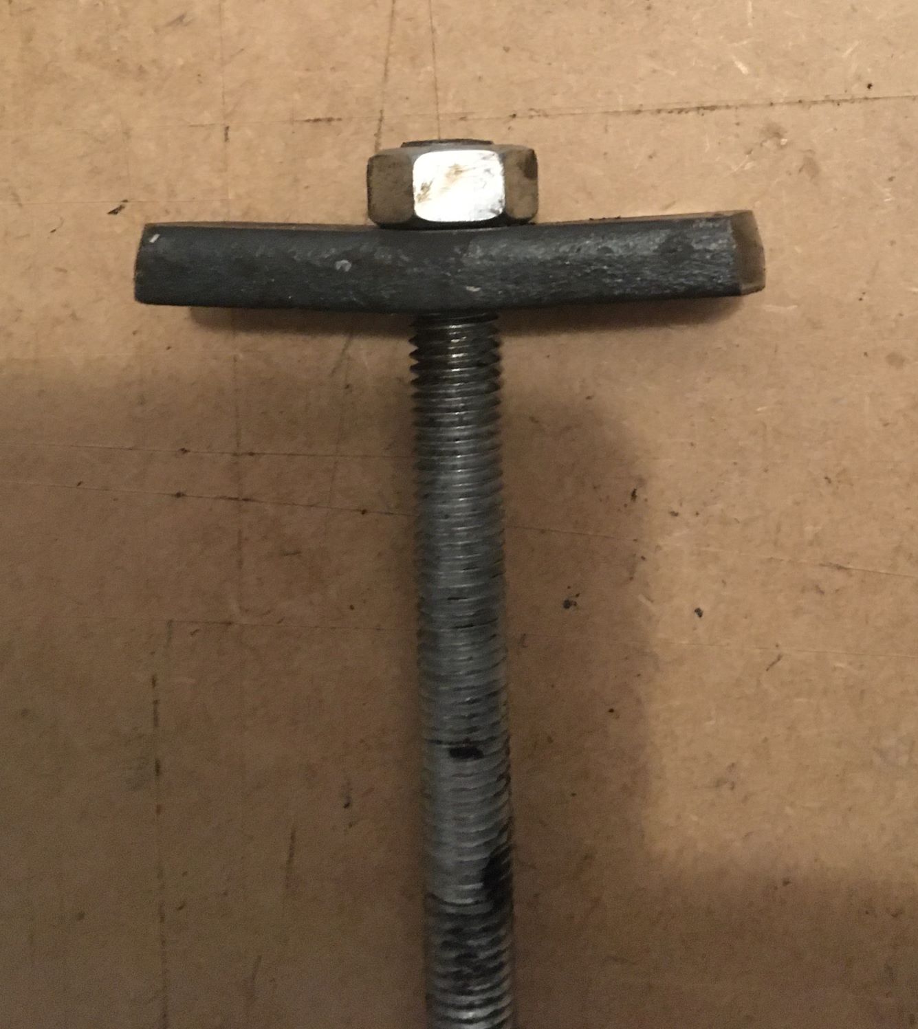

If the above won't be sufficient to properly seat them - enter "2nd line of defense" M10 all-thread, bushings, nuts and tiiiighten.
Whack/ tighten 'em and repeat 'til done.

Starting out with the bearings and their ass'y hardware:
Attachment 35184 Attachment 35185 Attachment 35186 Attachment 35187
The whole affair went so smooth and quick I forgot to take any pics of the oil seal being fitted, sealed and greased,
then suddenly the previously meticulously cleaned drum merely jumped in. -No sweat.

Attachment 35188 Attachment 35189 Attachment 35190
Having drilled app 20 holes around the tub perimeter, fitting the washers and M5 locknuts was the biggest challenge,
desperately trying not to get the grey silicone (nicely matching our kitchen tiles) on my hands, tools or clothes.
Lemme say that part of today's operations went "So-So".
Attachment 35191 Attachment 35192 Attachment 35193
Left sunbathing on our balcony in the afternoon sun - three hours after startup today -
With a pretty big WAF (Wife Acceptance Factor), and an amazed teen-age (usually dad-sceptical) daughter.

By exploiting "the Next-of-kin", we managed to levitate the drum unit upwards and down into the chassis:
Attachment 35211 Attachment 35212
