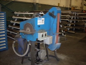

Homemade belt and disc grinder intended to reuse surplus abrasives from an existing roll grinder. Powered by a 5hp motor, the belt section accommodates 6-, 8-, and 10-inch contact wheels. An industrial vacuum pump powers the dust collection system.
