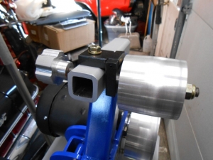

Homemade Belt Grinder Wheel Tracking Mechanism
bobs409 on homemadetools.net
Homemade belt grinder wheel tracking mechanism constructed from bar stock, threaded rod, and a nut. A crown was added to the wheel to induce proper tracking.
